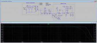

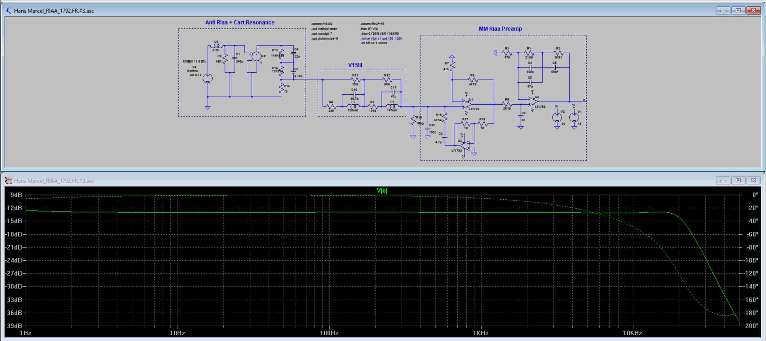

Let's hope I simulated it right this time.
The curve is 1dB higher below 5Hz, but who cares about that.
The rest is how is should be?

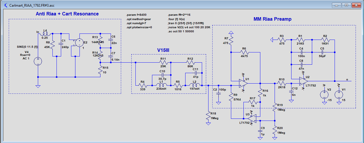

I made a slight change in the layout by replacing the 2n5 cap over the first stage to behind R10, now being 6nF.
This has several advantages:
1) you can freely change the gain of the first amp without worrying about changing the parallel cap.
2) when using the "cooled" version, the 207pF cap par to the 57K4 resistor can be discarded, making it a much easier to find the right resistance value when changing to another Cart.
I rounded the S/N figures to integers, but in fact there is only 0.5dB between the hot version and the cooled version.
I have no TL071 model but with 18nV/rtHz @ 1Khz I think the LT1792 with 4.2nV/rtHz is almost as good as it can be.
The OPA164x could be an alternative with single, dual and quadruple versions.
And regarding a S/N of 73dB-A, keep in mind that some of the most expensive and well regarded Riaa preamps (Stereophile) have lower noise figures, such as the $60,000,- Vitus with 62.8dB-A and the $36.000,- Boulder 2008 with even 58dB-A.
As a reference see here the noise from a 75dB-A preamp L/R in the lower trace against the surface noise of a new Feickert test LP with resp. an unmodulated track versus a track with a 1Khz test tone at 5cm/sec.
Where they are closest, there is still more than 15dB between the surface noise and the preamp noise, showing that even 66dB-A will only increase the surface noise by an almost insignificant 1dB.
The Boulder 208, producing comparable noise as the surface noise, will increase noise by 3dB, under the assumption that Stereophile measured correctly.
Maybe adding the noise was part of the magic of the Boulder, who knows.

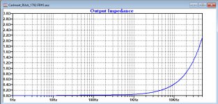

Yes I know what Impedance is, but I don't understand the reason of your question.
This amp is supposed to drive a high input impedance preamp as from the second LT1792 stage, so output impedance can never be an issue.
You could still insert an additional 100R resistor at the output to match the interconnect's impedance.
But anyhow, here is the output impedance for this Riaa preamp using the LT1792.
Hans

Using these low offset opamps on these designs, is it possible to avoid output capacitors?
Good point.
Assuming an offset voltage of 3mV max, this translates into 300mV max at the output, so when your preamp following this Riaa preamp is DC coupled, you will need an output cap.
When also implementing the cooling, you could discard the 4.7uF because less than 0.5uA will flow into the Cart, which IMO is acceptable.
But with two additional resistors and one cap, you can even reduce this to >100nA through the Cart.
My feeling is always that the best cap is no cap, so better to leave this 4.7uF.
Hans
