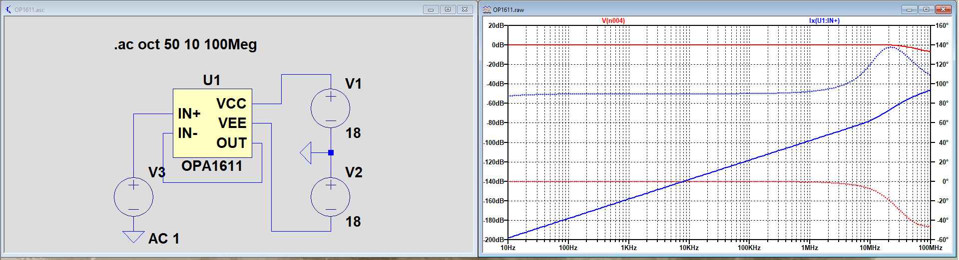

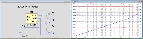

But I seem not get an LTSpice working model for it. Same thing happens with the OPA134, also recommended. Can't make the model work.

This reminds me of someone having trouble to get a AD825 working.
Hans
Indeed, Hans. Only this time that way of doing things is not working.
I do not have a .cir or .asy file.
Apparently a different way of doing things has to be applied, right?
Download the zipped OPA1611 Spice model.
Extract the zipped file.
Put the OPA1611.lib in the same directory that you are using for your model.
Follow the same procedure as for the AD825 to auto generate an .ASY file.
In your model click on AutoGenerated and place your OPA1611.
Hans

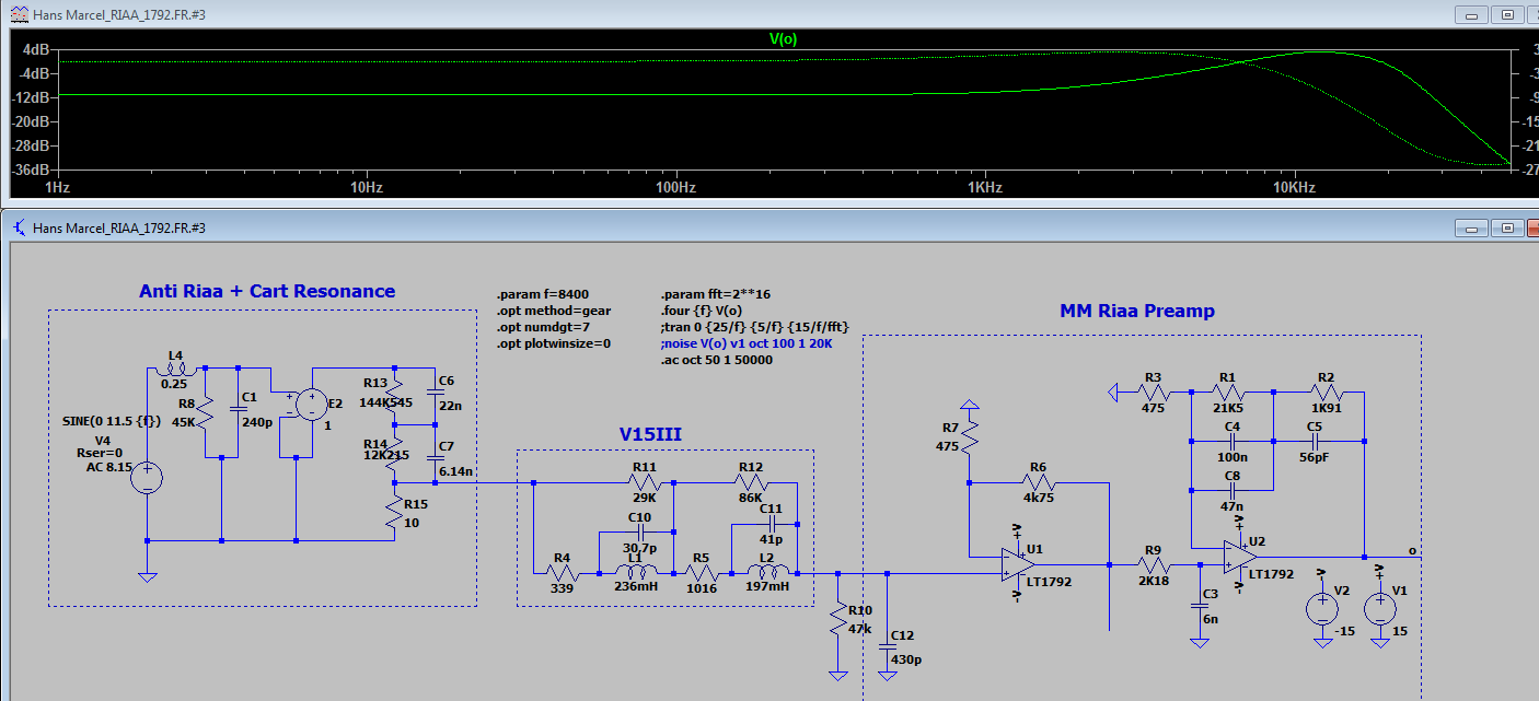

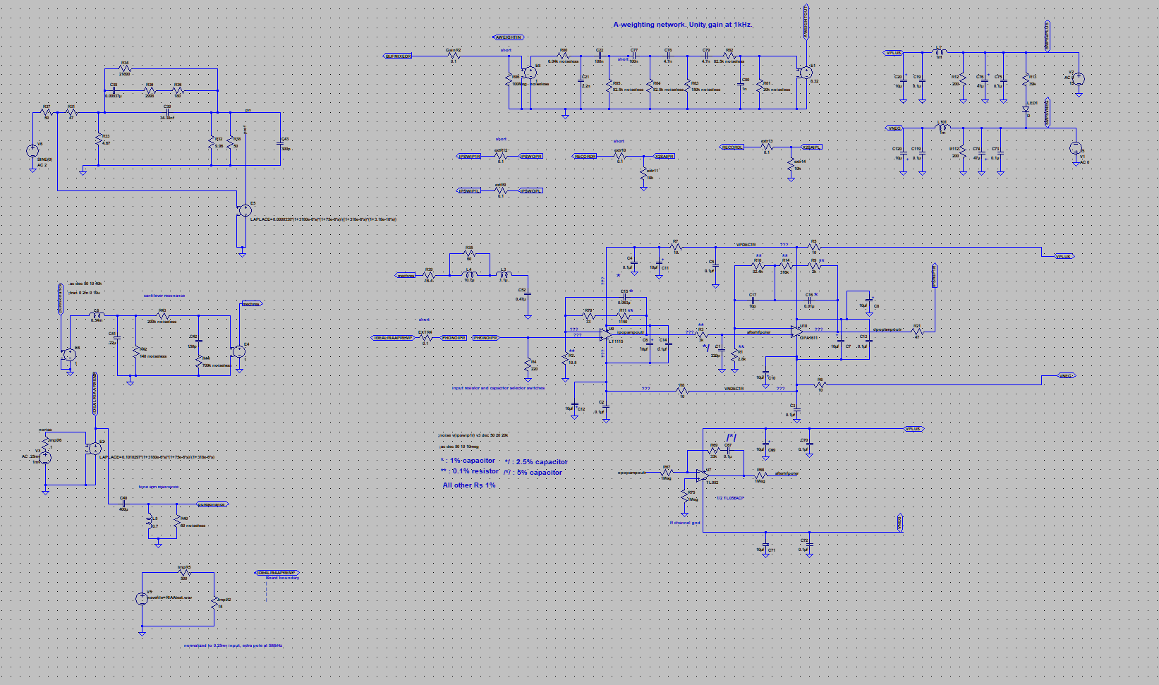

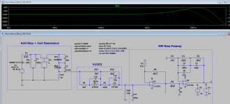

Perhaps some of you would find this of interest.
It's an early (simplified) RIAA opamp design which includes models for cartridge/pickup arm behaviors etc. based on measurements of a specific cartridge- the Miyajima Madake.
The full preamp, somewhat modified, extended and improved, is on a thread in this forum.
it also includes a Laplace RIAA model, A weighting measurement networks etc.
