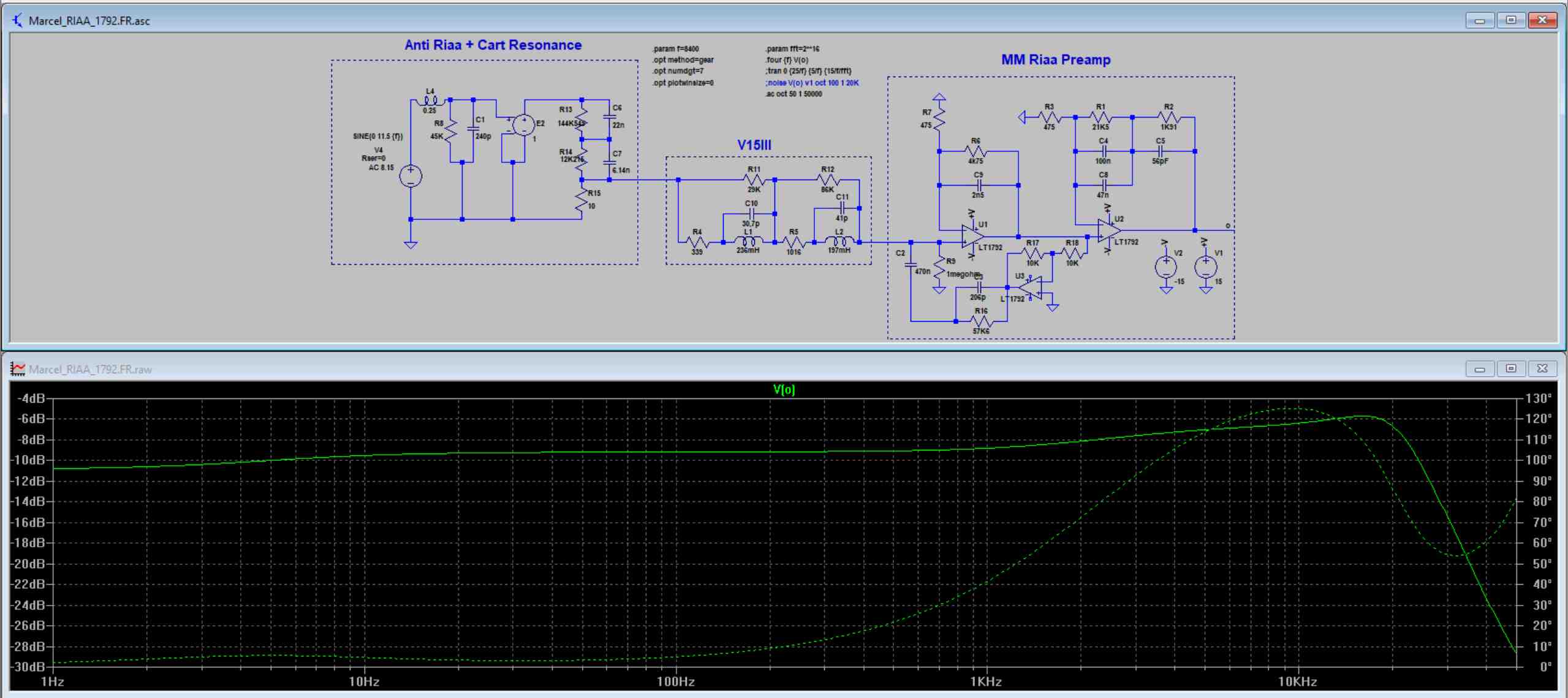

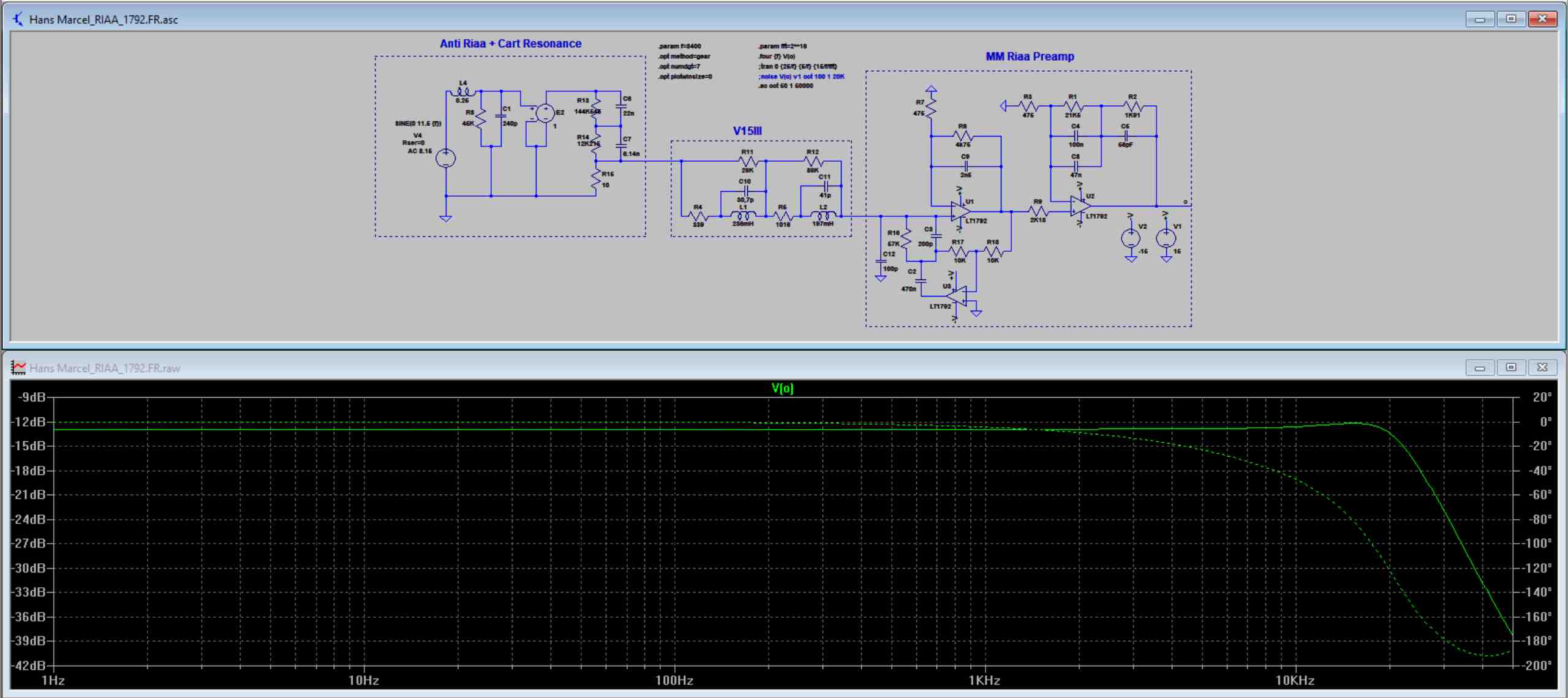

One thing I wold appreciate you to explain is why I'm getting a tenths od-f dB on the right and hundredths of dBs on yours. Why is the scale changing?
R9 is 1 milliohm instead of 1 megohm in your simulation. As Spice is not case sensitive, in Spice syntax, 1 megohm is 1 meg.
The supply pins of the extra op-amp appear to be unconnected.
The only benefit compared to Hans's version is a reduction of the noise. Otherwise it is supposed to do practically the same as the circuit from post #1.

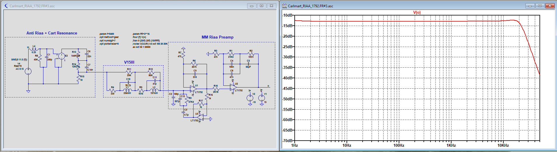

Which was the 80dB-A version with 47K you mention? The one I did got me a big hump going up 9dB, from 1KHz to 17KHz. To get flatness I need 4K78 load. Is there other option for a straight FR?
Simulated the Marcel "cooled" version you did, and it did get me a flat FR up to 17KHz.
I did some small changes in your schematic, going to the more standard values of 57K and 200p, instead of the ones you put, and replace the 4.7u with a film 470n. I hope that's alright, for nothing seemed to change in FR.
If the values have to be the ones you put, please do tell me why.

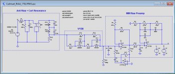

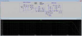

If I had TL071 models to use on my simulation I would certainly try them, and see what changes. Noise might probably be affected.
I made a slight change in the layout by replacing the 2n5 cap over the first stage to behind R10, now being 6nF.
This has several advantages:
1) you can freely change the gain of the first amp without worrying about changing the parallel cap.
2) when using the "cooled" version, the 207pF cap par to the 57K4 resistor can be discarded, making it a much easier to find the right resistance value when changing to another Cart.

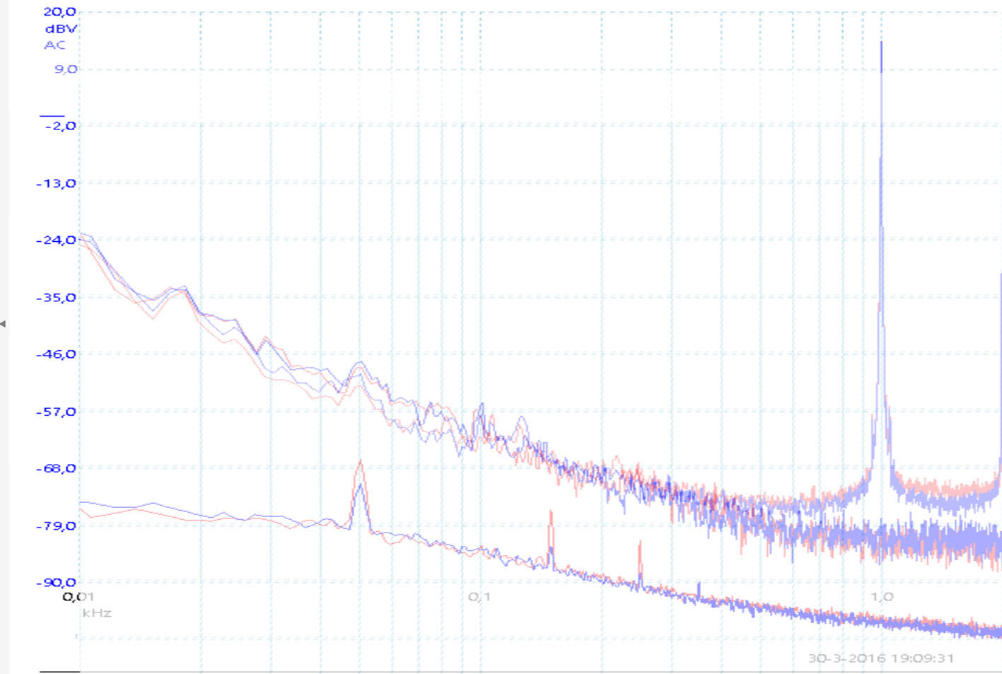

And regarding a S/N of 73dB-A, keep in mind that some of the most expensive and well regarded Riaa preamps (Stereophile) have lower noise figures, such as the $60,000,- Vitus with 62.8dB-A and the $36.000,- Boulder 2008 with even 58dB-A.
As a reference see here the noise from a 75dB-A preamp L/R in the lower trace against the surface noise of a new Feickert test LP with resp. an unmodulated track versus a track with a 1Khz test tone at 5cm/sec.
Where they are closest, there is still more than 15dB between the surface noise and the preamp noise, showing that even 66dB-A will only increase the surface noise by an almost insignificant 1dB.
The Boulder 208, producing comparable noise as the surface noise, will increase noise by 3dB, under the assumption that Stereophile measured correctly.
Maybe adding the noise was part of the magic of the Boulder, who knows.

That was the version without the cooling, with a 47K Cart termination and with the 34.4nF cap behind R10.Which was the 80dB-A version with 47K you mention?
This is the usual bread and butter version.
You have placed the 10K feedback resistor on the wrong place, it should be connected to the output of the amp.I did some small changes in your schematic, going to the more standard values of 57K and 200p, instead of the ones you put, and replace the 4.7u with a film 470n. I hope that's alright, for nothing seemed to change in FR.
Hans
