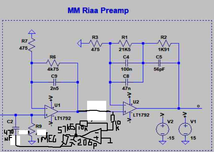

I've been using this RIAA circuit for many years with good results. Curious what you think of it. I tend not to need a lot of gain. Since I bought a lot of LME49710 opamps, that's what I use.
I have no access to LTSpice at the moment so I haven't a clue what your circuit looks like, but the noise current of an LME49710 is a bit high for moving magnet.

After removing some leftovers that don't seem to be useful anymore and correcting the two wrong component values, you end up with the attached schematic. 57.6 kohm is an E96 standard value, you can get 206 pF by connecting 150 pF in parallel with 56 pF. The extra op-amp could for example be an OPA134 or the same type of FET op-amp as used in the rest of the circuit. Details like power supply decoupling are obviously still missing.

There will be a substantial offset at the output, worst case about 500 times the maximum offset of the first op-amp plus 45 times the maximum offset of the second op-amp (as specified in their datasheets). The easiest way to block it is with a DC blocking capacitor.

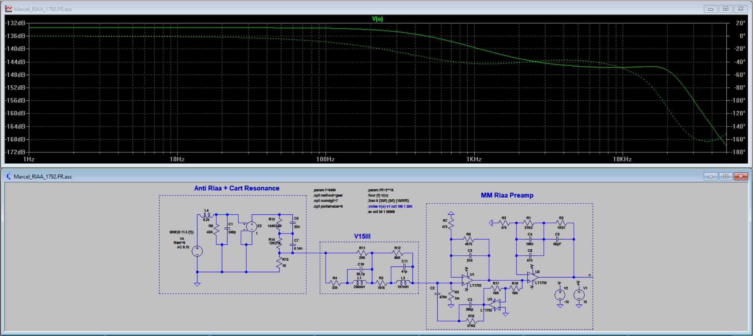

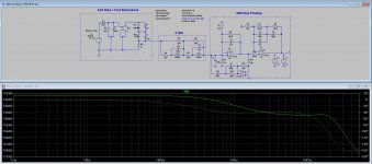

Marcel, you can't imagine how much appreciate what you are doing, even if I don't quite understand what it is. Hereby I enclosed the simulations of both designs you did, hopefully no having read some part spec wrongly.
The problem seems to be the frequency response I'm getting, which stopped being flat as it was before.
Can you explain a little more of what you were trying to correct and why?

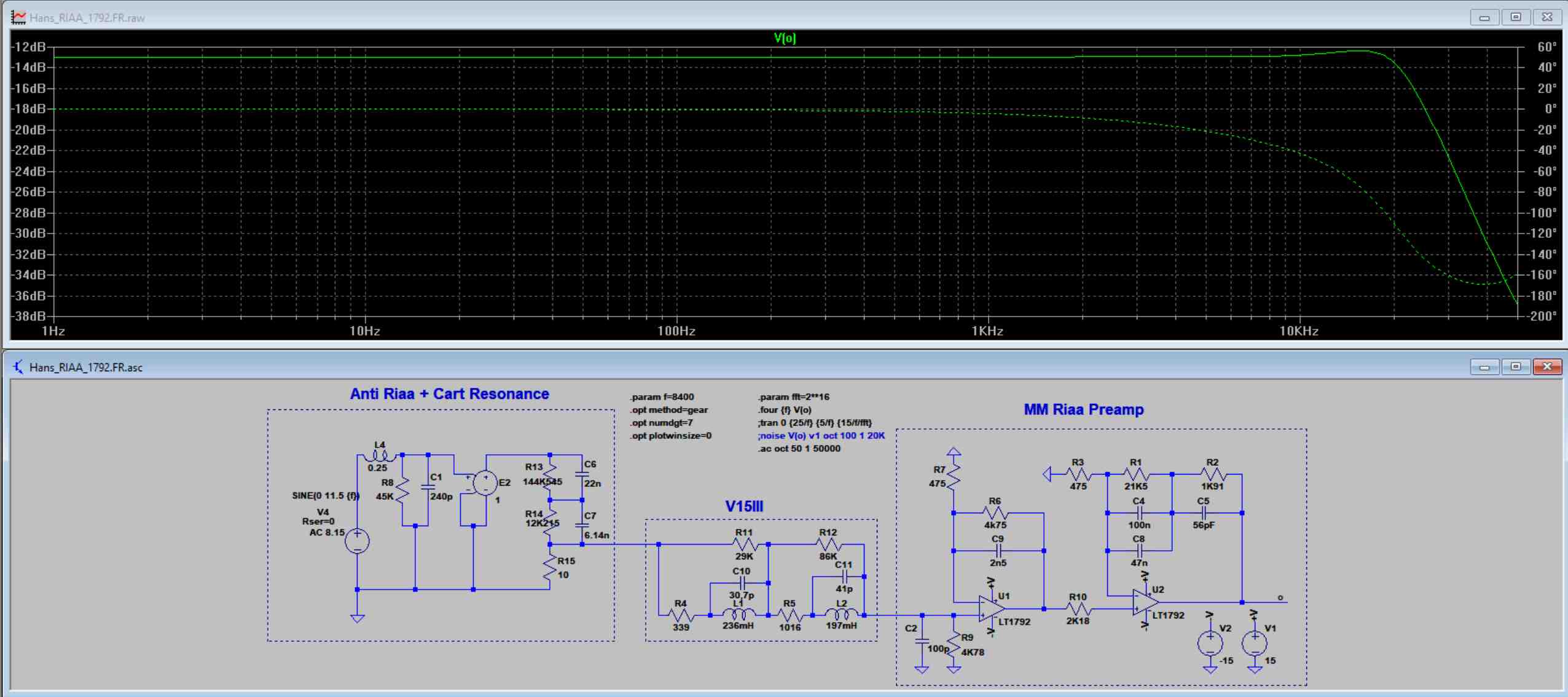

Enclosed, just for comparison, is the original Hans design.
One thing I wold appreciate you to explain is why I'm getting a tenths od-f dB on the right and hundredths of dBs on yours. Why is the scale changing?
