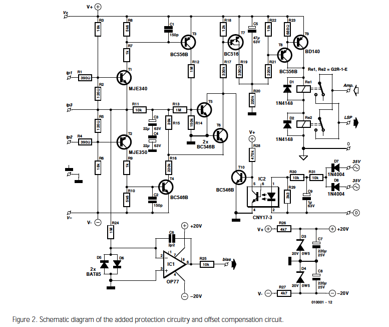

Thanks Valery,
I use the crescendo Me protection, see attached.
As you see, they are 2 x 35Vac connected and 0V coming directly from the transformer.
This is Elektor 2001 article magazine:
"The protection circuitry (Figure 2),which is located on a separate
printed circuit board, includes overload protection, DC protection, a
switch-on delay for the output relay and a voltage detector that directly disables the output relay when the power is switched off or any of the transformer voltages is absent"
1- The relay did not switched on after the delay of 8Secondes, if i take off R29 the relay switched on after 8s ..
2- When i disconnected one of the 35Vac the output relay do not switched-off

Looking at the schematic, here is what I see:
1- R29 shunts the LED too much, so you can increase its value up to, say, 10K. This resistor aims to discharge C9 after the voltage reaches the level where the LED stops conducting.
2- The way those diodes are arranged (D7, D8), the speaker will get disconnected only in case both voltages go off at the same time.

Hi Francois,
though I'm not Valery, I'll try to help you: Duplicate R31, i.e. one resistor in series with each diode D7, D8. Then inject 35 Vac to one of these diodes and decrease R29 or increase R30 until the speaker relay opens. Make sure that if you inject 35 Vac to both diodes, the relay must close again.
Best regards!

This is a working circuit,exactly as descripted in Elektor.
Tested!
![up :up: :up:](https://files.diyaudio.com/forums/images/smilies/up.gif)
If any of the transformer A.C voltage is absent, d.c voltage at the common cathode connection D7,D8 decrease from 34v to 24v which is not enough to drive the led.

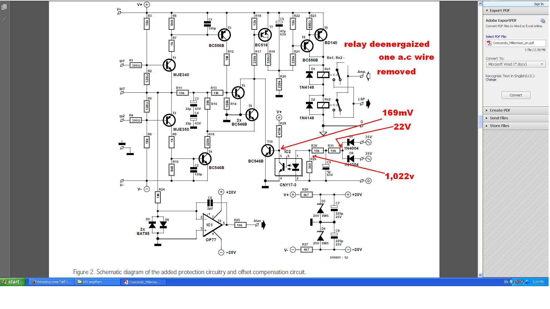

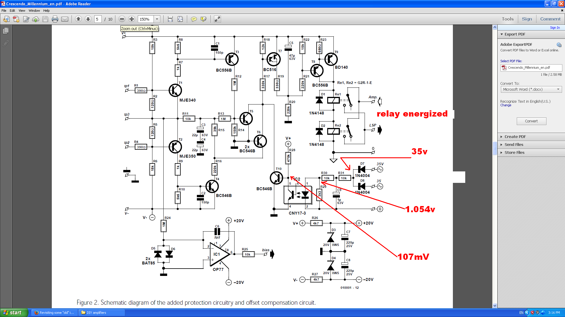

Yes,according to new measurments,this is a very critical circuit.
Now i wonder if it is a good circuit .
I will post measurments under normal and under fault conditions.
This fault is the absence of one a.c winding.
Picture in the right is under normal conditions.
Picture in the left is under fault.
I have tried to increase R29 to 10K but then relay stays energized even one of the a.c removed.
Using a trimmer here i ended again at 3K3 value.
Do they choose to stay at the end of conditions in order to open the relay instantly after amplifier power off?
Now Valery you have all the story

OK, that requires pretty fine tuning at particular voltage levels. I don't really like the designs, so heavily dependent on the supply voltage.
That means - it's possible to tune the thing up, adjusting R29 in a way that the LED will get enough voltage with both supplies working, but not enough with both supplies in place.

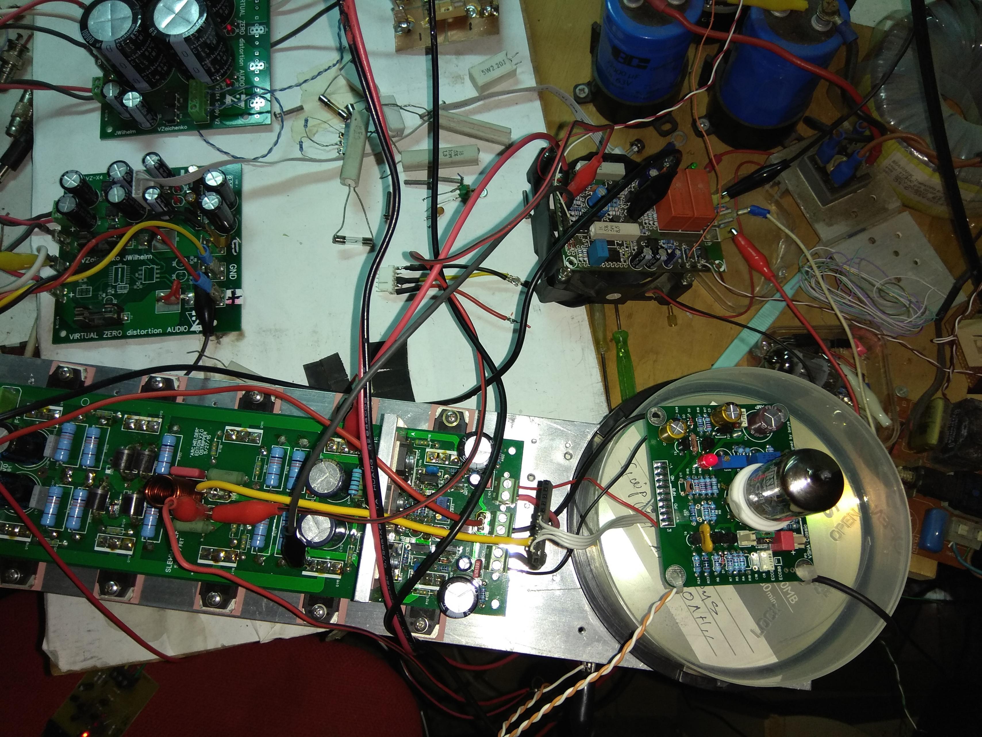

Finally this circuit as publised connected completely to Slewmaster and function absolutely normal.
Power supply +/-50v
Playing up to hard clipping levels all are fine.
