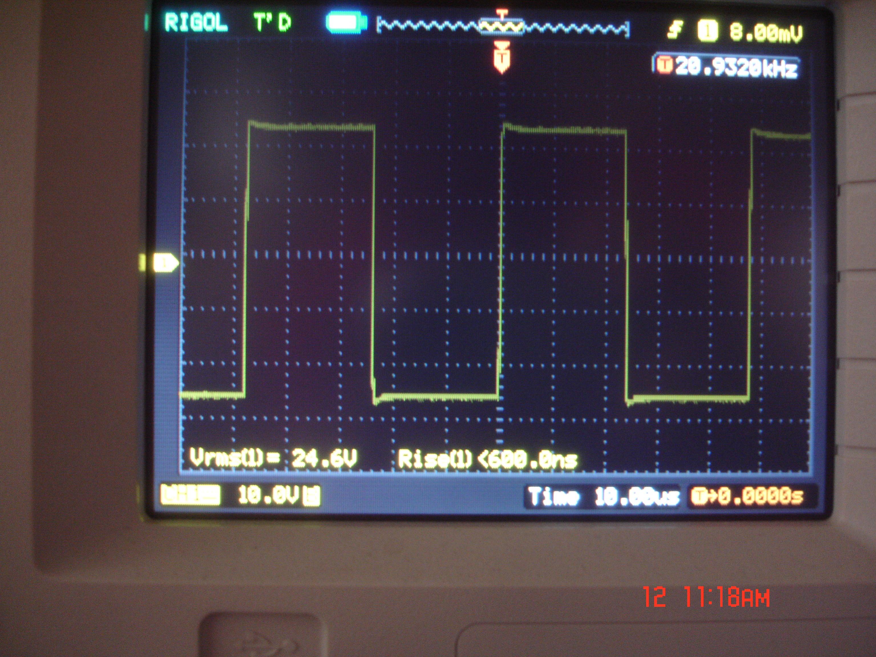

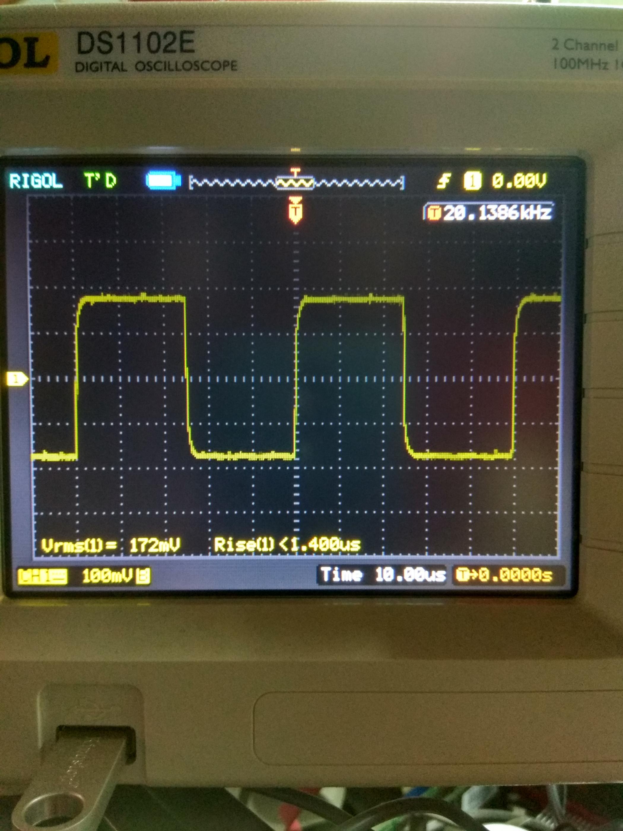

According Valery's guides.
D1,D4 SHORTED
C11,C12=100pf
C15 REMOVED.
This is a stand alone test.
D1,D4 SHORTED
C11,C12=100pf
C15 REMOVED.
D1,D4 SHORTED
C11,C12=100pf
C15 REMOVED.

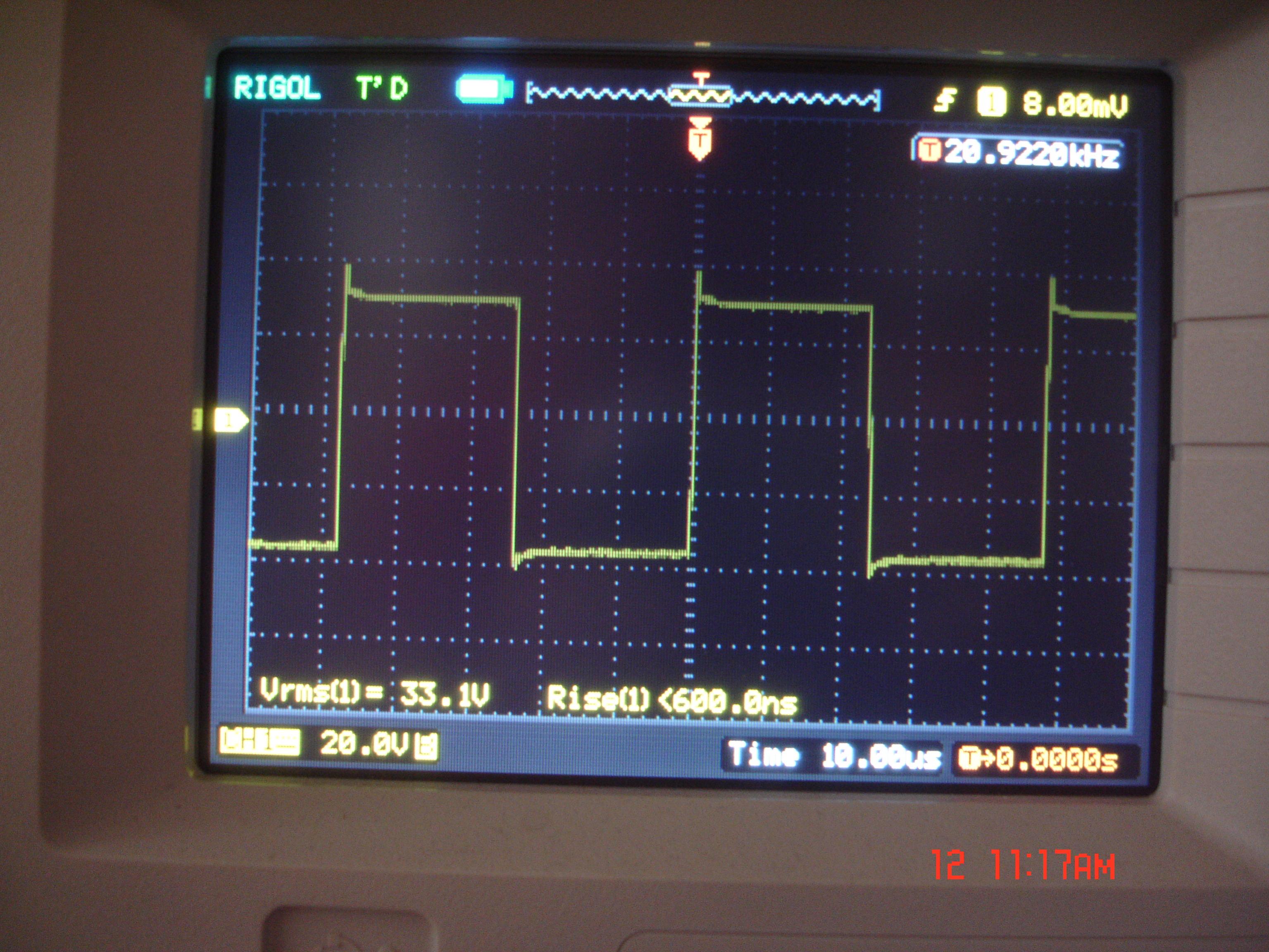

Hi Thimios! Thank you for the info.

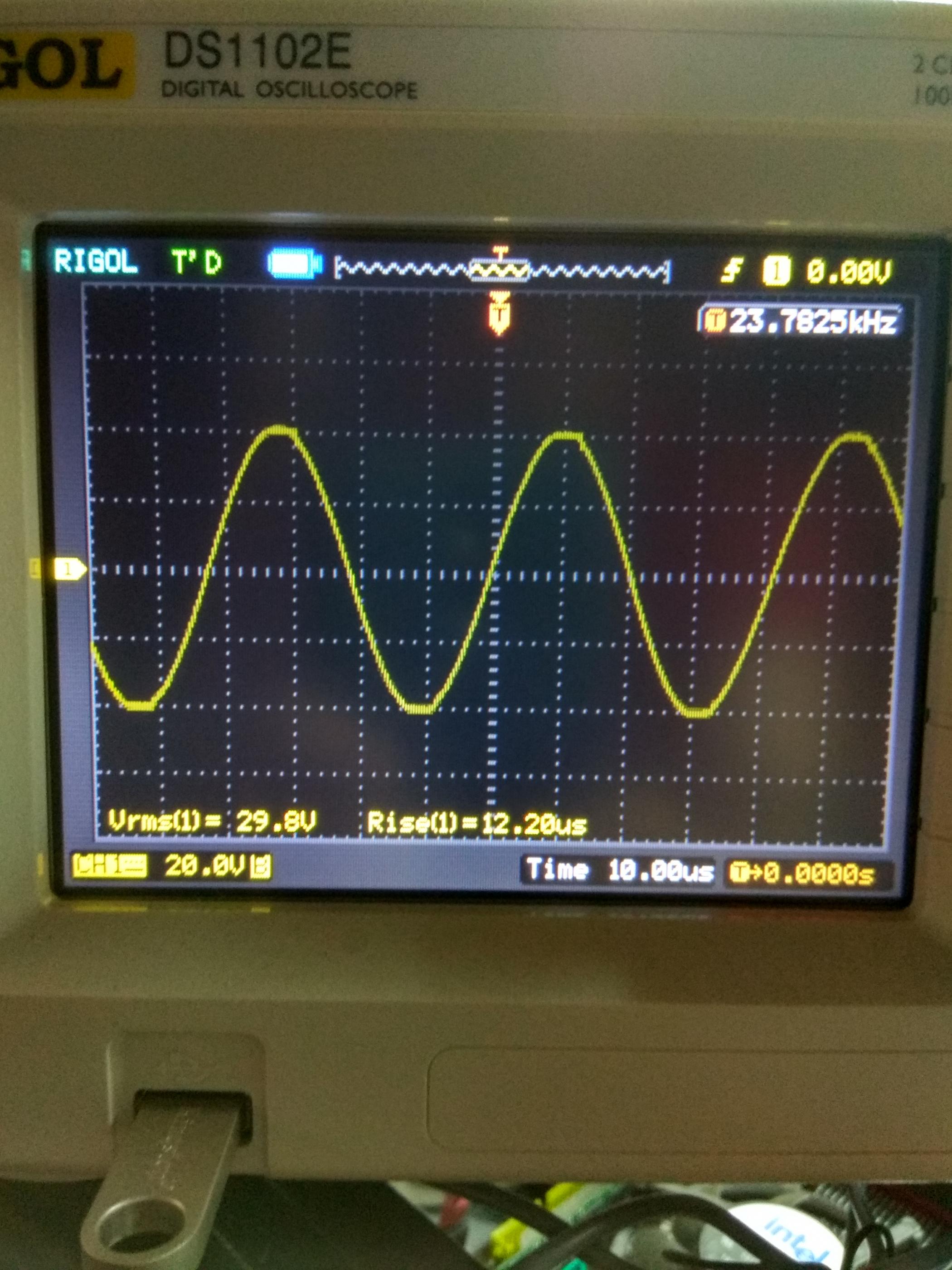

Showing a bit of an overshoot, being lightning fast at the same time.
Let's test it together with OPS, and then we'll see.
Probably we will return C15 at some small value, but let's see the whole thing first.
Now attached to OPS.
No good news🙁
No good news🙁

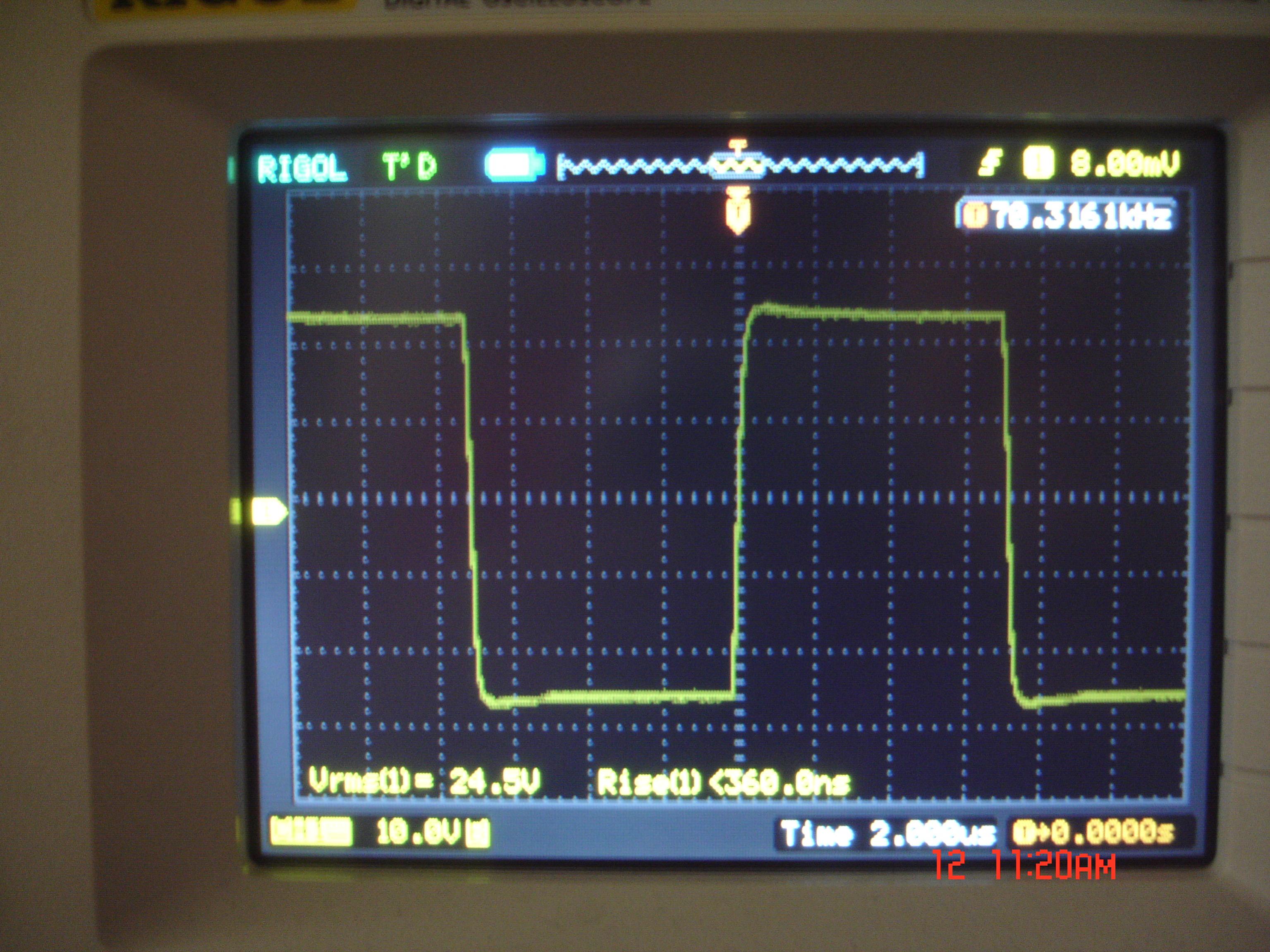

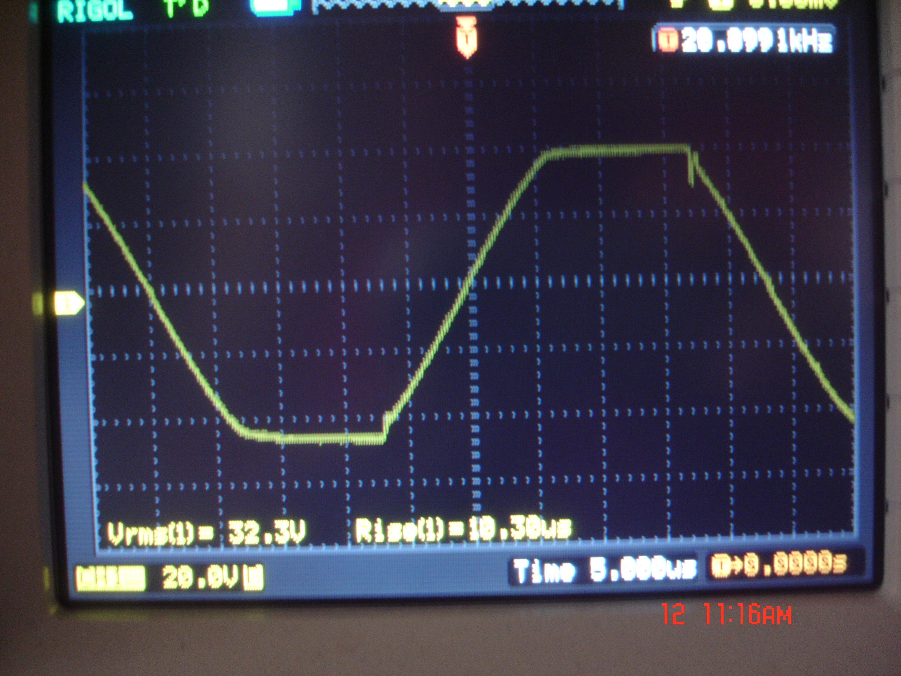

More pictures

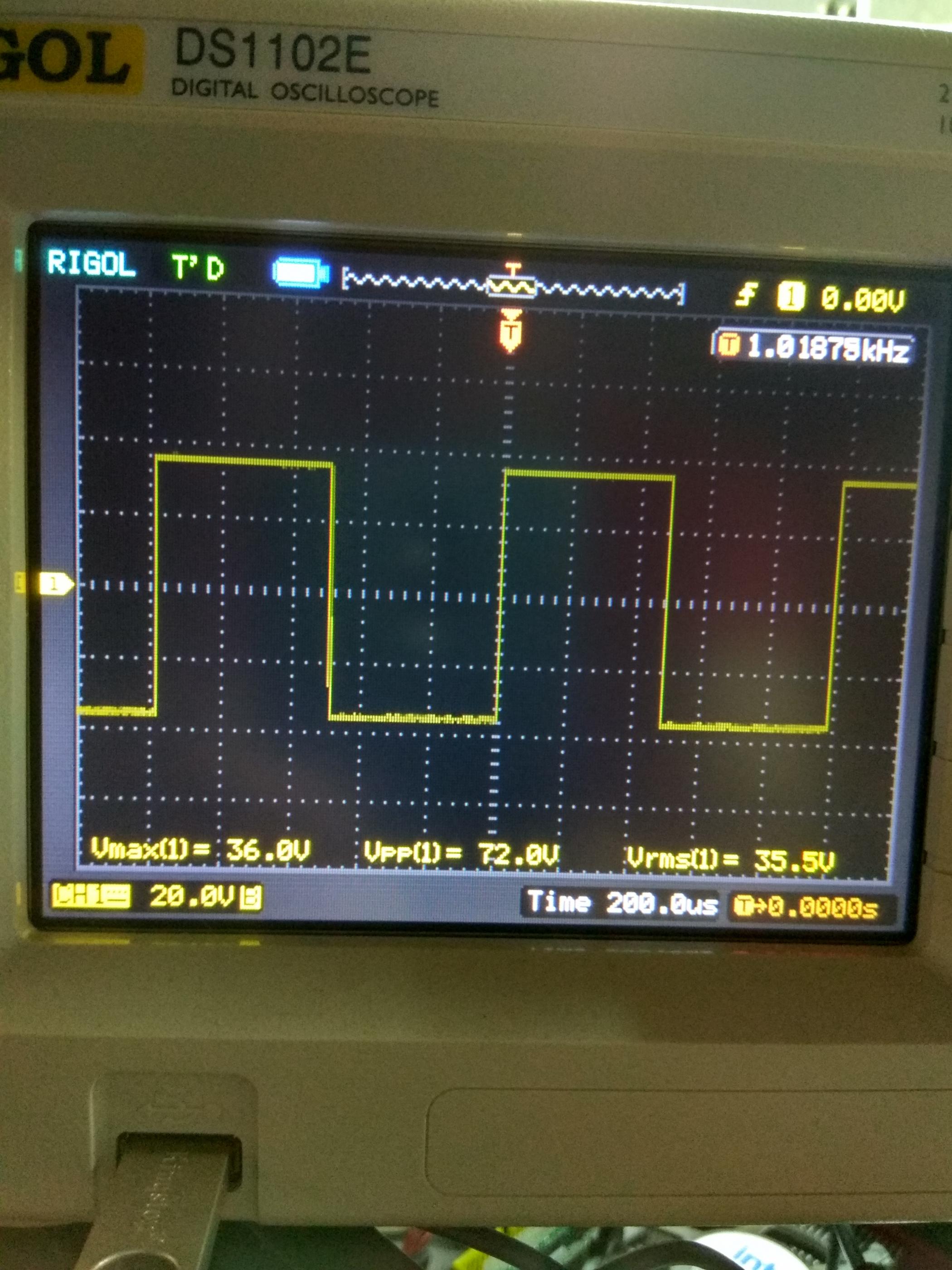

1)50Khz
2)soft clip
3)1Khz
1)50Khz
2)soft clip
3)1Khz
No good news🙁

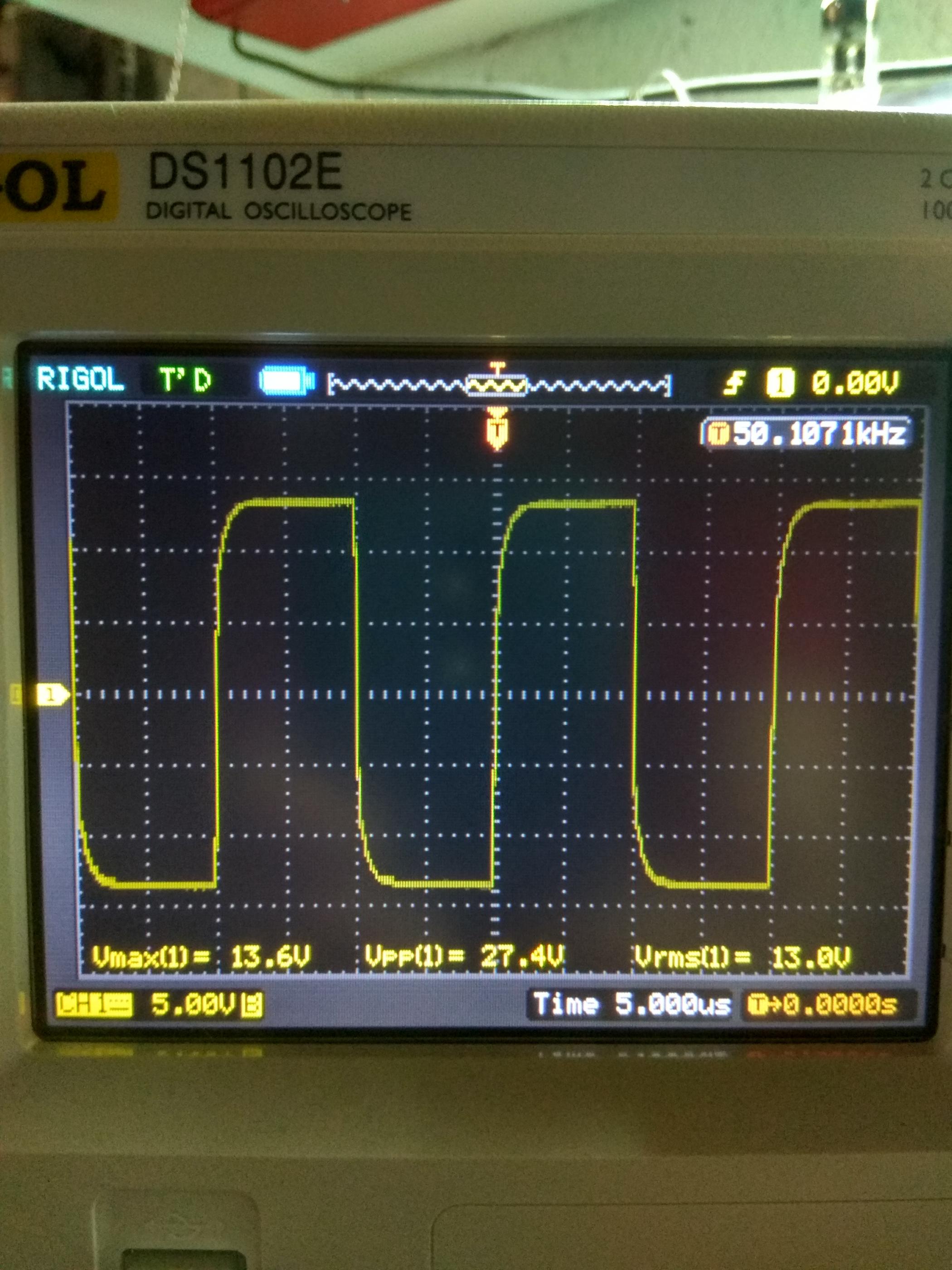

Well, it's much better than it was before, isn't it? 🙂
Now you can put some 15-22pF as C15 for having the front corners more rounded.
More pictures
1)50Khz
2)soft clip
3)1Khz
Rather fast and accurate, huh? 🙂
I like it.

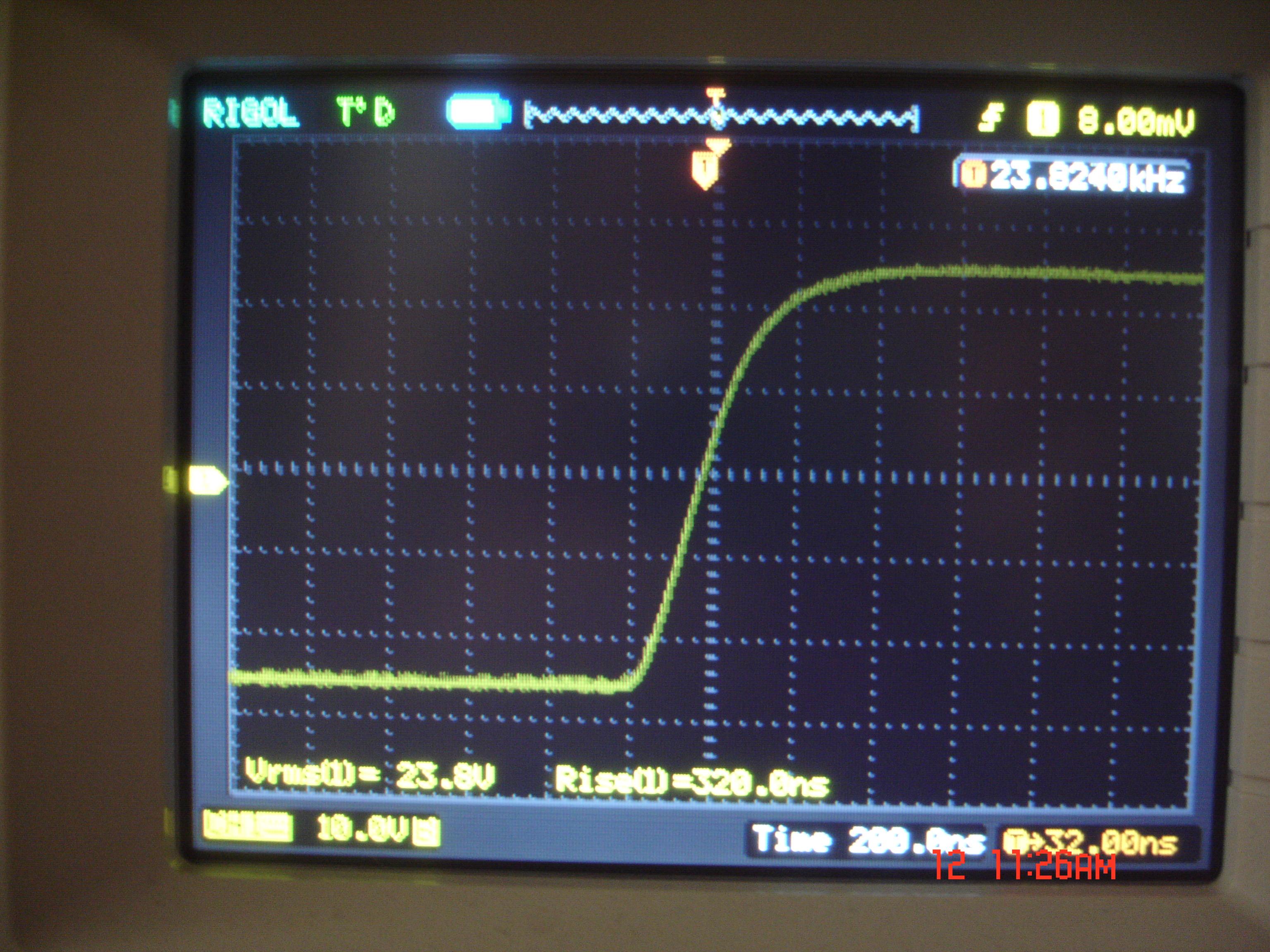

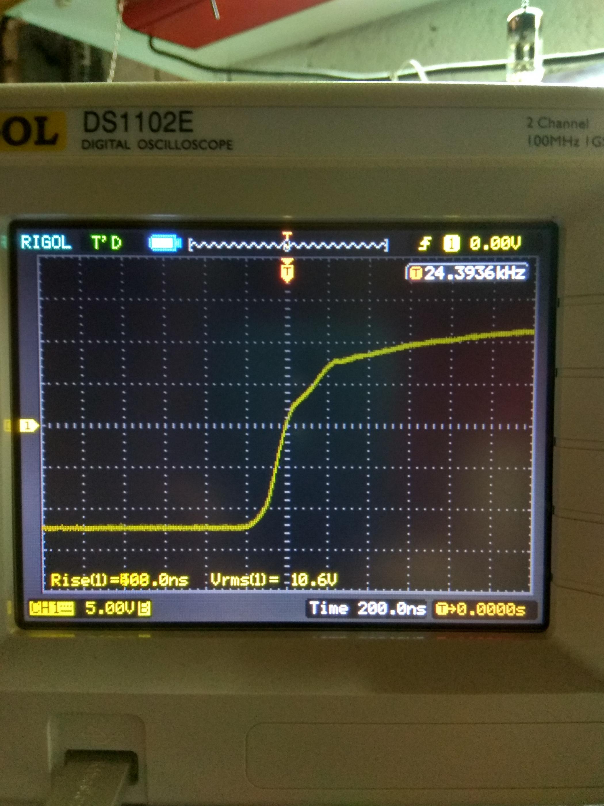

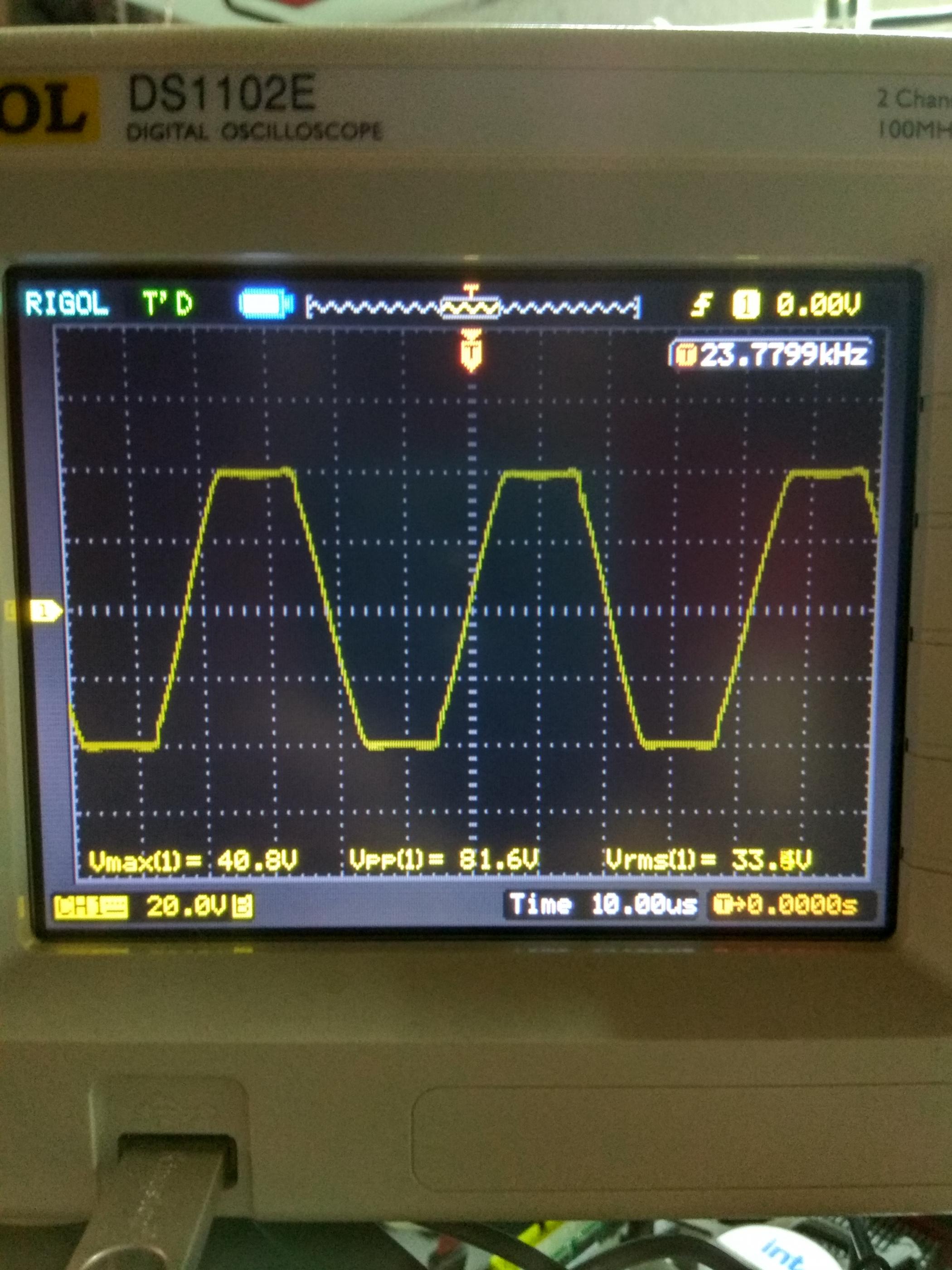

Yes but what is the unnormal rise on picture 3 on post#2828?
That's not an issue - the whole thing happens within a very short timeframe.
The bottom half of the slope takes around 100nS - holy shoot! 😀
Then it slows down a bit, forming some kind of inflection point. It may be possible to smooth it by tuning-up the compensation, however even as-is it will not create any issues within the audio range of frequencies.
50KHz square in the post#2831 looks very good, as well as 1KHz - super accurate.
Ok boss!🙂
What about C15,do you see any reason for additing something here?
I would test with, say, 15pF just for the sake of curiosity if it's going to make that inflection point less noticeable in the same conditions.

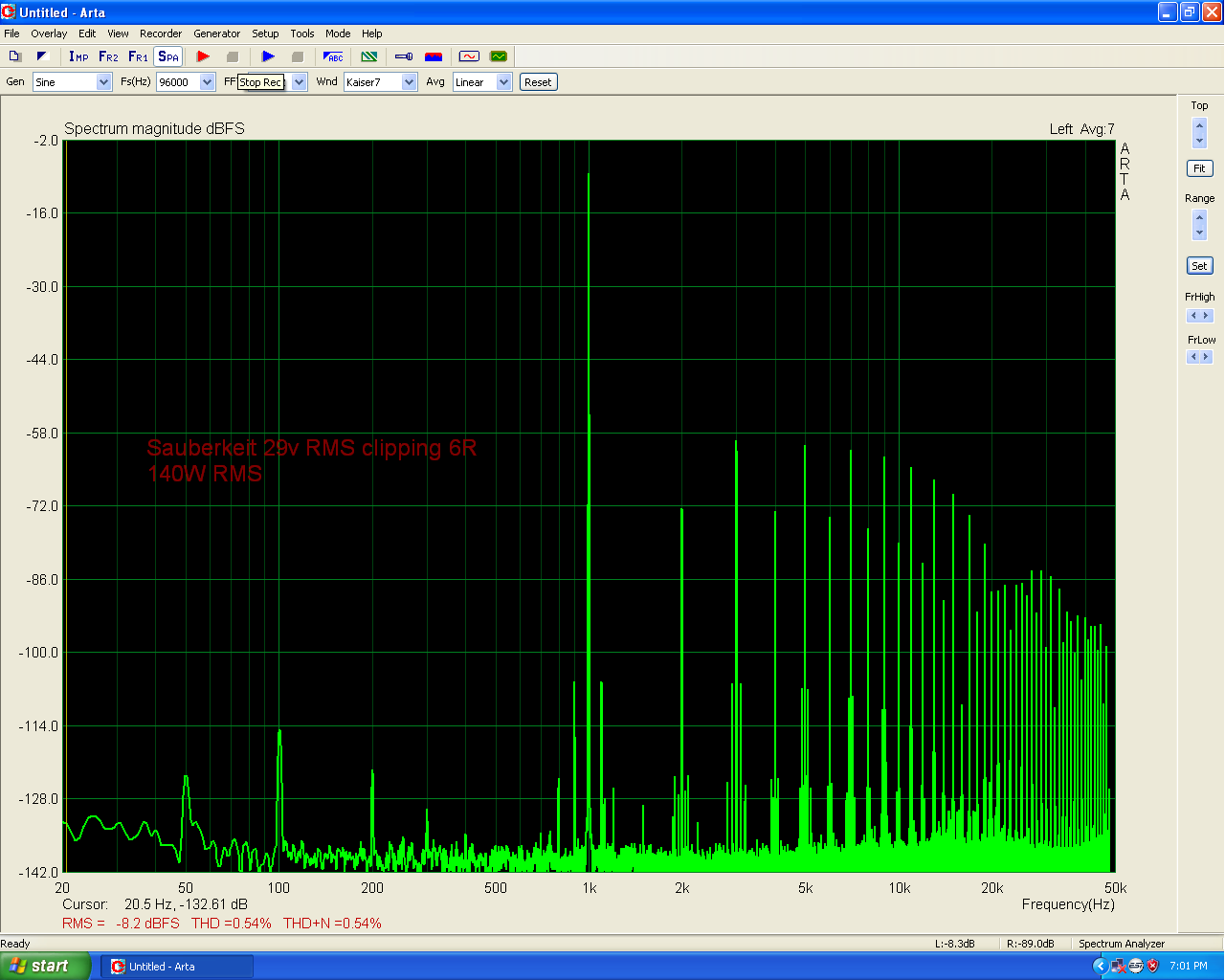

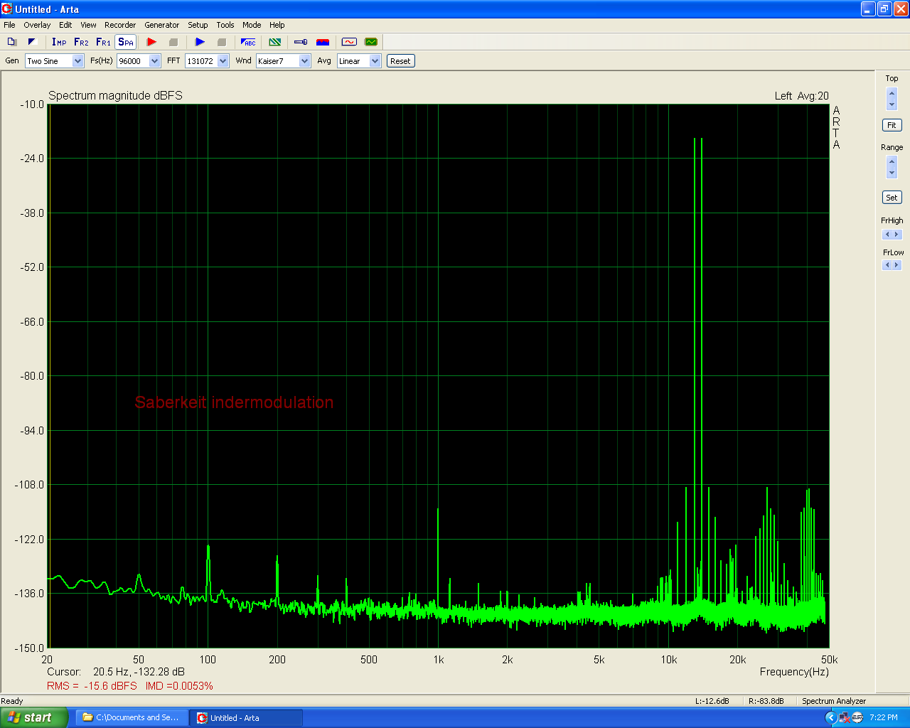

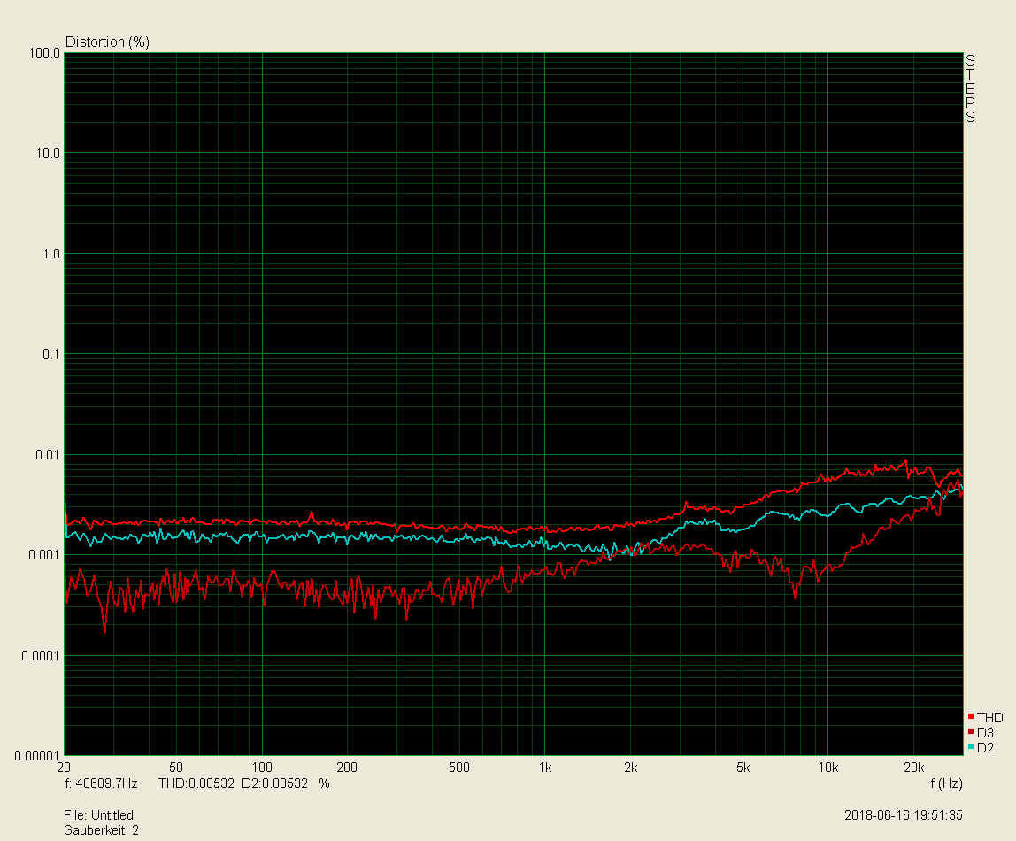

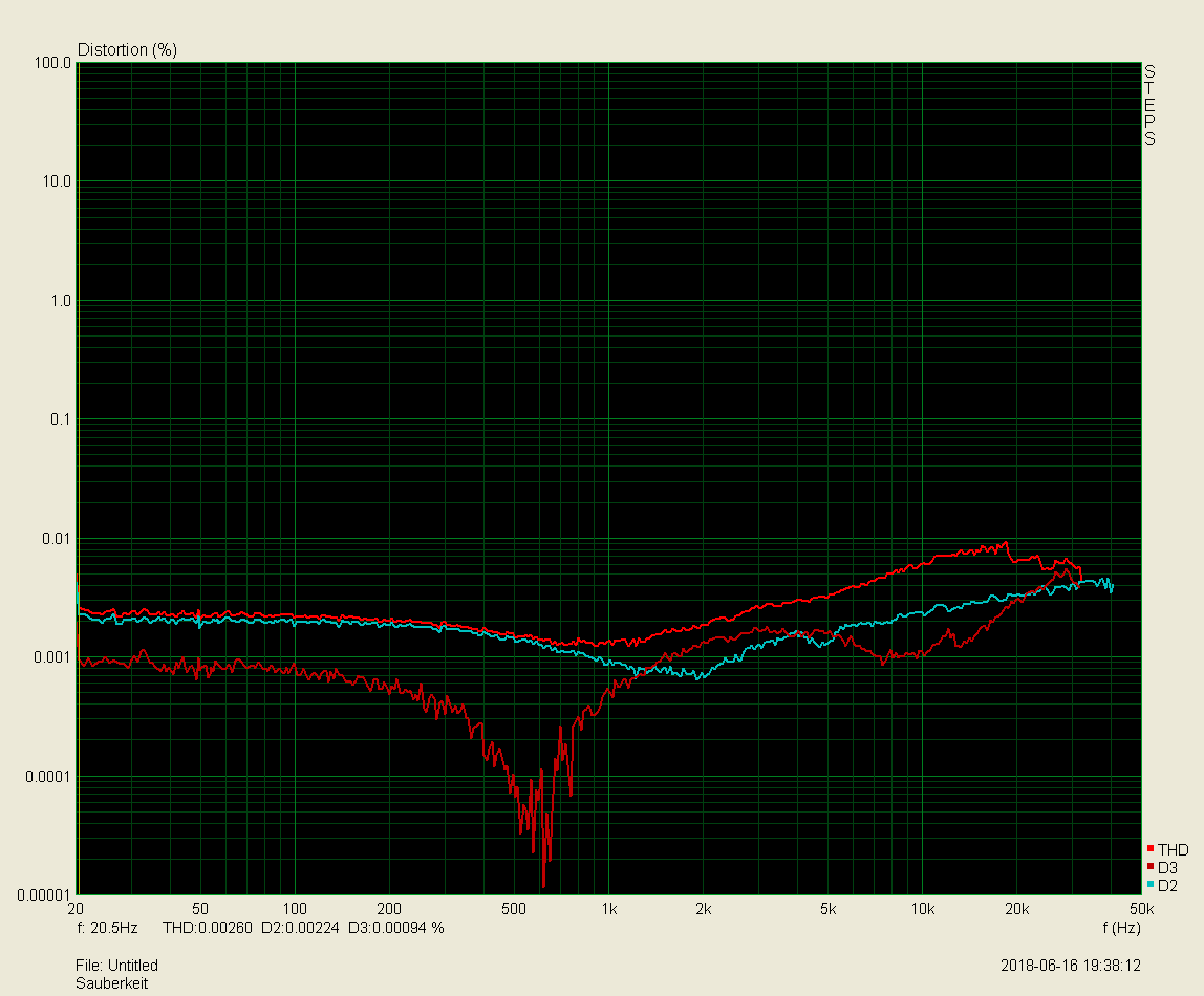

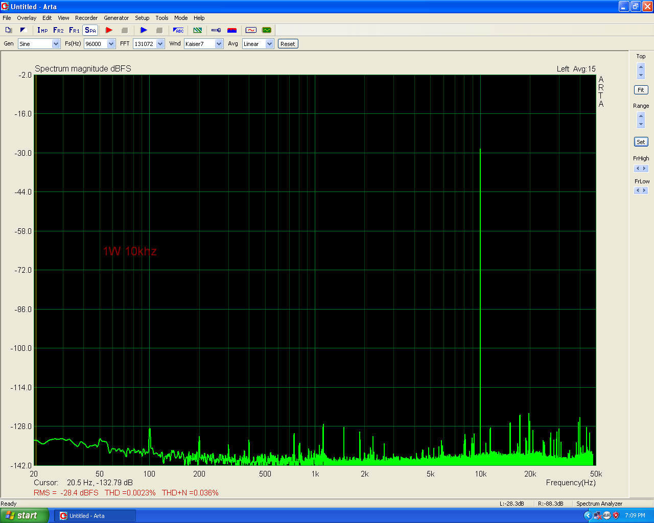

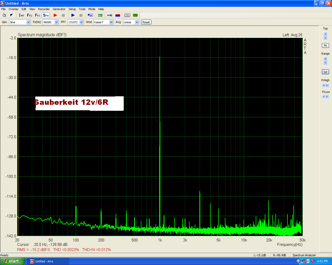

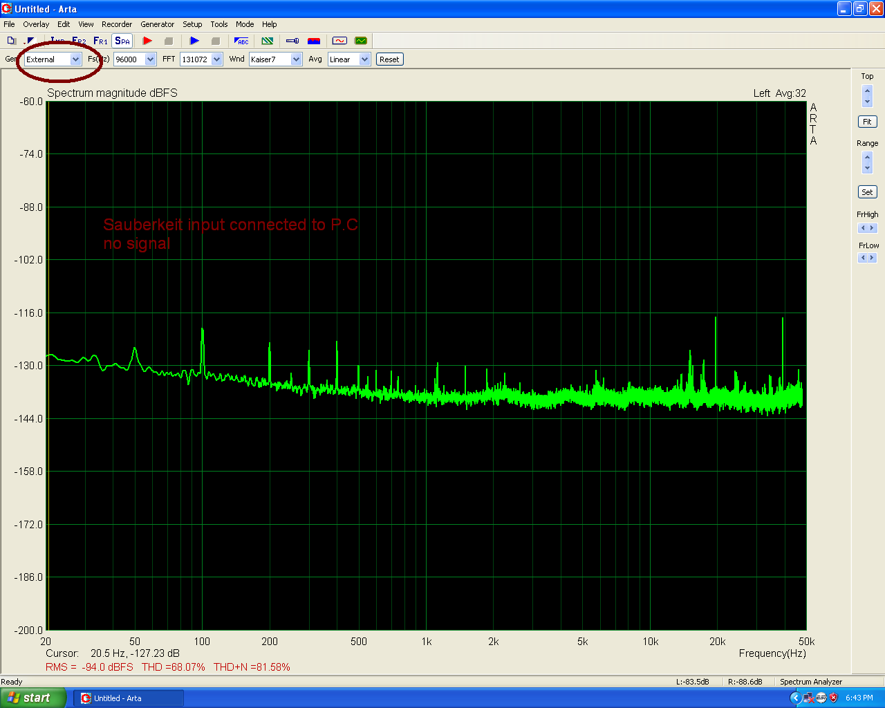

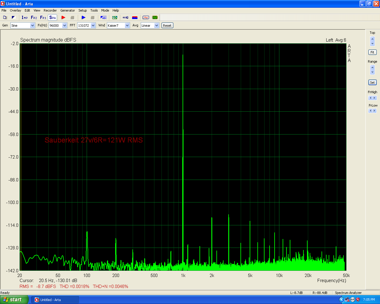

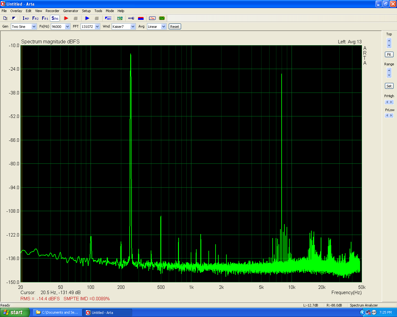

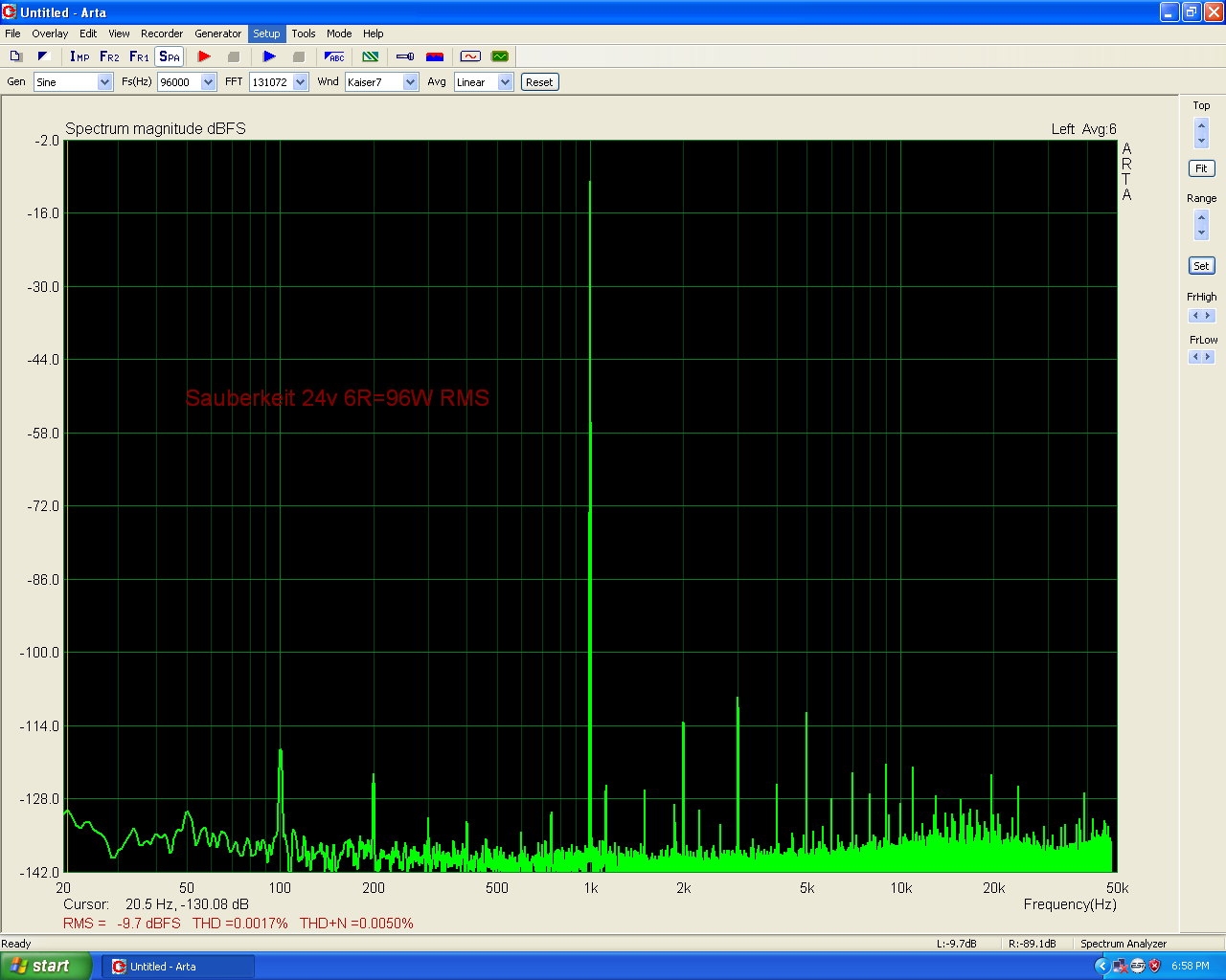

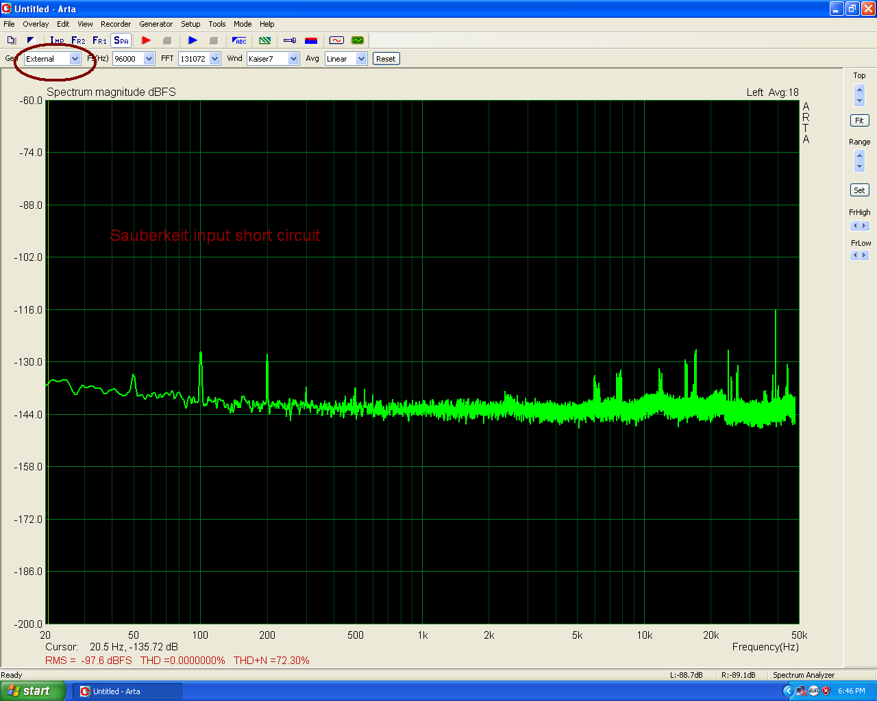

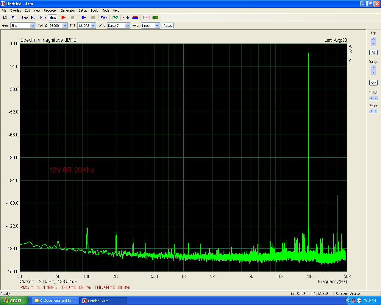

Sauberkeit+NS
Let's see what is the new IPS.
Power supply +/-50v
32.000UF/RAIL
Idle=70mA
Offset=3mV.
The rest on the pictures.

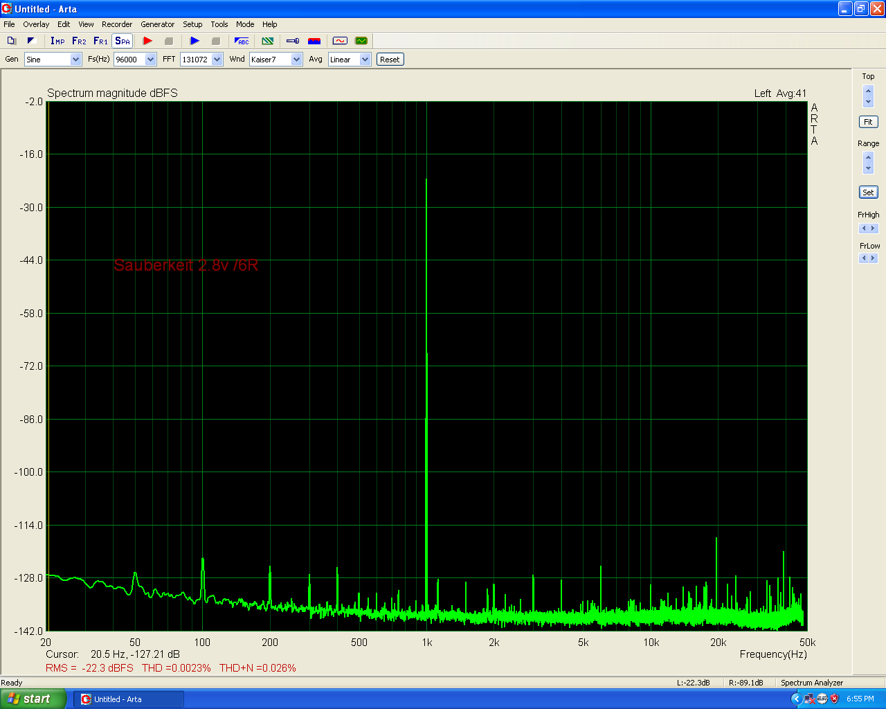

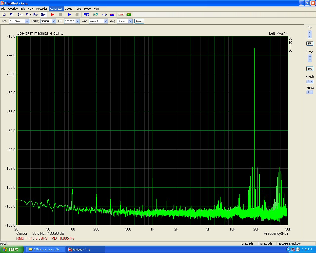

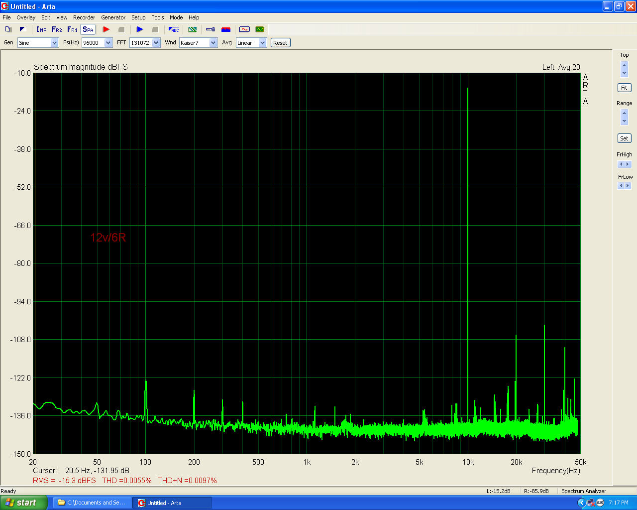

Picture 1,2 how quiet is the amplifier.
Power supply +/-50v
32.000UF/RAIL
Idle=70mA
Offset=3mV.
