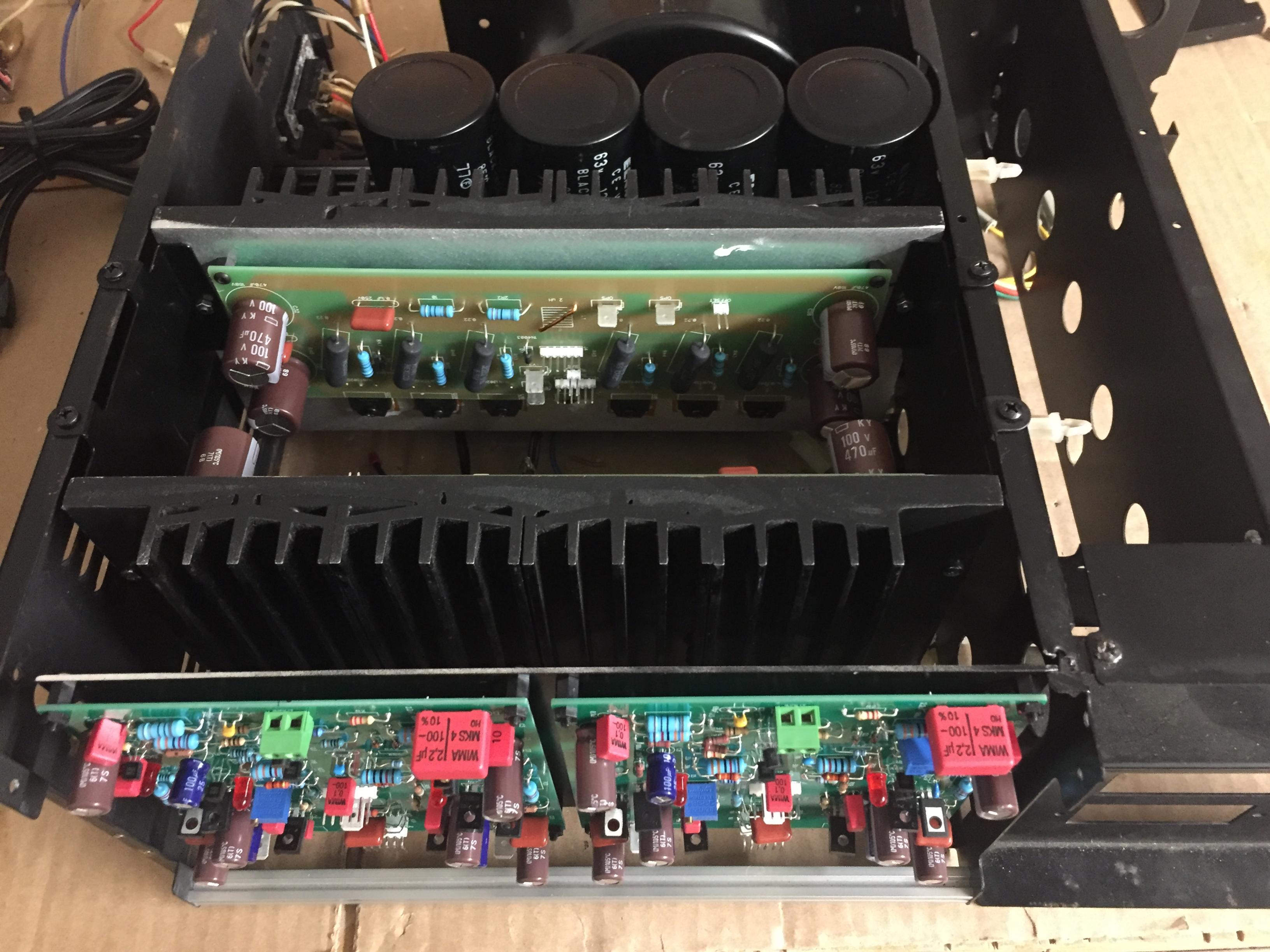

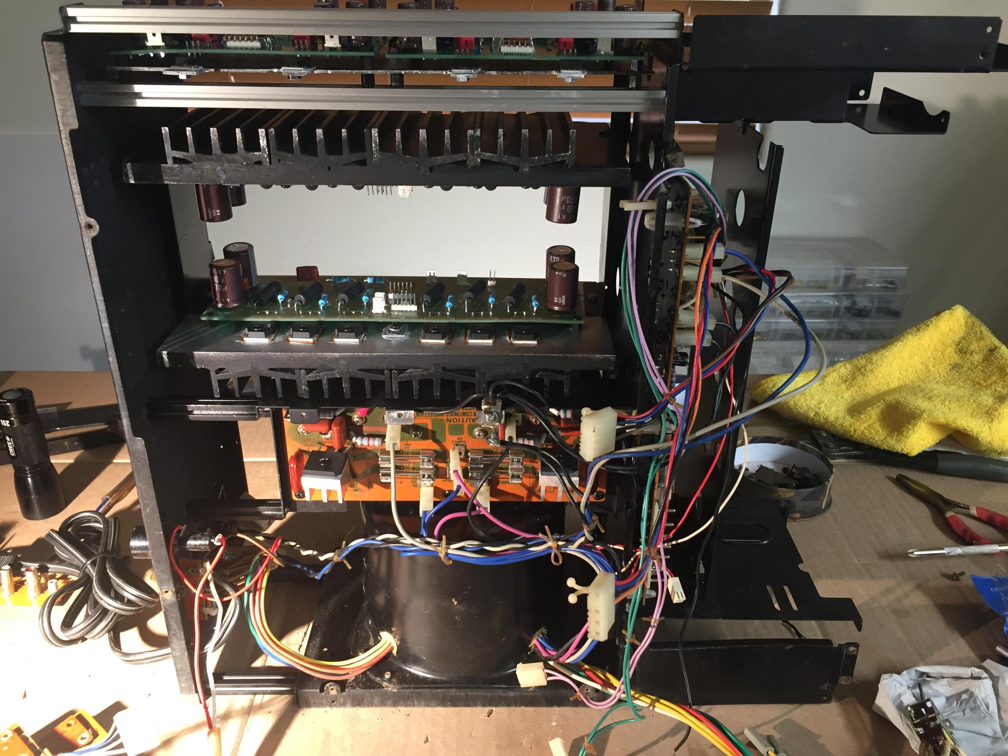

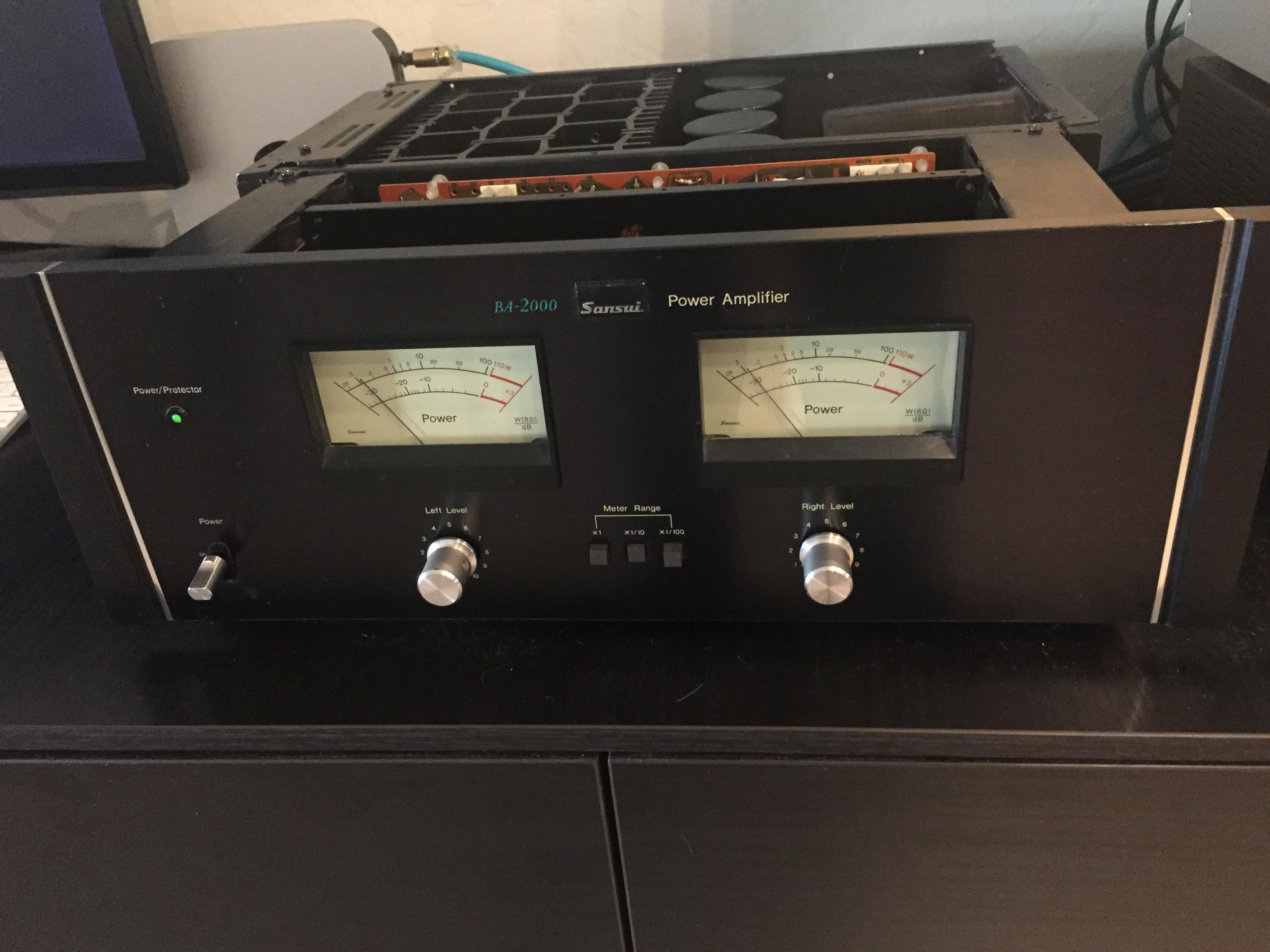

Valery's Tribute-3000
I'm working my way through implementing Valery's updated Sansui Ba-3000 driver and OPS. I don't have a BA-3000 but I have a BA-2000, About 10v less B+ and a slightly smaller chassis. Well, its was smaller It's not smaller anymore.
I think the updated boards can be seen in the center picture. OPS mounted on the heat sinks and the green driver boards.
