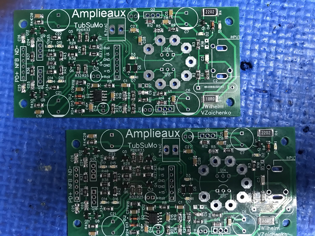

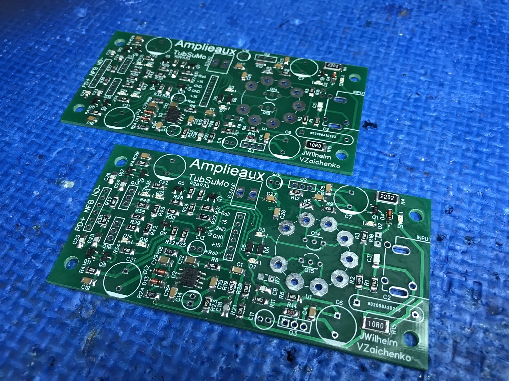

The TubSuMo IPSs arrived for me 4 days ago. For 6.3V heater supply i use a small transformer, nothing fancy. The amplifier biases easy without any problem, just it needs more time at startup for the offset to settle. There is no hum and the distortion is in the 0.002% region.
It plays lovely, you must try this.

Excellent build - from what I see - looks very much like our reference one
Great job
Do, of the amps I’ve built the tubsumo is one of my favorites. I’d be curious to hear that front end with the big NS OPS. Nice work
I have lots of boards in stock. You can try them first hand.
"of the amps I’ve built the tubsumo is one of my favorites. I’d be curious to hear that front end with the big NS OPS. Nice work"
Thanks evanc, now I really want to listen to it more than ever..!

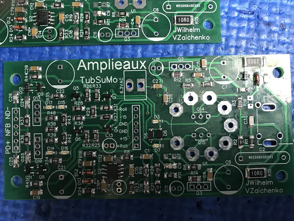

"The boards look beautiful, however I have to mention an important point - Q14 and Q15 placeholders are reserved for optional transistors (bjt or jfers). If you use tubes, those placeholders have to be empty."
I wasn't too sure since the J117 had traces to the tubes triodes pin directly. I'm happy you confirmed this. Just don't know what would be the point of using anything else than tubes here since it is called Tubsumo?
