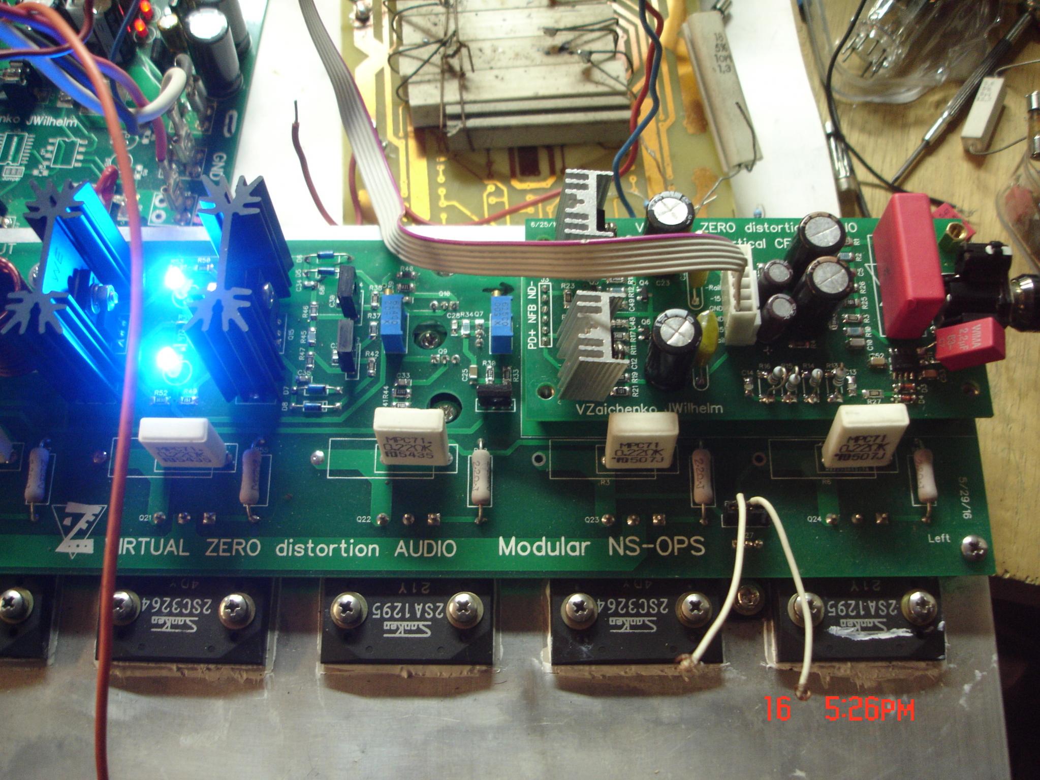

Hi Thimios,
I have ready to test the Vertical CFA and Tubsumo but I also have PCBs for AX-Deluxe and X4-VFA which will be assembled in the near future.
Do
Hi Thimios,

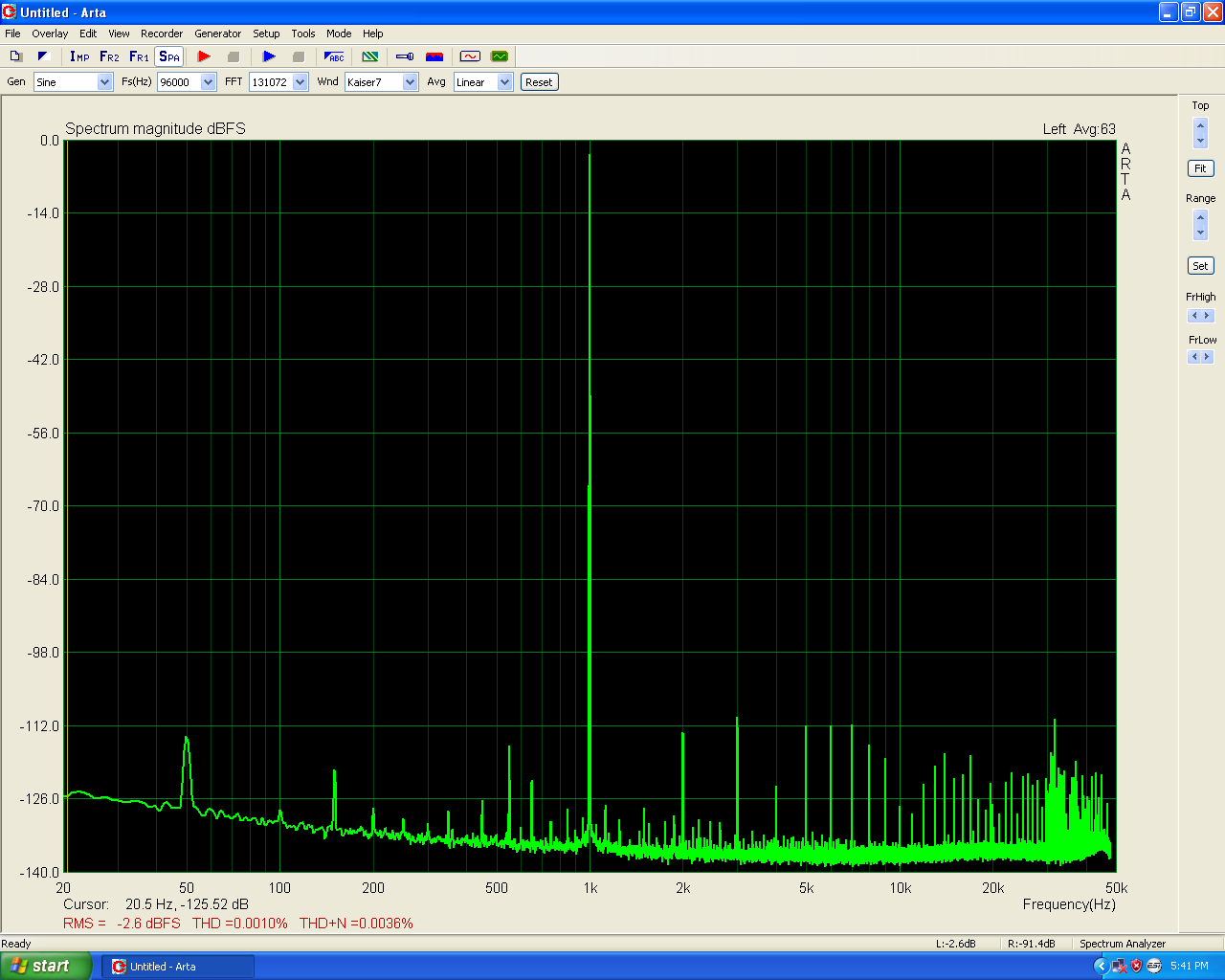

I Have a new test for this CFA IPS .
I wiII post results latter.
Very interesting!😎

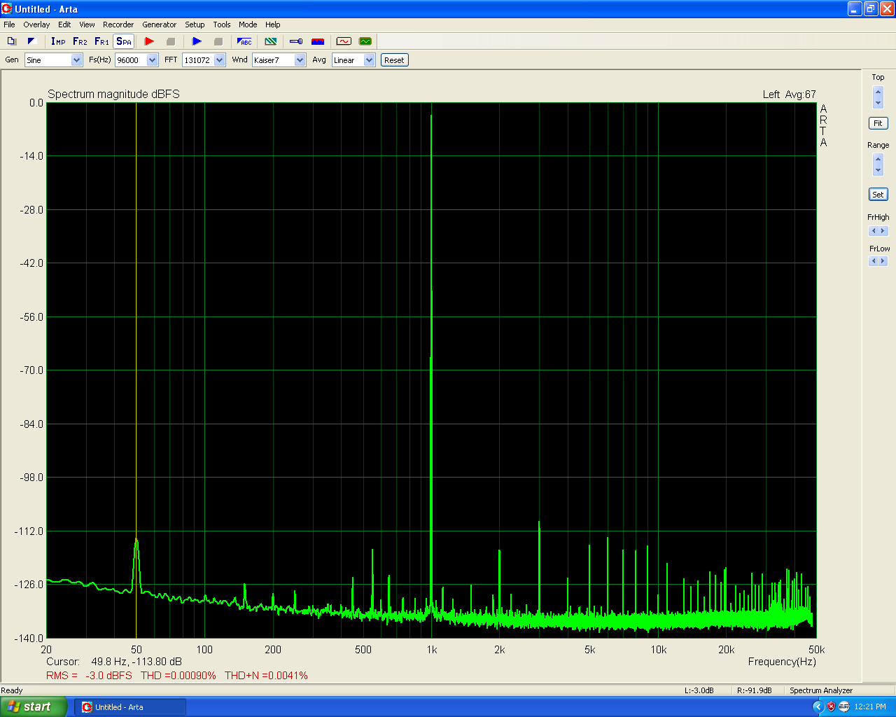

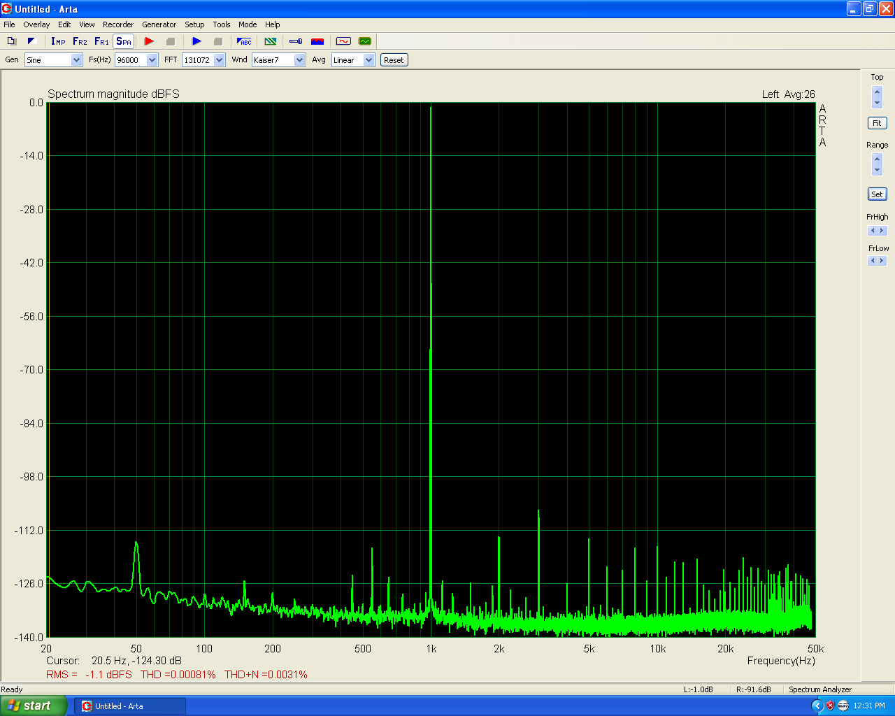

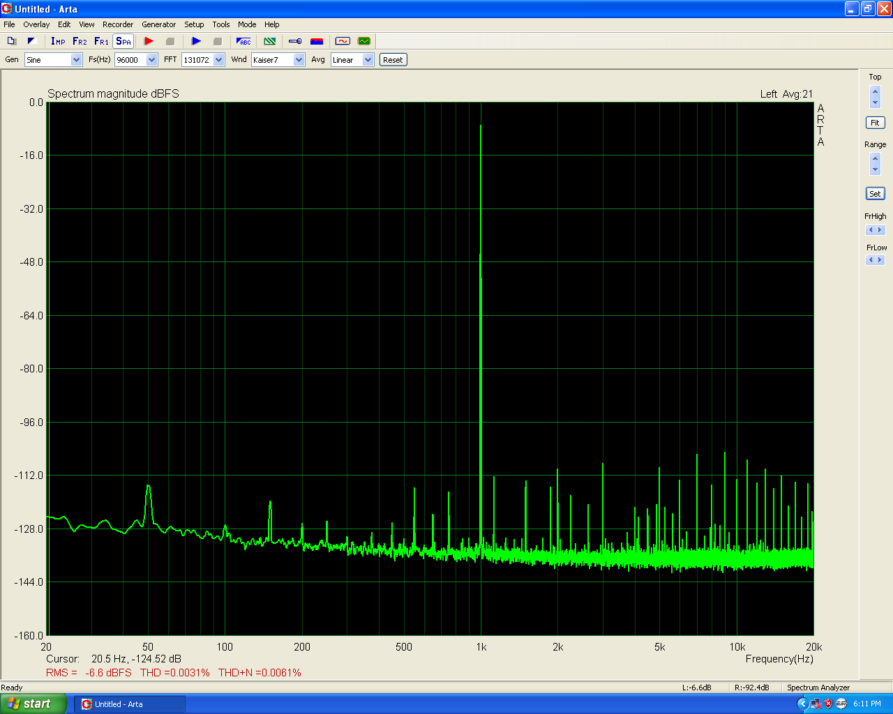

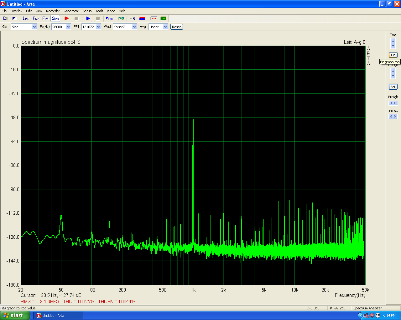

CFA IPS NEW TEST
Testing CFA IPS again.
+/-50V
15mv on bias testing leades.
75.000uf/Rail
6R dummy load
1)aprox 1W RMS
2)66W RMS
3)98W RMS
4)110W RMS
