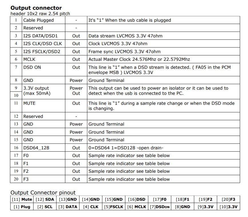

Here is the Amanero pinout (pin-5):
What sample rate DSD are you trying to play? What sample rate PCM did you try sending?

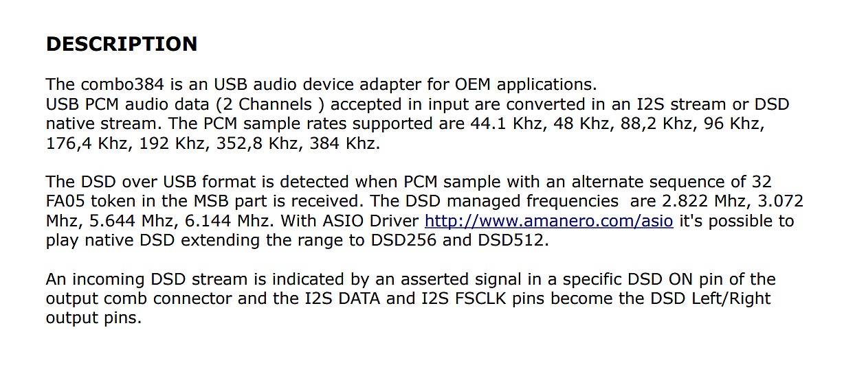

One thing I checked is that recent Amanero firmware does not allow passing DoP. You can see the option is greyed out below (when DoP is detected, it is automatically converted to Native DSD):

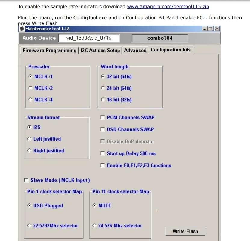

I have used this tool to flash the most recent CPU and CPLD software successfully and also flashed the configuration content.

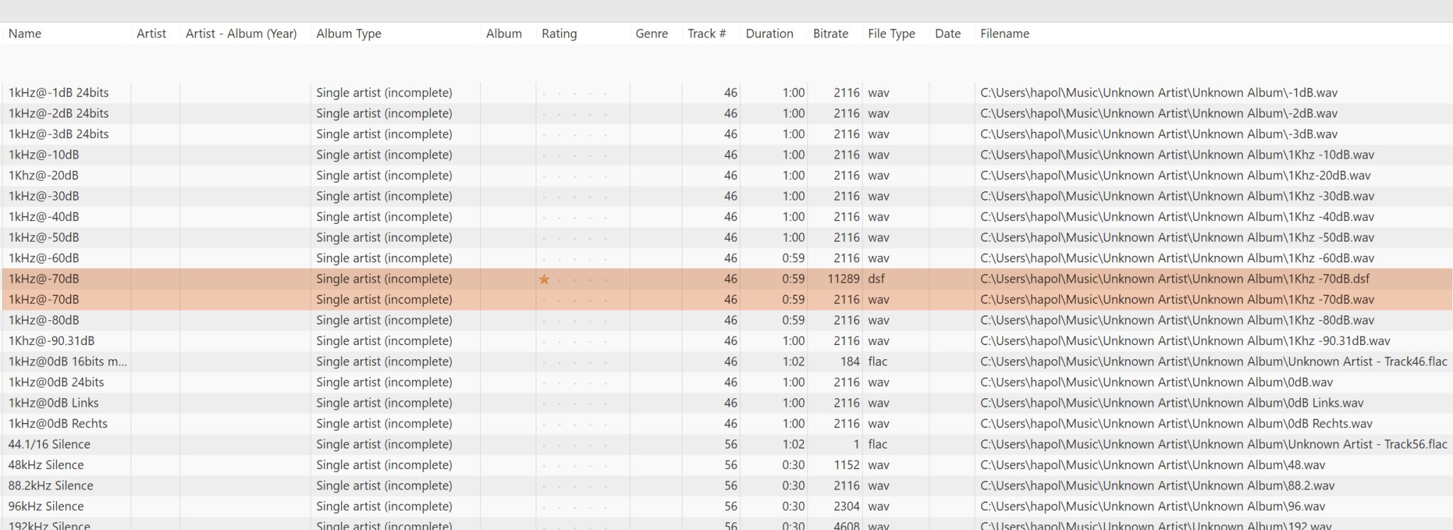

It seems that all input, either .wav or .dsf is converted to a clock, a framesync and a data signal.
See images below at the Amanero's output for a PCM 44.4 1Khz -70dB .wav input-signal and for a DSD128 1Khz -70dB .dsf input-signal.
Outcoming clock frequency for the .wav was 2.82Mhz and for the DSD128 .dsf clock frequency was 11.29Mhz
So, conclusion is that this is not the straight dsd that Marcel's Firdac needs.
Question is, how to tell Amanero to improve its nasty habbits.

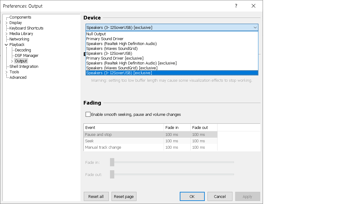

Some apps can convert DSD to PCM then send it to the dac. If the drivers are configured wrong then that may be what's happening.
Next things to do would be to see which Amanero driver JRiver is using, and also check the Amanero device configuration in Windows Control Panel.
Below is a pic of foobar device and driver selection (since I don't have JRiver). There may be multiple Amanero drivers that can be chosen. There may be parenthesis to indicate if it is an Exclusive Mode driver (such as seen below), or an ASIO driver, or Shared Mode driver.

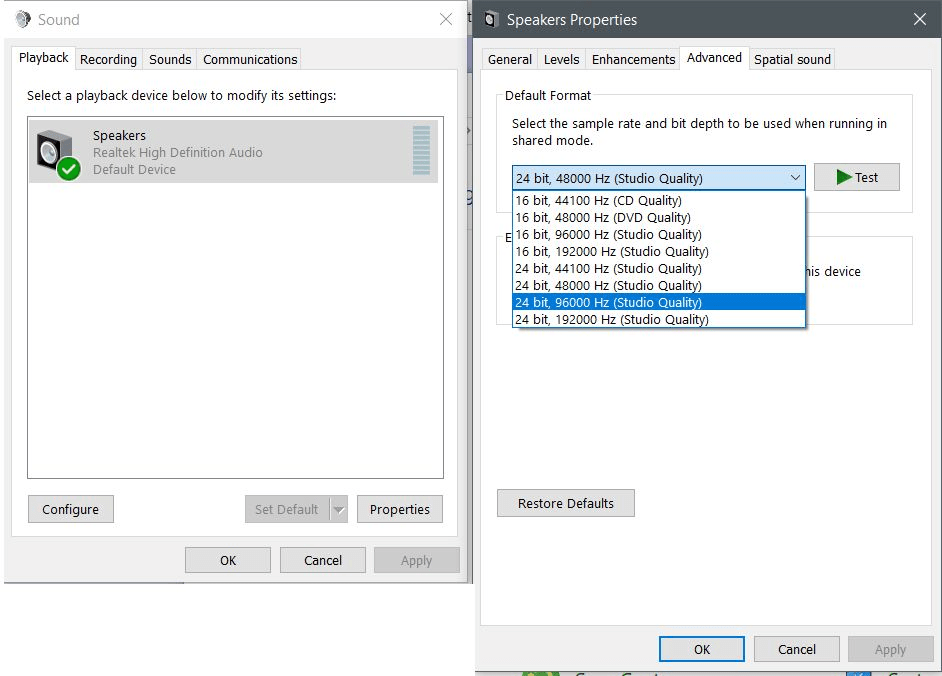

Also, in Windows Control Panel / Sound settings there may be a green circle with a checkmark for the Amanero, kind of like the one below:
