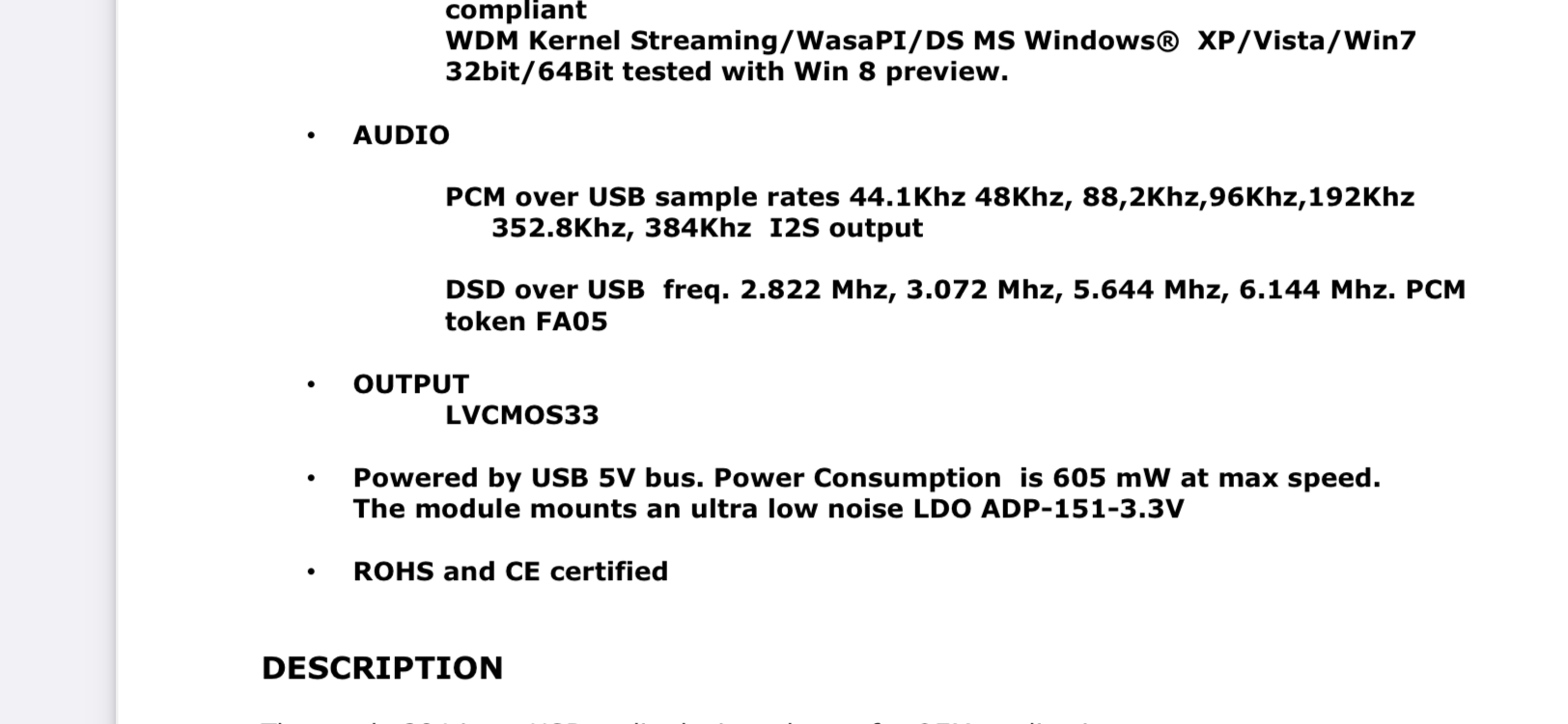

Having planned to test the shift register FIRDAC, just like I've already done with the 74AHC02 DAC, I have an Amanero Combo384 at my disposal.
I haven't yet at this stage attached the Amanero to the shiftregister Firdac, but I'm still in the preparation phase.
The test files being used will be played with JRiver, for which I have installed a Combo384 Amanero Wasapi driver.
When then trying to play a PCM .wav or a DSD .dsf file with the Amanero attached, it seems that JRiver sends the files just like that without error message.
Is that all there is, or is there extra software available to tell Amanero what to do?
And does Amanero an automatic conversion to a 1 bit format from a .wav file and into what DSD rate ?
It would be great if somebody having some experience with this Amanero board could give a helping hand.

DSD can be sent over USB in Native DSD format using ASIO drivers only.
DSD can be sent over USB in DoP format using WASAPI Exclusive Mode (in Windows10 and above, at least).
DoP requires twice the USB bitrate as compared to Native DSD. The usual PCM token for DSD via DoP is FA05 hex.
For each DSD sample rate, e.g. DSD256, it can be clocked using 44kHz family clocks or 48kHz family (11/12MHz audio clocks for DSD256). The original DSD was SACD, IIRC it used 44kHz family clocking. Hence, SACDs at DSD64/44 were clocked at 2.822MHz (bit clock is the frame clock).

When the upper eight bits of each sample alternate between FAhex and 05hex, the Amanero assumes the signal to be a DSD signal in DoP format and outputs it as raw DSD. That doesn't involve any conversion from PCM to DSD, just recognizing the marker and rearranging the bits.

I have connected the whole chain, JRiver, Amanero, Firdac and amplifier.
When I let Jriver play a file through the Wasapi Combo384 interface, either PCM or DSD, I can hear the relays click on the Firdac in both cases, but no sound is being produced.
So Muterel is obviously activated.
Some quick help where too look would be highly appreciated.

Hans,
I finish few days ago the FIRDAC with the PCM2DSD and st the first trial I face the same issue, the rlay click but no sound at all.
In my case I just misunderstand the note in the schematich and I don’t install R1, R2 and R3 that should be installed if you don’t use UFL

When I have problems like that with dacs first thing I do is start looking at scope signals. Have seen valid DSD signals going into a FIRDAC but no sound. In one case it turned out to be a DSD idle waveform going in, which of course produces no output. The other thing to check is the phase of any signal used by the dac that comes from the USB board. Sometimes MUTE and or DSD_ON may be inverted.
Indeed, this is what caught me out first off. Probably the most likely thing wrong.Sometimes MUTE and or DSD_ON may be inverted.
Also useful to check the voltages on the DAC outputs with the filter board removed, all 4 should be around 1.24v with DSD playing.
Also check supply voltage on the DAC shift register chips that it is around 4.96v, will indicate if the voltage reference is working (a lot of places for that to have faults I found)
In my case it was poor solder joints on some of the transistor pairs in the stack. It is possible to check the voltages down the stack and see where the sudden discontinuity in the progression occurs.
