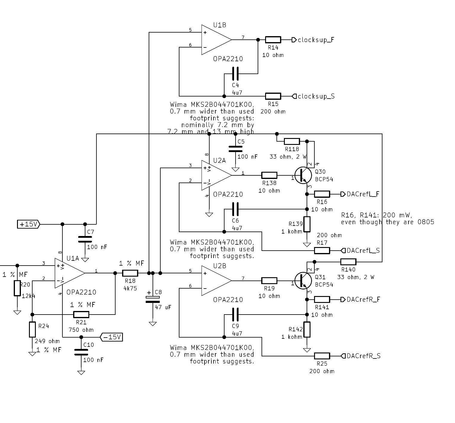

There are antiparallel diodes between the OPA2210 inputs (inside the OPA2210). Those could prevent the voltage from going above 1.38 V if one of the negative inputs doesn't go above 0.6 V or so.
For example, if the diode and 8.2 ohm resistor that replace R14 got loose, R15 and the clock circuitry may be loading the reference through a protection diode.

Marcel,
That's very unlikely because there is a straight connection betweem R18 and the three op-amps.
So when the negative input would prevent the positive input going higher than 1.38 Volt, one side of R18 would also have 1.38 Volt, but both sides have 4.98 Volt.

Yes of course also +5 Volt.Sounds like the right side of R18 has gone loose.
+/-16 V, and +5 V for +5Vd?

@marcel, It must be an internal connection from R18 to C8 that is blown, from thereon everything is o.k. for as far the 4.98 volt concerns.
I have made an external connection with a wire.
Going to try again now to get any output-signal

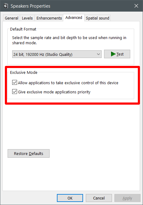

EDIT: Also, if using Windows WASAPI to carry DoP, it is critical that it be "WASAPI Exclusive Mode." Do not try to use "WASAPI Shared Mode." Thus is necessary to use a dac or USB board that comes with a WASAPI Exclusive Mode driver, and to select that driver for use in the audio player app. It is also necessary that WASAPI Exclusive Mode has not be disabled for that audio device in the Windows Control Panel > Sound settings for the particular audio device. The device settings should be as outlined in red below:

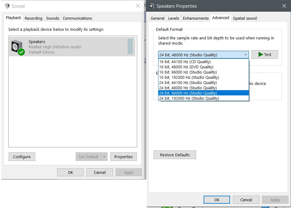

Hans, if you start trying to play audio from your player app then you hit pause, you may see a repeating "idle" pattern exactly the same on both channels. If you set the scope to a low enough sweep rate to capture the whole pattern you can see if its the repeating idle pattern. It may be "01101001" It should be on the I2S lines called DATA and LRCK, right? Don't remember the pattern exactly, but its obvious because it constantly repeats and there is no sound. In that case both channels will have exactly the same data and you know what it should be. If you start tracing from I2S bus, that pattern should pass through the whole dac producing a constant analog output voltage halfway between full positive and full negative.
What it will do depends on the particular dac and the status of the DSD_ON and MUTE signals. I have seen it cause audible problems in some cases....be sure that you are not sending DoP which if happened should lead to no sound at all, not funny and distorted sounds,
It is very true that the algorithms you use for upsampling and or PCM->DSD conversion affect the sound. Also, its is important that player app be bit-perfect. Not all of them are, maybe not by intention, but some do affect the sound when they shouldn't....the player software you use...
Its also important if using ASIO drivers for Native DSD, the sound device you use in Windows should have no green circle with a while checkmark in it as shown below. That's BAD. You should get rid of the green circle by assigning it to some other sound device you aren't using.
The above having been said, the particular hardware you use should have no effect on the sound at all. Why? Because computers calculate data. If the data is correct, then the dac should play the data the same no matter where it came from. If the data is correct and if the sound is affected, then there must be some other physical process sending information from the computer to the dac. Typically that physical process involves conducted and or radiated EMI/RFI noise. The fix is always to go after stopping/attenuating the noise, not to use different hardware and or a different OS that produces different noise. Different noise is still bad, even if it sounds a little better.
Forgot to say earlier than when looking for DSD idle waveforems, the sweep rate needs to be slow enough to capture the repeating pattern, and the scope should be set to Single Sweep mode so that the waveform is stable for visual examination.

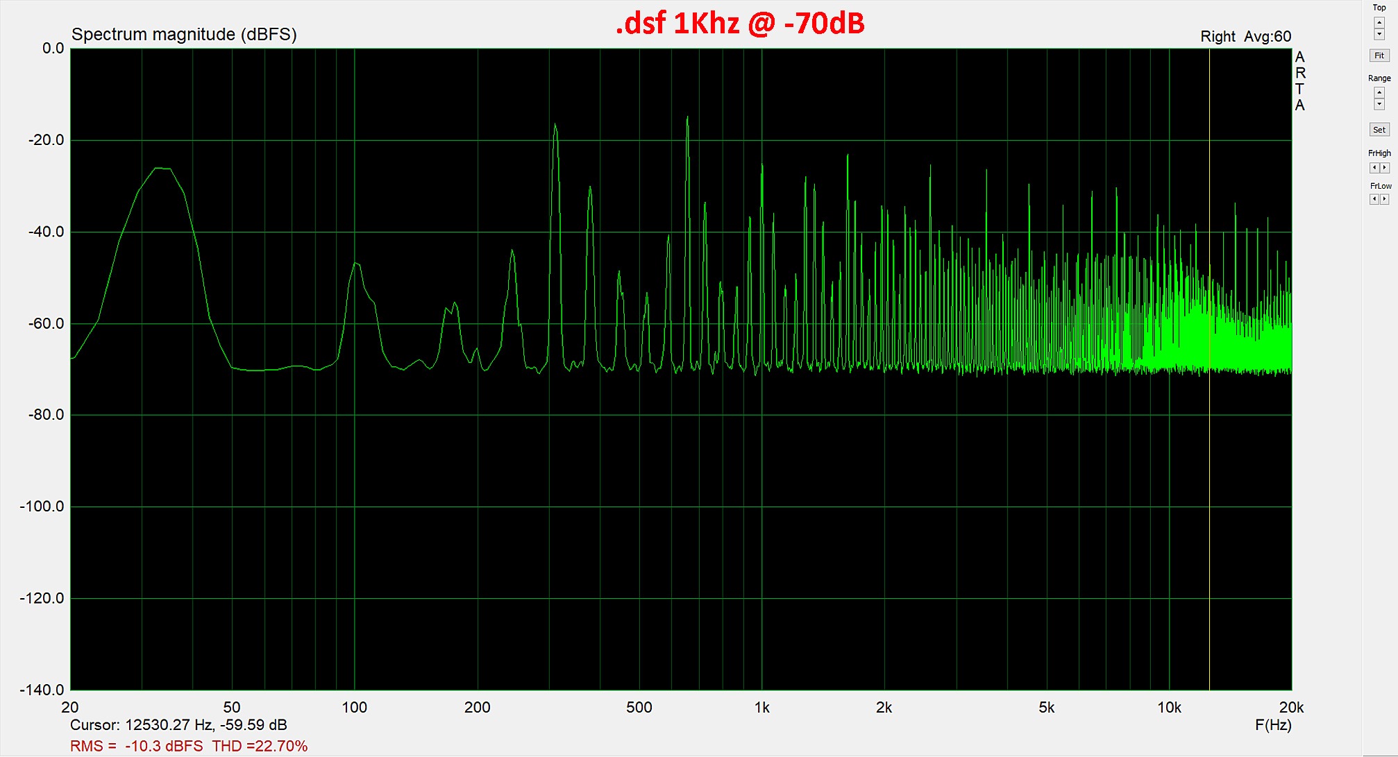

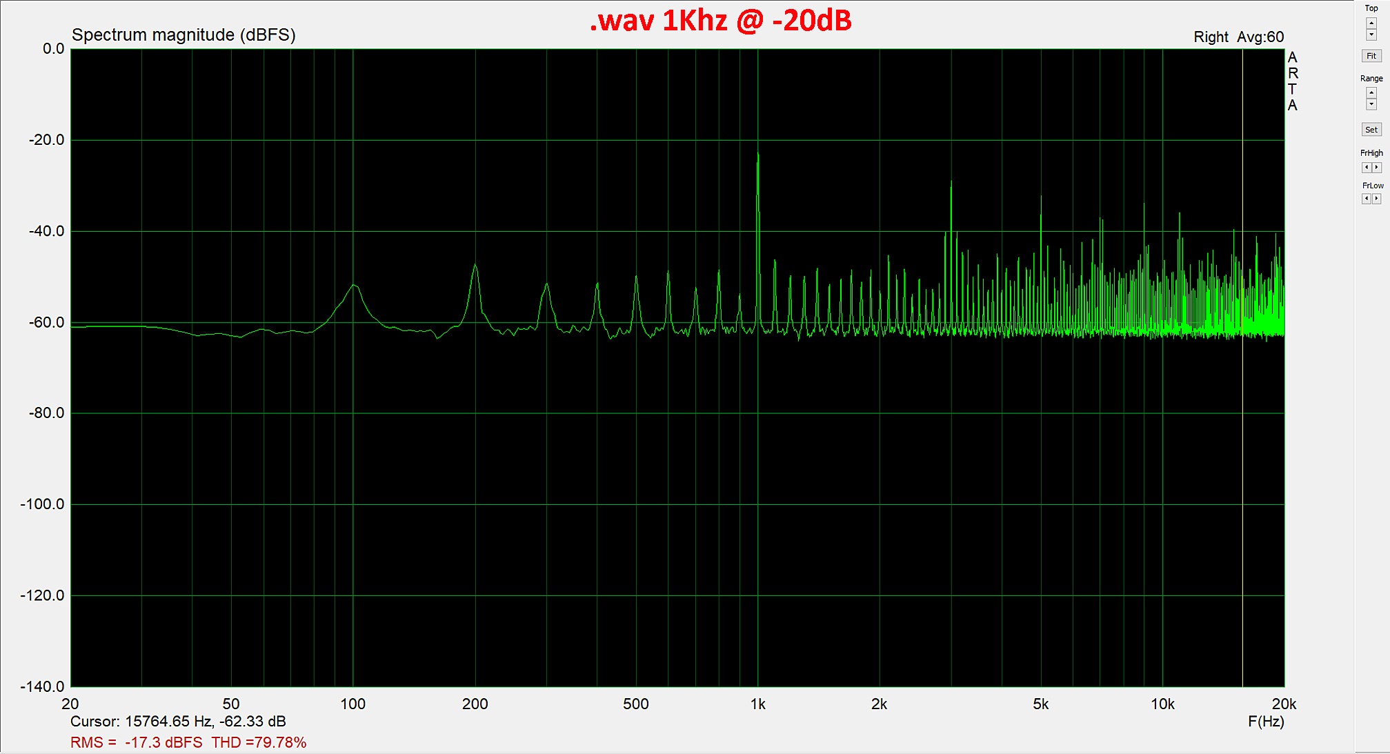

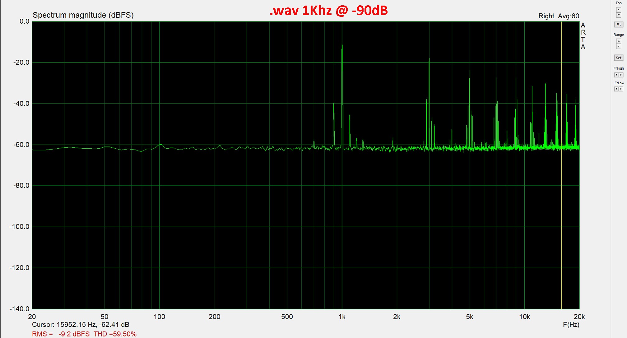

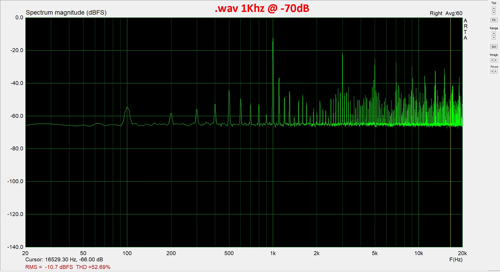

To give a better idea what's coming out, here are 4 spectra of resp 1Khz@-70dB .dsf / 1Khz@-70dB .wav / 1Khz@ -90dB .wav /1Khz@ -20dB .wav
No volume control in between, all signals have roughly the same peak magnitude, except -20db which is even weaker.
And PCM looks even better as DSD which is completely mad.
