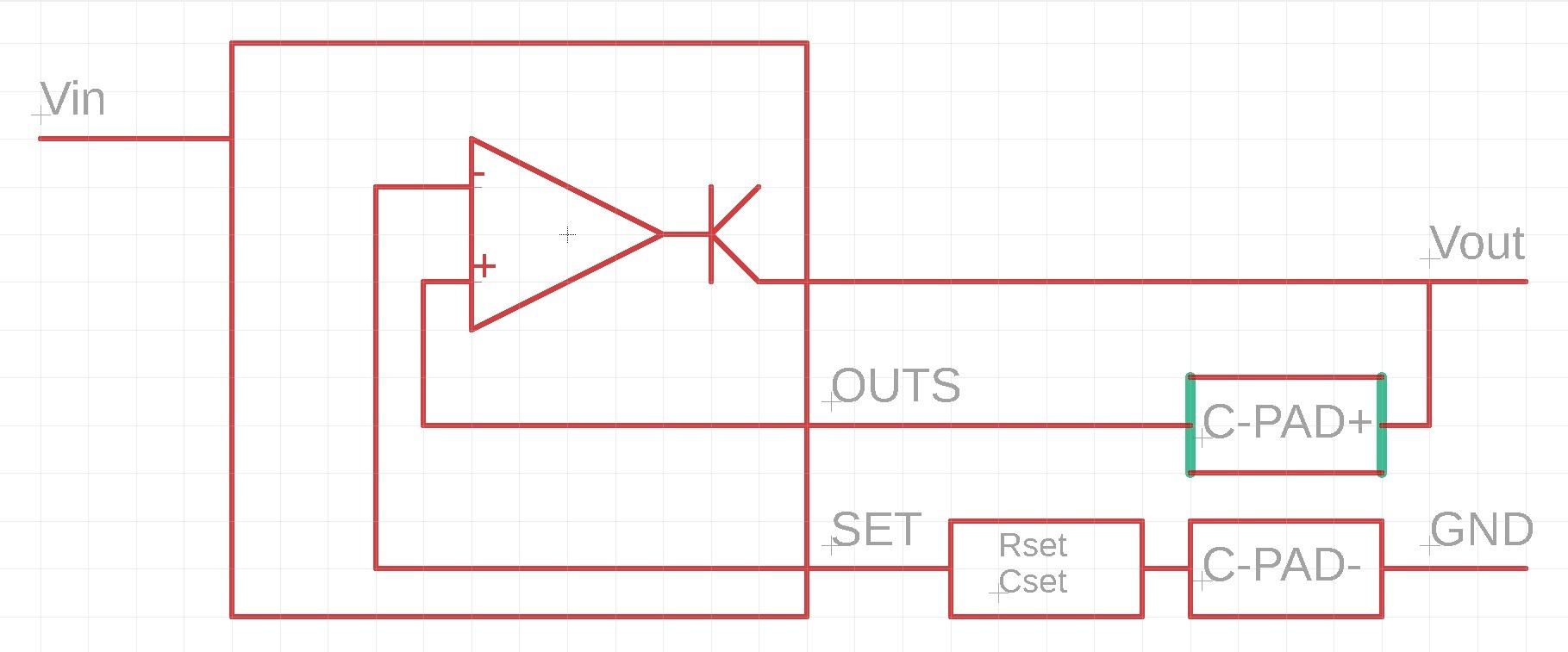

I want to show you a PCB layout technique - split cap - that I read about in the manufacturer evaluation board documentation Maybe you already know about it.
I don't know if there is any difference, or how big it is if exists, but their explanation seems reasonable.
To me a the main thing that stands out with that concept is the impedance change at the solder boundaries - by making the cap bridge part of the circuit it will have two impedance changes for the output. Less of a problem with low frequency but high frequency it will hurt. LDOs aren't really that good for high frequency ripple but still, in theory it could cause instability. Try it and test I suppose
Trying keep things simple but not overly so, IIRC a comparitor has a digital output. We are probably talking about an 'error amplifier' here?...the comparator...
Hi NickKUK,
The impedance changes don't affect the output directly, but both positive and negative inputs to the comparator.
Other say, both Cout pads are in the INPUT circuits, not in the OUTPUT.
However the split pad is across the output? I just looks like the cap solder joint spans a gap on the pad that the output must traverse and the input (essentially the output tap on your diagram) - hence you get a solder transition on the output and the cap input. Hard to see and I may be wrong in that observation. Either way for audio not a big problem.
As in the simplified schematic above: the input only to the IN+ of the error amplifier (thank you Mark for correction) goes through the Cout pos. pad, but there is no any Cpad through the output.However the split pad is across the output?[...]
Actually you are not wrong, there are no pads, but vias are, so the effect you said is almost the same, maybe smaller. Anyway, there is nothing perfect, so we have to learn how to manage the side effects.

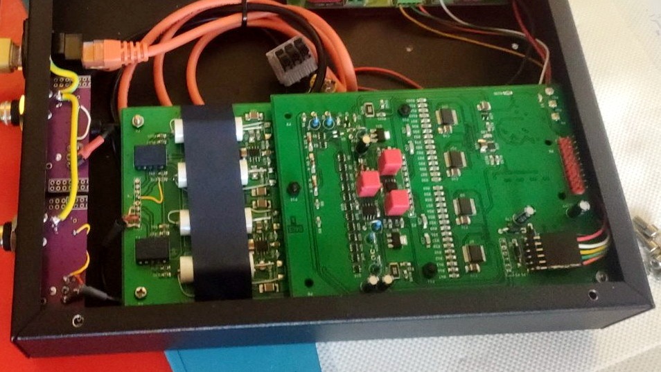

I populated one of the simplified filter boards today. I'm not able to test/audition it yet as I've lent my power supplies to the friend. I soldered this board using a stencil for applying the solder paste - I wish I had done it before as it makes the process much easier/quicker and, of course, you get just the right amount of paste for nice solder joints.

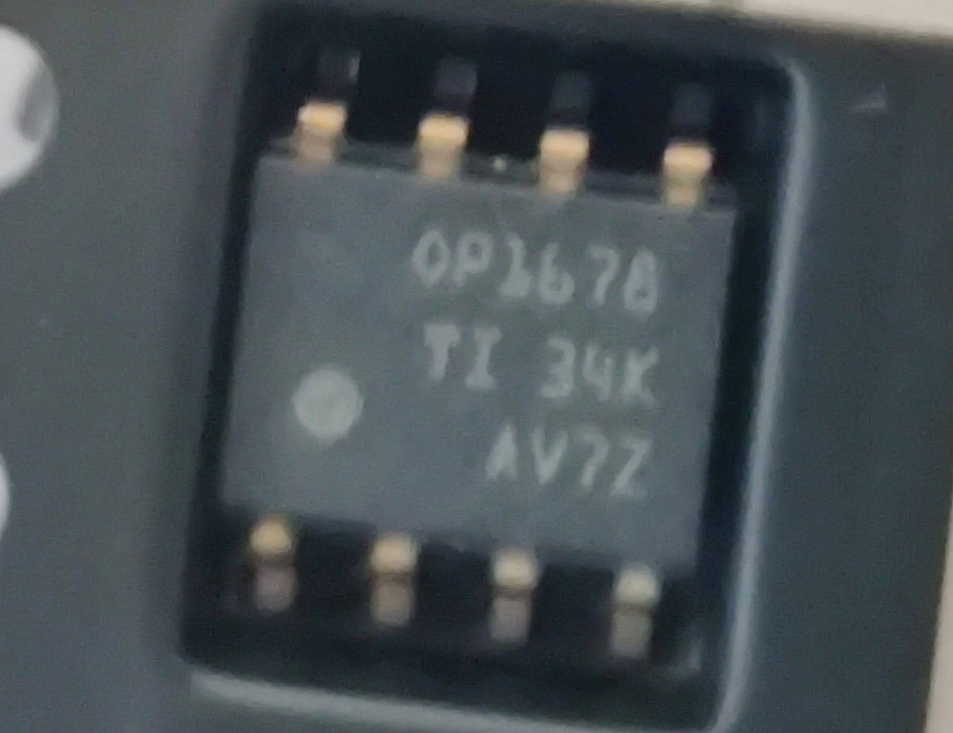

During this I also took some microscope photos of the opamps I have sourced and used on this DAC, the filename of the photo reveals where from I got them.
I have to say that every one sound better of NE5532 to my ears even if it is suspicious for fake, you can judge from the photos below and comment on genuity estimation.

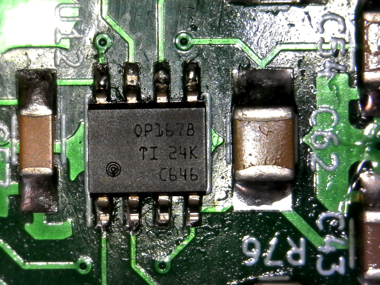

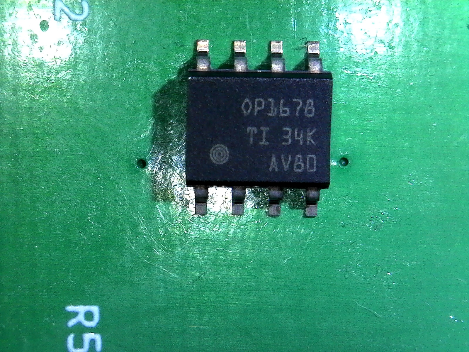

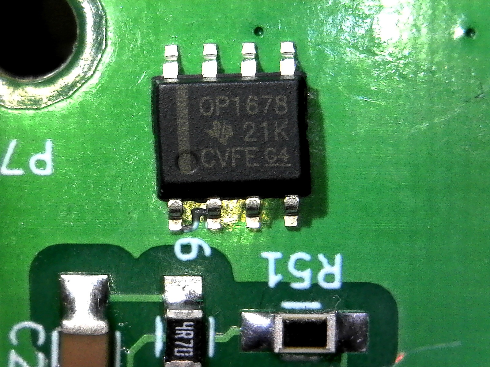

I did the same thing as you, got Ali Express, LCSC and finally Mouser.During this I also took some microscope photos of the opamps I have sourced and used on this DAC, the filename of the photo reveals where from I got them.
I found the ones from Ali and LCSC not so great. The Mouser ones are excellent, leading me to believe those are the only genuine ones.
Mouser:
And just received (from Mouser):
