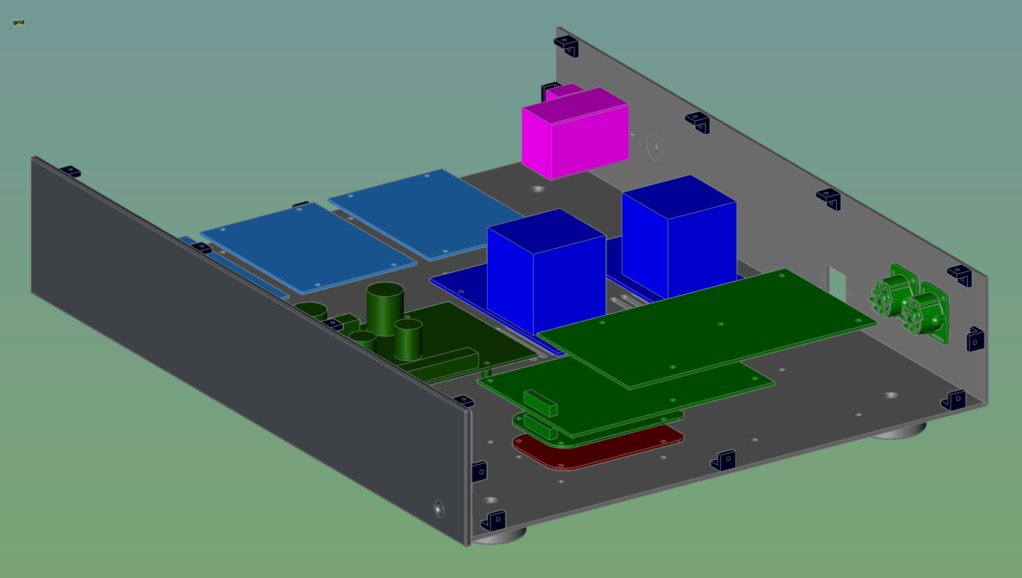

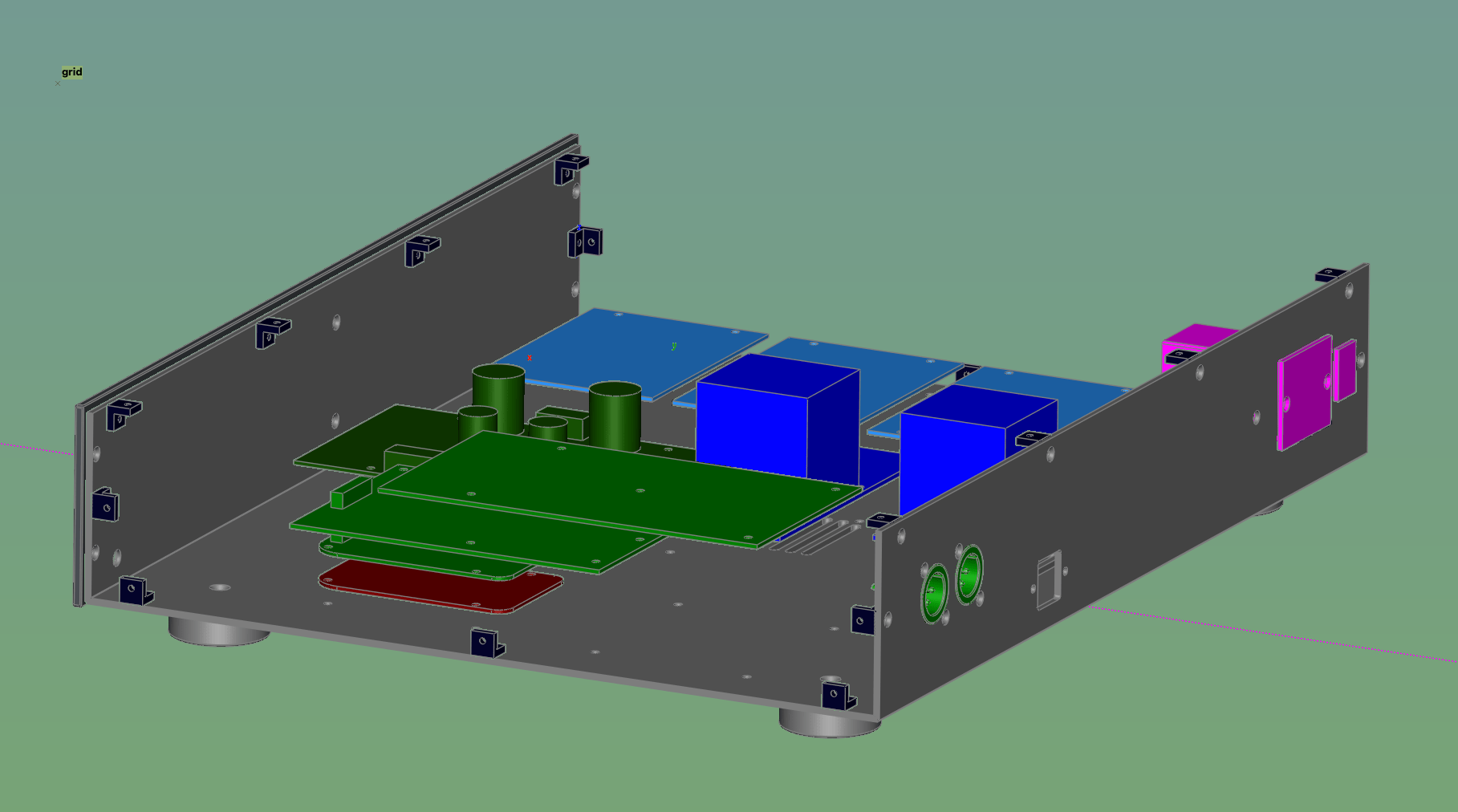

I thought I would update this thread - I've been a member of diyAudio for a while but not contributed much to it. I'm the chap that nautibuoy has been very kindly building RTZ boards for, and I currently have his breadboarded build which combines my built-up RTZ boards and a DSD'it that I bought from him, together with his power supplies and Beaglebone.
I'm mainly a vinyl guy but I really wanted to try and get my digital front end sorted properly, as good as it could get within reasonable cost parameters. I use Roon so this solution works perfectly for me. The sound is absolutely first class, it's time to build this into a chassis, put it in the rack, power it up and job done - digital is now sorted and I can focus on my mad phono stage projects.
Most of this weekend has been spent measuring the various PCB's and laying out the chassis in TurboCAD to then be transferred to Front Panel Designer for Schaeffer AG (Front Panel Express Euro-side) to manufacture. I've used Schaeffer many times for my projects before, they are not cheap but the results are so good that I continue using them for my chassis work - I wouldn't be able to do metal work if my life depended on it!
Power supply-wise, for the digital side I'm using some boards I purchased from nautibuoy for another project, since abandoned. Acko Super Audio PSU provides 2 x 5V to power the Beaglebone and its DSDit cape. Then a Salas Reflektor-D for the 5V digital supply to the RTZ. Finally an AMB sigma-22 which I had spare, will power the ±15V analogue circuit. I've used the sigma-22 everywhere in my system - it also powers my Pete Millett LR phono stage, and two of them power my Bruno Putzeys Balanced Pre (one for each channel). Incidentally, @Hans Polak you may be interested in this thread https://www.audio-talk.co.uk/phpBB3/viewtopic.php?t=8373 where I combined Bruno's linestage design and your relay modification, with AMB's 'LCDuino' control system, into something that looks a little bit like a Quad FM4. It works beautifully by the way, and sounds amazing.
Back to the RTZ - here are some screenshots from TurboCAD showing how the chassis layout will look:
