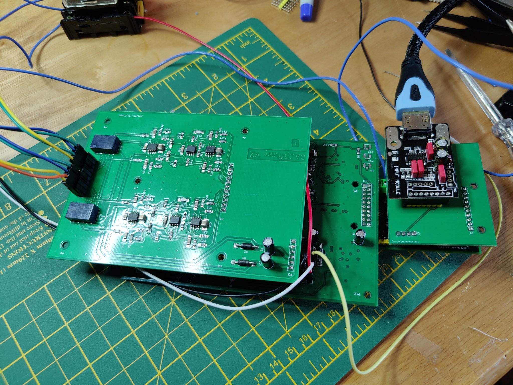

RTZ DAC no2 with Ray's version of the filter board with the last stage removed:
Also, LVDS receiver board mounted on my own daughter-board to hook up to the PCM2DSD below. This DAC is being fed from my Logitech Transporter via LDVS.
