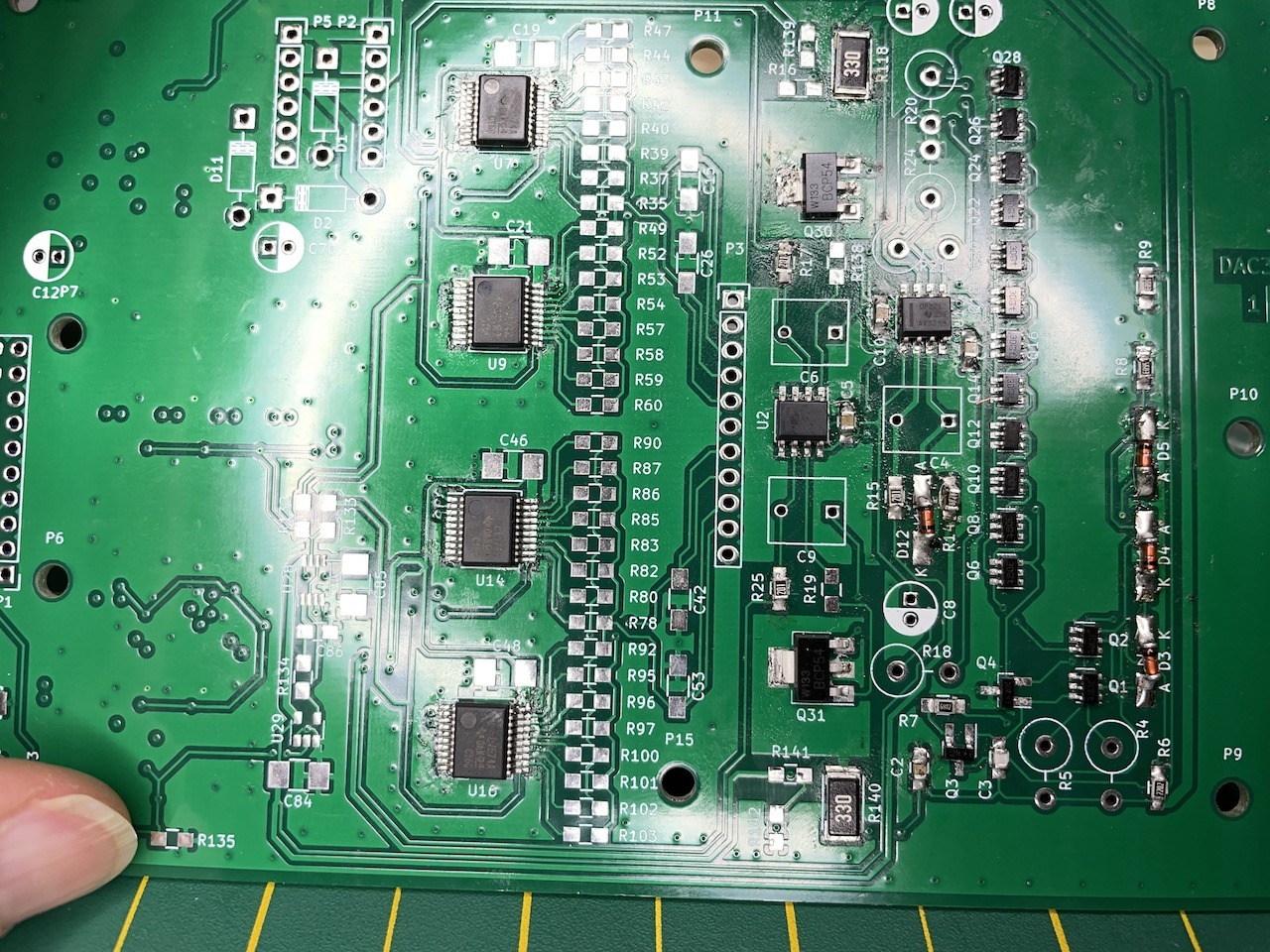

A little more added - some of my resistors on this board are also backordered along with the OPA.
I use my own method for soldering the chips to the pads - I use a small dollop of paste on each corner pin, position the chip and then put the iron next to the dollop allowing the heat todo the work to soldier the corner pin without moving the chip. I then do the same with the other corner. Next I put a very thin line of paste alongside the pins then use the flat edge of the iron to drag along side on the solder pad - leaving the capillary action to draw the solder between the pad and chip pin. After I have done both sides I re-apply heat to the leg to ensure the solder joint is both the pad and the pin.

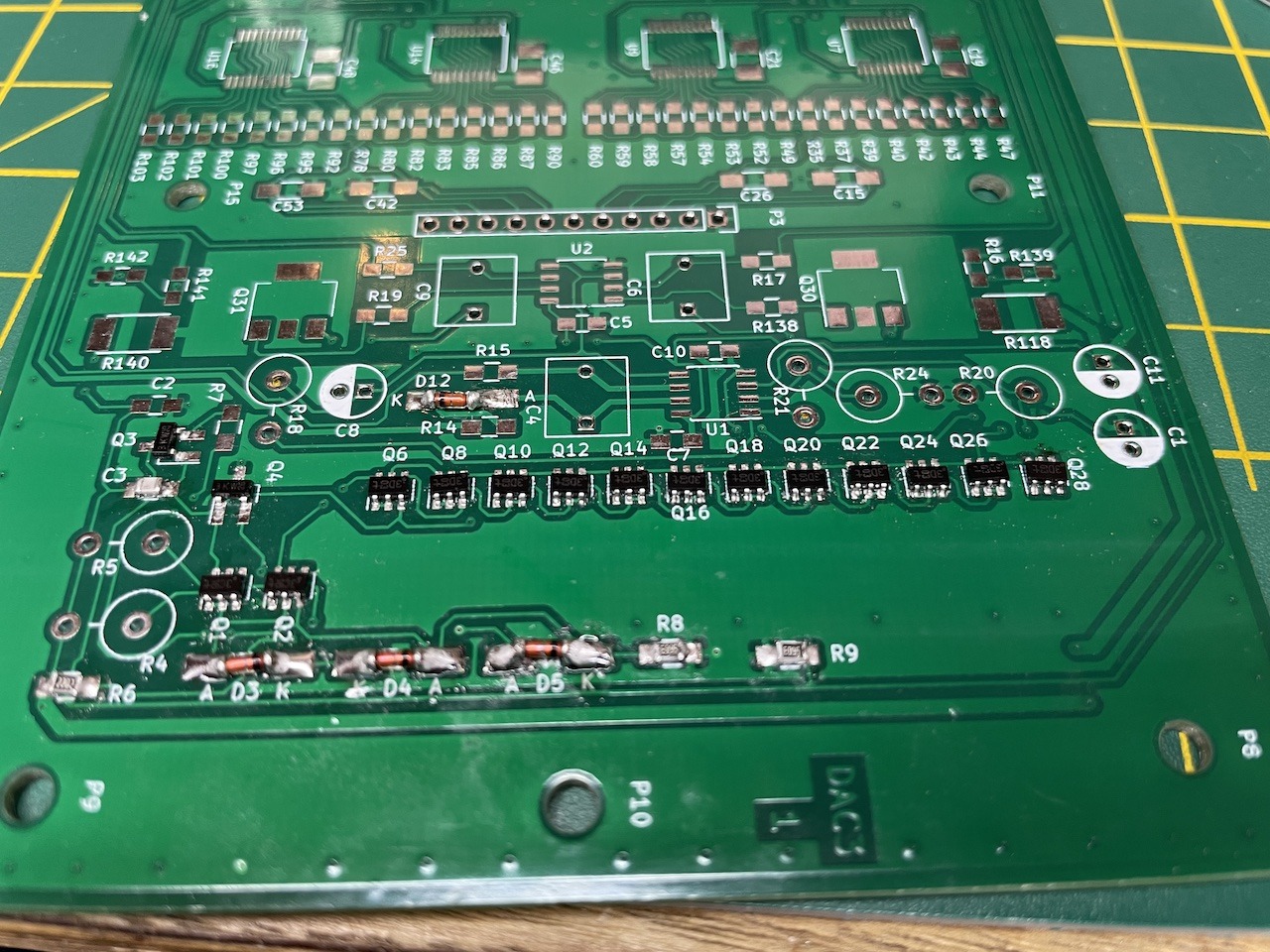

I corrected D4, and the SOT23s I found easier with the larger iron head (after this photo I neaten up with the large tip on. I'm only using an unregulated 25W antex iron, so it can be done you just have to understand that big pads/pours will suck the heat away quickly. Just be careful of a hot iron a going into the centre of the paste, the flux then sprays the molten paste, instead it's better to edge up to the solder and let the heat warm through it.
I'm leaving the big components so I can flip the board over and it will stay flat.

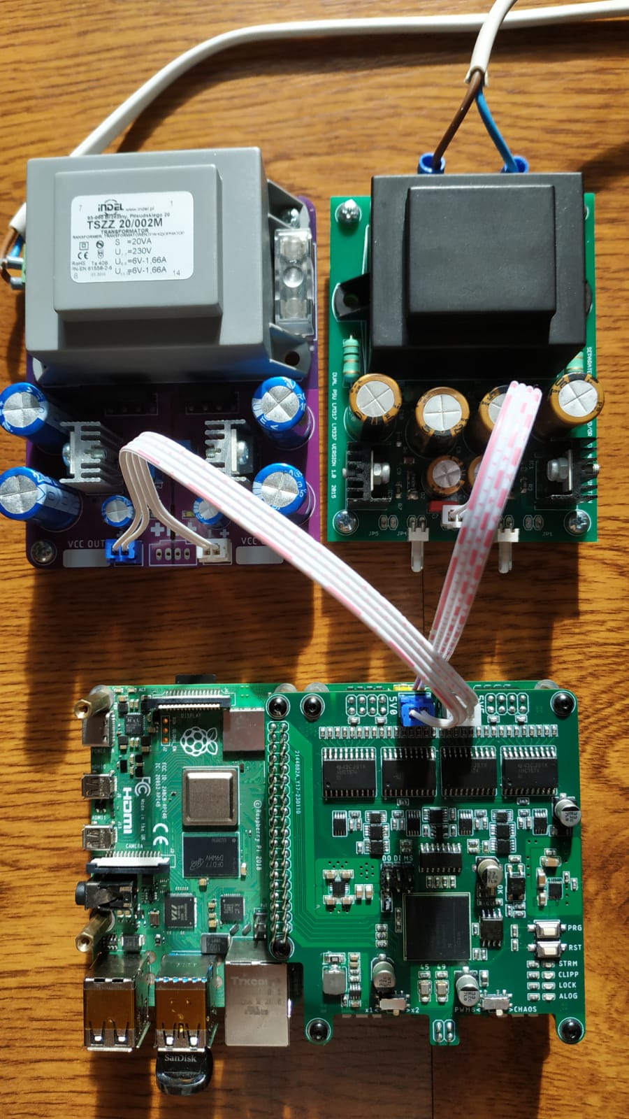

I just finished the lite_for_RPi vesion of this RTZ FIRDAC and even if it is a downgraded variant (no ref. voltage circuit, but only an LT3045 based power supply) it still sounds amazing.

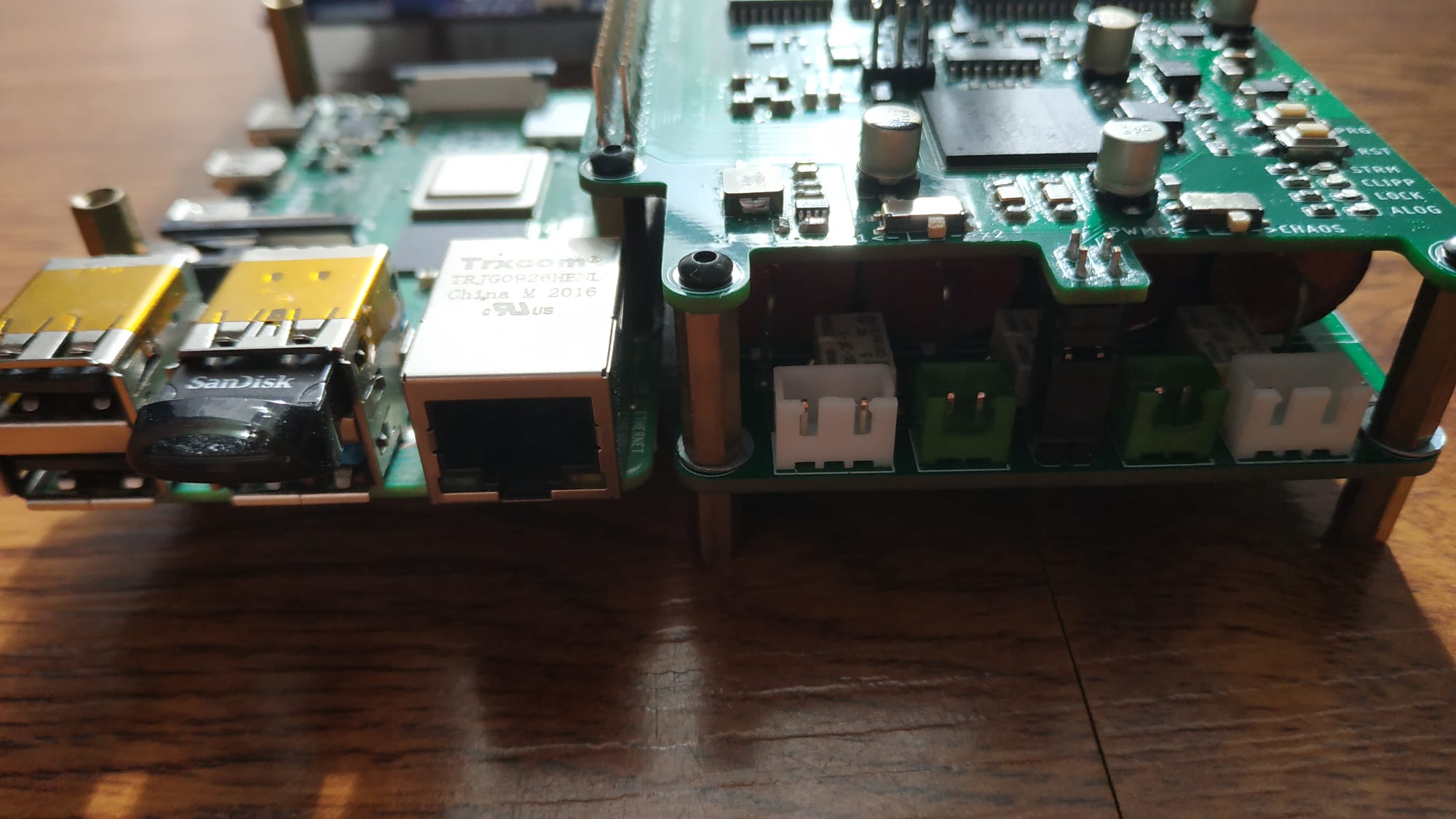

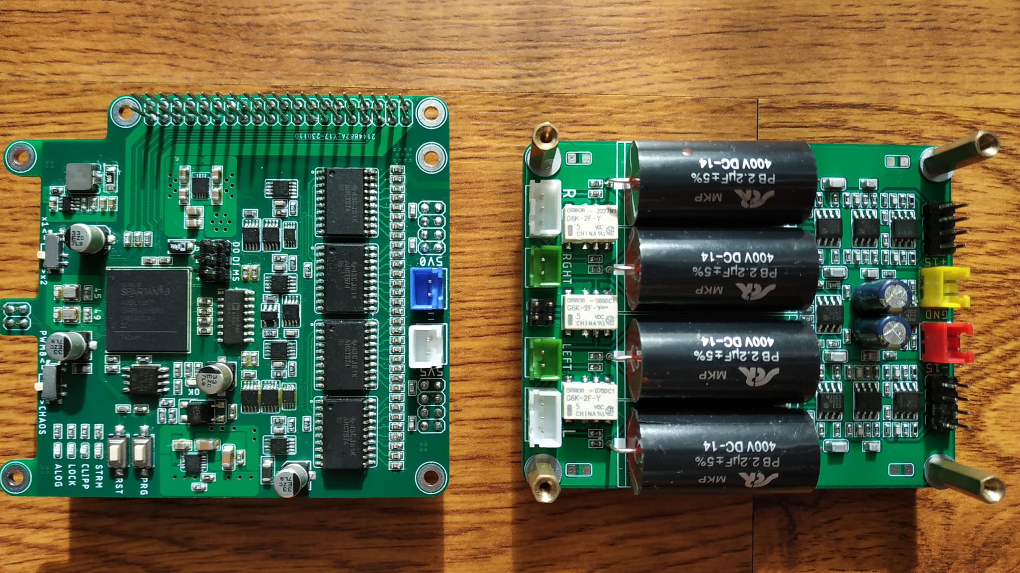

Yes, it is a modified variant.
@ digital side - I replaced the voltage ref. you designed with a simple power supply, due to the space limitations, so this is the biggest downgrade.
I also replaced 1x 74AHCT74 (U20A+U20B) with 2 x 74LVC1G74, and used an FPGA (as I2S master for RPi, 256x interpolation and SD modulator) on the same PCB..
@ analog side - I didn't had 2 x OPA210 so I replaced them with 1 x OPA2210, replaced OPA1678 with MUSES8820, added a diferential to single output stage and used different mute relays and circut.
Not sure about the prefered mode yet, I need more listening time. 🙂
I have the cheapest reflow oven in the market, T-962, which is good enough for a hobbiest. Had no stencil, so fpga was soldered first in the oven and the other parts later by hand, using soldering station and heat gun. I spent about 2 hours to solder 0402 size caps, 18 pcs. only, on the bottom side, below fpga.🤓
