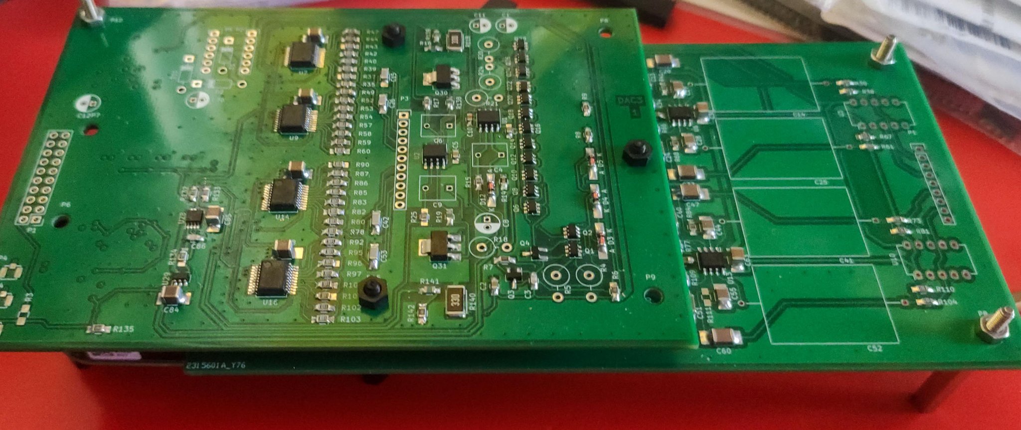

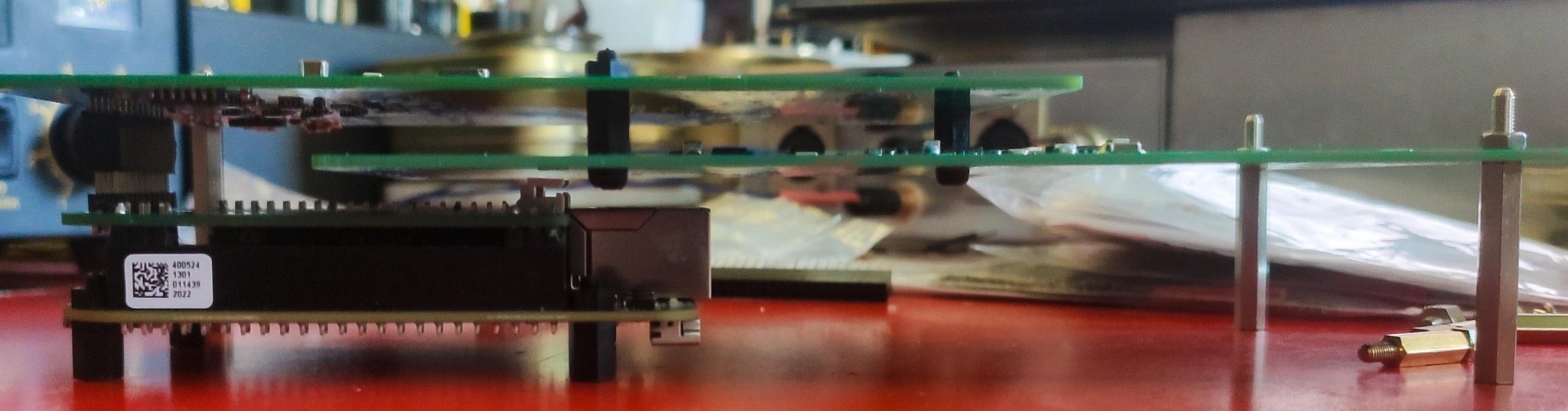

Would you suggest against of the arrangement I am trying, where the DAC PCB is on top of DAC-Filter PCB ?
I am planning for DSDit on a BBB as input and I would like to stay under 50mm total height.
I have kept the clearance between the PCBs at 10mm.
I understand that the proposed arrangement keep the digital part away from the analog as much as possible.
I have also attached a PDF that can be used as a hole punching template if printed with actual size option (not fit to paper).
