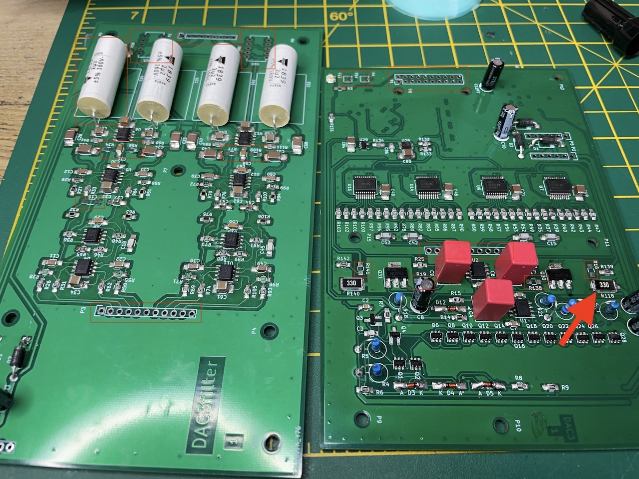

One cap made a bid for freedom, I heard it bound off the keyboard on my lap.. so it's lost at the moment. I have two sets of resistors on back order along with the unobtanium OPAs. I found a solder short under one of the 330R resistors so I had to remove and resolver that. I'm missing some connectors (I know I didn't want to get them until I knew the height for clearance required and I only ordered 1 but not 3 of the RF connectors. I still need to source and fit the relays (Farnell I believe) plus one an extra power connector. I tested the Vishay axial caps on the scope after I fitted the first and decided they are less noisy the other way around so I need to adjust the odd one (I put the more noise sensitive outer side towards the audio side).
So I still have a way to go before first power up.

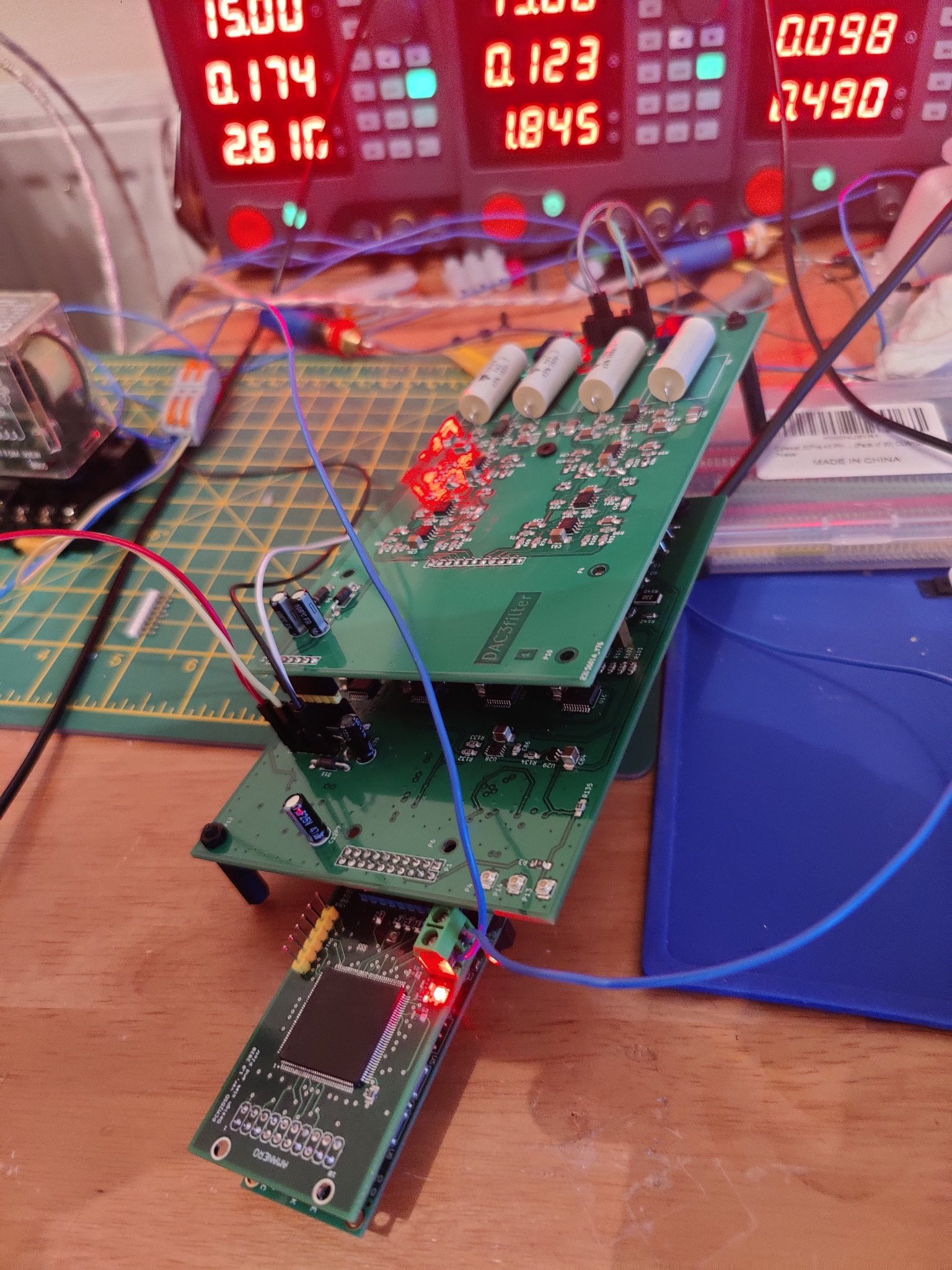

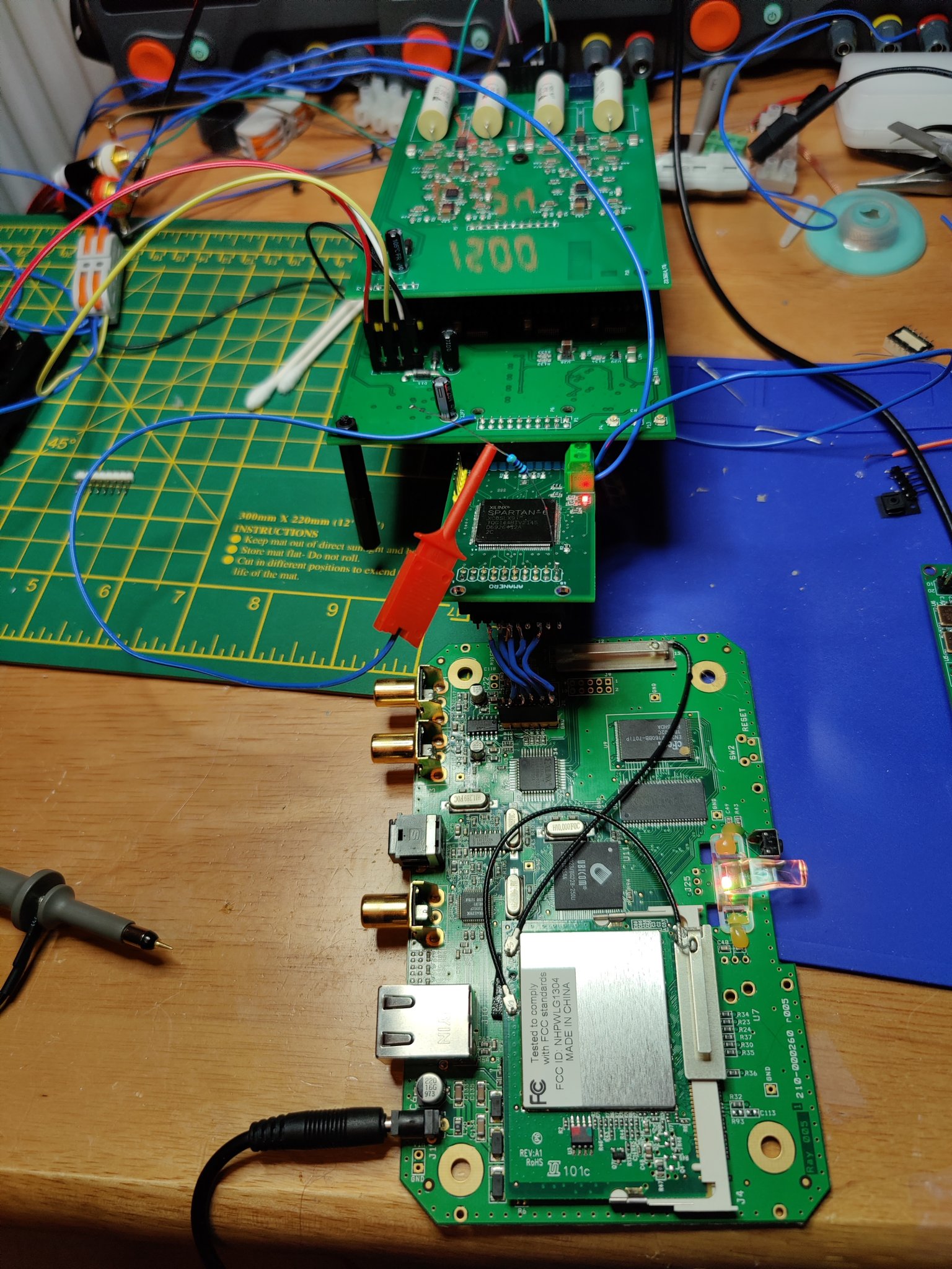

At the moment I have the RTZ DAC and PCM2DSD connected to a spare SB Receiver, still on bench supplies. I can't find a "mute" line anywhere on the SB to tap into however there is absolutely nothing bad happening when I switch tracks or sample rates so I have the mute defeated here, hence the hasty bodge of the resistor!
It is sounding fantastic though! It has the edge over my TDA1541A I reckon. Bass is much better, everything feels more dynamic and the soundstage is amazing. I'd hoped that wouldn't be the case but there you go. Lot's to learn and you don't know if you don't try!

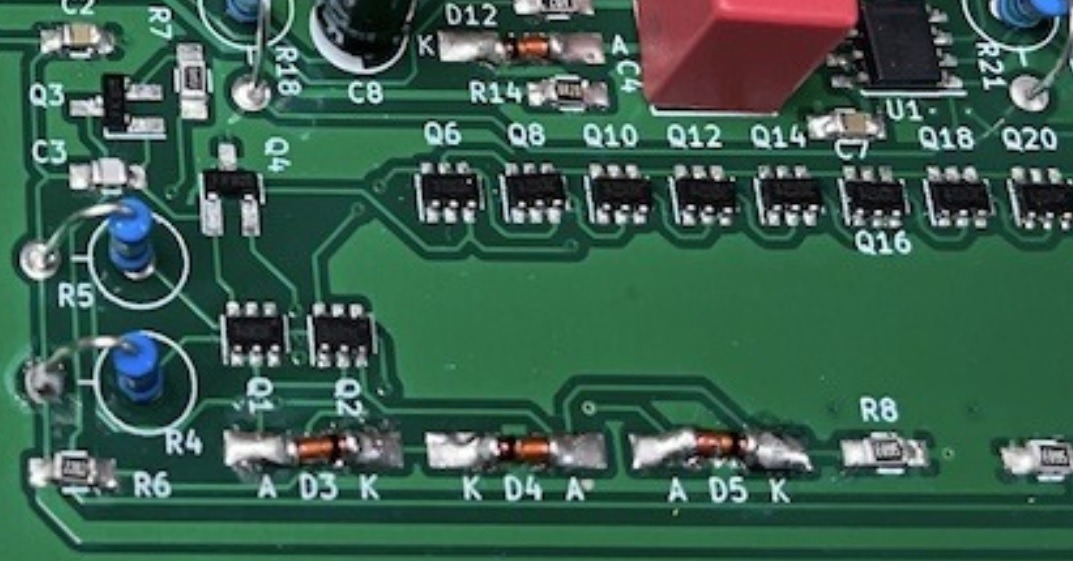

What are the pink lines bypassing R115 and R119? Edit: Ah, I see, you're just defeating the mutes.
From the voltages you have it looks like there could be a problem around the voltage reference, Q6A/B, etc. I'd think those voltages at the top of the stack are too high.
It's indeed a problem in the voltage reference. The voltages at the top of the stack should be about 7.something V and the voltage across R20 should be about 1.24 V.
Are any of the double transistors mounted the wrong way around or not soldered well?
14.36 around Q6 is mistyped, sorry.
Q10 is soldered rotated 180 deg., wrong.
I will fix it and post back.
Do you use hot air or a classical soldering iron? Desoldering with hot air and tweezers is straightforward once you have figured out how much you have to heat up the dual transistor and its surroundings.
It's not so straightforward with a soldering iron, but there is some trick with special low-temperature solder. I never used it, but @acg did on the valve DAC thread. If I remember well, he managed to desolder 80 pin SMD connectors with it.
As these dual transistors have only six pins, maybe you can heat all pins up simultaneously with a soldering iron and some improvized metal heat spreader. I don't know, I never tried.
Solder wick is great for removing shorts or cleaning SMD pads once the components are removed, but when I tried to desolder SMD components with solder wick, usually the amount of solder that the wick didn't suck up was enough to keep the SMD firmly in place.
Yes, the low temp solder heats easily and stays warm for a long time making it easy to remove many pinned connectors.
If you have a spare Q10, I'd cut if off at the legs. Then its easy to remove the remnants of the legs left on the pad, and install a new part.
