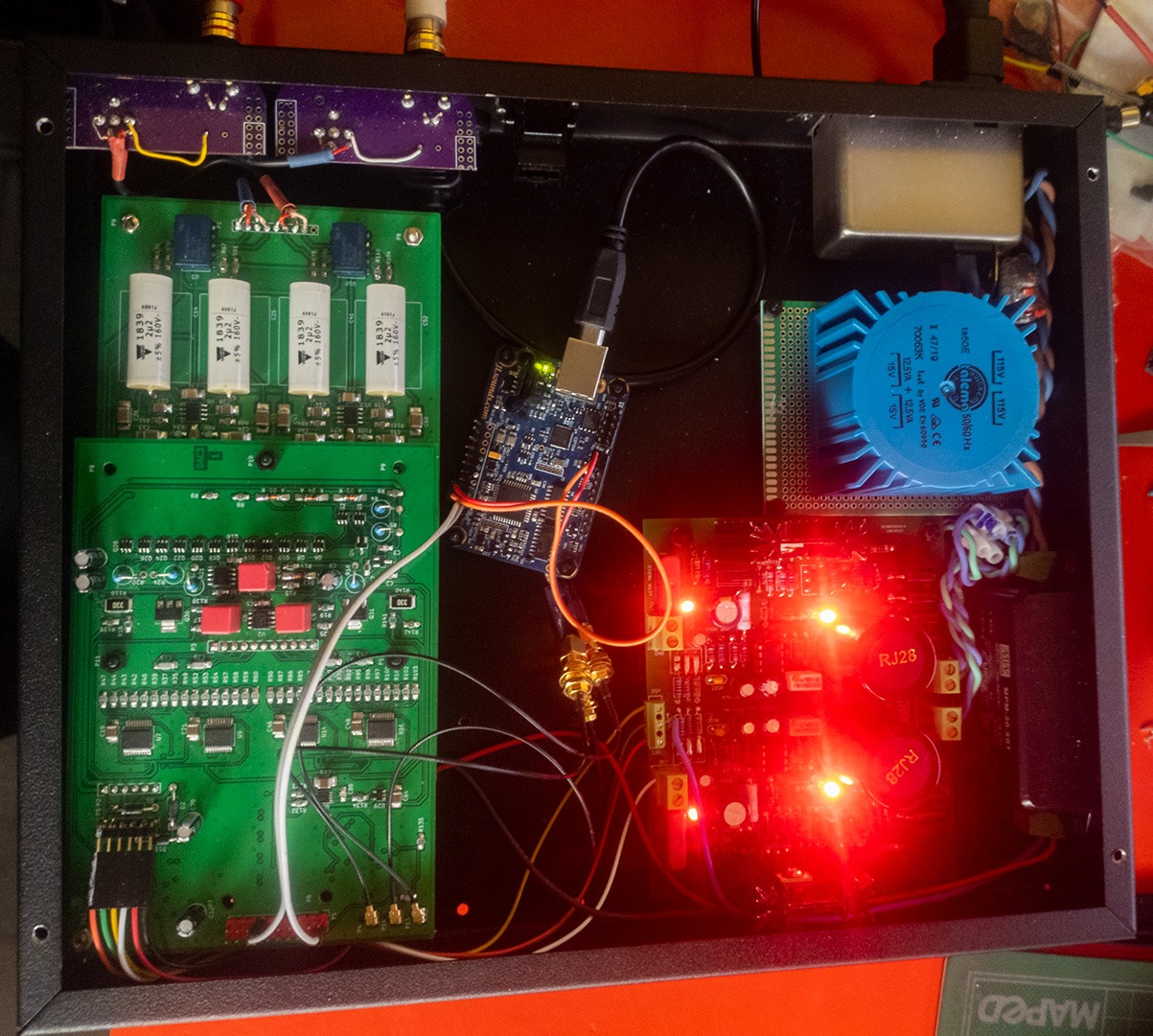

Well, it works, without any major fault from my building skills.
After some fiddling with the USB interface, I have beautiful sound coming out from both channels.
Soon to be converted to Ethernet input after finishing the DSDit II board, (another challenge for me definitely).
I am excited with the sound of it, DSD Valve DAC will have a hard time comparing with it, for sure, but I leave that for later.
A small issue I face is that the Right channel's output is phase inverted and I cannot see why.
Did anybody had a similar issue?
Great respect to the designer and a thank you to the organiser of the GB.

Please note that only one channel's phase is inverted. (I have concluded that it is the Right channel but I'll investigate it further tonight).
Anyway I have connected the wires reversed pin2<->pin3 on the XLR socket and OutpN to the RCA center pin on the Right channel for now.
This way the problem is bypassed for now, the absolute phase remains to be checked but it is more important to find why this happens.

I don't see anything in the DAC or filter schematics that could explain it. Filter board connector P1 pin 2 should be left positive and pin 6 should be right positive.
If with your question about the input you mean where the signal inverts, I can't see any point of possible inversion and this is the reason I am asking. But you are right, I should disassemble the DAC PCB from the Filter PCB and trace the signal, before this I am asking for some guidance for suspect points, if any. Thanks for answering.

I am struggling with another issue which I cannot solve, so asking again for some help.
I have 2.5dbV difference between the channels. The channel with the lower output has also a small amount of 2nd harmonic, the other is clean down to -100db.
Input signal: 1000Hz, -3dbFs
Output 1: -5,75dbV
Output 2: -3.24dbV
I have traced the signal back to U12,U5 with similar results

Digital input throught DSDit II (Ethernet), shows the same channel imbalance with I2Sover USB ver.III.
I have indeed checked everything, for connectivity, short circuit and the values.
But you know, sometimes it is in front of your eyes but you can't see it.
As for the distortion classification even or odd I am not quite sure because during the last tests I am using a handheld Neutrik Minilyzer which has not the proper screen resolution. Still, I can hook it at the output and get some instant measurements easily.
Some days back I used ARTA but I have done so many tries back and forth tracing the error that I am not sure any more.
I have to do it again.
From memory I can say that it is 2nd harmonic and since it is a balanced circuit that could not happen, so I predict that the fault channel is that with the small distortion and the lower output.
