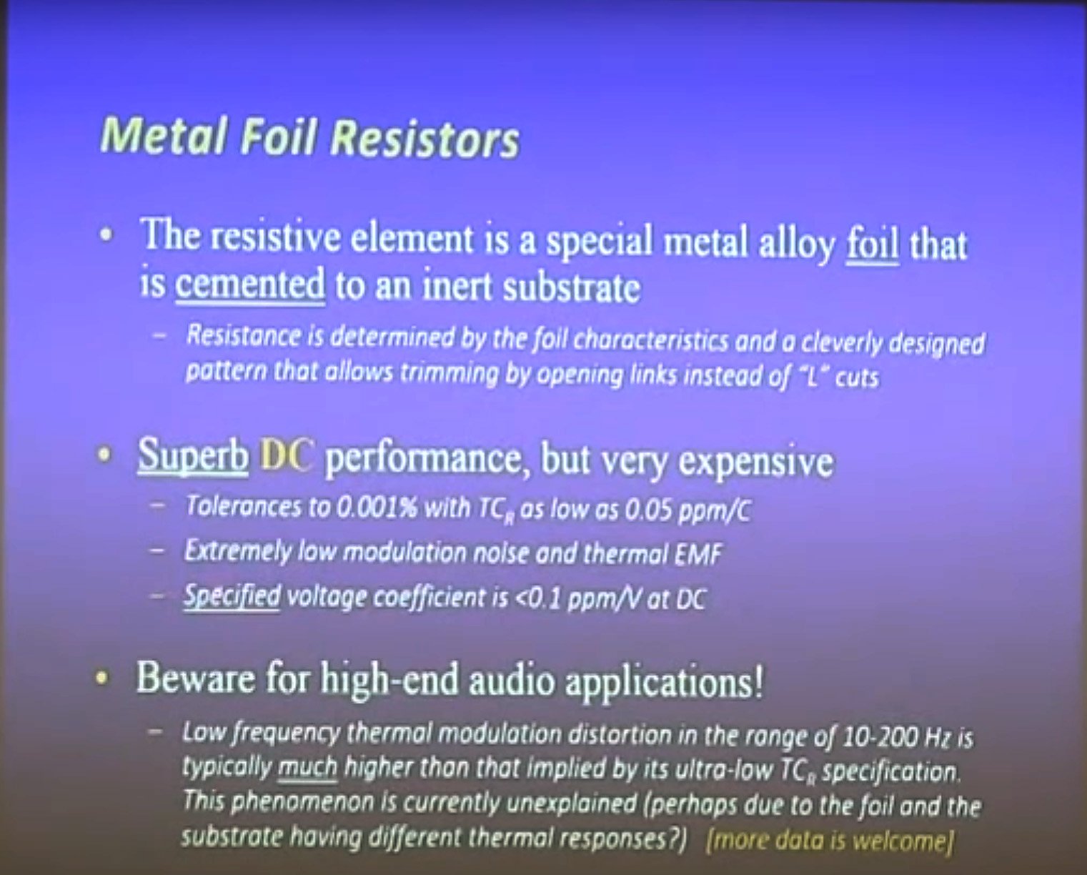

You favored using Metal Foil resistors at the shift registers output.
I was just looking at a Bruce Hofer presentation from AP where amongst others, resistor properties were discussed.
Apart from their excellent Tc and Vc properties above 1Khz, are you aware of their large deviating properties between 10-200Hz ?
Hans
Hi Hans,
Hofer has said somewhat different things at different times. In one article he said:
.... My recent experiments (which are also corroborated by another individual) show that some metal foil resistors with exceptionally low TCR behave as if | Z(ω)| >> θR, thus contributing higher modulation distortion than a thin film resistor with a larger TCR under identical conditions.
Please see pages 3, 4 of: https://convexoptimization.com/TOOLS/HoferUltraLowTHD+NPart2.pdf
Without knowing which metal foil resistors he was talking about, whether they were T/H or SMD, etc., makes it kind of hard to know under what conditions such thermal modulation might be seen.
In the two cases where metal foil resistors were tried here, they resulted in come improved clarity. In the case at that time with the RTZ dac the improved clarity was deemed to be only very slight and not worth the added cost.

Hi MarK,
As always, you are well documented.
However in the link you provided, I also read:
Reducing Temperature Coefficient Nonlinearity
Avoid the common 25-ppm/C characteristic in critical circuit locations. Instead, opt for premium parts that deliver 10-ppm/C or even 5-ppm/C characteristics.
Avoid metal foil resistors. While they have very low temperature coefficients (less than 1 ppm/V), they exhibit poor AC performance. This information isn’t found in the datasheets, which typically only show DC values.
However, technical specifications and listening experience are two different things,
So, AP purely concentrating on the highest possible technical performance, is looking at it from a different angle as you do as a listener.
I have no experience with metal foils, but I was nevertheless rather surprised by this information.
