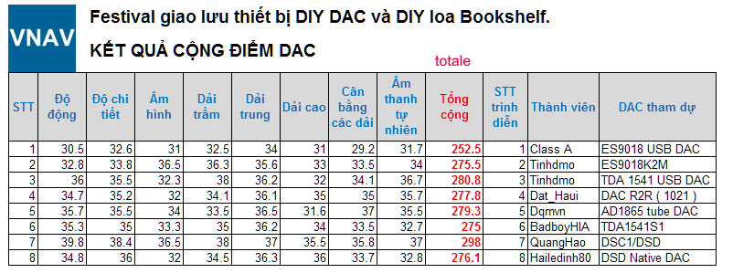

You probably tried their EVM board? Evm is bad sounding. For examplle this one https://www.audiodesignguide.com/DSC2/index.html got 1st place in Vnav forum where audio enthusiasts gathered with their audio devices, like a little competition, which tells that ct7302 is not bad at all.That would be bad. CT7302 is not an ultra-low phase noise reclocker. It sounds awful in comparison to what LTK is doing. I know, since I have tried CT7302 and consulted with their factory to try to get it to sound decent.

Thats all subjective. Ct7302 can't have 32 bits dynamicrange(192dB), THD+N (-174dB) in case it have an phase noise isue. And E1DA Cosmos ADC would not outpreform some $30k audio measurement devices in case their ct7601 audio usb out have some isues. I think Comtrue is a real!
ok, I accept a different opinion! I will do some measurements soon, booth dsc2 and dsc2 frontend with ina849
