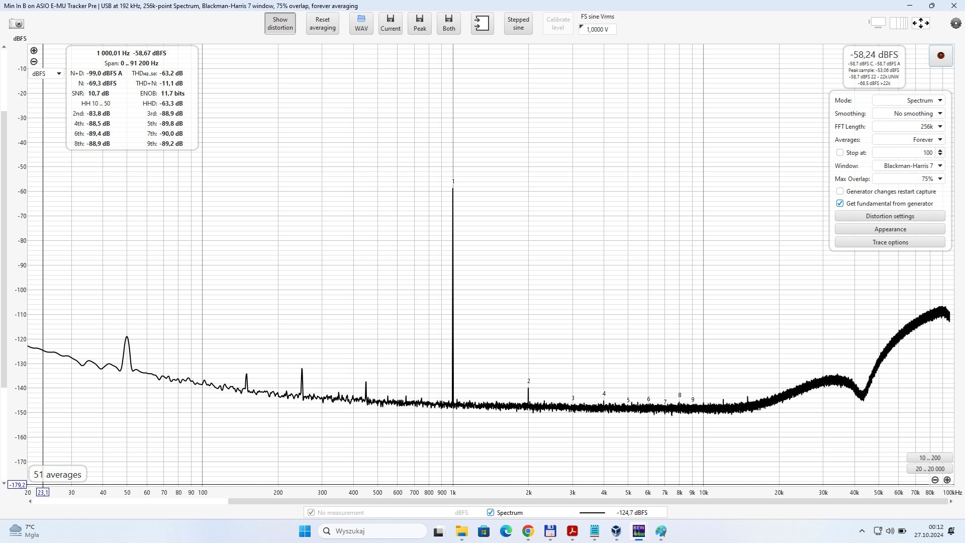

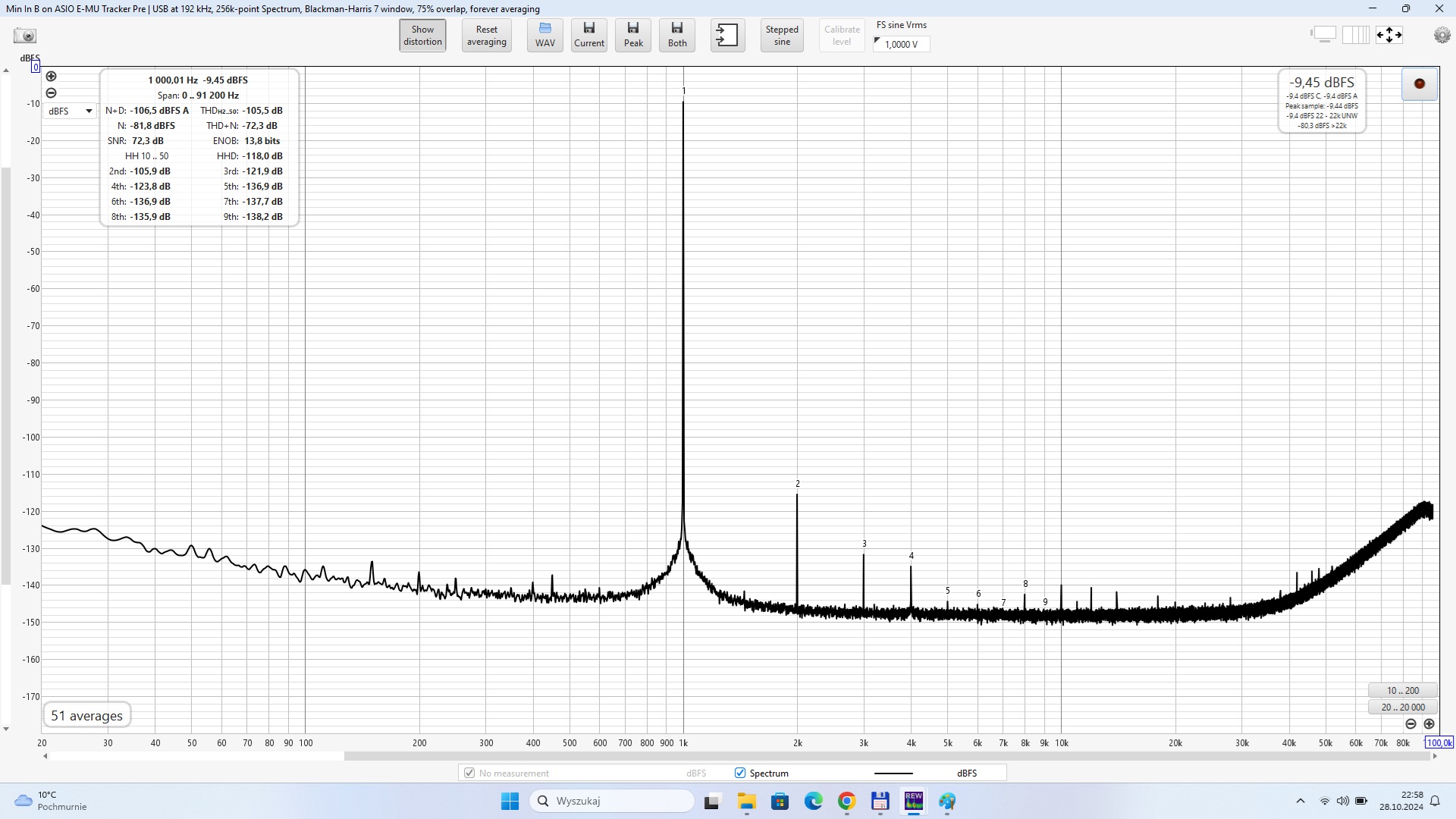

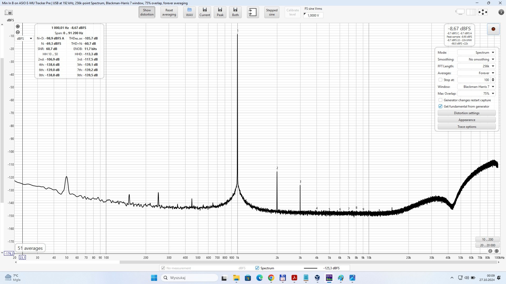

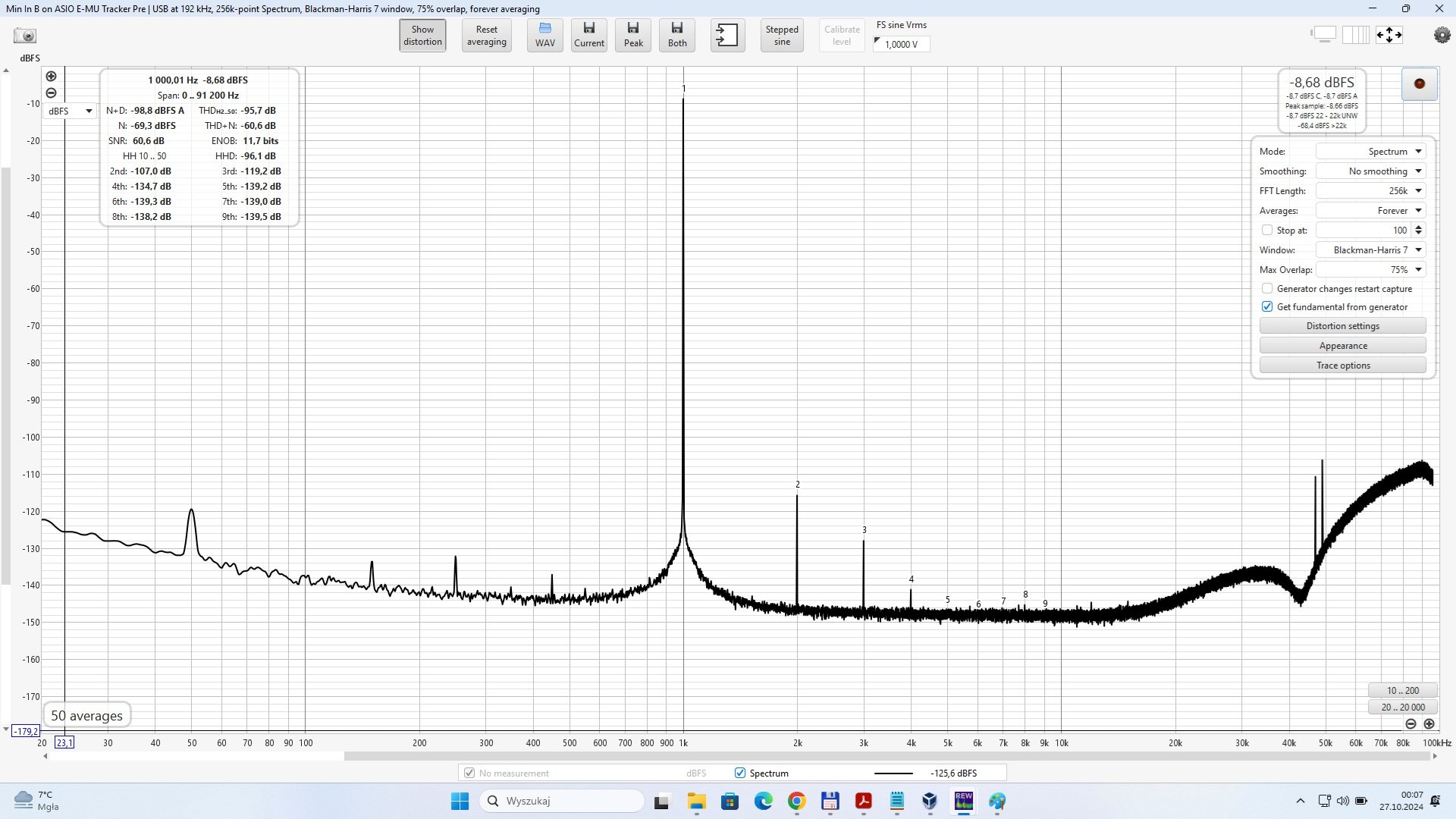

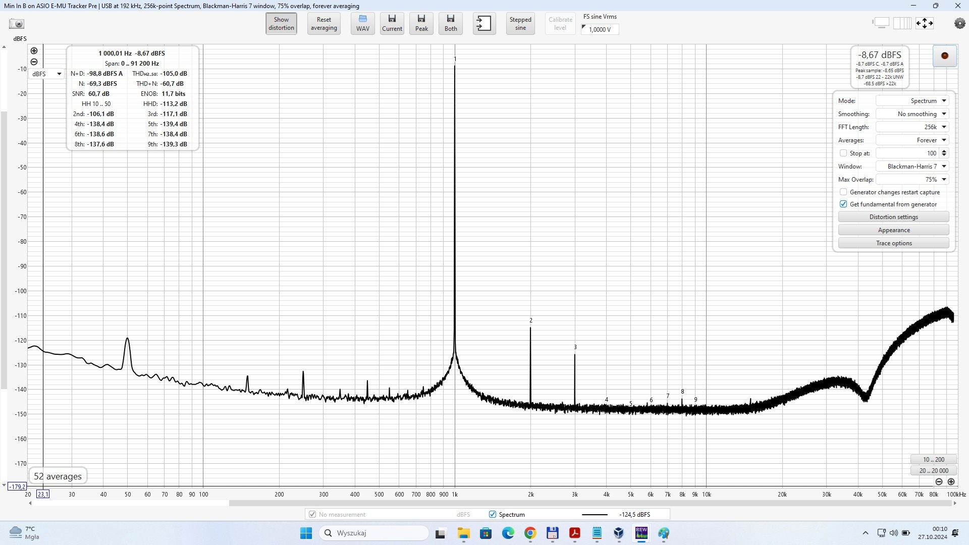

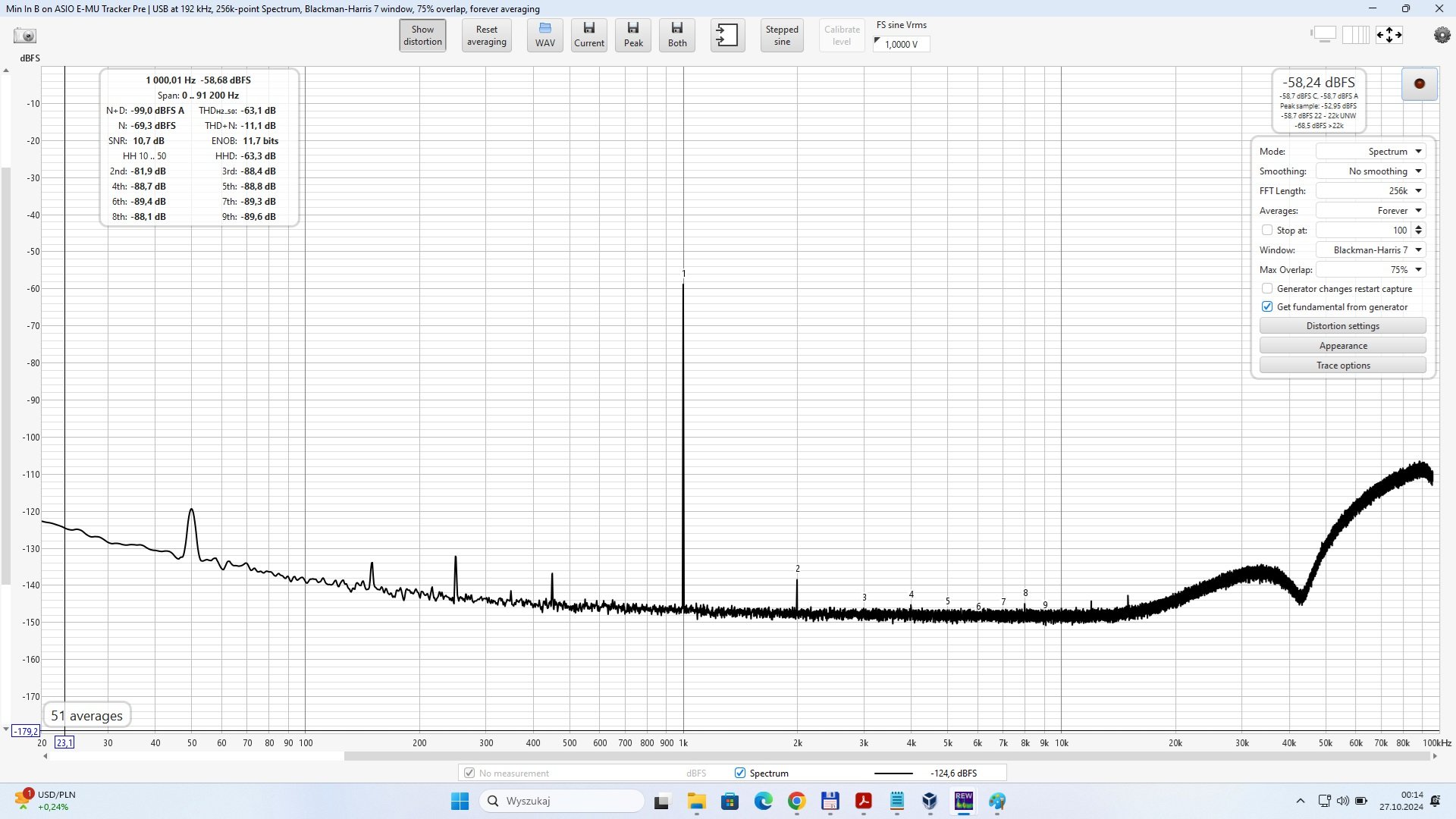

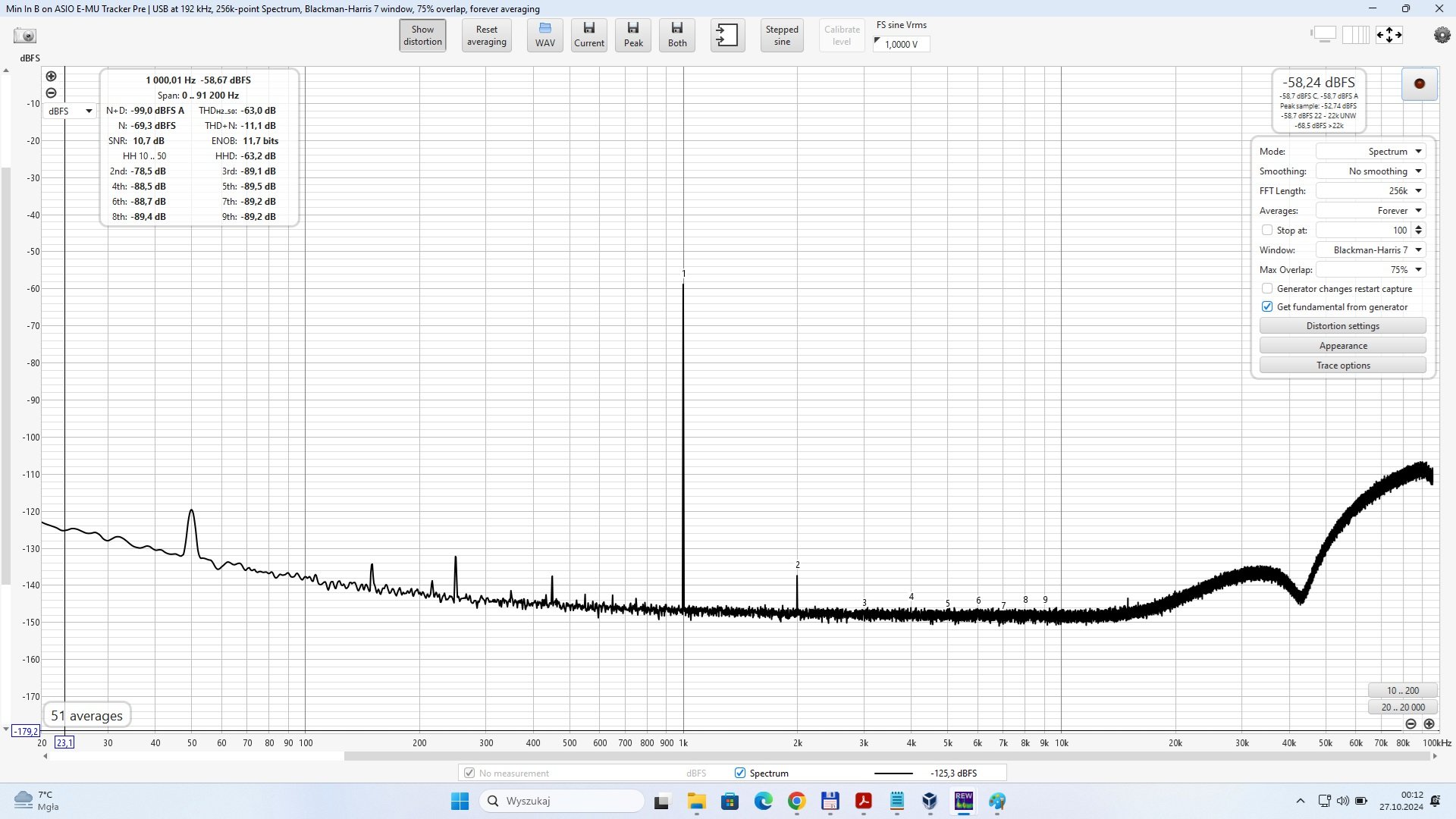

@PJotr25 gave me permission to post the measurements he made using a PCM2DSD board running my topLX9.bit configuration file version 1.2 and the RTZ shift register DAC. The DAC was clocked by the master clock, not by the bit clock output of the PCM2DSD board.
-10 dBFS, 48 kHz input sample rate:
-10 dBFS, 96 kHz:
-10 dBFS, 192 kHz:
-60 dBFS, 48 kHz:
-60 dBFS, 96 kHz:
-60 dBFS, 192 kHz:
The increase of the noise around 20 kHz is due to shaped quantization noise.

Do we know how it compares to @PJotr25 v4 firmware measured the same way?
Also, how does it look with no test tone? How about with a different frequency test tone? Is a multi-tone test possible there?

PJotr25 confirmed that the graphs look the same for version 1.3. The only difference between 1.2 and 1.3 is that 1.2 uses sums and differences of uniformly distributed random signals for dithering left and right, while 1.3 uses different random signals for the two channels (making left and right dither statistically independent, to the extent possible with pseudorandom noise).
To me at least, v1.3 is a step in the right direction (perceptually speaking). Its just that there is still room for more effect in that direction in order to compete well with PJotr25 v4 and or HQ player.
I don't, but PJotr25 may know.
In measurements, the most important thing is comparison.
Comparison to other measurements in the same or similar conditions.
Here you go v4:
-10dBFS, 48kHz:
-60dBFS 48kHz:
Here you go v4:
-10dBFS, 48kHz:
-60dBFS 48kHz:
Looks like slightly lower noise skirts for PJotr25 v4. Also less ultrasonic noise. Still wondering about non-PSS noise, as well as noise phase distribution.
