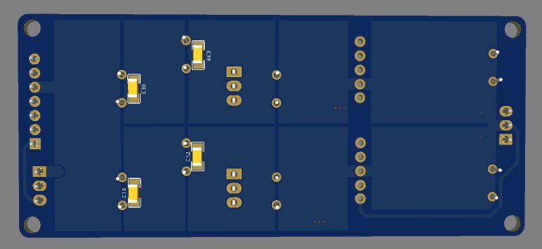

There is one other thing I might mention. I thought it should be easy to bring is a crystal clock signal to replace your XOR gate frequency doubler. I tried more than once, including designing a custom low noise driver board that connected to your dac board over u.fl cables. Nothing I tried could quite get the excellent performance of your doubler. I attribute my failure to your doubler being on the same ground plane as the rest of the dac, it being very close to the shift registers, and the very low noise power supply you designed for that circuit function. My expectation that it would be easy to do better was destroyed.

When I tried using MCK for clock2fs I noticed an increase in noisefloor. Tuning the setup and hold times with series termination resistors proved unsuccessful. BTW my guess is that the close-in phase noise performance is impacted partly by the clock doubler circuit.There is one other thing I might mention. I thought it should be easy to bring is a crystal clock signal to replace your XOR gate frequency doubler. I tried more than once, including designing a custom low noise driver board that connected to your dac board over u.fl cables. Nothing I tried could quite get the excellent performance of your doubler. I attribute my failure to your doubler being on the same ground plane as the rest of the dac, it being very close to the shift registers, and the very low noise power supply you designed for that circuit function. My expectation that it would be easy to do better was destroyed.
Maybe due to uncontrolled grounding? It's best to practice a star grounding scheme while designing the pcb, so that signal gnd, dc gnd, digital gnd, clock gnd... etc all have their own controlled path, the worst you can do is the usual uncontrolled huge ground layer and components connected to them via vias, that way the gnd is not under control and they don't have their own set path, they can wander uncontrollably and that's how unpredictable disturbances occur where they shouldn't be. Or at least put some canals and separate that huge gnd layer into sections somehow so that current flow excatly trought an boiler capacitor at least and not trought master clock for example, in worst case : )
e.g. while using huge gnd layer
Most likely not a grounding issue as the onboard clock doubler works well with low noisefloor but with the same grounding using MCK instead increases noisefloor.
I ruined several boards because of a common gnd practice, one board made according to the same scheme has no noise and the other one has noise, I realized that it was because of the gnd that was not under control. Now I practicing strictly the star scheme with definitelly noticeable better results. It's about the post regulators and they work great now, and I believe that everything else that doesn't concern the regulators has to work better when practicing that. I'm relatively new to designing boards, but so far I've had a bad experience with common ground problems. It turned out to be much better when practicing star ground.
The problem with using star ground at RF frequencies is that current loops are big, thus they make good antennas. Such boards are unlikely to meet emissions standards required for products sold commercially.
Instead of using star ground you have to learn to think about where current is going to flow in a board with a ground plane. Usually layer 2 of a 4-layer board will be the ground plane. Areas of surface fill on the top layer can be grounded, but the top layer fill doesn't necessarily have to be continuous, and even it is continuous you can often have a lot of control over where impulsive noise currents will flow. You can also put sensitive analog components such as clock oscillators where ground currents flowing underneath them will be minimal.
For example, you could put clocks in a corner of the board, with voltage regulators off to the side. That way ground currents from the clocks themselves can return directly to the regulator, and ground currents from other circuitry flowing back to the regulator will not pass under the clocks. You can also keep most bypass cap current loops on the top layer so that impulsive currents don't have to pollute the ground plane layer so much (and so that bypass current loops can have very small loop area, and can also be very low inductance). Ground planes have very low impedance, which mainly means voltage differences across the ground plane should be very small. However, currents still need to flow and they will produce magnetic fields. When di/dt is fast then ground currents tend to follow traces carrying the mirror image current on an adjacent layer. When di/di is slow the ground current spreads out. The mirroring and spreading out is happening constantly with signals like clock pulses. On clock edges di/dt is fast. While the clock is high or low for awhile before the next edge, di/dt will be slower.
It is, but it is desirable that the current flows in a controlled manner otherwise you can't predict where current flow is ongoing on an huge bottom gnd layer, its better to divide bottom gnd layer into smaller areas with contolled direction, it is desirable that it goes first through the capacitor and not through an opamp first, for example.
Are you saying current flow doesn't follow Maxwell's equations? I mean, its true most people don't have access to an advanced EM solver they can practically use. However, you can learn to think about EM fields like a good RF engineer should be able to do....you can't predict where current flow is ongoing on an huge bottom gnd layer,...
No, I'm just saying that some auxiliary circuit can "pull" something from another circuit from which we don't want it, when the current flows uncontrollably across the gnd surface. That is why it is desirable to divide that area into smaller areas so that it has its own controlled direction.
Then you risk making resonant slotted-ground plane structures. In that case you may have a pretty good radio transmitter.
OTOH, star ground may work pretty well for a MC phono preamp design, as there should be essentially no RF energy to speak of in that particular case.
What I meant about strictly star gnd was star point between power ground, analog ground, digital ground, and signal ground. Each section have their own sub ref gnd plane with controled flow. Whole gnd's is on one layer only. Nevermind.
