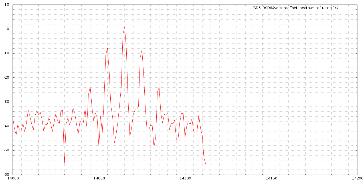

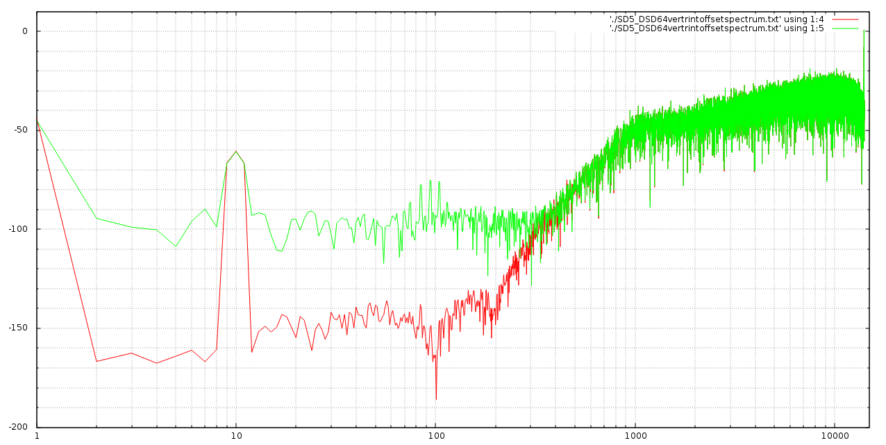

I'll see if I can program a particularly poor sigma-delta modulator and have it convert an offset such that the second-order intermodulation product ends up at a highish audio frequency.
Plain old fifth-order single-bit sigma-delta modulator running at a DSD64 rate, with no dither and almost no chaos, notches at 10 kHz and 20 kHz, offset applied that should shift the main idle tone by 5 kHz and thereby cause a 10 kHz intermodulation product.
Spectrum with a 1 kHz, -60 dB DSD signal, Hann window, frequency axis in DFT bins of 100 Hz each, vertical axis in dB DSD:
Red trace: ideal case
Green trace: bit of second-order intermodulation distortion introduced by making the bit weight 0.1 % too high or 0.1 % too low, depending on the value of the previous bit.
Zoom of the 1.4 MHz to 1.42 MHz area, ideal case, spectrum above 1.4112 MHz is the mirror image of the part that is shown:
Spectrum without the 1 kHz signal, Hann window, frequency axis in DFT bins of 100 Hz each, vertical axis in dB DSD:
For some reason the 10 kHz peak is closer to 9.4 kHz. The second-order intermodulation distortion increases its level by about 70 dB. Source code attached (with the extension changed from .pp to .txt), next step: putting it into the program with the .dsf writing routine.

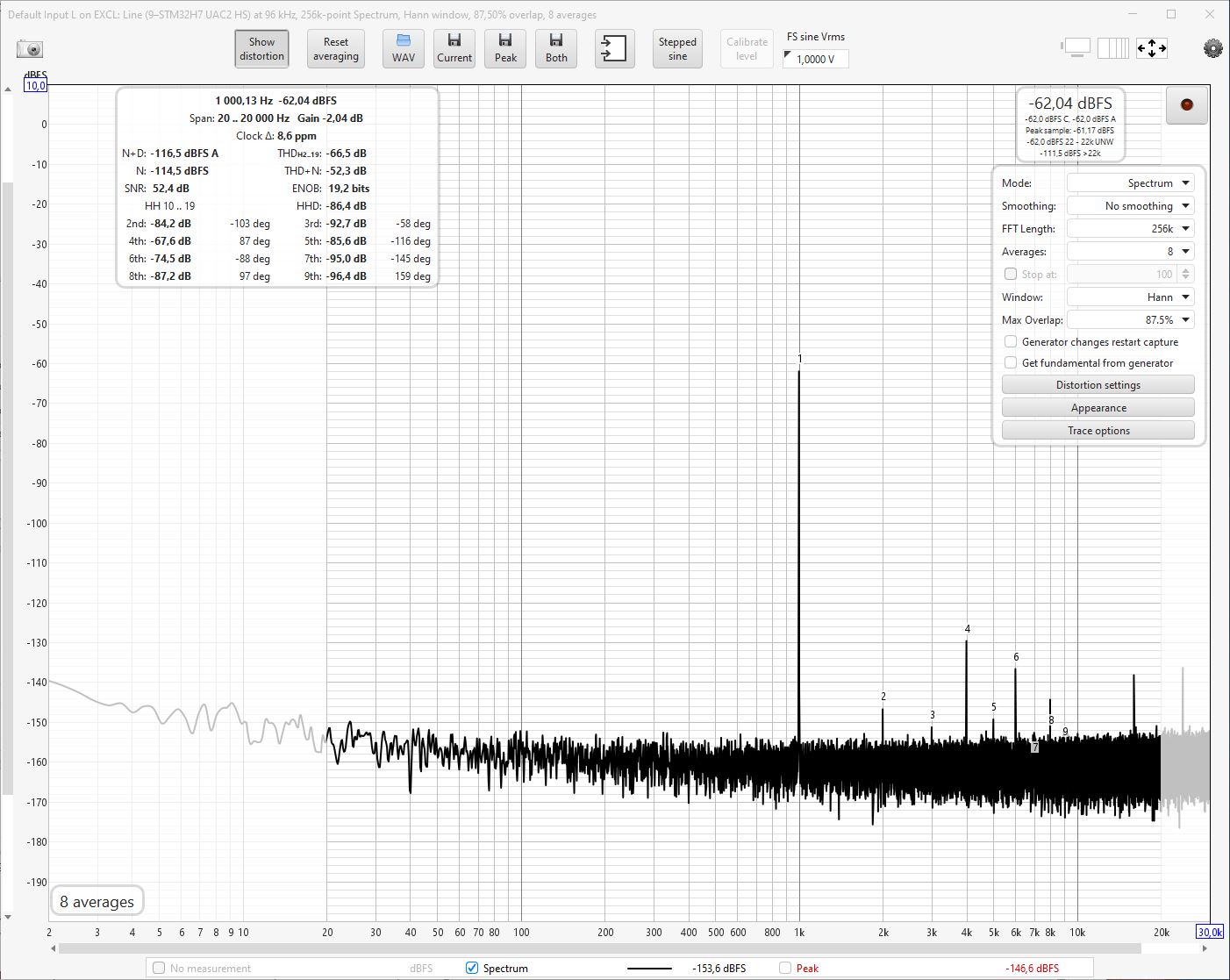

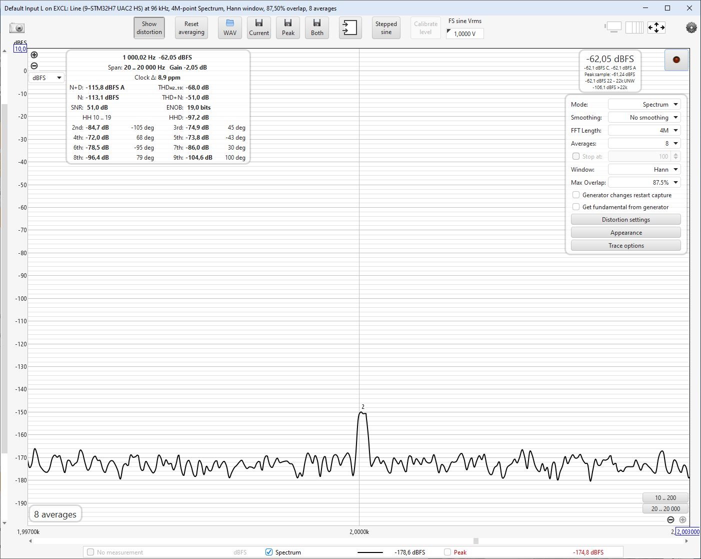

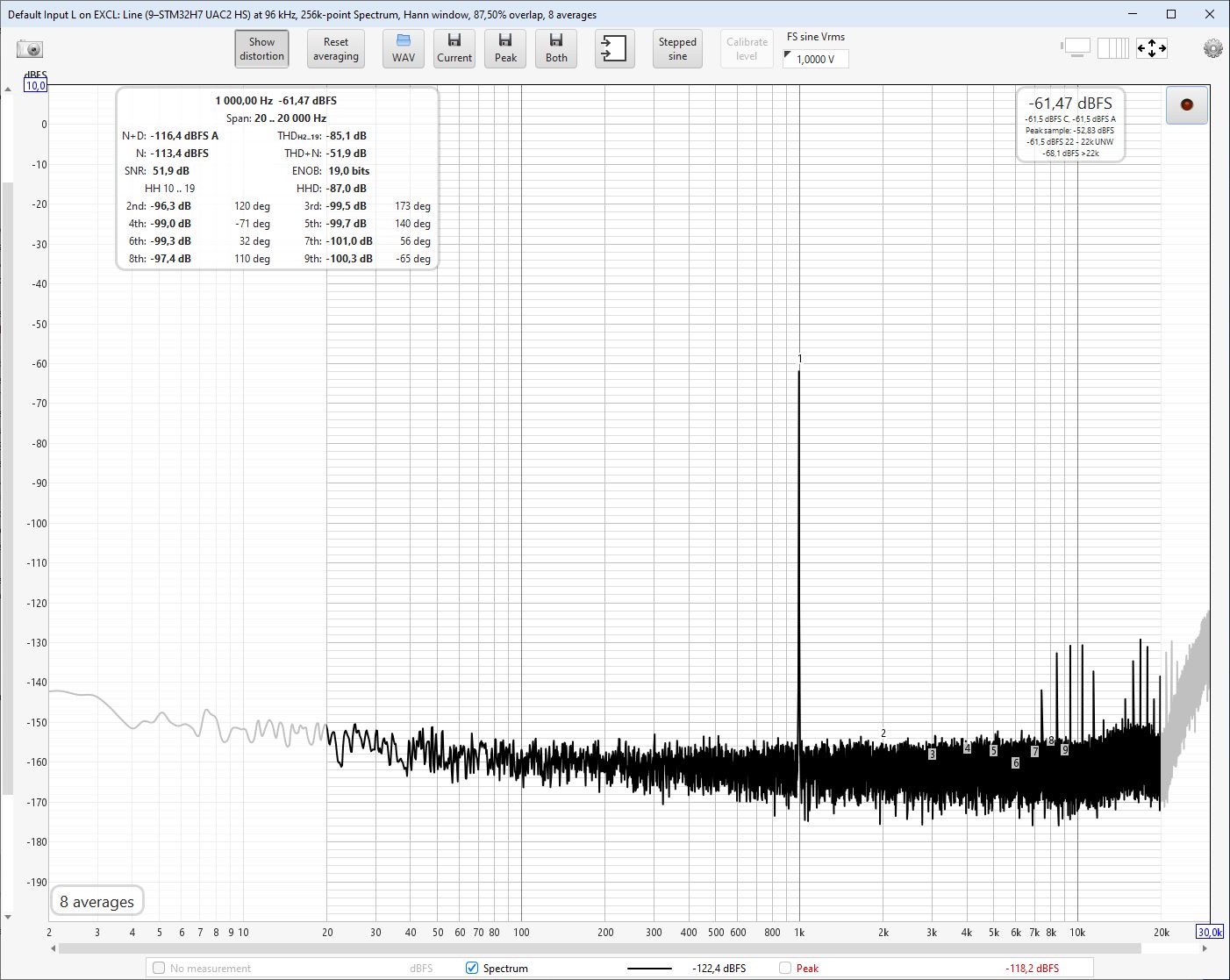

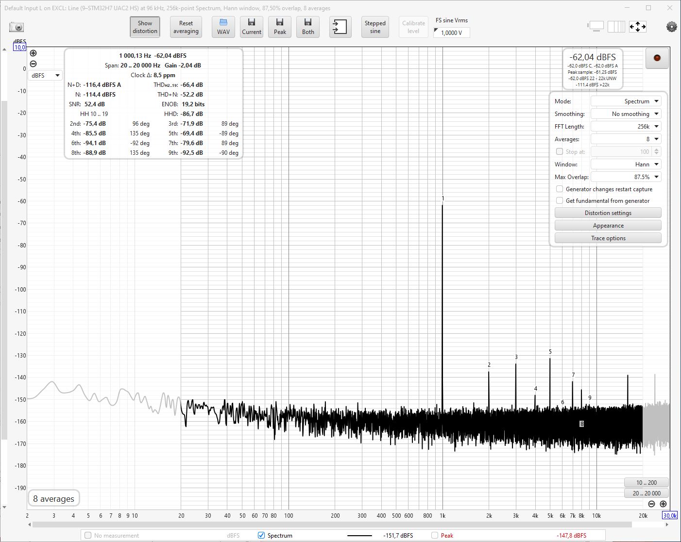

I'm not sure about your expectations but here are results from both RTZ (stock) and AK4493.
Interesting that there is only some 10 dB of difference around 10 kHz.
Was the AK4493 in volume bypass mode, DSDD = 1? If so, does it much improve with DSDD = 0? I would expect near perfect behaviour when DSDD = 0, especially on the left channel, unless something has gone wrong on my side.
How does the spectrum look for the left channels of both DACs?
Silly me, I looked at the shapes rather than the shapes and scales. The worst peak around 10 kHz for the AK4493 is about -140 dB, and the peaks I simulate for the ideal case have about the same level. The main difference is that they are sticking out more above the noise in the measurements due to the smaller resolution bandwidth.

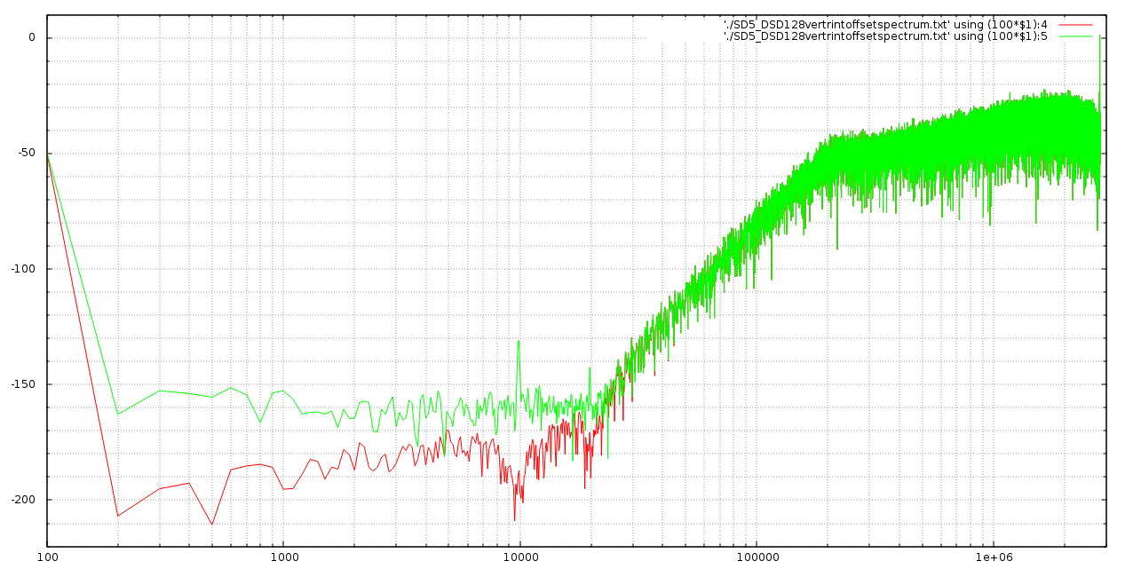

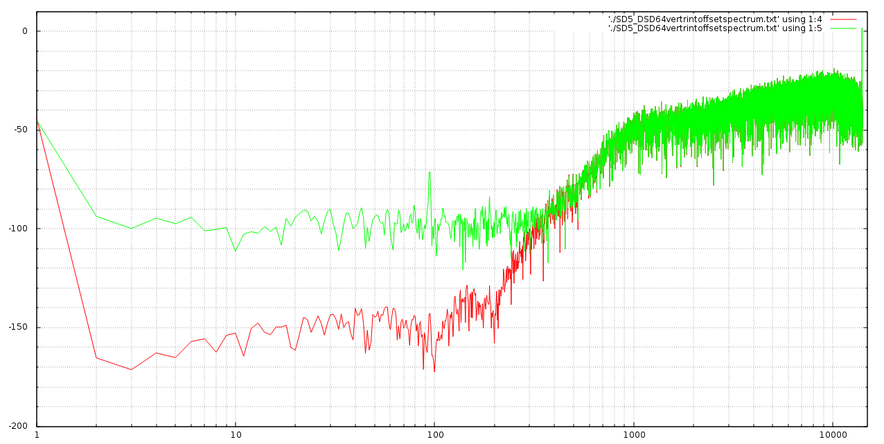

Bohrok2610's measurements from yesterday mainly showed that the approximately 10 kHz component coming out of yesterday's software sigma-delta modulator was not far enough below the 10 kHz component due to intermodulation in the DAC. I've now adjusted it for DSD128 to solve that.
Horizontal scale in Hz, vertical in dB DSD, Hann window, bin size still 100 Hz
Green trace: some second-order intermodulation introduced by making the bit weight vary +/- 1 ppm depending on the previous bit (I used +/-0.1 % yesterday, but that gave an unrealistically large 10 kHz component)
The source code of the program that generated this spectrum plot, of a program that writes the bit stream to a .dsf file, the .dsf file and the plot are in the attached zip archive.
The purpose of the .dsf file is to hopefully make it easier to simulate or measure differences between the intermodulation products produced by different output filters. I hope it will be of use to Hans and later to myself.
Another attachment is a minor update of the report on the cause of the low-level tones.

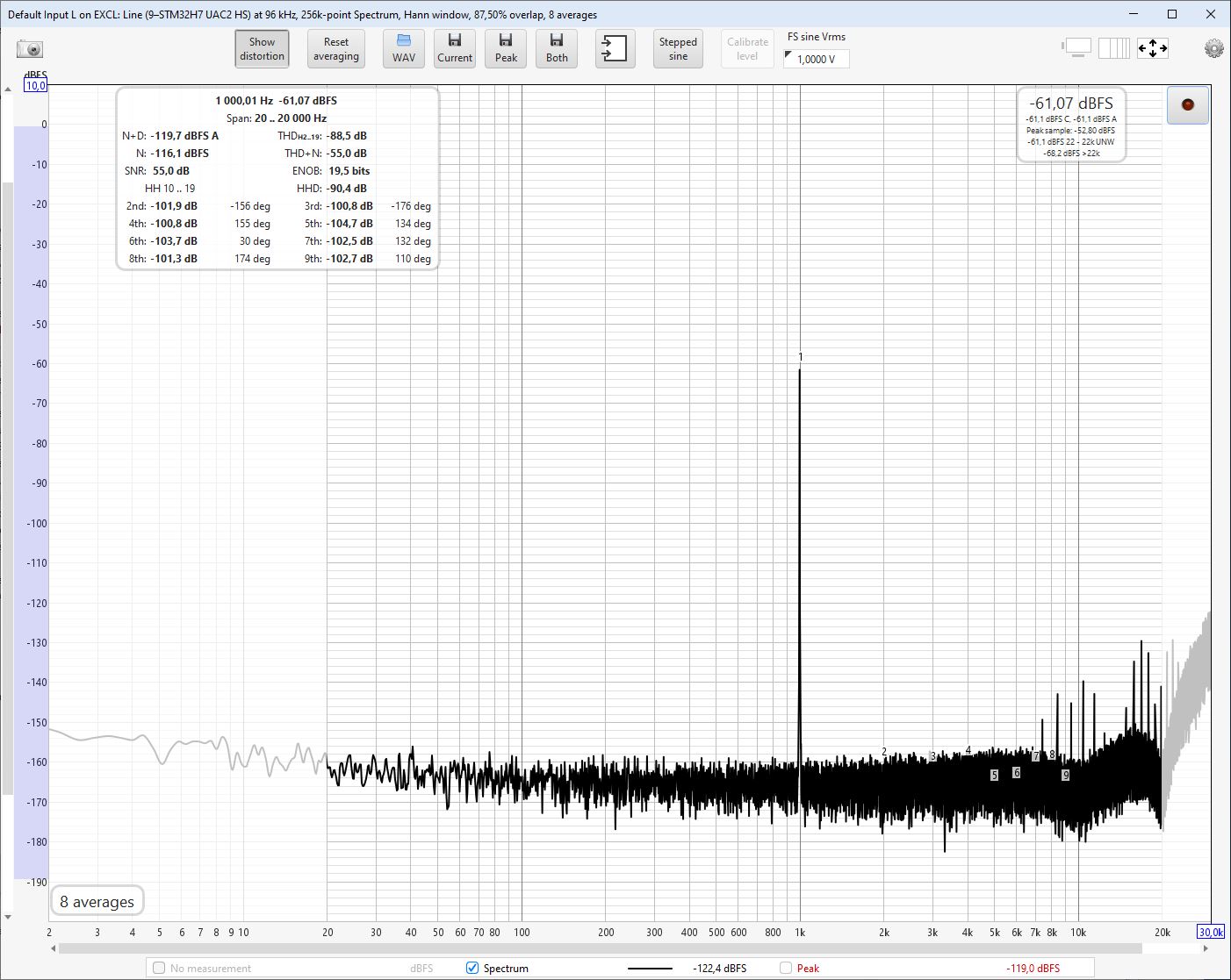

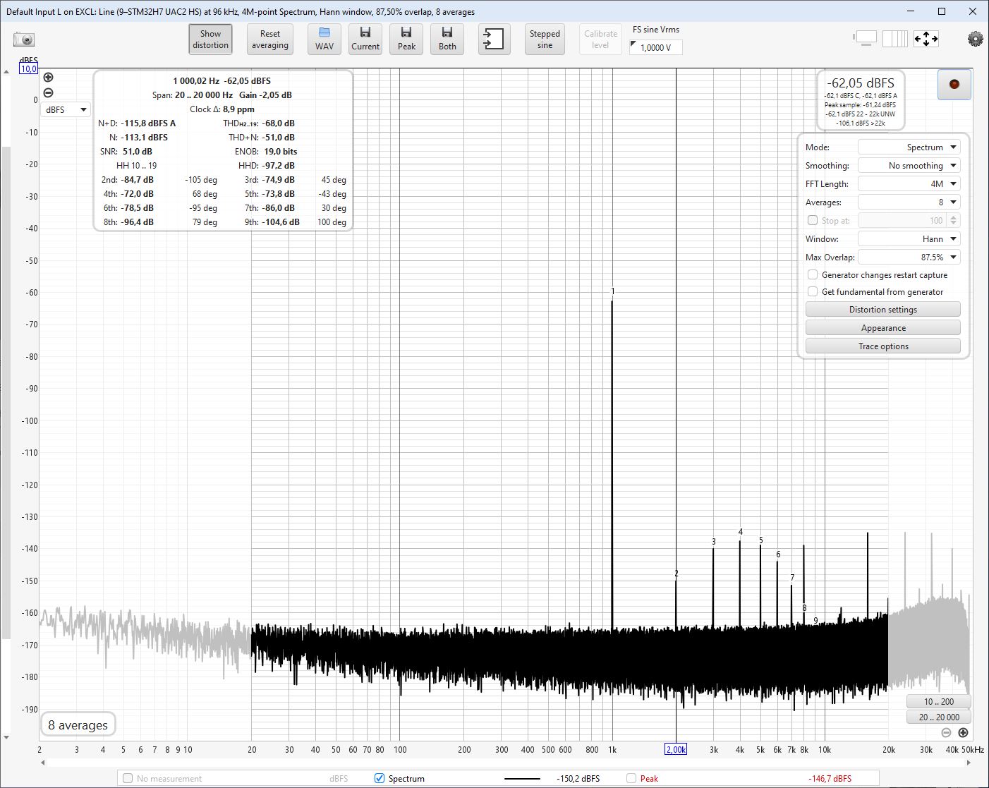

Based on my tests the new PCM2DSD FW does a good job at removing the splitted peaks of low level "harmonics" with no degradation of performance at higher levels. So clearly an improvement.
There is one minor "issue" that was probably on the earlier version as well but has now become more apparent. With low input levels (e.g. -60dBFS) the harmonic peaks "pump" slowly up and down by almost 10-15dB. Oddly this pumping happens alternatively either at all even harmonics or att odd harmonics (see attachments 3 and 4 which were taken about 15s apart). Marcel suggested that this is caused by miniscule split in peaks. This may well be the case when looking at 4M FFT zoomed to +-3Hz at 2kHz (second attachment) as there appears to be 2 peaks very close to each other. So the "pumping" is quite likely just a measurement (or FFT) artefact. In my tests all peaks at low levels were at -130dBFS or lower so there should not be much reason for concern regarding audibility.

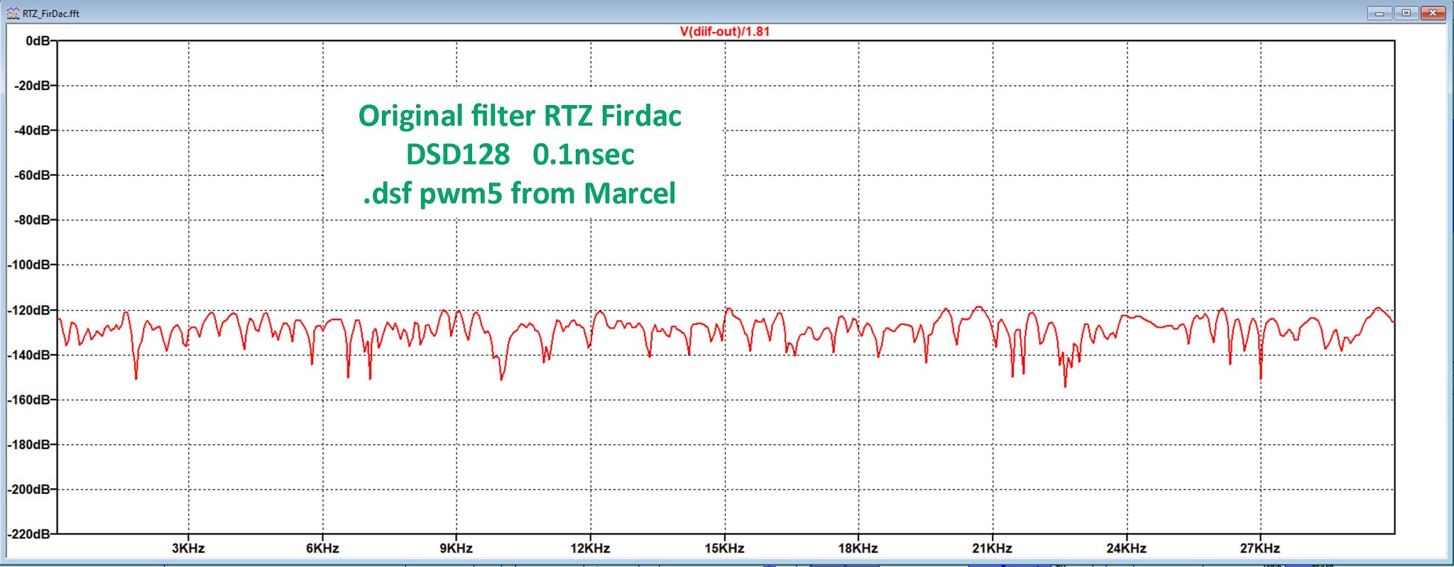

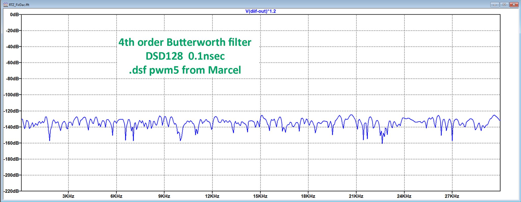

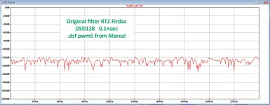

Marcel,
I processed the .dsf file with DC offset, the one that's in your zip file, with two different filters, a fully passive 4th order Butterworth and also the with the original RTZ Firdac filter.
Filter bin was 62.5Hz and simulation step time 0.1nsec.
The passive filter was multiplied by 1.2, but this had to be 2.4 because the passive filter (with Rs = 376.25) attenuated 6dB.
Much to my surprise, both spectra are absolutely identical, but I don't see any intermodulation products.
Any idea why ?
Is it because they are below the noise level in my simulation ?
Hans
