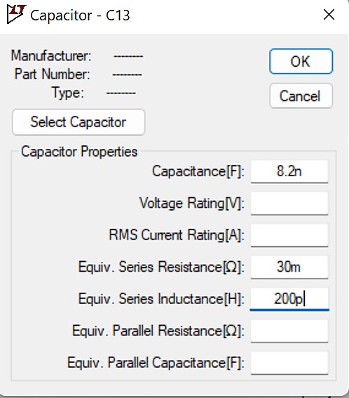

Before going into different DSD rates with even smaller timesteps, I first wanted to get a better feeling whether a more realistic 8.2nF cap as against an ideal version would make any difference.
That's why I added a 30mR series resistance and a 200pH series inductance, this according to Kemet specs for their 8.2nF NP0.
Result turns out to be rather obvious as shown in the attachment below, without at the left side and with these two series impedances at the right, where lots of spikes are visible at the moment the slope inverts its direction.
These spikes feedthrough all the way into the first OPA2210 op-amp.
Image was made with a 50psec timestep while processing the DSD256 1Khz@0dB signal.
Blue is the signal as measured on the 8n2cap.
Red is the signal on the inverting input of the OPA2210, connected with a 255R to the 8n2 cap, here for better clarity magnified by a factor 10
Looking only at the red curves, those spikes look quite small compared to the triangular ripple you already get with ideal capacitors. It looks to me like the series inductance isn't dominant.

As mentioned in the text, I only added to the 8.2nF a series resistance and a series inductance.How did you model the parasitics of the capacitors, resistors and IC package?

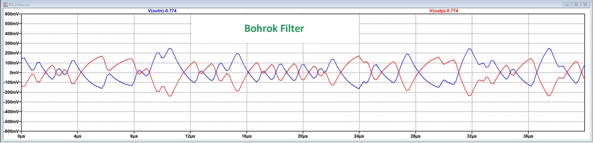

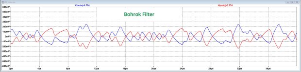

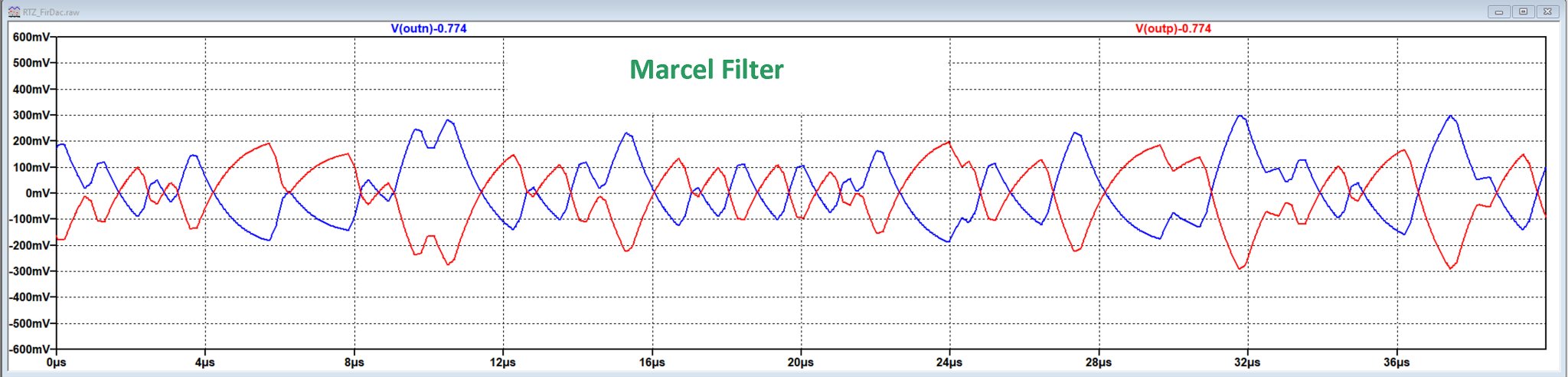

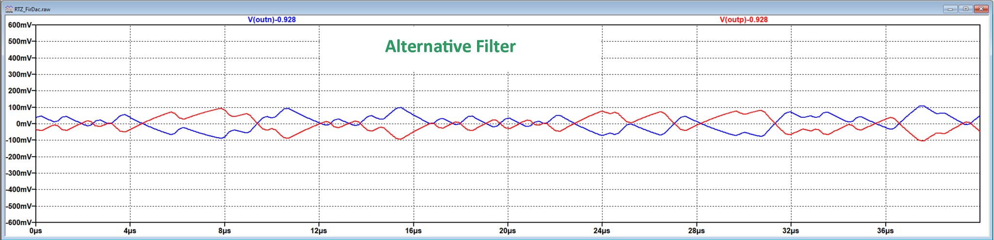

Looking at the signal directly on the two nodes of the eight 3k01 Firdac resistors (resp. pos and neg), three different filters where compared:
1) Marcel's filter starts with two 8.2nF caps.
2) Bohroks filter starts also with two 8.2nF caps, but has an added 1nF between the pos and neg Firdac ouputs
3) The Alternate filter, based on Bohrok's design, has two 10nF caps instead of 8.2nF and 10nF has been added between the two Firdac outlets replacing the 1nF in version 2).
When looking at the attached images, the original filter has the sharpest edges, Bohrok's filter has smoothened the curve a bit and the Alternative filter does even more passive filtering.
Since the idea is that more passive filtering before going active with op-amps, the alternative filter could be a step in that direction.

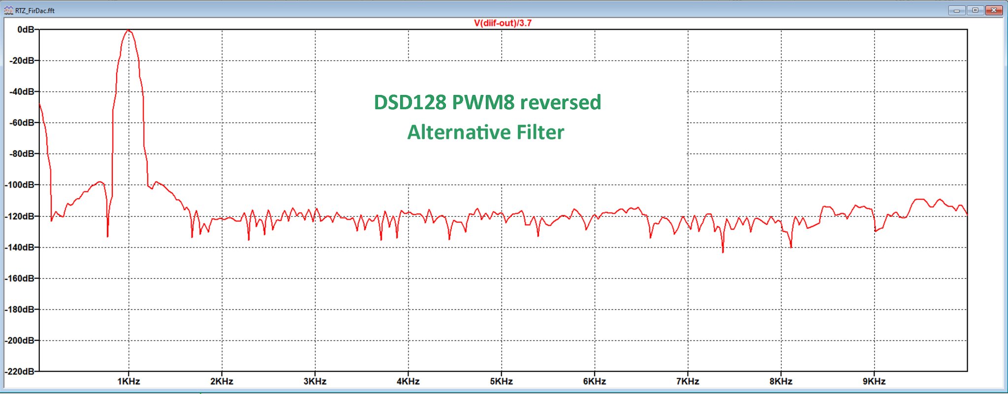

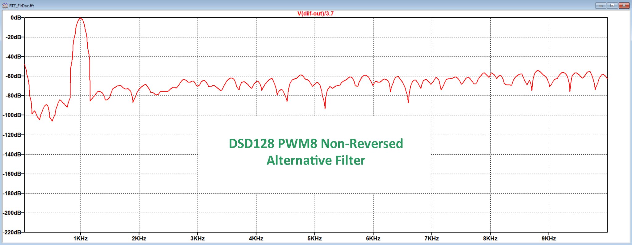

Would you care to share the kicad files, thy would be way easier to look at - at least for me with kicad already installed.Made yet another version of Marcel's dac board, This one only differs in having added u.fl test points for clock and data signals going into the shift registers, test points for things like scope grounds, and test points for both Vref supplies. The test points can be used to monitor existing signals, or else used to inject external signals if some upstream resistors are removed first. Also, Marcel has reviewed the Gerbers and said they look okay.
With a DSD128 .dsf file, prepared by Marcel with PWM8 , I have made the simulation with reversed and non reversed bytes.
It must be obvious that, given the much higher noise level, bytes will have to be reversed.
Time step was 0.5nsec and the Alternative Filter was used to get the lowest possible contamination from the Firdac's
Hans
