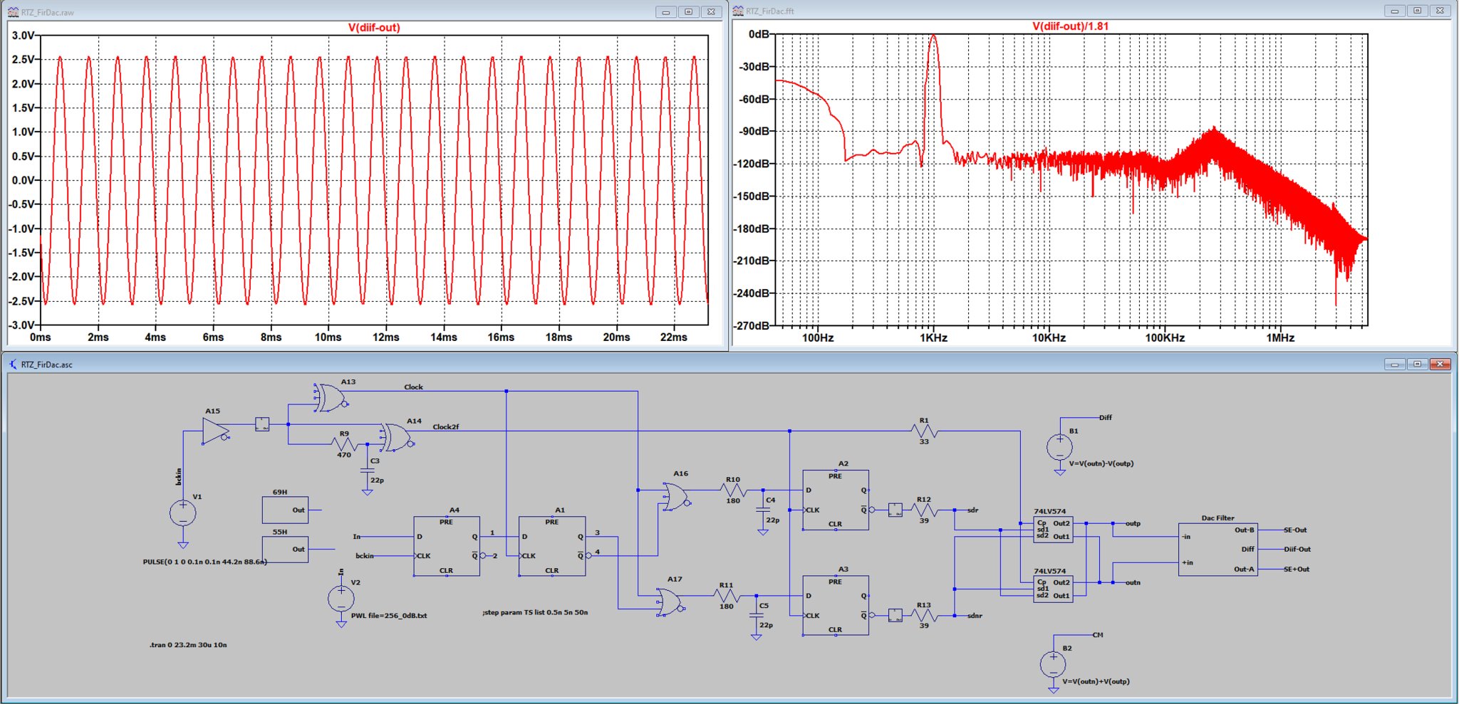

I finally got the model working properly.
A large number of blocks from a DSD256 .dsf file where skipped, and there it was the 1Khz@0dB signal in the left channel.
16 blocks split in 8 blocks Left and 8 blocks Right containing just silence, were concatenated and bytes reversed.
These 8 blocks played back over the model hold 23,216msec on information, but the sim takes almost 50 minutes to complete.

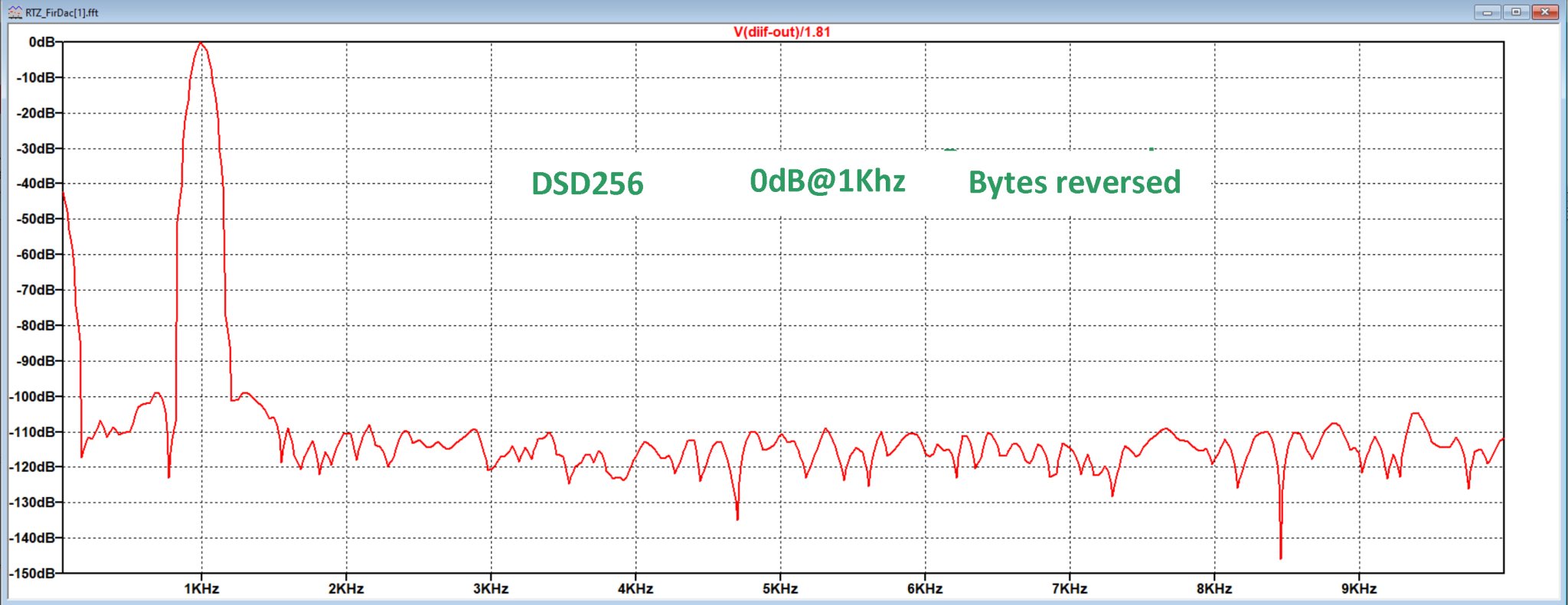

See first attachment with the result, a clean looking 1Khz sinewave together with a Blackman-Harris windowed FFT.
Second attachment shows the spectrum when zooming into the range up to 10Khz with no obvious distortion products.

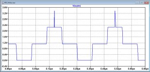

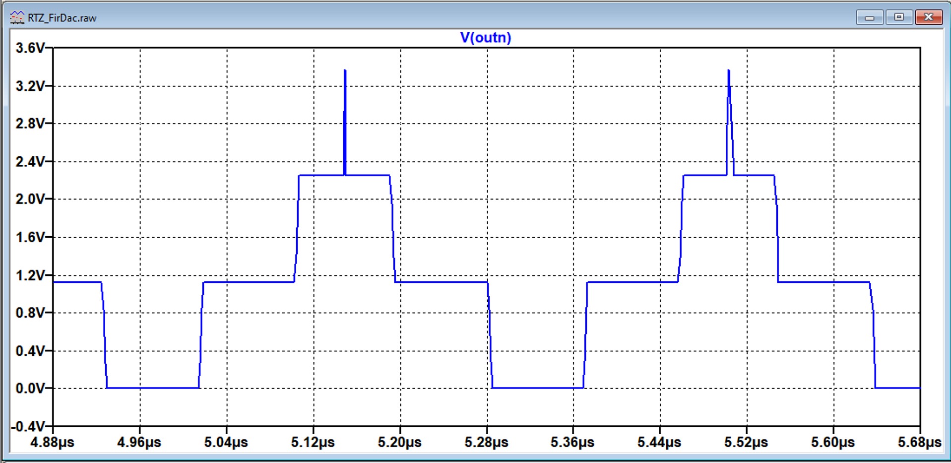

But, at this high DSD256 frequency of ca. 11.3 Mhz and using a timestep of 10nsec, I still noticed spikes coming from the Firdac after the 8 summation resistors but with no further loading, see third attachment, so in fact the 10nsec timestep is still too large.
At 1nsec timestep all spikes are gone, but at the cost of an even longer sim time, but not used for this first run.
I'll switch now to DSD64 where the contribution of eventual spikes to the spectrum will be accordingly smaller and I will also try to get an even more accurate spectrum with a smaller timestep.
There I will also try to investigate in more detail the effect of reversing bytes or leaving them as they are positioned in the .dsf file.
To be continued, step by step
Hans

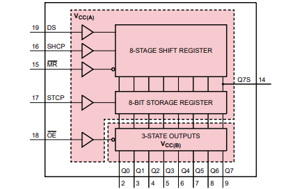

By the way I saw that the SN74LV595ANSR can be operated at 5V and has a fmax of 115 Mhz, so I would guess, this could be a good candidate as an alternative to the 74FF shift register?

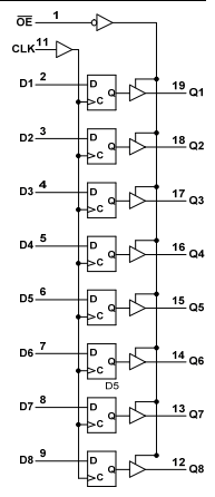

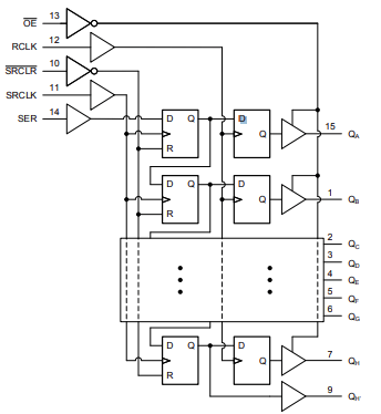

Ok, let's look at this in detail. First the internal diagram:
We can see we have two sets of Flip-Flop's in series. That is one more than necessary. And we have tri-state outputs.
As remarked - with correct timing we can use the two separate registers to our advantage, however I have not seen a FIR DAC design using this. So we get two sets of Flip-Flop's triggering at the same time making the device more noisy than necessary and as there is only a sole GND & PSU pin this is going to cause trouble.
At 115MHz you are very seriously pushing the timing at 5V Supply. Reliable operation past 50MHz is probably going to be hard to achieve.
One improvement could be to use 74LVC8T595, which has two power supply domains, one for all the Logic and one for the output switches.
Now any logic switching does not directly feed into the analogue reference power, but the IC is obscure and excess logic up front still causes what Ed Meither defined as "Logic Induced Modulation" affecting clock jitter inside the IC and possibly outside, depending on the competence of the PCB design.
Another issue is that all flip flop's in the 595 are internally committed into a shift register with 8 Bit's.

If instead using 74LVC574 we gain a number of advantages:
The Logic is more simple (less noise) and the Flip Flop are uncommitted, so we can make two 4-bit FIR DAC (sections) that are balanced on one IC.
Even some of the root causes of LIM are resolved. As we get the same number of L>H and H>L transitions in each "sample" the power spikes charging/discharging the CMOS gates in theory net off and are contained on chip.

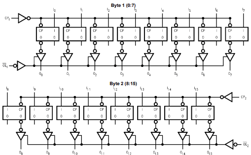

It is noteworthy that 16 Bit D-Latches optimised for high speed bus systems operating at 1.8V or 2.5V do exist and could be used to make a single chip balanced 8-Tap FIR, like used by Electrart Japan for the so-called DSD-Principle DAC (resistor values and schematic in the Link).
The 16 Bit parts also have (IMNSHO) much better pin layout for ground and PSU, allowing much lower noise PCB Layouts than the 8-Bit parts.
So in my view, using for example SN74LVC16374A to make balanced FIR DAC's is a much better choice than either 574 or 595.

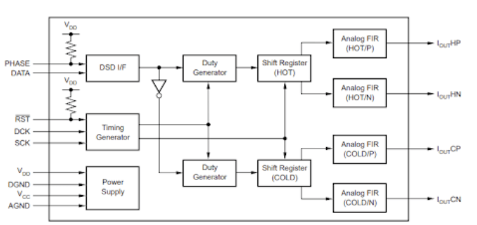

Finally my "obligatory" DSD1700 reference. This was BB Japan's DAC Chip for DSD, basically designed for Sony et al.:
I think a discrete implementation of this with 2 X 74LVC16374 as shift registers, Kaiser Window weighted (or just electart's values) and RTZ with 75% duty cycle (MCK = 4 * BCK and additional logic) based on Marcel's design could produce a DAC with similar complexity and improved performance.
Equally a Jussi/Pavel DSC2 build correctly using 74LVC16374 would likely outperform this thing:

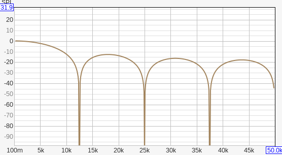

You can use any wave editor to draw the samples and then use FFT function, or use REW with impulse response text import (which needs to obey to the following format).But what determines the cutoff and stopband frequency? The resistor values and the capacitor at the summing point? I just need the math for a equally weighted FIR filter.
Example for 8 equal weight taps:
Code:
* Impulse Response data saved by REW V5.31 (required)
0.0 // Peak value before normalisation, don't care
0 // Peak index, don't care
1024 // Response length, defines low frequency display limit
1.0E-5 // Sample interval (seconds), make sure the sample rate is neither too high nor too low to display
0.0 // Start time (seconds) , don't care
* Data start
1.0
1.0
1.0
1.0
1.0
1.0
1.0
1.0
After import, normalize to 0dBSPL at a low frequency.

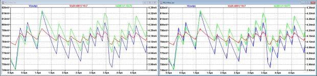

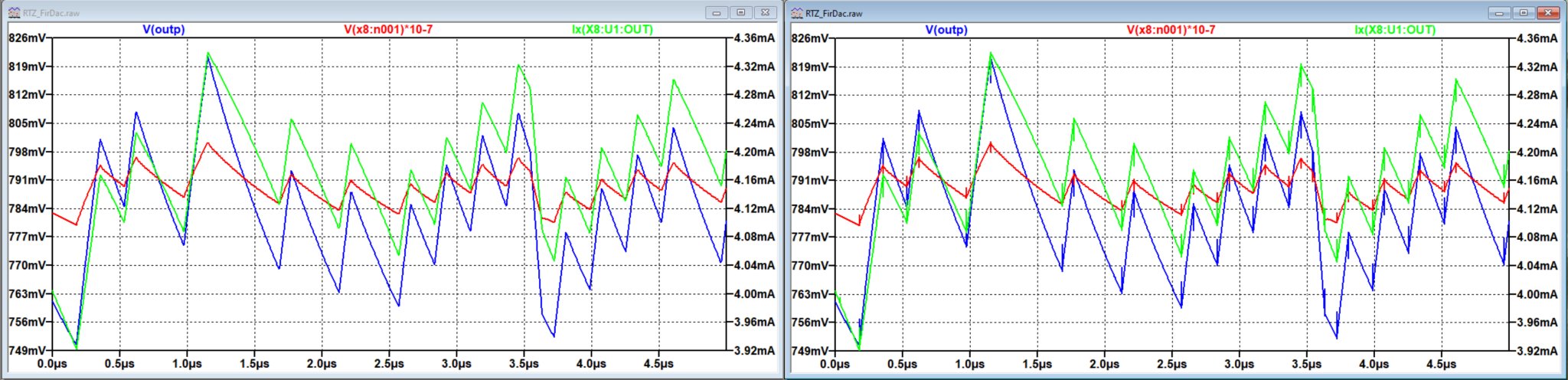

Before going into different DSD rates with even smaller timesteps, I first wanted to get a better feeling whether a more realistic 8.2nF cap as against an ideal version would make any difference.
That's why I added a 30mR series resistance and a 200pH series inductance, this according to Kemet specs for their 8.2nF NP0.
Result turns out to be rather obvious as shown in the attachment below, without at the left side and with these two series impedances at the right, where lots of spikes are visible at the moment the slope inverts its direction.
These spikes feedthrough all the way into the first OPA2210 op-amp.
Image was made with a 50psec timestep while processing the DSD256 1Khz@0dB signal.
Blue is the signal as measured on the 8n2cap.
Red is the signal on the inverting input of the OPA2210, connected with a 255R to the 8n2 cap, here for better clarity magnified by a factor 10
Green is the output current sourced by that same OPA2210 op-amp.
As such the voltage variations at the inverting input are seemingly well within range to avoid oversteering, but this is just a sim and the real thing may react different to these spikes.
@marcel, what is your view on this qua impact on the performance and could this be reason why noise becomes slightly worse when increasing the DSD rate?
Hans
P.S. I could also try Thor's filter and see what the OPA1632 makes of this 😊

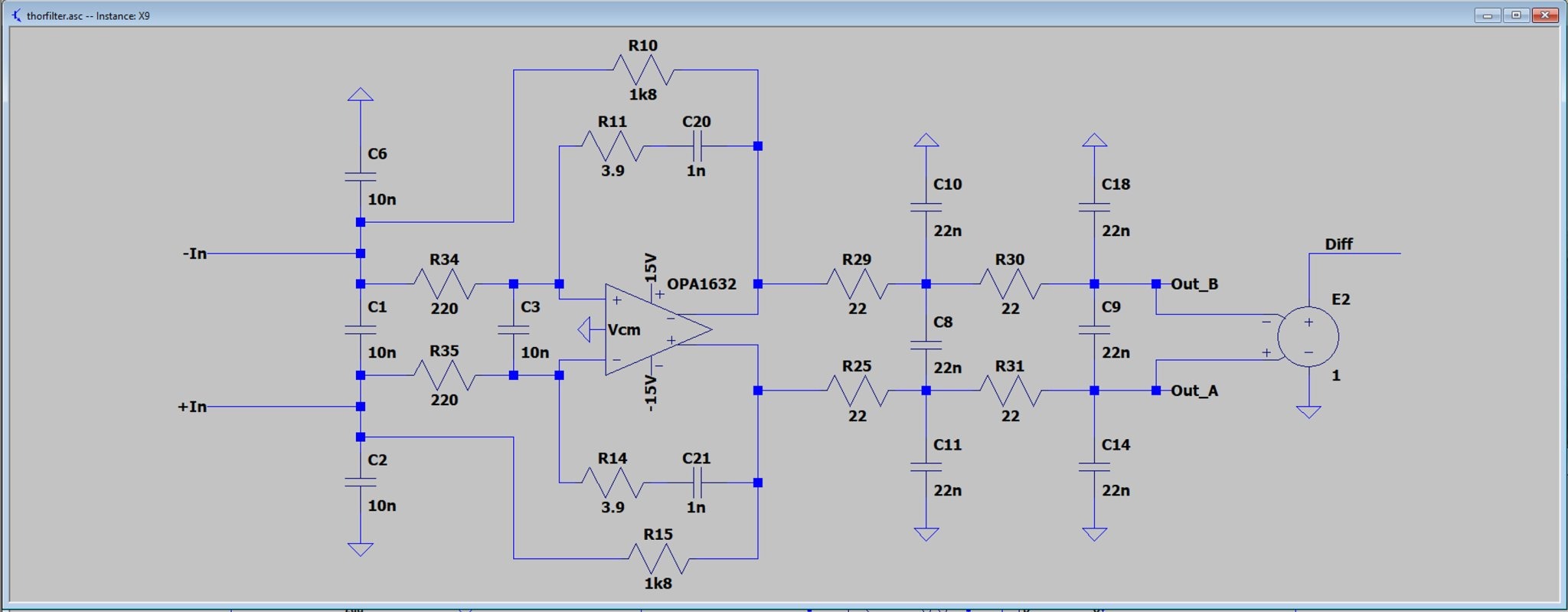

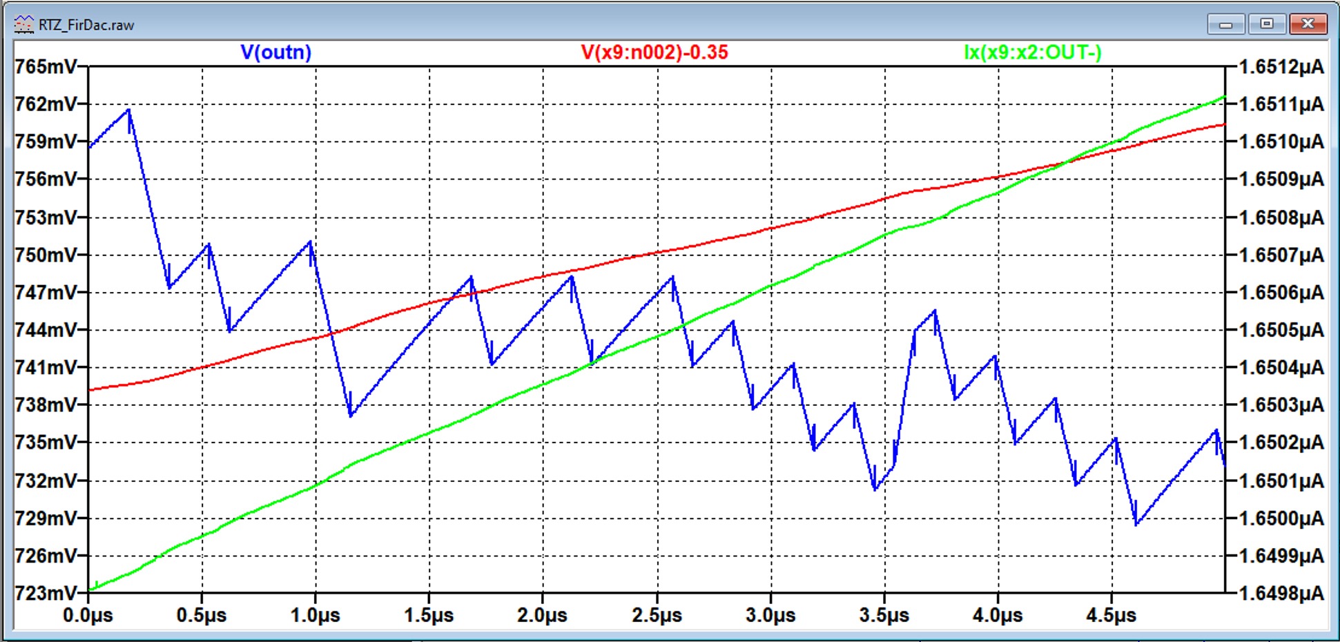

The same period as above, but now with Thor's filter, results in completely different waveforms because of the different topology.
The spikes at the point where the eight Firdac resistors enter the filter in blue, still have the spikes as before, but at the input of the OPA1632 in red all spikes are absent, but also the OPA1632's output current in green doesn't show any content of spikes just because the spikes from the Firdac's are in opposite direction and cancel each other.
This filter seems to be doing a superior job, kudos to Thor.
Hans

This is the one I used.Which filter do you mean?
Not yet optimised to have a perfectly flat response up to 80Khz, but representative enough to see it's behavior in the test I did.
