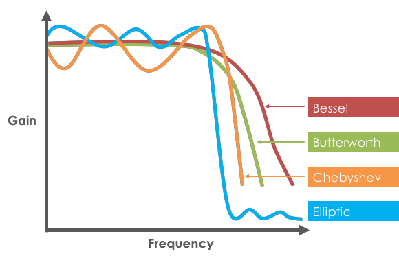

Well, put most simple, if you take (say) a sallen key or MFB filter and you change the relative relationships between components and their values, you create different filter responses, in what is fundamentally the same circuit, with equal numbers of poles and zeros.
In a FIR filter (or a FIR DAC, which really just is a FIR lowpass) the filter response depends on the number of taps and weight of each tap.
The DSC DAC or the RTZ DAC discussed here use equal weights, that is each tap contributes the same value. This produces certain filter shapes and also corresponding time domain response.
It generally is what in analogue filters we might call gaussian or bessel response (not literally) - a slow roll-off until it approaches the final slope. There is no peaking in the frequency response. It is also known as "rectangular window".
The slope of the filter itself depends on the number of taps and the stop band has ripples also depending on number of taps. But each tap has a a value of "1" (plus minus tolerance), no matter if it is a current source, or a resistor etc.
So in Marcel's DAC we have 4 Tap's and if we were to make a triangular window we might instead of 4 X 3.03 kOhm we might have two 2.2 kOhm (NPV) in the "inner" positions and 5.6 kOhm (NPV) in the "outer" positions.
We now have unequal weights and the response of our filter (but not the final order) changes.
Unequal weights generally give a a slope closer Chebyshev or even elliptical.
Where this gets interesting, for a given number of taps, unequal weight FIR DAC's allow steeper slopes of rejecting DS noise as well as jitter.
There are many math options on this which we may elect (not select - selection implies evaluation of actual performance while election is based on the expectation of performance) to deliver the best balance of virtues and vices.

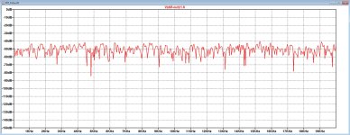

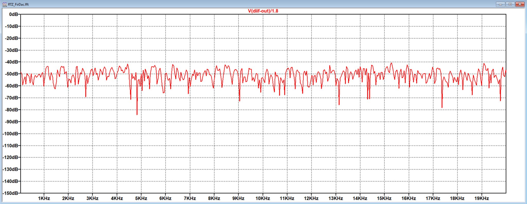

I processed in my model the first 262.144 samples from L and the same amount of 262.144 samples from R, or 8 blocks of each from a DSD256 .dsf file holding a 1Khz 0dB signal
But still no trace of the recorded 1Khz signal, but instead a huge amount of noise, see attachments.
I have tried with and without byte reversal, but without any success so far.
When playing this file over my audio set, it seems to work as expected.
That's why I have made 3 control files, one with 1110 1110 etc. to get maximum DC output level.
One with 0101 0101 etc. to get zero output
And one with 0001 0001 etc. to get minimum DC output level.
Note that this was sent from left to right, so with MSB first !
All three files work flawless giving resp. a seemingly noisefree 2.56Volt, zero Volt and -2.56Volt, exactly as it should be, so the model seems to be working properly
Still have no idea how to proceed but to proceed taking a next series of blocks, a rather cumbersome job.
