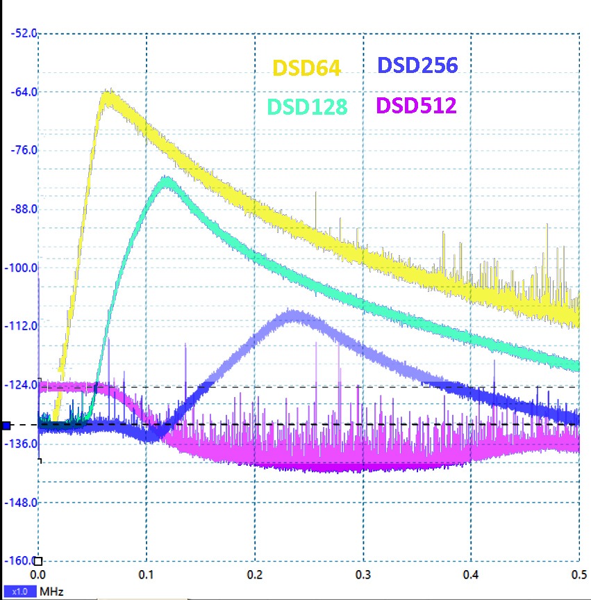

I've tried to work out my hypothesis about the out-of-band signals and the low-level distortion a bit further, see the attachment. I still can't exactly explain why the distortion products occur where they occur.
Impressive analysis.
I’ll try to see whether any of this can be detected in a simulation.
If so, changing the filter topology could give more insight.
Hans

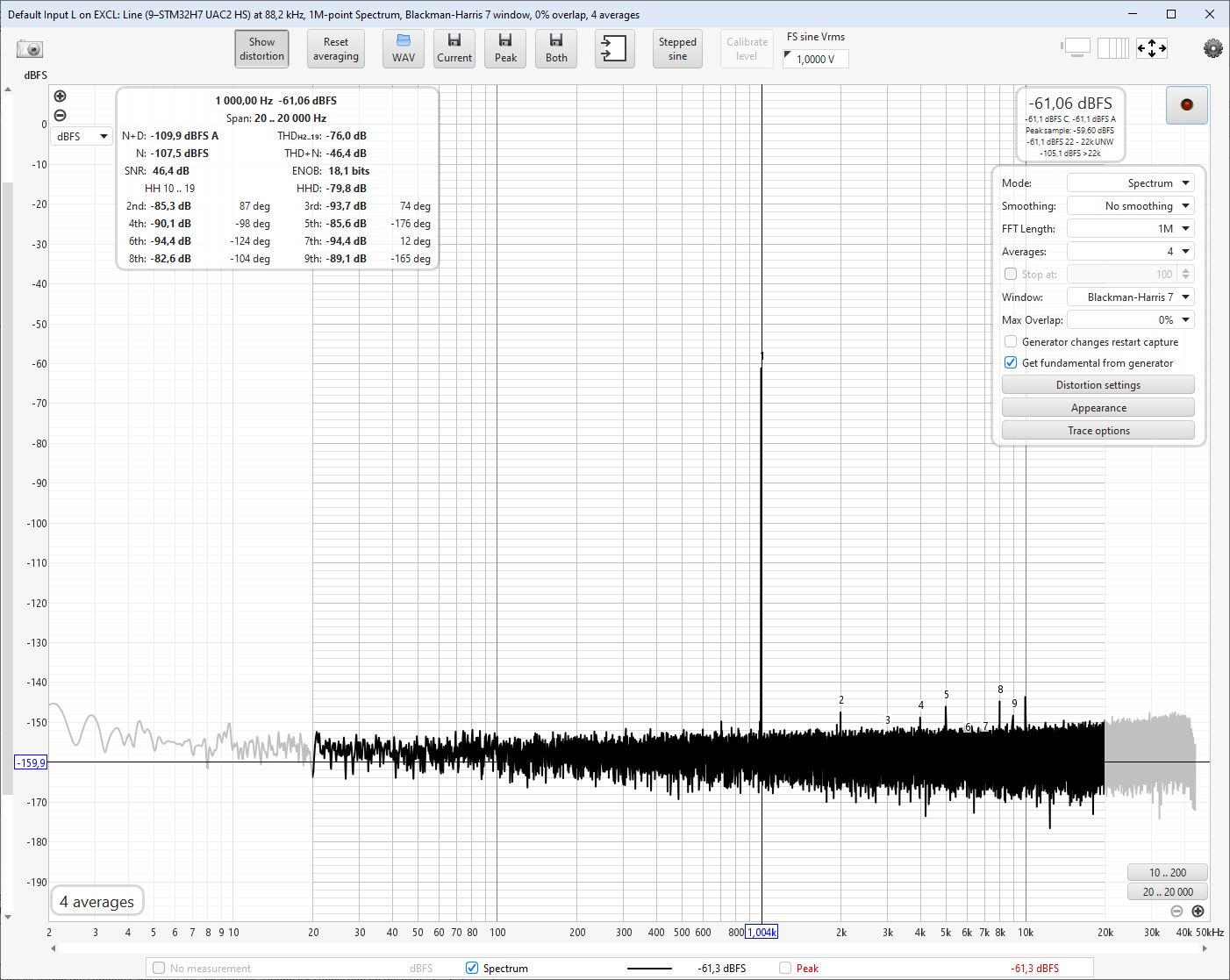

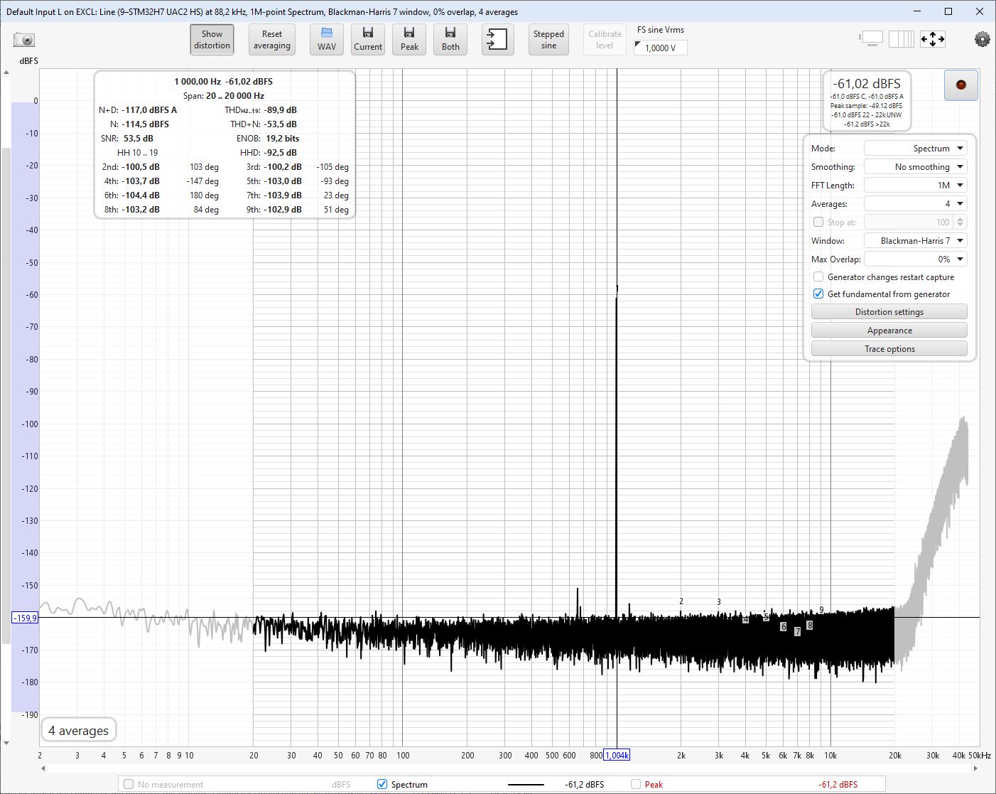

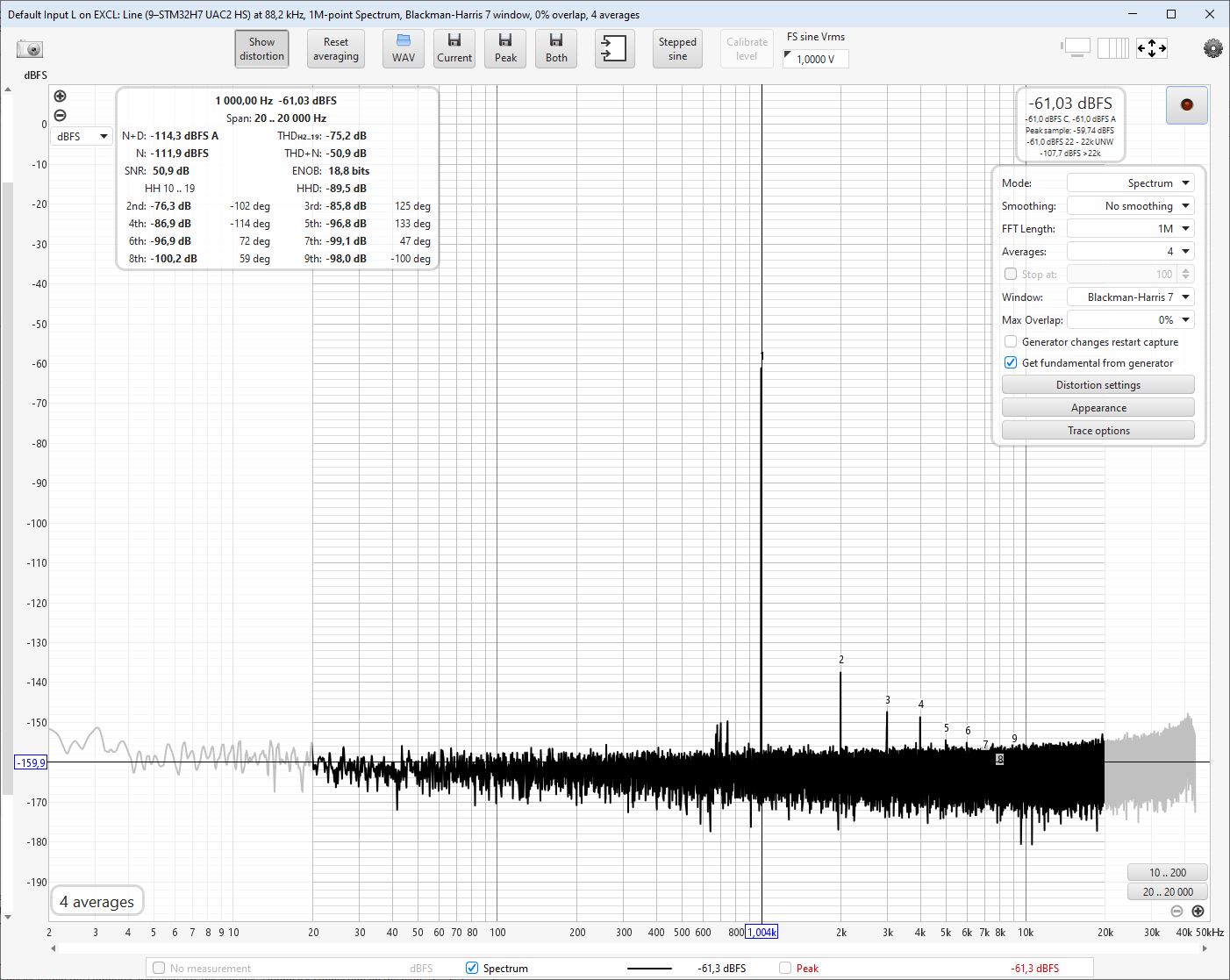

Here are measurements of 1kHz -60dBFS at DSD64, DSD128 and DSD256. The output stage is the dual OPA1632 "hat" I used in my output stage shootout. All signals were generated from sox 1kHz -60dBFS 44k1 PCM using sox-dsd with sdm8 filter. Player was foobar2000.
The low level distortion artefacts are clearly depending on the used modulator but sox-dsd with sdm8 seems to work well. These results look quite satisfactory to me.
The splitted harmonic peaks of PCM2DSD is my main concern as PCM2DSD is by far the easiest and most economic way to use this RTZ dac. Performance is very good apart from the splitted peaks.

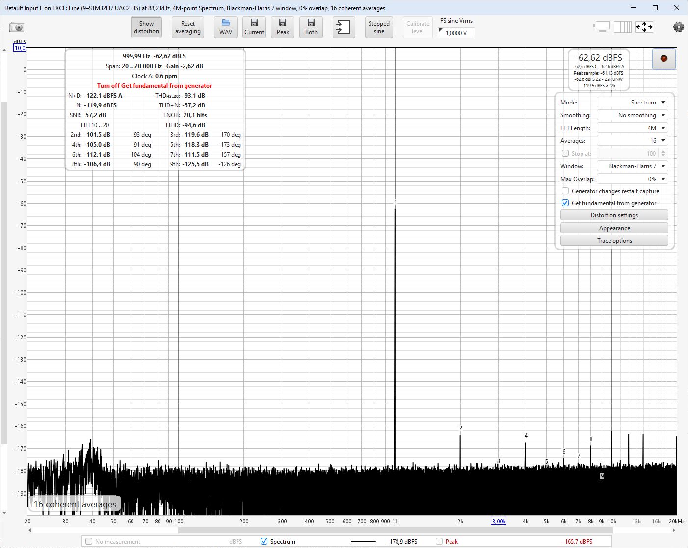

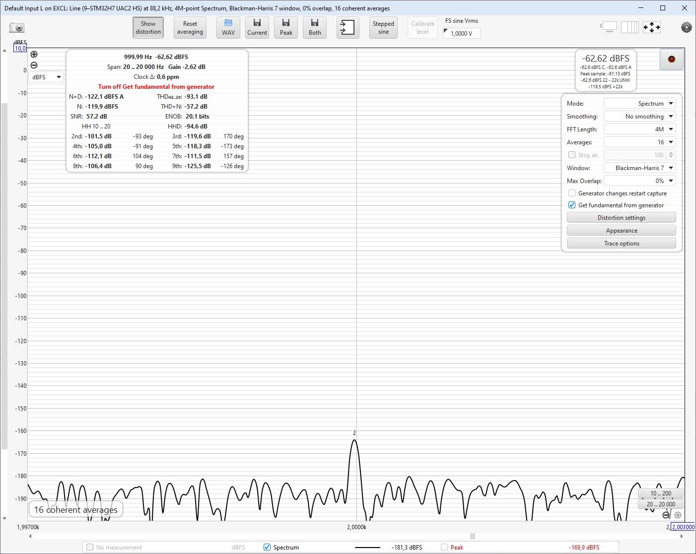

To verify that splitting of harmonic peaks only occurs with PCM2DSD+RTZ, here is PCM2DSD+AK4493 with coherent averaging to pull out harmonics. No splitted peaks as can be seen at 2kHz.
