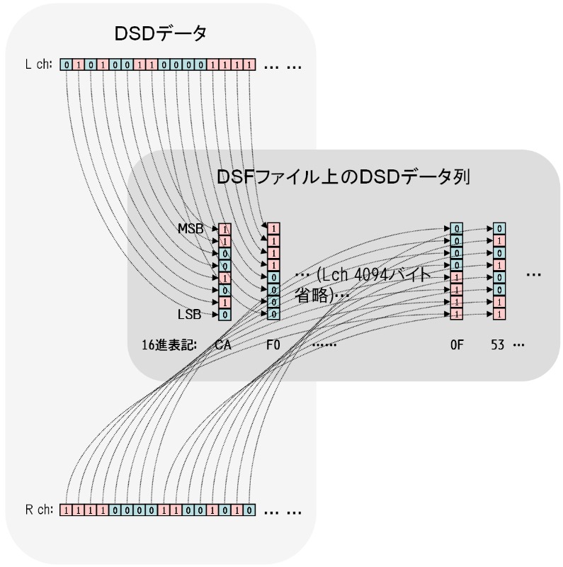

The specification also mentions that LSB first is used (1 bits per sample) so oldest bit is in each byte's MSB.
When you first put a single-bit sample in the LSB, then the next single-bit sample in bit 1, and so on, then the oldest single-bit sample is in the LSB. The oldest single-bit sample is the single-bit sample that came first.
Not according to annotation 4 in DSF specification.I thought 8 bit per sample just related to the DSD Wide format, also known as PCM Narrow: noise-shaped 8 bit PCM.
Based on annotation 4 LSB first means that oldest bit is stored in byte's MSB.When you first put a single-bit sample in the LSB, then the next single-bit sample in bit 1, and so on, then the oldest single-bit sample is in the LSB. The oldest single-bit sample is the single-bit sample that came first.
I only see that data have to be stored in the LSB first when "Bits per sample" is 1, which implies that the LSB is the oldest sample:

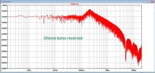

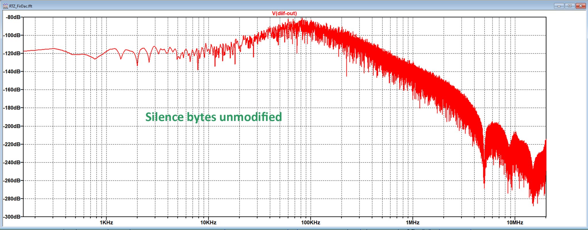

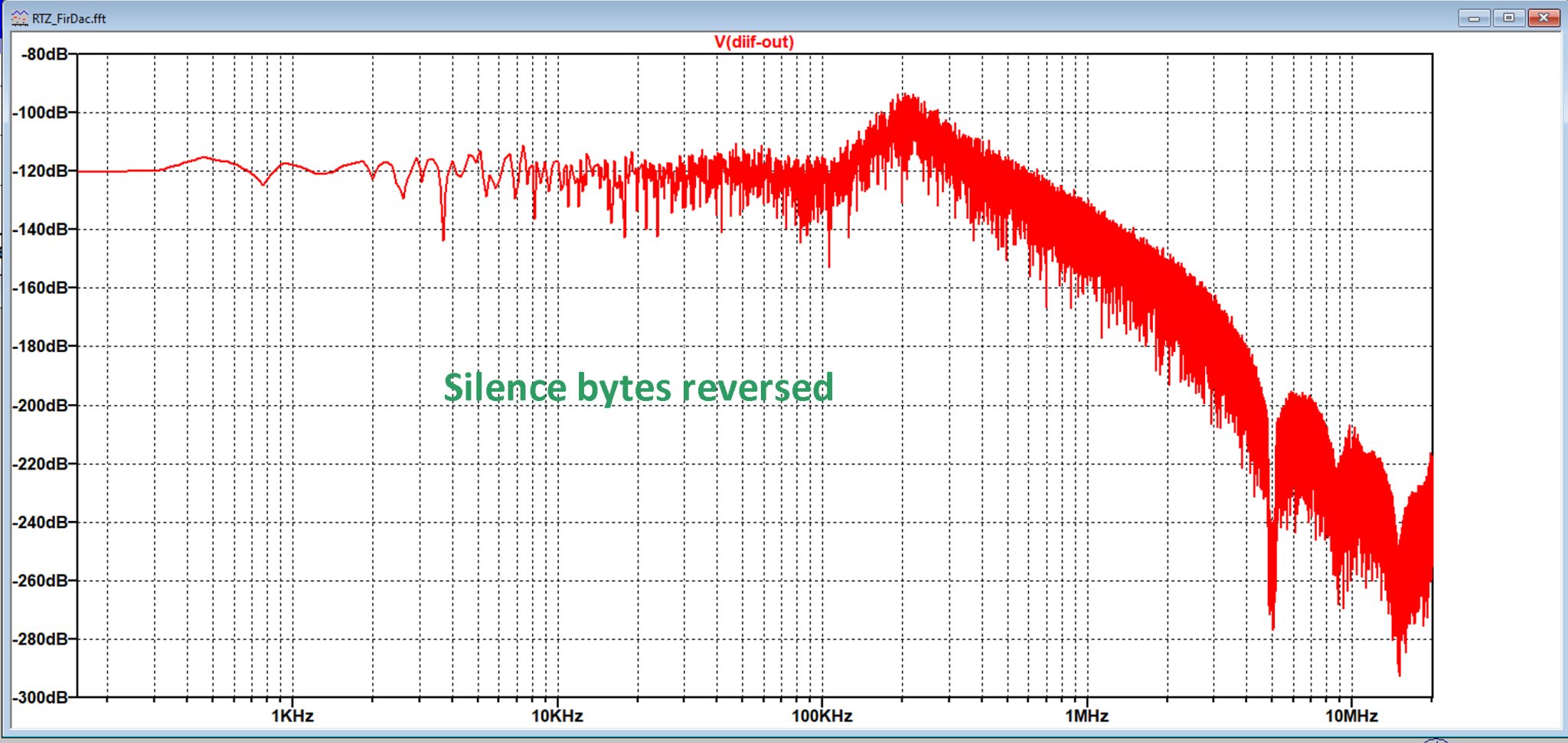

In the meantime I have implemented both options, so practice will show what difference it makes.
I have made two short runs with silence, first with bytes reversed second unmodified.
Looking at the spectra behind the reconstruction filter, I tend to think that the reversed version, being almost flat up to 100Khz is the right way to process.
I'm surprised how much impact this has.
Hans
P.S. this a file processed with 10Mhz.
