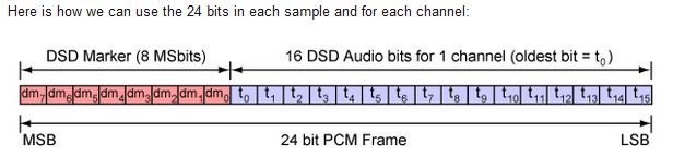

Just some info's I wanted to share.
I did some calculations on the DSD transfer rates and was surprised by the huge amount of processing in a restricted amount of time and also by the lack of markers within the .dsf file.
A .dsf file has a header of 91 bytes, telling all sort things like DSD rate, file length and other parameters.
The data starts as from position 92, where 4096 byte blocks are alternating for the Left and the Right channel.
Each byte in the data stream has to be reversed, so 0111 0001 becomes 1000 1110.
When I'm right, when sending DSD over DoP, to each set of 16 DSD bits, eight additional PCM marker bits are added to get a 24bit PCM frame.
This increases speed by 24/16 or a factor 1.5 giving a transfer frequency for DSD64 of 8.467,200 Mhz (or PCM 176,400 Khz) and for DSD512 over PCM of 67.737,600 Mhz (or PCM 1.411,200 Mhz).
The converter will have a complex job in extracting the 16 DSD bits from each frame, reversing the bytes, storing a 4096 byte block to get the left and the right channel bits released at the correct parallel time and to produce a stable bitclock.
A bitclock for DSD64 is at 2.822400 Mhz and for DSD512 at 22.579,200 Mhz leaving in that case ca. 44nsec processing time for each set of output signals while doing the whole job as described.
So it seems almost not as a surprise that the Amanero is not fit for that demanding job at DSD512, resulting in a flawed channel and substantially more noise, because possibly several bits are not properly recorded and/or stored or because of internal crosstalk problems.
Also when somewhere in the process the selection of the 4K byte blocks gets shifted, parts of one channel will get into the other channel which will lead to strange anomalies.
I won't say his this is the case here, but a DSD file has no marker "end of 4K block" or "start of 4K block", nor does it tell that it concerns Left or Right.
When the synchronization gets lost somewhere, it will proceed until the end.
Hans

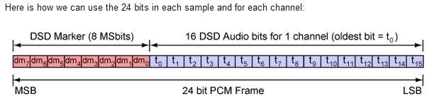

Hans

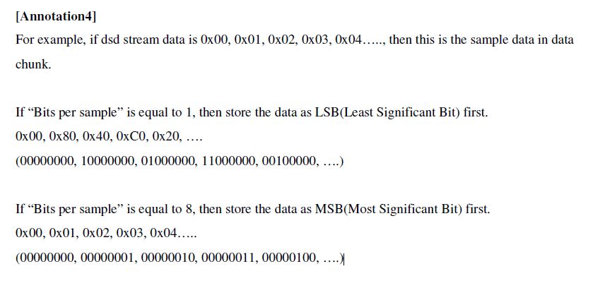

In DSF file data is stored LSB first (if "bits per sample" = 1) so actually LSB is stored as MSB in data bytes. As data bytes are sent MSB first to DAC there is no need for reversing bits in bytes.Each byte in the data stream has to be reversed, so 0111 0001 becomes 1000 1110.
You may be right, but that’s not what the specs are telling.
As a matter of fact, in a 1 bit datastream there is no MSB or LSB. 🤣
I think the spec is quite clear on this. Below is annotation 4 from
https://dsd-guide.com/sites/default/files/white-papers/DSFFileFormatSpec_E.pdf
Besides as I have implemented USB-to-DSD interface I know there is no need for reversing bits in bytes 😉
What matters though is endianness.
O.k. Thx.
In my .dsf files I have bits per sample 1.
So I read this as having to reverse all bytes, true ?
Hans
Hans
I see what you are telling, but find this at least very confusing when looking at the specs.
Maybe others can give their opinion on this.
But thx anyway in paying attention to this item.
Hans
