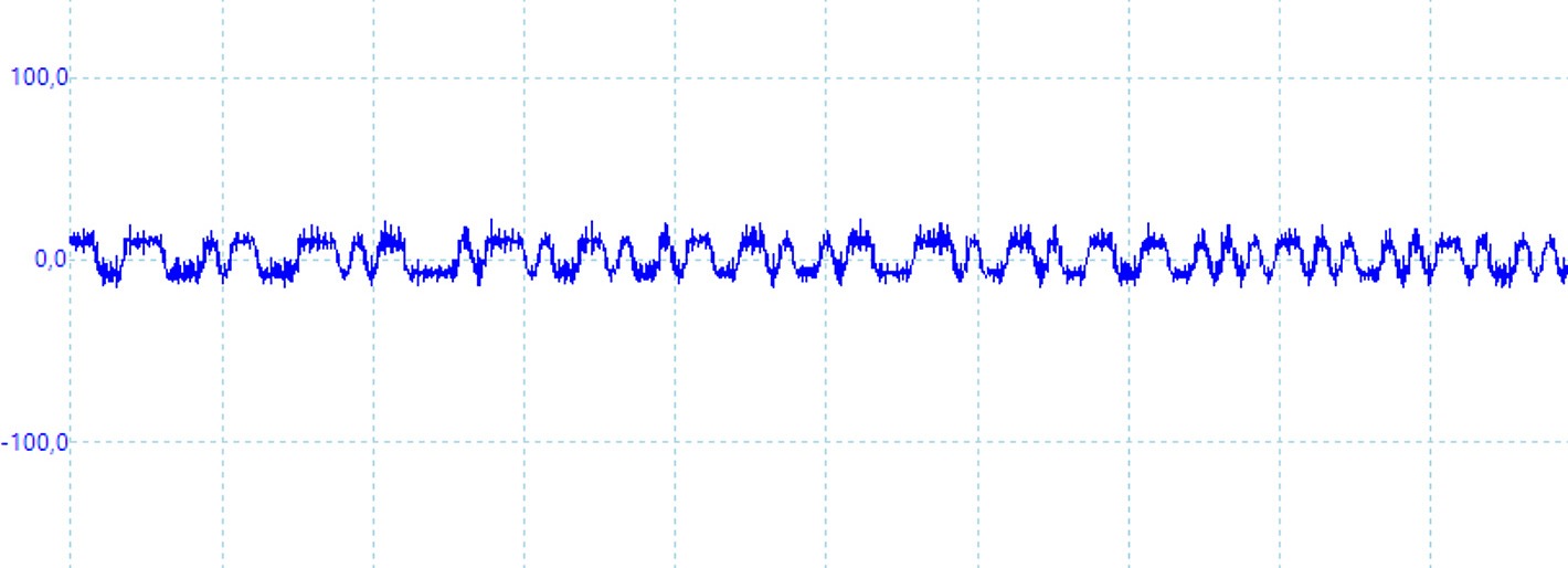

In the meantime, waiting for the next sim to be ready, I went back to at an earlier measurement that I made on one of both 8n2 caps with a DSD512 recording with a 4nsec sampling interval on a 1usec/div time base.
Spikes in this case are clearly visible, so It may be an idea trying to get similar spikes in my simulation.

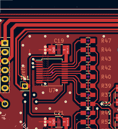

Changing the subject a bit and with regard to spikes, here is a section of the dac PCB surface:
I will describe a problem I found in a different dac-related circuit and a possible dilemma: Shift register bypass currents are forced through vias (bypass cap is C19, U7 is the shift register). IME, that causes more noise problems than if bypass currents are kept more on the surface layer. A decision was made to route the shift register signals on the surface, and to duck the bypass currents down through a lower layer. I'm not sure what would happen if the opposite strategy had been used, which would be to use solid surface fill under the shift register chip as a low inductance bypass current path. To do that would require ducking all the data signals down through a lower layer. Which approach would be worse in terms of shift register output noise? Well, one problem is that noise could be added to the data signals which are also the dac outputs.
Another possible approach to clearing up the fill area under the shift register might be to rotate the chip by 90-degrees and route the data signals around one end of it in sort of a Y-shaped path. Propagation delays would be longer, etc., but without trying it and or EM field simulation its not clear if there might be some solution to be found in that sort of way.
The above having been said, don't know offhand which strategy would be best/worst in the end. Again, its just that IME there can be considerable benefit to keeping bypass currents on the surface layer through a direct path.
Using vias with bypass capacitors is common practice.

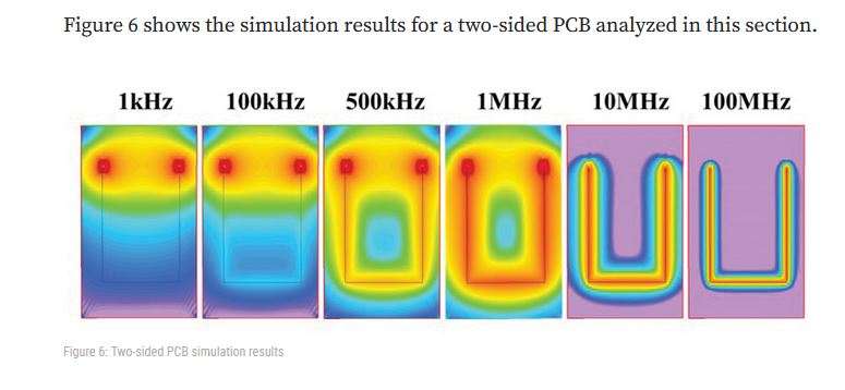

IMO what is questionable with Marcel's layout is that ground plane has slits beneath the shift registers. These may cause noise & reflections for critical signal traces above the slits. For HF traces return current path is beneath the signal trace. (second picture is from https://incompliancemag.com/alternative-paths-of-the-return-current).

Regarding via inductance, its usually the reason bypass caps are limited to no more that .1uf or .01uf. Any bigger than that tends to resonate with via inductance and cap self-inductance (usually vias account for a lot of the inductance). If we need 22uf bypass caps, then we might want to reconsider using bypass vias. Slowed bypass current propagation time also may increase transients in data signals.
Regarding signal routing complications, we might be better off with a 6-layer board.
On the subject of ground plane discontinuities under a digital signal, among other factors the amount of signal reflection depends on the highest frequency present in the risetime of the signal, and how much of the highest frequency signal's period is spent passing over the discontinuity, given the signal's propagation velocity. Also a small lumped discontinuity may be used for impedance matching in the steady state case. Doesn't mean there won't be some emissions if circuitry is unshielded, since there are always some emissions anyway. The usual concern is keeping emissions under regulated levels without requiring costly shielding mitigation, etc. Moreover, given this is a dac with a doubled clock, and given that dacs sometimes benefit from less than the fastest possible risetimes, at least we aren't dealing with frequencies as high as some PCB designers have to be worried about.
Understood. However in this case the ground pin of shift register is connected to the ground plane with a single via. The sum of the via inductances for the bypass current to flow is part of what resonates with the bypass capacitance to create a resonant circuit that causes bypass impedance to vary with frequency. At least that's the model people commonly seem to use.
Assuming the parallel vias at the bypass cap and the large capacitance holds the power pin of the IC pretty steady, it may be the ground pin that will be doing most of the bouncing around. It would presumably produce a common mode noise for the output stage to deal with.
