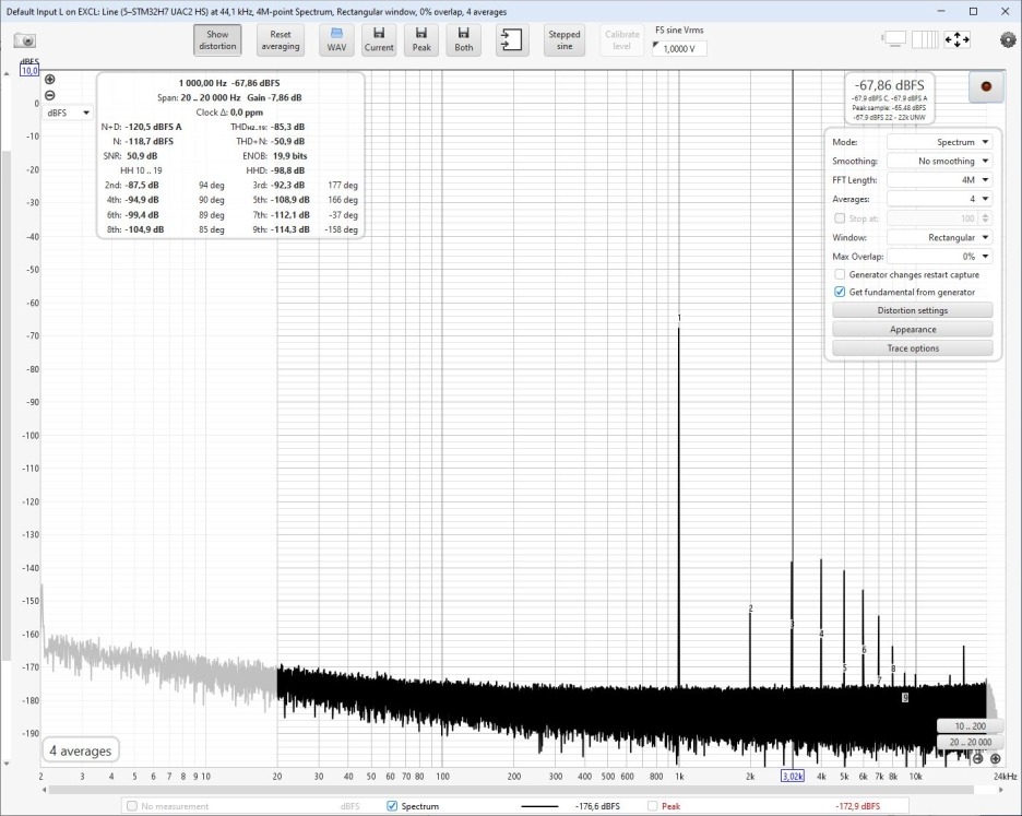

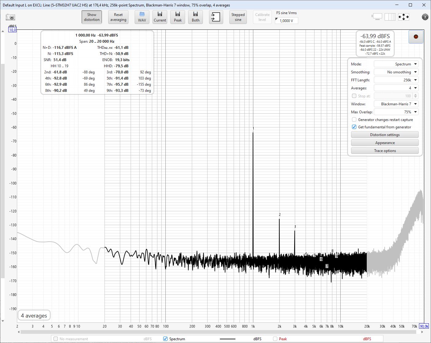

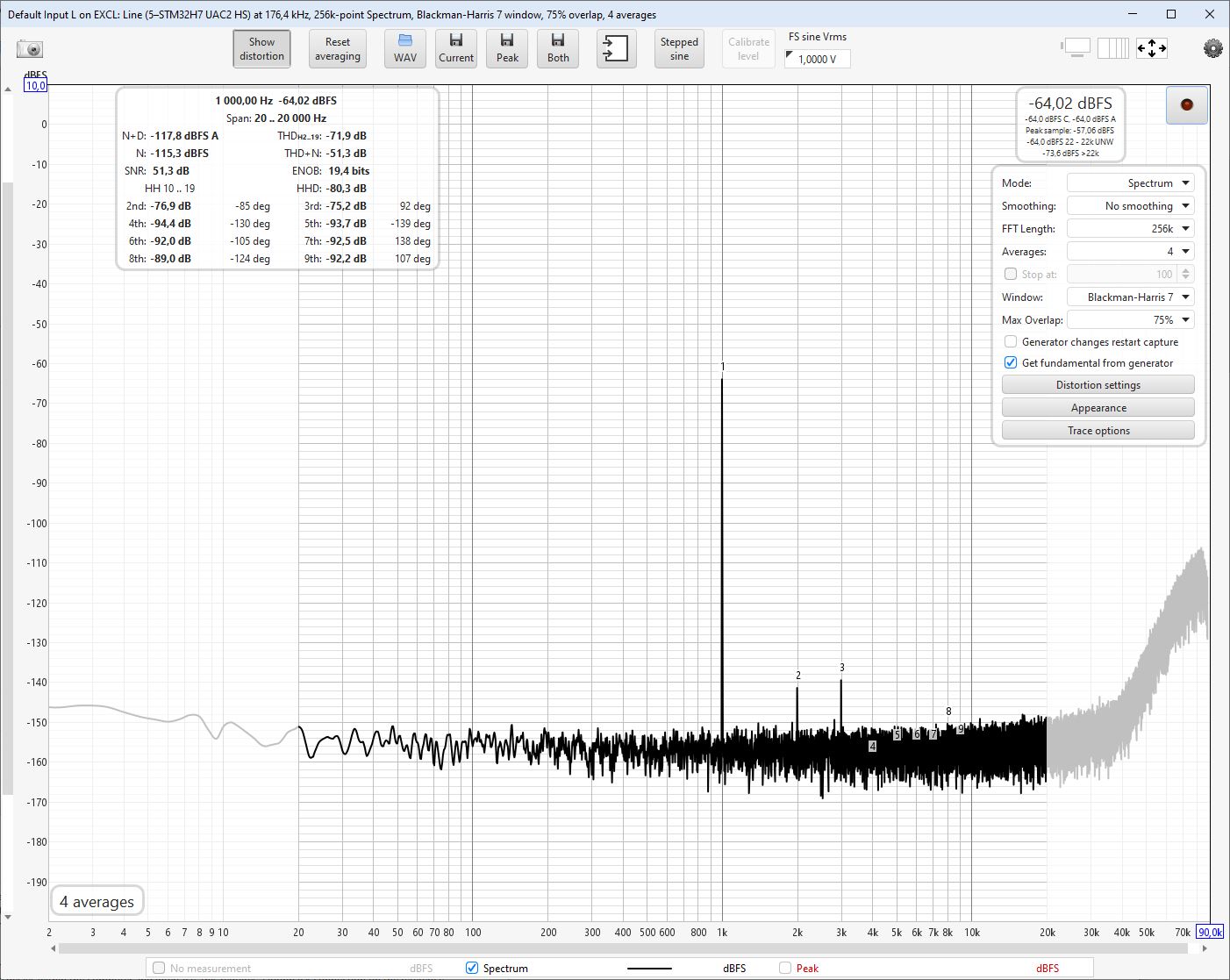

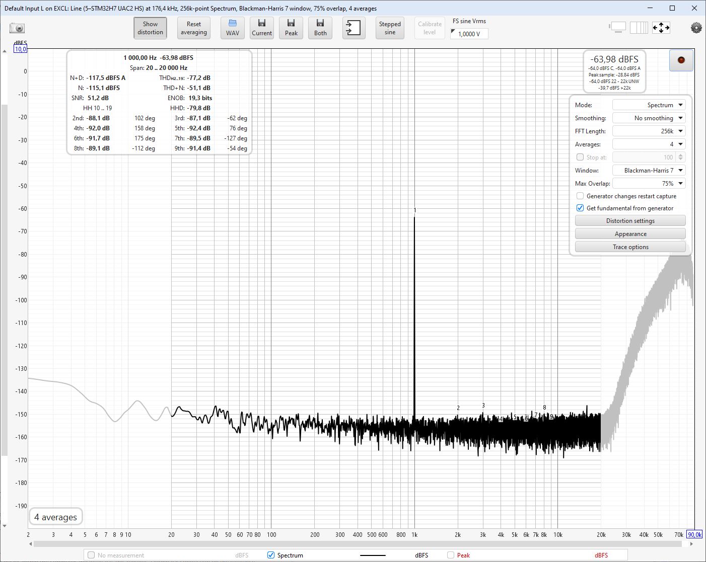

Some time ago I noticed that Marcel's RTZ dac has quite a bit of distortion at low levels.
E.g. here is 1k -60dBFS with PCM2DSD (host -> USB-I2S -> PCM2DSD -> RTZ).
Further testing showed that this distortion has frequency dependency. I.e. it is pronounced between 500Hz to 3kHz. First I assumed this has something to do with PCM2DSD but the same setup with AK4493 (host -> USB-I2S -> PCM2DSD -> AK4493) resulted in immaculate FFT.
This lead me to test various alternatives: output stage, Vref, (re-)clocking, psu. But to no avail. It seemed that low level distortions are somehow intrinsic to the design. Marcel pointed out that other modulators than plain single-bit modulators would work better and that turned out to be true. More about that on next post.
Back to PCM2DSD. At some stage I noticed that the distortion number and FFT peaks in (picture) did not match. Also the distortion indicator numbers where not on top of peaks as they should be.

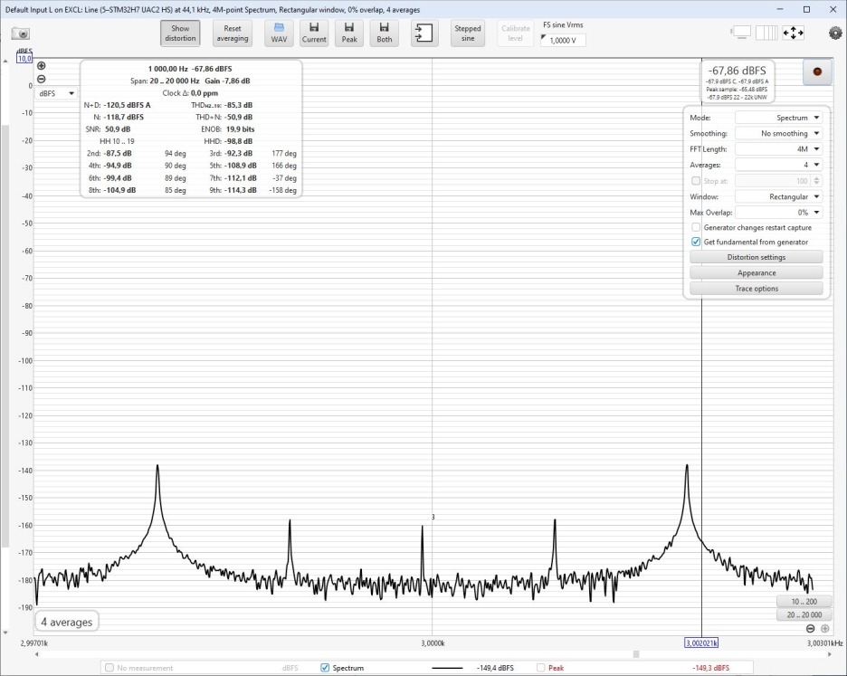

Zooming in on one of the peaks revealed this:
So in addition to the harmonic distortion peak there are additional peaks at about 1 Hz apart. Same occurs on all harmonics. Marcel promptly suggested that this is probably due to a small digital DC offset. I tested this by adding "artificial" digital offset to PCM samples at USB-I2S which indeed produced similar splitted peaks. I also verified that without PCM2DSD, i.e. using DSD output from USB-I2S directly, there were no splitted peaks. So PCM2DSD seems to be the culprit.
I have notified PCM2DSD developers about this possible DC offset. It probably does not impact NRZ dacs so it has gone unnoticed. But hopefully they can come up with a fix.

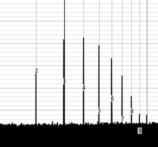

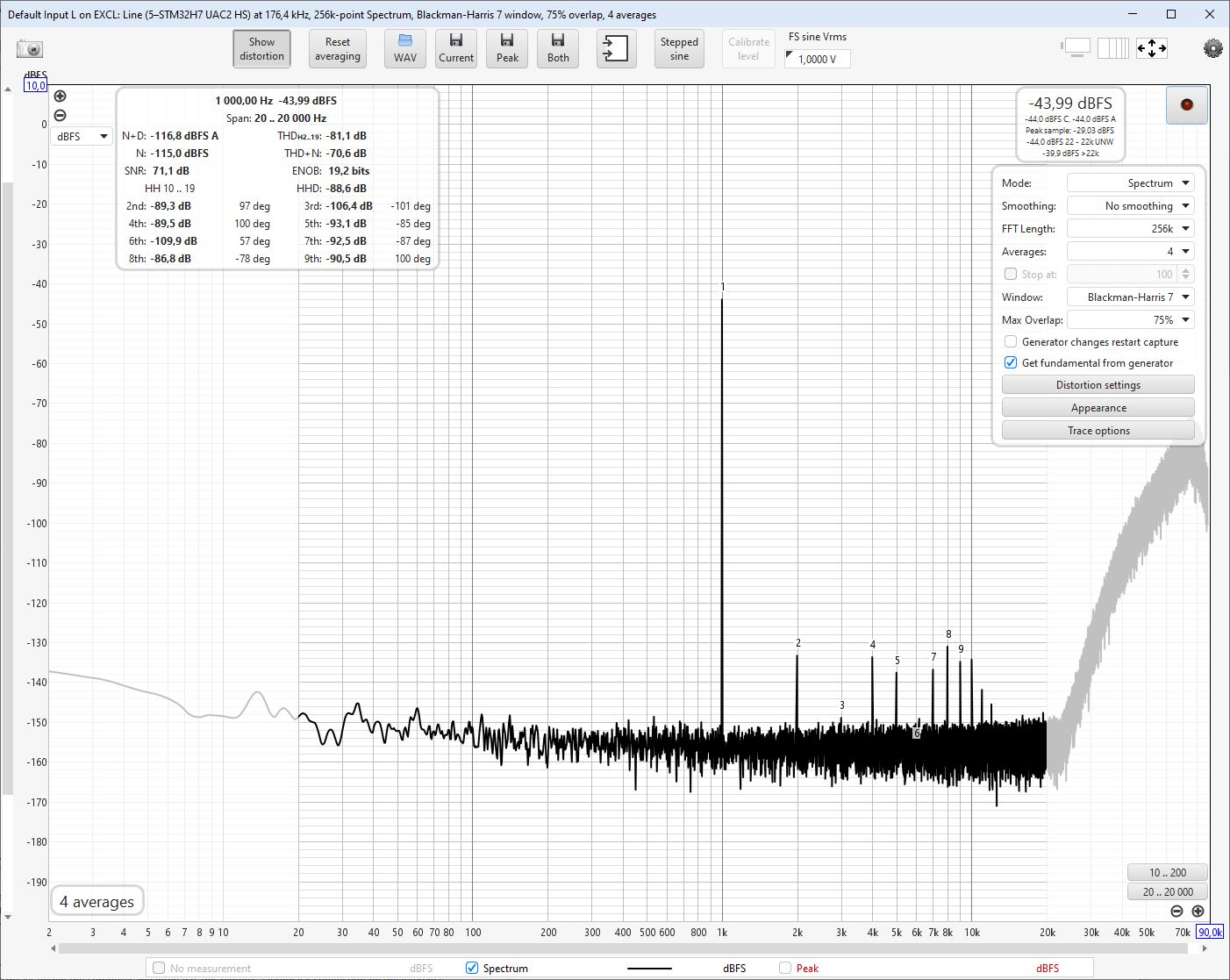

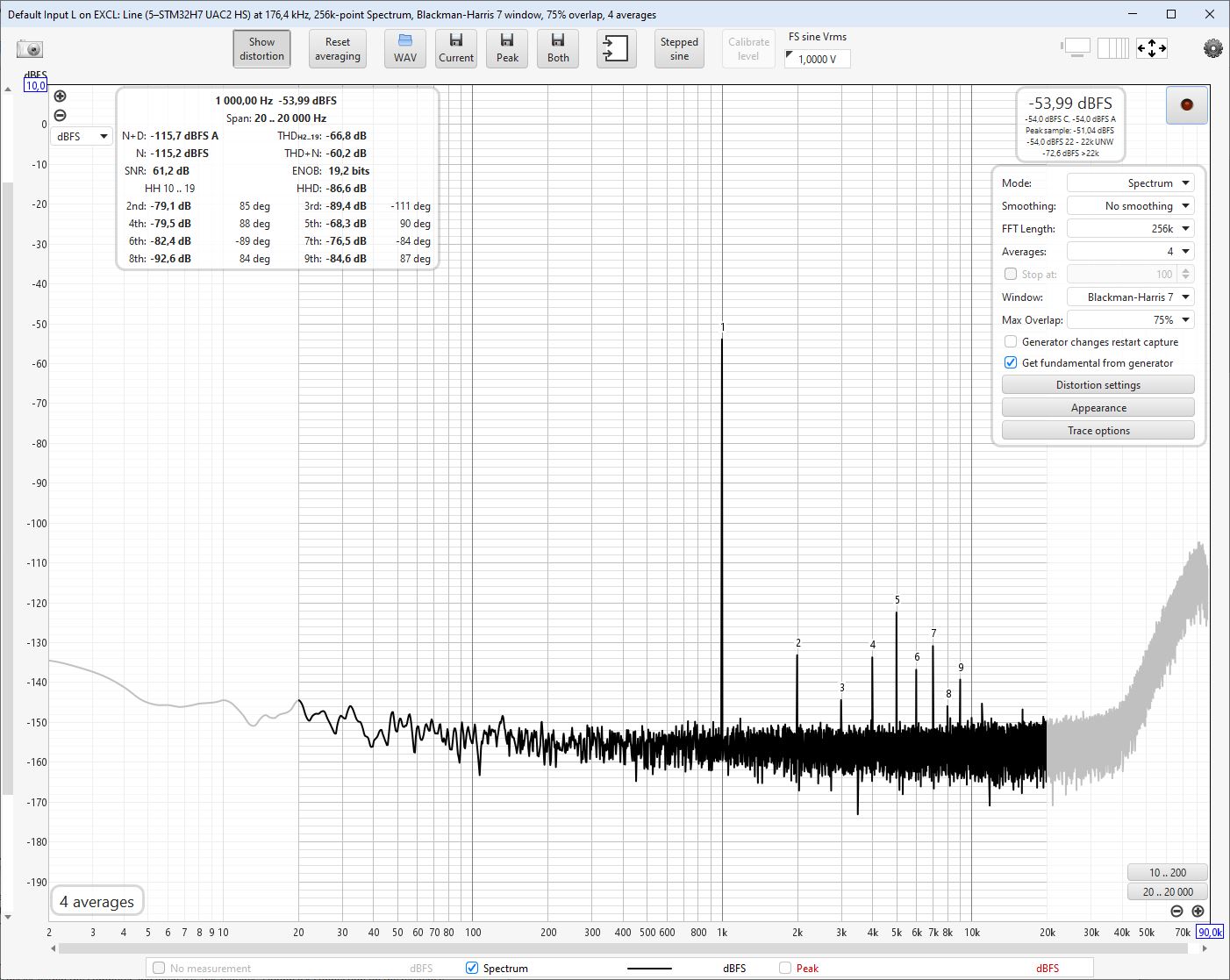

As mentioned in my previous post this RTZ dac seems to have somewhat pronounced distortions at low levels. This is probably related to additional FM-like tones generated by the modulator. Marcel has a plausible theory on this but I leave it up to him to explain it in detail.
This issue has a clear dependency on the modulator. Different modulators produce different levels of distortion. To test this I generated test signals with sox. First to to PCM format and then converted to DSD format using sox-dsd with sdm-8 filter. Here are distortions with DSD128 at -40dBFS, -50dBFS and -60dBFS using HQPlayer's "ASDM7EC-light" modulator.
Although distortions are higher than e.g. with AK4493 these are most probably not audible. So this is mostly an "academic" issue.

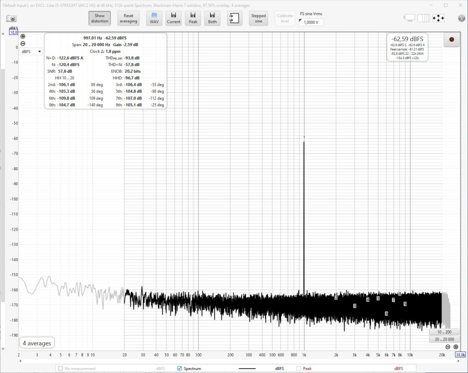

Anyhow according to Marcel properly dithered quasi multibit modulators just produce shaped noise so they should have lower distortions at low levels. Here are same measurements but with HQPlayer's "AMSDM7 512+fs" modulator.
Distortions are clearly lower especially at -60dBFS.
So it seems quasi multibit modulators work better with this RTZ dac. Those who use HQPlayer should try AMSDM7 modulator. However it is computationally more complex so online conversions from PCM to DSD256 or higher require a top-notch computer.

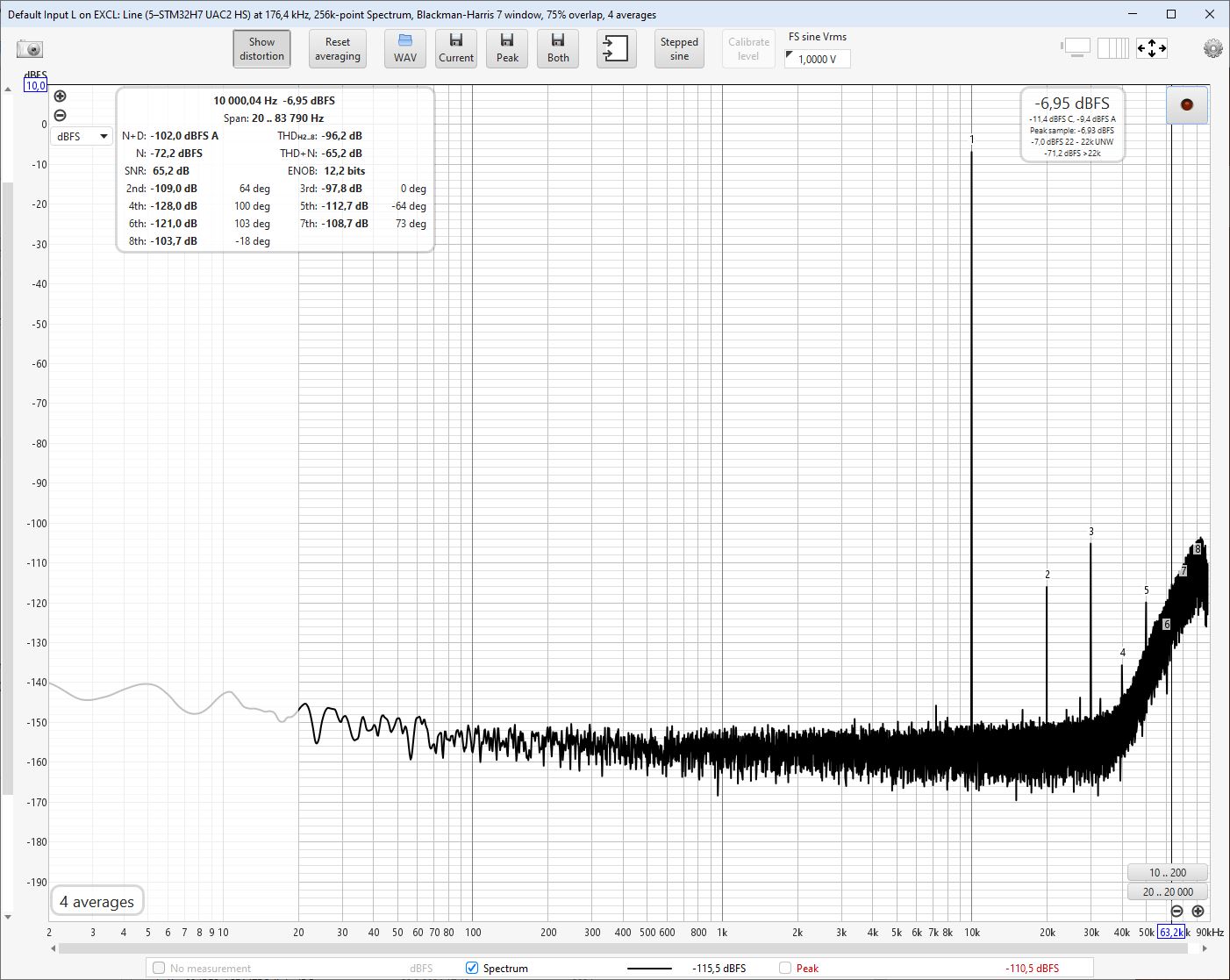

Back to the output stage shootout.
For this test I made 4 output stage "hats" that could be fitted to my main RTZ board.
This is the lineup:
1. stock
Although I made a "hat" for this as well I run out of components so stock output stage in this test is the R-channel on the main RTZ board. Other output stages are fitted as hats to L-channel on the main RTZ board. In theory this should give stock filter a more optimal layout with better ground planes.

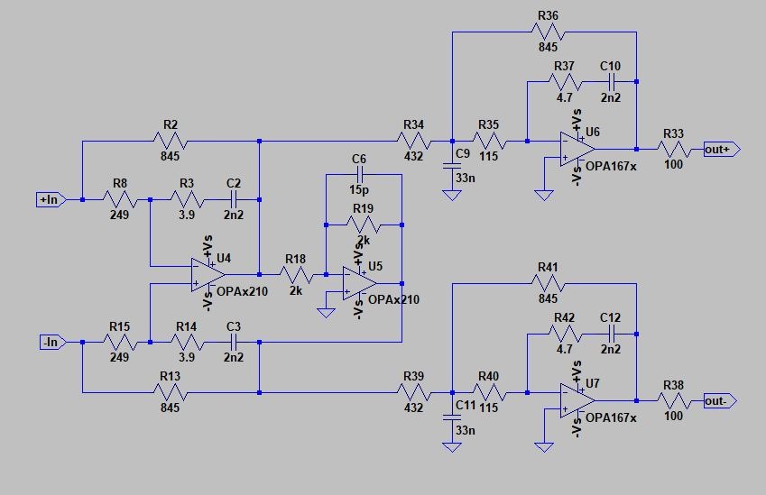

2. ThorstenL's suggestion (based on Birt)
This output stage is based on what ThorstenL simulated in post #2150 although without the passive input filter.
Here is the schematic.

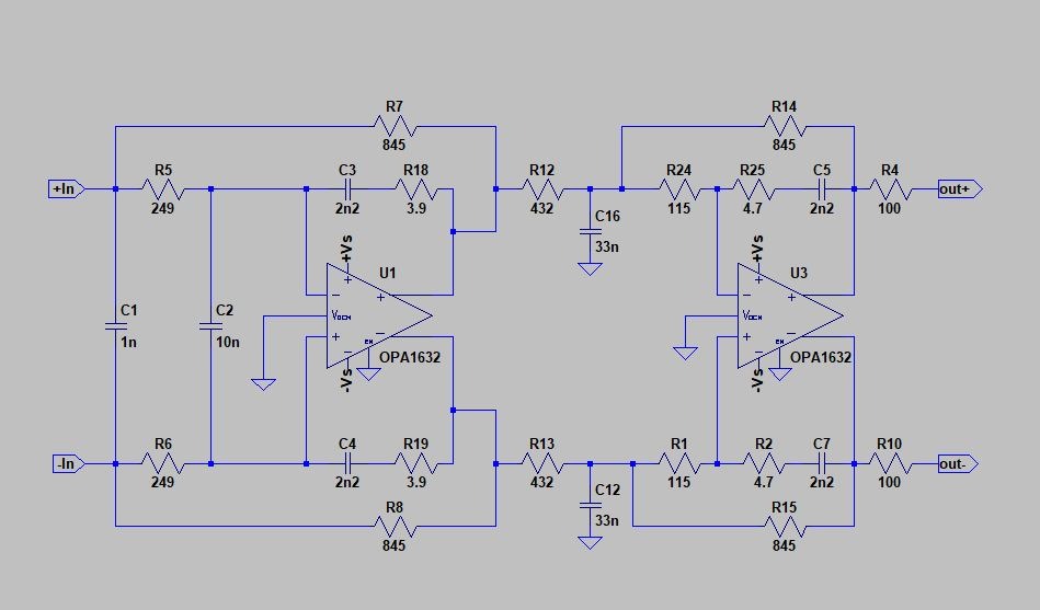

3. Dual OPA1632
This is more or less what I tested in post #2148 but modified to have same filter characteristics as stock.

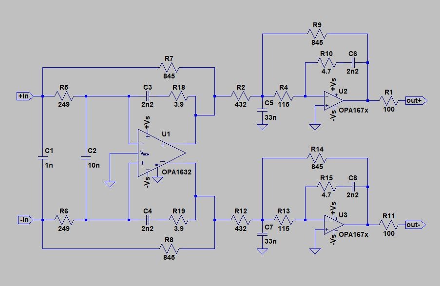

4. OPA1632 + OPA1678
Basically the same as 3. but with OPA1678 as second stage. I included this to test Marcel's second-stage-distortion hypothesis.
All output stage hats were implemented as 4-layer boards. Passive components were matched to 1% or better.
The test setup was this:
Player: HQPlayer 5.5.1 running on battery powered laptop. Output format set to DoP.
USB-I2S: my STM32H723 board
ADC: my ES9822PRO board
I2S-USB: same as USB-I2S

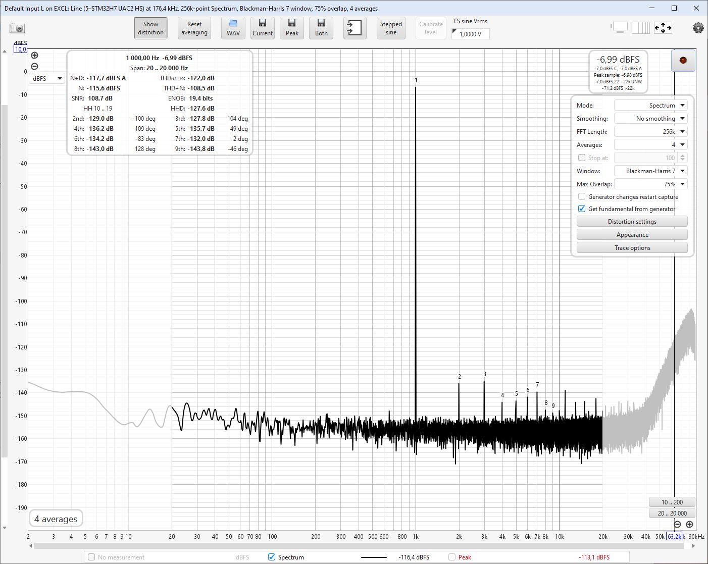

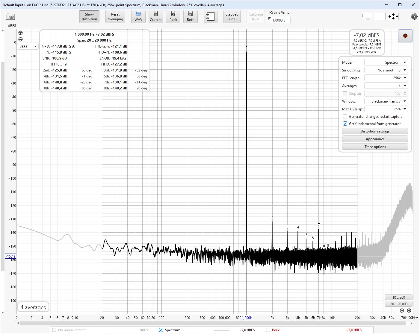

Test signals used in this test were these:
10kHz at 44100Hz -3dbFS
1kHz at 44100Hz -3dBFS
1kHz at 44100Hz -60dBFS
Test signals were generated with sox in the same fashion as in my previous post. I used DSD128 bit rate.
Modulator used in HQPlayer was ASDM7EC-light.

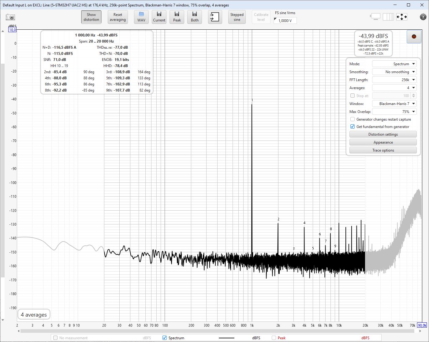

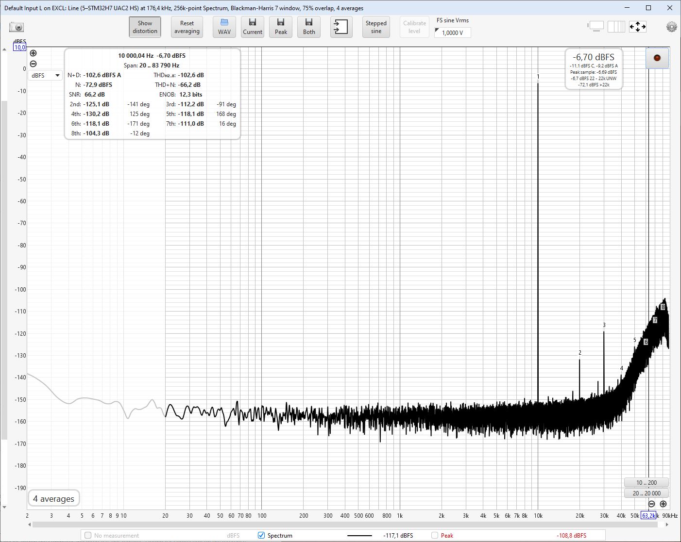

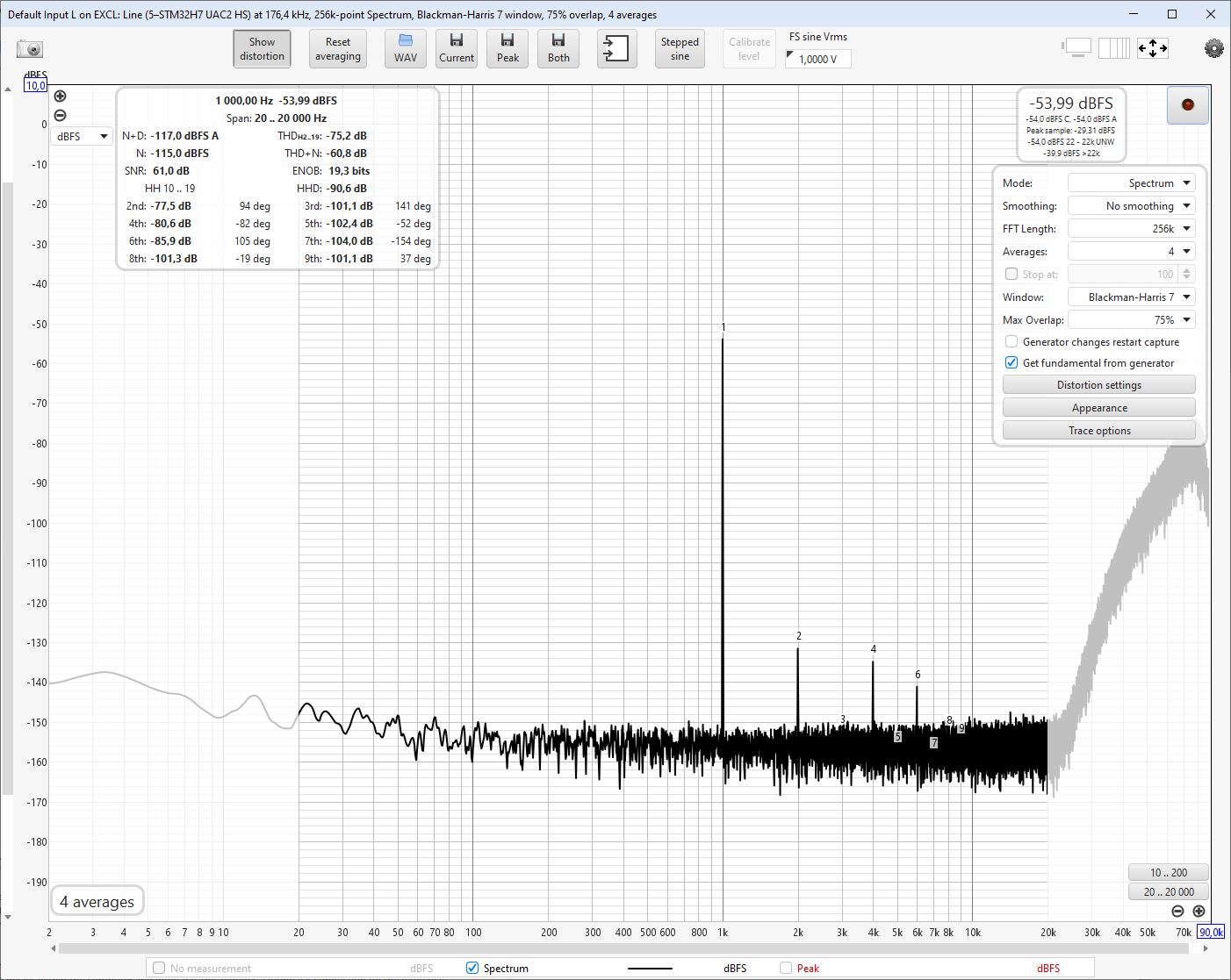

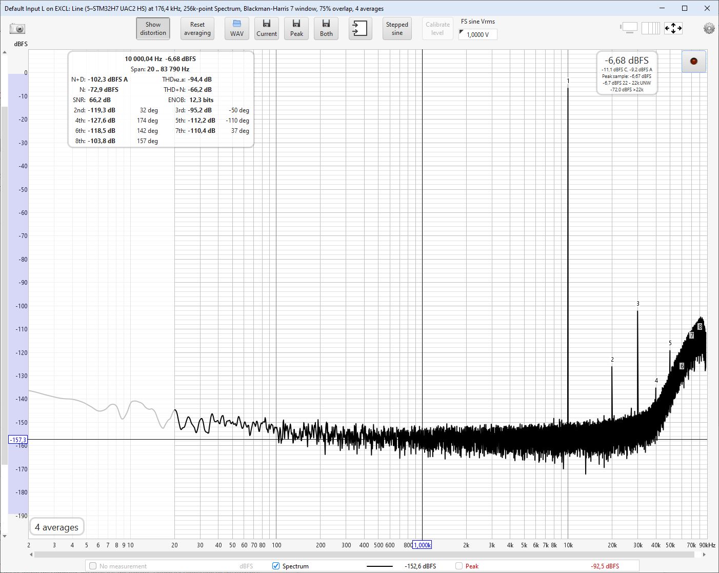

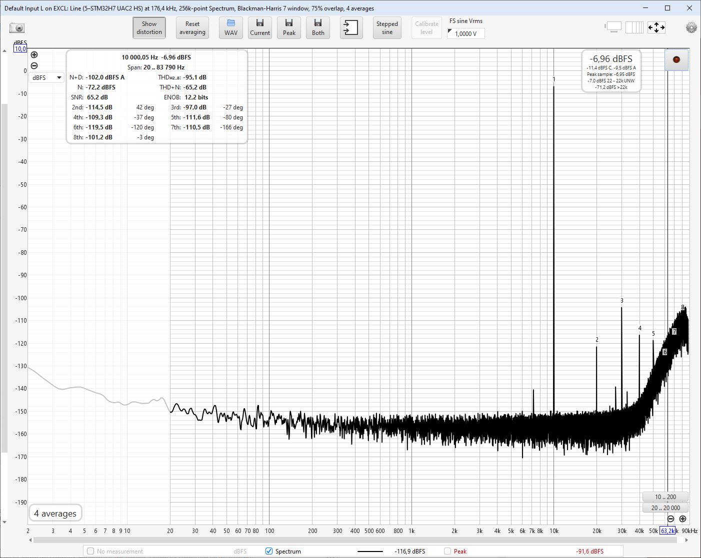

Based on this test dual OPA1632 has lowest distortions at 10kHz. The 4th filter with OPA1678 as second stage was clearly worse than dual OPA1632. This seems to support Marcel's second-stage-distortion hypothesis. Also filters 3 and 4 had more passive filtering before the first opamp. Adding passive filtering as ThorstenL suggested to stock or Thor's filter would very likely improve those filters as well.

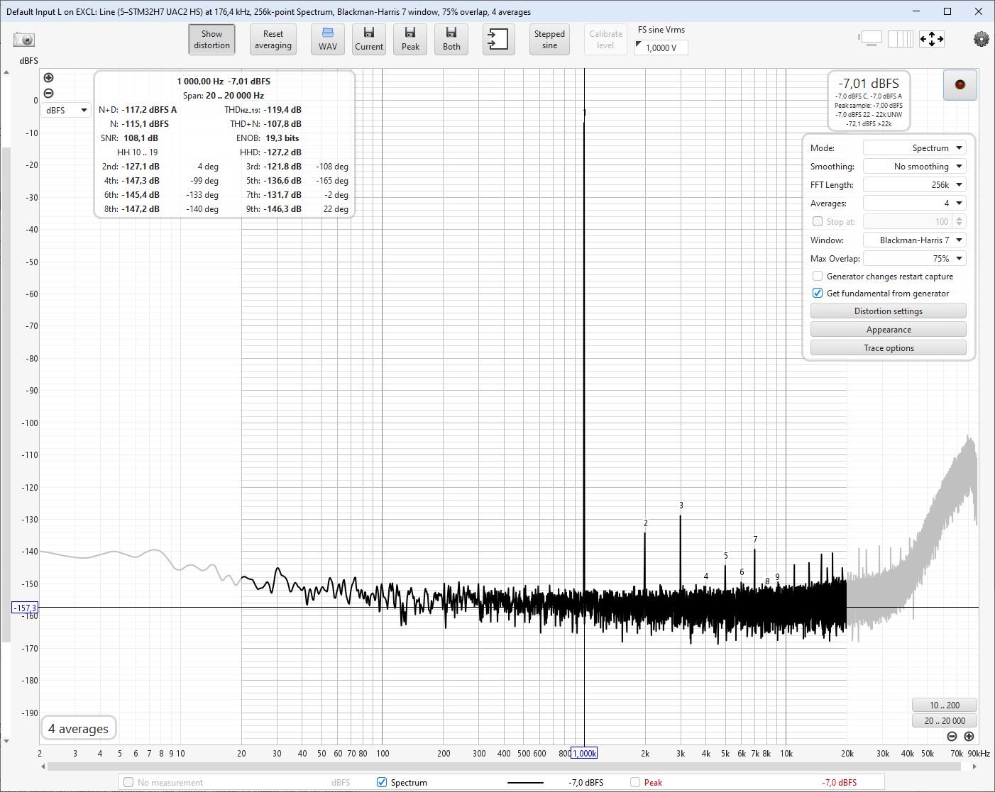

At 1kHz differences were much smaller.
