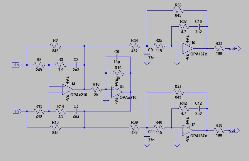

Here is the schematic.
Two notes, first, naturally the second stage should also have used "Birt" and a common mode + diff mode MFB filter.
Not sure how much difference this would make to the outcome though.
If the second stage distortion hypothesis is correct, then a "Birt" in the second stage would show improvements,
Also, I probably would not suggest OPAx210. OPA2156 would likely have been my choice (over OPA1656). Note, I also have no issues with OPA1632, except that it is a single vendor part, with very little alternatives.

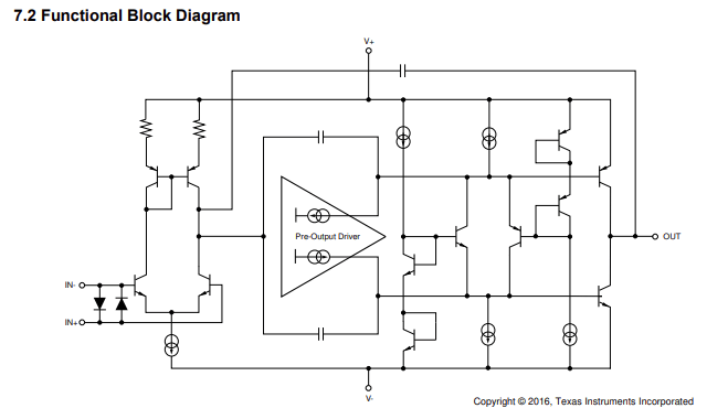

A THEORY from me (not certainty). The OPAx210 internally is "rail to rail", or common emitter output:
Current sourcing and sinking is limited and quiescent current is VERY low. In the circuit we have switching related artifacts at ~12MHz (or 24MHz) and a feedback loop that is in effect a 2.2nF Capacitor.
This means rf rides through to the output stage. What does it do there is to get to the base of the output transistor, which is in effect also the VAS stage.
Now OPA1632 has buffered outputs, likely Diamond Buffer type and likely with significant quiescent current:
This output stage would "sink" RF noise even in "open loop" condition, it will not enter the circuit inside the IC in a similar manner.

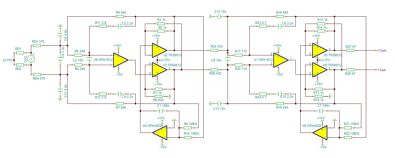

2. ThorstenL's suggestion (based on Birt)
This output stage is based on what ThorstenL simulated in post #2150 although without the passive input filter.
Just to note, my "real" suggestion would look like this:
Probably with LT1028/1115 instead of OPA1611/12, though OPA(2)828 or OPA1656/2156 would also be options.
The THS6012 is resymbolised as TPA6120, use either one, OR ANY OTHER CFB Op-Amp with diamond or other emitter follower outputs. Note the CFB output stage has gain, that is needed to both offset the loss of loop gain of the main OPA and to avoid exceeding the CM Range of THS6012, which causes it to go into polarity inversion.
Servo Op-Amp is not that critical, but at OPA1678 should be used.
Thor
How do you estimate the OPA2210 output stage quiescent current? It must be less than 2.2 mA because the whole op-amp typically draws 2.2 mA, otherwise I don't see anything indicating the value.
If there were a big Miller compensation around the output stage, I would estimate that the quiescent current is about 400 uA because of the 35 ohm high-frequency open-loop output impedance. The compensation scheme is, however, more complicated than that.
Anyway, if your hypothesis is correct, a few pull-down resistors drawing a few milliamperes out of the op-amps of the first filter stage could help. It would reduce the voltage swing on (and hence the distortion of) the input stage as well as the distortion of the output stage.
I estimate it as "low". The entire OPA has 2.2 mA, the input stage at least a few 100uA to get so low noise. Probably closer to 1mA for input. So likely less than 1mA in the output stage.
Given the outputs are pulled to 0V, 2.5V @ 375R+ 845R already draws ~2mA.
Thor
Good point, I forgot about that. It's actually 1.24 V and about 1 mA: half the outputs are at zero because of the RTZ functionality, the other have data on them, so on average one out of four is high.
It would make more sense to try a pull-up rather than a pull-down resistor then.

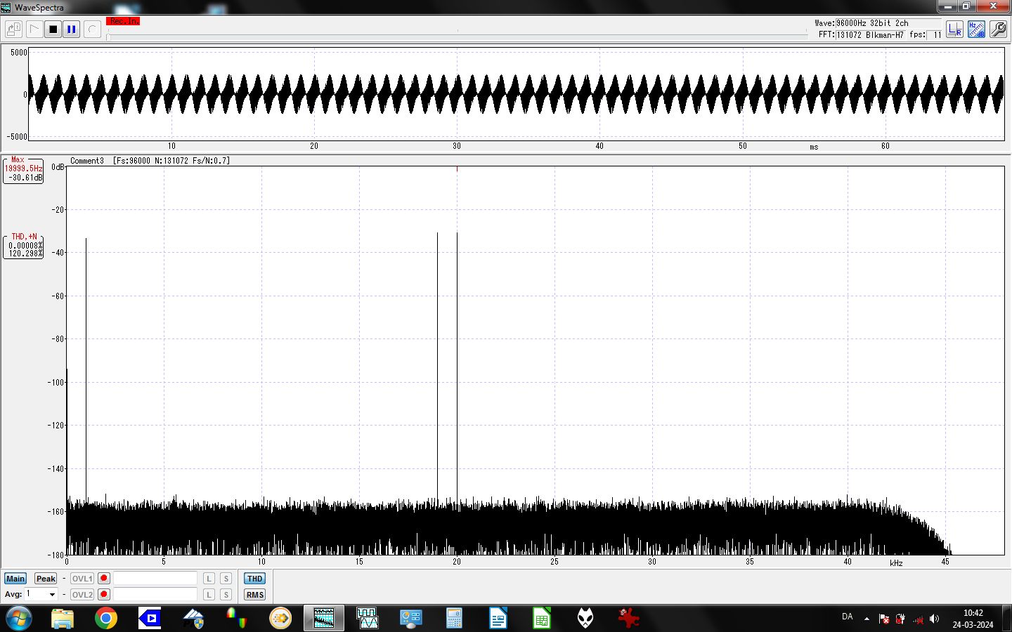

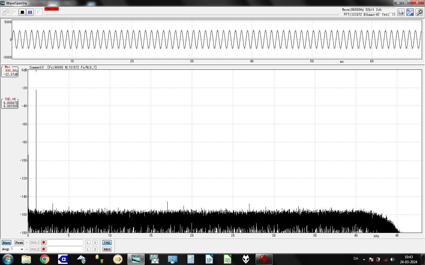

Hi ... since I can see that you are talking about the filter stages and distortion at higher frequencies I thought this might be relevant to your talk ....
The attached FFTs are when using Marcel's output stage - without - the common mode circuitry and with a slightly different PCB layout. Also, I use the OPA1656 in the last stage whereas the first stage still is the OPA2210. There are also some different decoupling capacitors around the opamps but basically the same structure.
Cutoff frequency has been re-calculated to be 65 kHz for the first stage (thanks Marcel for the MFB document earlier in this thread & the Okawa-denshi online calculator 😉 ) whereas the second stage is as Marcel designed it (I just realized that I have forgotten to change the second stage's cutoff frequency so it is still at, to my memory, 80 kHz?).
The sound files I used were generated with WaveGene - a software freely available (although aged some years by now). At -1 dB for the 1 kHz file (384 kHz 32 bit PCM) and at -12 dB, -9 dB and -9 dB for 1kHz, 19kHz & 20kHz, respectively, for the "IMD" file.
Playback through HQPlayer at DSD128 with ASDM7ECv2 modulator (just the one I happen to use for comparability without challenging my computer beyond its capabilities). Output level - 1dB in HQPlayer for both files.
Cosmos ADC (4.5V RMS sensitivity), Fs 96 kHz, 132k samples, Blackman-Harris 7 point window. WaveSpectra FFT software (also freely available, to my knowledge the same developer). Above 48 kHz there are not any other distortion pins except the increased DSD noise level.
The DSD DAC was not Marcel's (I can't get my version to perform optimally, unfortunately) but an experimental discrete DSD DAC (which I at least currently am not at liberty to share more details about).
My reason for posting this is that as far as I can see the output stage (w. OPA1656) in this context does not perform "worse" at high frequencies ... ? Just my input in case it may be helpful to your talks about the filter stages.
Cheers, Jesper

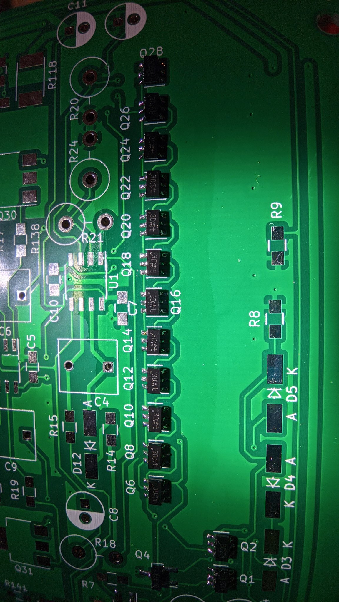

Diy'd some wire snippet desoldering pincers, greased them up with some solder, and off the disoriented BCM56DS came. Took less than a second per part.
I don't know if it's more embarrassing or not, but I saw the dot on the part, but missed the marking on the silkscreen. After comparing the schematic and the pinout, I misidentified the emitter of Q28A and didn't care to check again until after they were soldered, which was when I noticed that there are indeed orientation markings on the silkscreen...
Either way, onwards and forwards.
