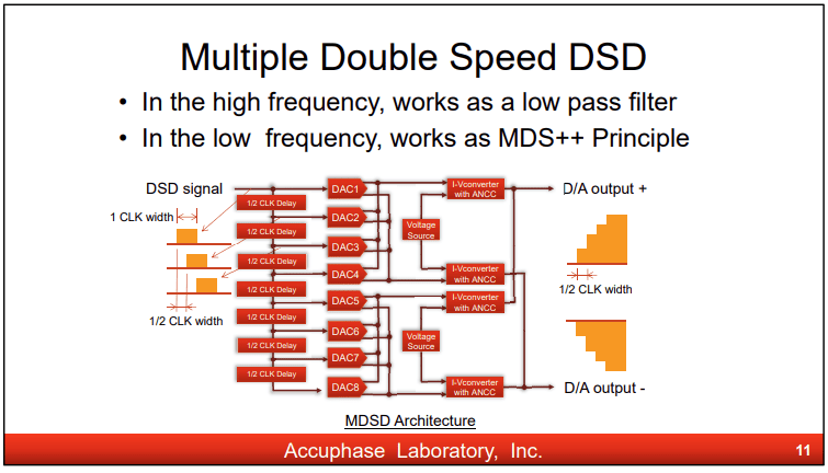

Conceptually this (left had side):
What was tested included RTZ at 75% duty cycle in the DAC Hardware, thus based on definitions in extant literature "increase the sample rate N-fold by using N DAC's" and thus at least under these definitions would qualify as DSD2048.
But ultimately this is all semantics.
Later testing found that in practice audible and measurable differences between a complex algorithm and a simple delay chain were very inconclusive. Improvements for both versions "Interleaved multi-DAC" solution were observed, compared to just operating four DAC's in parallel. The same situation was observed with two DAC's to a lesser degree.
Thus my personal takeaways was that what Accuphase calls "MDSD" is worthwhile to implement and relatively trivial in difficulty (especially if we use an FPGA for PCM/DSD to DSDn conversion) if we use multiple DAC's.

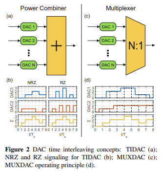

The concept using an analog power combiner in order to sum signals of multiple DACs is shown in Fig. 2 on the left side. The signals of the individual DACs are exposed to a phase shift relative to each other in order to guarantee a correct summation.
Furthermore, one can distinguish between two techniques as shown in Fig. 2 (b): firstly, NRZ signals can be added. However, they require a digital pre-compensation algorithm to calculate
the individual sequences contributing to the combined signal. This variant is also known as pseudo-interleaving and used e.g. in the Fraunhofer HHI Arbitrary Waveform Generator (AWG) with 70 GS/s and 18 GHz bandwidth.
Secondly, return-to-zero (RZ) signals can be used, which do not require a pre-compensation algorithm, as shown in Fig. 2 (b). Hence, this technique is called true interleaving. However, the requirements on the DAC’s switching speed are increased. Both techniques increase the sample rate N-fold by using N DACs, but the bandwidth remains constant, since the combined DAC
is limited by each DAC’s sinc-roll-off in the frequency domain.
The other concept in the time domain makes use of a highspeed MUX as shown in Fig. 2 on the right side. Multiple DACs generate analog signals, which are then aggregated to a higher sample rate with a high-speed analog MUX, which switches between the input signals. In Fig. 2 (d) the
ideal MUX operation is shown for the case of two DACs. The MUX output is generated by switching between the two input signals, whereby the MUX "samples" the input signals in the center of each symbol, which is denoted by the black dotted line.

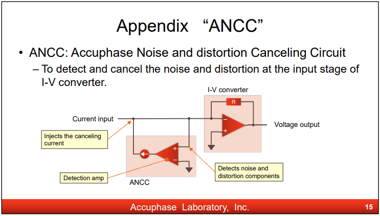

Very strange this ANCC circuit.
The I/V converter has a virtual input that should be at at the same level as the positive input, zero volt in this case.
When any deviation from zero volt takes place (apart from the tiny input voltage difference dependent on input signal and loop gain) it means that the I/V convertor isn´t fast enough to follow the input current signal.
This will be detected by a much faster Detection amp who injects canceling current.
1) Either this happens outside the BW of interest, then it protects the I-V's input from overloading by signals outside the required BW
2) When it already happens inside the BW of interest, the detection amp has no knowledge of what's noise, distortion or Audio and can only damage the signal. To prevent this from happening, the detection amp must have a high pass filter to prevent interaction in the BW of interest.
So to me it looks like an input overload protector instead of a noise and distortion canceling circuit.

Maybe so, for that elite group at the time. However, I've gotten lots of flack since then for advising against ferrite beads in some applications. At least Thor gets it....most of us here were in agreement about it when the issue first appeared...
The ANCC +ve input terminal with the -ve input terminal grounded? What does the arrow out of this ANCC amplifier mean?View attachment 1285551
I have used similar circuits in other applications that needed low noise where it was non-trivial to achieve without major re-designs.
"To detect and cancel the noise and distortion at the input stage of the I-V converter."
How does the ANCC network "know" what is "noise" and what is "distortion" of the current "input" signal? How does "cancelling" come into it and not potentially preventing it or "lowering" it in the subsequent I/V?
What is the nature of the "noise" being cancelled, or not otherwise amplified? Is it IM being lowered in relation to signal that the ANCC can seemingly know to differentiate?
This blurb seems hopelessly inept.

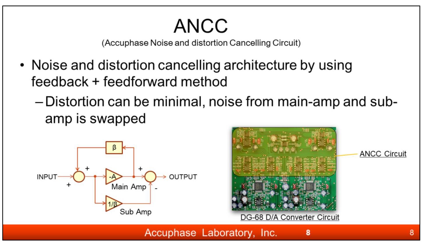

This may make more sense. (page 8 in https://www.accuphase.com/technical_information/dg-68_technical_information.pdf)
One paper attached. Be nice if Thor would be so kind as to post the Accuphase material.
The paper describes a different method, which is why I did not post a link to it. For us relevant is really just first/second page.
It is not a technical article or service schematic. It shows a fundamental principle and likely so you need to think a bit to spot the obvious intentional "schematic mistakes".
It doesn't "know" of course.
It can only "detect and cancel the noise and distortion at the input stage of the I-V converter.", of the I/U converter of course.
You extract the error and inject the error with correct phase and amplitude back into the signal circuit.
In an ideal circuit, all distortion and noise is cancelled (but then, there is no such thing in the first case).
In a real circuit the error correction Op-Amp is commonly the limit, plus, I have never been able to get such cancellation schemes much past 20dB... Then again, 20dB lower noise or HD are worth having.
The ANCC Circuit does not actually distinguish what noise etc, it "looks" at the inverting op-amp pin and "thinks" to itself: "This should be zero, if it's not zero, what is there is a fidelity impairment that I need to action to make zero."
Bad English translation from Japanese that was overly simplified.
Given that is such an utterly basic set electronic concept's involved, I did not see a need to belabour the point, it was just something noticed in passing while I was looking for the illustration of multiphase DSD.
Yes. This is plain old error feedforward, older than Black's feedback patent.

I think the ANCC circuit in post #2441 is supposed to have a finite transconductance that is close to the reciprocal of the feedback resistance of the transimpedance amplifier (current-to-voltage converter). It then acts as a negative resistance equal to the opposite of the feedback resistance of the transimpedance amplifier. The gain from the error voltage of the transimpedance amplifier's op-amp to the output is ideally the sum of the two resistances divided by the ANCC resistance, so (-R + R)/(-R) = 0.
The amplifier in the ANCC circuit is drawn as an op-amp, so I originally thought that the circuit was supposed to behave ideally when its gains approach infinity, which made no sense.
Marcel,
Yes indeed, that creates a working solution, but it could be a delicate exercise to match those resistances over de required BW.
On the other hand, with modern op-amps having two digit Mhz GBW's with THD's in the ppm, what's the sense of using this complex solution ?
