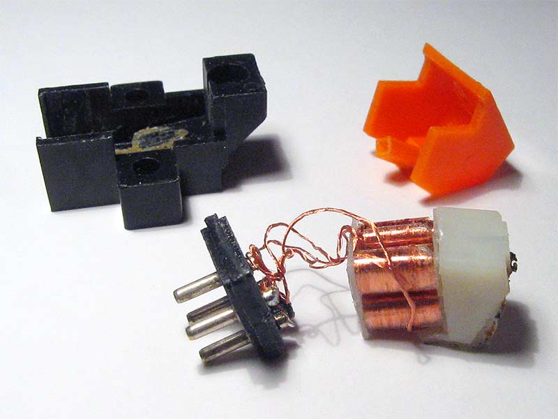

@ George, you've got me all fired-up now, hehe😀 I've never wound coils for an mm cart and won't try that anyway as there's just too much wire. I've got a couple of mm carts laying around perishing and oxidising. I'm tempted to take a can-opener to a Shure M75ED, remove the coils and transplant them into a new milled alu body (with tapped threads, of course) and mill and drill a proper, secure mounting block which can be screwed down below the coils. My own proprietary damper would go ahead of the magnet (and at the rear of the cantilever). The magnet, I will also fabricate from rare earth material I have here. Then, I'll replace the Shure cantilever/stylus assembly with say a Gyger FG11 alu or ruby job. In other words, the replacement generator would have the appearance of that of an mc cart, but the grooves driving a small magnet, instead of the coils.

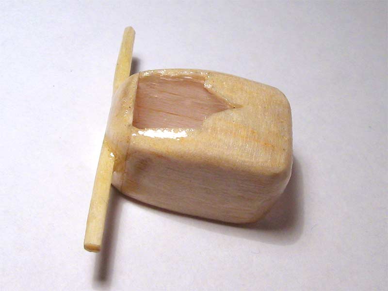

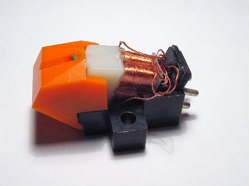

To again illustrate the dividends of small, intelligently chosen mods to mm carts (and also to mc's), I recently repaired a humble Excel cart for a friend. The cart had a whacked cantilever and I asked him if I could implement some of my ideas in the repair.
The cantilever/stylus assembly was replaced with a Gyger FG11 which is much lighter and thinner than the original. At the back of the original cantilever, was a small steel tube to hold the magnet. I replaced the steel tube with a titanium replacement, which I turned on my lathe. As luck would have it, I found a slightly longer and thicker magnet which fitted into the new titanium tube.
The last mods were to replace the hardened suspension rubber with that of my material, cut to size with an NT cutter blade, and to replace the anchoring wire with a 9-strand cable - even thinner than the original wire and much more flexible.
The difference in sound was profound - sounding like a cross between a Grace F-9 and a moving coil.
OK, this is a recipe. Check out your parts bins 😉 . Just remember, small magnets fly away, never to be found again.

Ok I have got a little inspired here from this thread and thought I'd see what would happen if I re-bodied one of my cheap $10.00 carts, so this afternoon I managed to disect it and cut away the steel housing successfully, having never seen inside a cart this was interesting. Using bits from the cart I can keep everything aligned so thats good. If I stuff up it won't break the bank so I can afford to experiment.
The question is now how to best re-body the cart and control interference, I was thinking making a body out of balsa and then gluing aluminium foil to the outside casing and earthing it of course and then painting it black or some other finish..is this likely to work OK. I would love to do a machined aluminium body but I don't have the gear so it needs to be wood or plastic.
It looks like I can get things much more rigid internally as the original assembly was glued to the cart casing at the front only so I imagine there would have been some vibration of the whole assembly under pressure.
The wiring behind the motor assembly has quite a lot of extra lenght in there, I imagine to make assembly easier but I wonder how this effects things as it was a bit of a tangled mess.
I imagine embedding the whole motor assembly in epoxy is not a good idea, as it might effect capacitance? This would make for a solid structure though with little weight penalty.

I like it. Any photos Zero One?I managed to disect it and cut away the steel housing successfully, having never seen inside a cart this was interesting.
Balsa is excellent for prototyping the cartridge body.
You can use the constraint layer method, to produce whatever shape you wish, very easily.
I don’t know though if it is good material for a final version.
Balsa has a spongy construction.
It will work as a vibration dissipative element.
You will also face the problem of proper rigid coupling to the headshell.
You may try to harden balsa by immersing it into a hot varnish (or into a two-part diluted varnish). Hopefully it will soak varnish into it’s pores and become harder and stiffer when dry.
Also, instead of sticking aluminum foil on the outside, you may use a conductive coating in spray-can.
Both aluminum foil and conductive coating, will provide some shielding for HF (RF) but not for 50Hz electromagnetic fields. In your turntable, you may have no 50Hz hum problem though, so HF shielding may be adequate for you.
Try first with no shielding, then paint and compare.
Again, try to make recordings (even with a cassette recorder), so you will have a way to compare, not by memory.

Hi George, here is a pic of the cart with the metal case removed, it is actually quite easy to use the plastic bits left as a supporting chassis, so this is now the plan, embed the coils in epoxy, mount the motor into the plastic chassis and then glue mount the stylus holder with stylus in place and than add the exterior balsa shell and foil coating, finish with black paint and laquer.

Here is a pic of the outer shell for the cart I have I dissected, it has a built on longhorn stabilizer, still lots of finishing to do but so far it is going OK.
