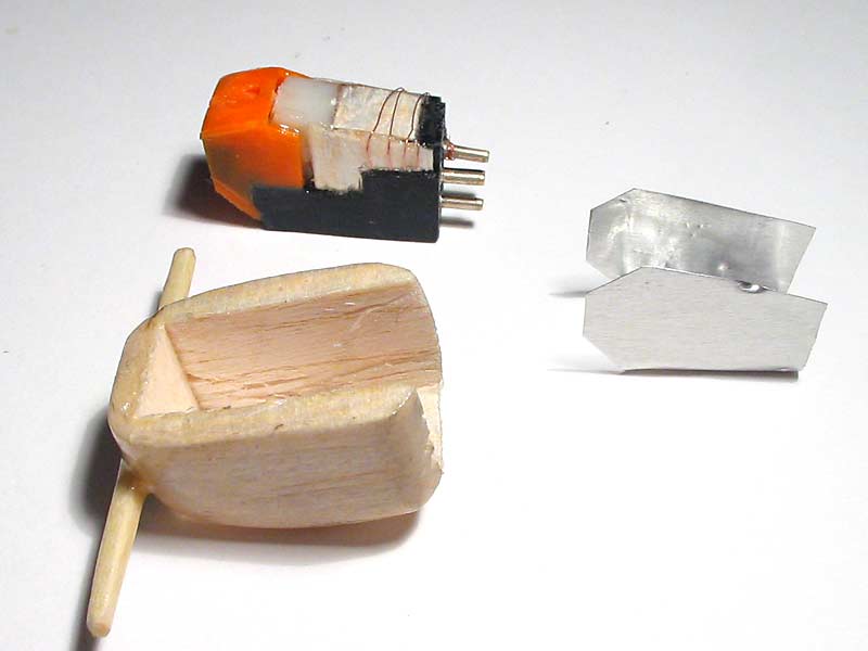

This shows the bits, the silver bit is the shield that goes between the inner balsa and the outer balsa case, it is earthed via the wires on the back of the cart.

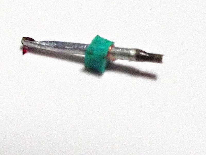

Finally here is the stylus, crook shot I know but thats as close as I can get and then I had to crop, you can probably just make out the copper wire around the cantilever just behind the elastomer.

You must have some eye sight to work onto the cantilever!
Very clever with the notch and the copper wire. It will work.
But there is the risk of the reaction pulling the elastomer out of it's place (forward).
You may have to install another copper wire forward of the outer diameter of the elastomer (at it's housing).

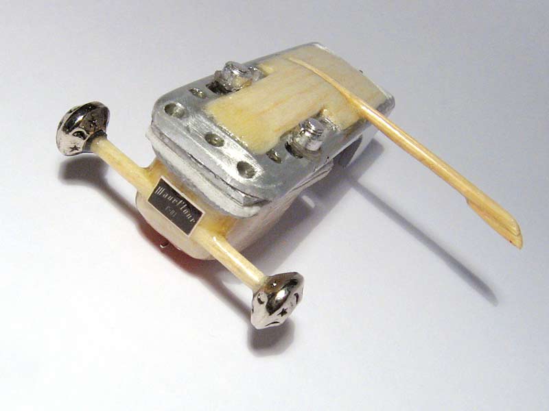

Finally I have got the cart all together, mounted up and running....yes first time.
There is a problem that I have to check as I have a hum on one channel, so probably a bad connection, the wires on the tonearm are very fine and I may have caused damage pulling it off etc, since it is only one channel it is likely the cart shielding is fine so that not a worry.
So here is what I can say so far.
I have not set up the cart properly, too impatient to see if it worked, so I will get to that so I expect it will be better still as it beds in and the set-up is finalised.
The first impression is just how much clearer the high end is, you can hear it in the attack on guitar notes and plucked strings and I can hear more detail than with the previously modded cart. There is a greater sense of ambience and distortion levels are definitely lower, right across the record.
Bass seems are little less powerful, but then it is only the first hour of playing so that might improve, however the bass is tighter on transients.
One thing I did not expect was that the surface noise seems to have been lowered somehow, though I.m not sure why, but it is definitely less upset by scratches and other disc issues.
So its early days but overall I'm very happy with the results, I feel it will be easy to listen too long term and I feel I have learnt a lot in the process. So long as I can fix that hum on the left channel.
Here is a list of what was done for those interested:
1) Metal casing was completely removed
2) Plastic mounting tabs cut off
3) Plastic chassis filed down
4) Wires from coil to metal pins rerouted so they did not twist around each other so much
5) Plastic stylus holder filed down and shaped so it had no hard angles
6) Balsa wood body made into which the cart chassis could fit, with no hard edges/corners
7) Aluminium inner shield made and earthed to minus pin
8) Coils embedded in epoxy
9) Stylus holder epoxied into chassis after the internal holding pins were pushed inwards to tighten the grip they have on the shank of the holder, the shank which is plastic was also thinned down prior to gluing in.
10) The balsa body had a integral cross bar to hold outrigger weights
11) The body was lacquered 6 times to harden the outer shell and give a nice finish
12) Once the body and chassis were mated all of the joints were epoxied to give a totally homogenous structure
13) 3 Cavities in the top of the glued up body were filled with very fine sand
14) The top of the body was capped with a small sheet of aluminium shim
15) Double side foam tape was added to the top of the cart.
16) An alloy plate with integral bolts was attached to the top of the foam so as to allow easy mounting and adjustment
17) The perimeter of the cart where it mounts onto the foam tape was given a bead of bluetac to make a better bond and strenghten the edge of the foam
18 The magnet was glued firmly to the cantilever, this seemed to be a weak point
19) The cantilever was notched just behind the elastomer and a very fine copper wire ring glued in place to prevent the cantilver pulling through the elastomer under pressure on lare modulations
20) The stylus tip was filed down considerably around the mounting area for the diamond to remove all excess metal
21) The shank ahead of the elastomer was filed down to taper towards the stylus
22) The shank was smoothed off with very fine sandpaper
23) A single loop of very fine cotton thread was placed around the shank, half way between the stylus and elastomer this was super glued in place.
24) The cantilever was mounted into the holder and the finest dabs of super glue touched to the surface just above the elastomer so it ran down to the lip of the elastomer and locked it in place preventing forward motion of the elastomer (this was quite nerve wracking as any glue on the elastomer would have hardened it and ruined it.

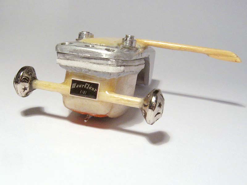

I have noticed that most of the MC carts, including expensive ones, have a relatively low compliance of around 12. If I were to design a cart I would opt for low mass, medium compliance. The reduced compliance probably eliminates some of the squirm (for lack of a better term) in the cantilever motion. Mark
And another view, it can be seen that the cart has an integrated foam mount like the cartridge isolater, this is probably far more secure though as the whole top of the cart is designed to orwk with this to start with.
There is a thin bead of bluetac around the perimeter of the cart to aid stability between the cart and the isolator, looks a bit crook but works well.
