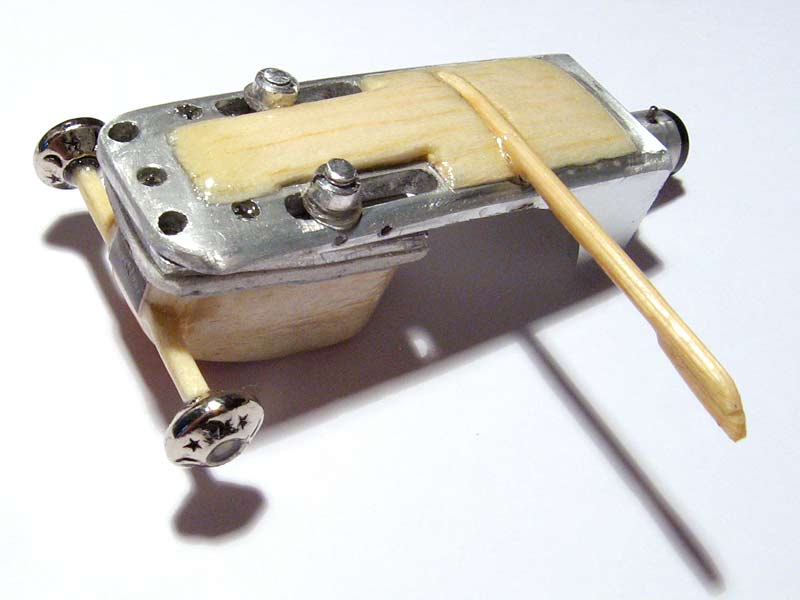

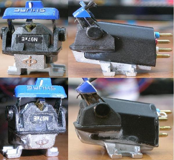

Results of M97xE mod

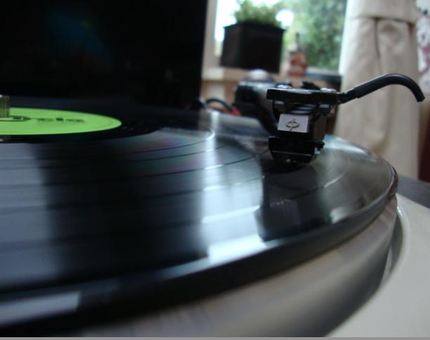

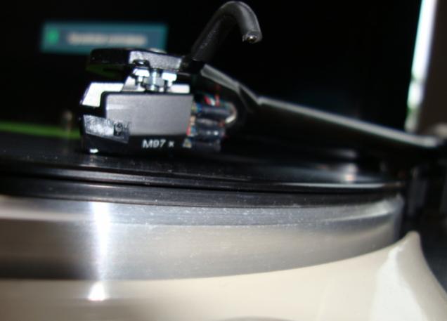

In this top view the headshell mods are pretty obvious, the lifter is made from a pair of toothpics and feels very secure in use, I have often felt that the thin metal lifters could act as a vibration source.
Gday Hailteflon
I did glue inside the cart, in fact you can think of the whole cart as being homogenous, funnily enough it feels that way when you hold it too, to me this means there are few opportunities for odd resonances etc within the cart and in part this may account for great sonic result.
The bar is what is known as a longhorn mod, though most I have seen are made from alloy and lead, The idea being it stabilizes the cart in the lateral planes, and this seems to work well in conjunction with the isolated mounting of the cart, I have done this with three carts now and in each case got a good improvment in tracking and sound.
This whole project has lead me to re-evaluate what is actually good in cart design, the stylus is so basic, but it doesn't sound that way at all, I am starting to feel that the body and mounting have been rather neglected in may designs, with all the effort going in the stylus cantilever, which is clearly important, but maybe many carts could be made to be way better with more attention in the areas discussed in this thread.

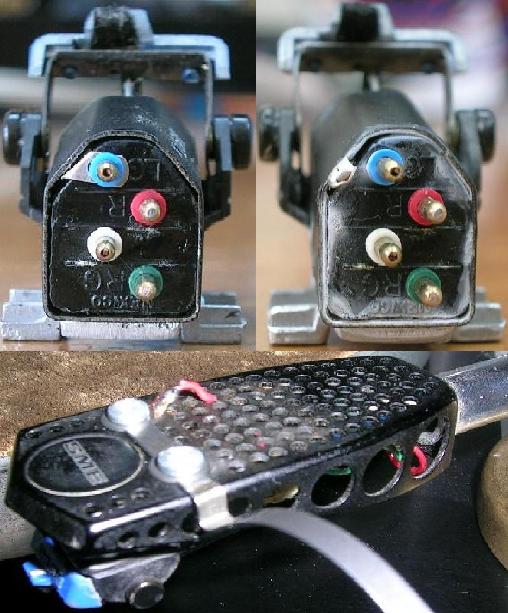

Hail Hailteflon
The cross bar is know as a longhorn mod and goes way back, I think about 20yrs, you will find many references to it on the Vinyl Circle forum, here is a link to the forum.
http://www.audiocircle.com/circles/index.php?board=32.0
I feel it works by stopping any rocking motion in the cart under the influence of the normal wiggling movement of the stylus, kind of like a trapeze artist eith a balance pole. However it works the final result is very good on my system, basically the cart just racks far better and as I said it seems to be a perfect match for the isolated method of cart mounting, I'd say it is worth a try, though this version is far more integrated than most I have seen so that might make it work a little better.
I doubt it would be good for cart and arms that are very light and have softish suspension.

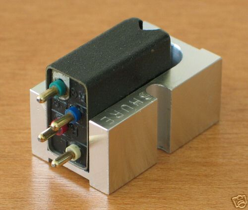

There was a set of very good pictures of the Shure V15 type I on ebay (Supertrack type I, but not called ST yet), but they are gone now, sale ended. Shure set the typical Shure coil body in a large rectangular metal holder. This was a new cart in box plus new extra stylus. It is unique for the era in that it has a .2 x .9 stylus. Lucky buyer.
I am still going to think about how to get some cement on the magnet/lever joint without disassembly. Great project Z, lots of new questions and directions. Mark

longhorn modification
hailteflon et al:
Hi!
I´m reviving this thread ´cause I have found the PDF of ¨Audio Basics¨newsletters from 1982.
There you´ll learn about the genesis of the idea, which is not very far, conceptually, from your hypothesis about cartridge mass and it´s contribution to axial stability.
If I remember well, the idea was born from a series of experiments with some MC cart that had a low center of gravity. They discovered some virtues in the design of that cart, and tried to replicate them in a MM design.
This is the link:
http://www.avahifi.com/root/audio_basics/ab_pdf/ab1982.pdf
check out http://www.avahifi.com/root/audio_basics/index.htm too, because there is a lot of interesting info from the days of yore

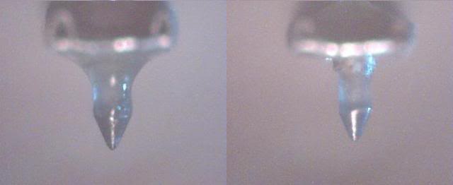

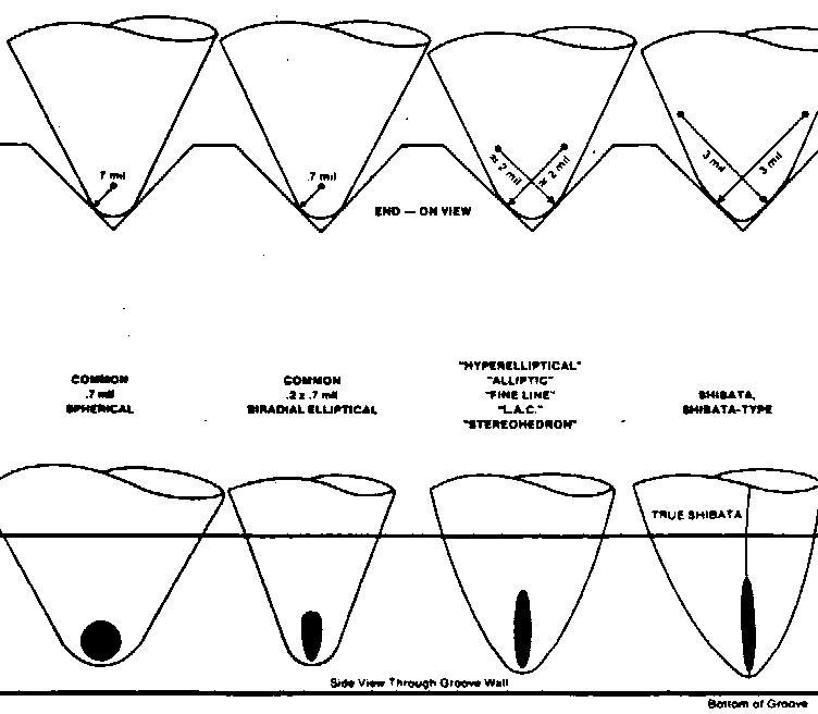

Hi made a simple modification to the M97xe. After my little son damaged the third stylus in his live he is very attracted to the equipment and plays with it when I do not see it. So I needed a replacement needle.
By coincidence I did find the Ed Saunders shop on ebay. He had made a replacement stylus for the V15vxmr.
He has a HyperEliptical styli it is not a micro-ridge but comes close in refinement of the diamond shape.
Ed's latest project is this hyper-elliptical stylus for the Shure V15VxMR cartridge. Making one of these things from scratch has a lot of trial and error in the process. Ed will not put a product on the market until it has been thoroughly tested and evaluated by knowledgable persons in the analog audio industry.
Ed really sells the stylus at a lower price as the original replacement for the m97xe.
It is a great chance to up grade the M97xe. I received the package today.
The stylus looks small with the eye. The stylus guard of the Ed Saunders is a laugh it is very flimsy. I took it of.
The new stylus fits a bit tight to glue it to the cart isn't necessary it can not move any more.😱

For people how are this reading at the first time The sound of a cartridge is influenced by the shape of the diamond this shape is a limiting factor in treble detail. The Ed.Saunders HE is capable of reproducing micro-detail if captured on the record.
See photo's diamond shape.
