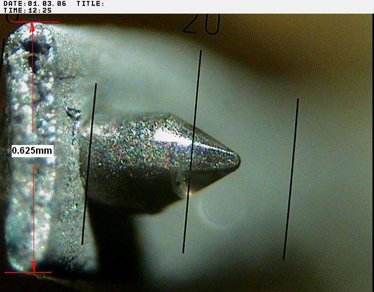

Fact 1: I have removed the stylus assy 2-3 times and put it back- in from the time of purchase till the glue application.
Fact 2: I have pictures taken just before the glue application showing good fit of the stylus assy.
Hypothesis 1: SY’s reasoning is based upon his experience from analogous cases.
Fact 3: I have no statistical or theoretical proof to provide for to reject SY’s reasoning.
Statement 1: Therefore SY’s reasoning remains a logical possibility-thus valid- until any opposing proof is presented.
Fact 4: All the information and data that I have provided so far are the outcome of my experimental set-up, based on my experimental methods working on the specific piece of the cartridge I own. Indeed I have not as yet communicated in this forum the complete list of equipment, nor reported with adequate details the methodology of the experimental work, on the basis that this work is still in progress and under the initial thought that some participants of the forum may find it somehow an interesting subject.
Statement 2: My involvement in this experiment is based on my desire to expand my knowledge into the technical aspects of audio reproduction, triggered by other’s information and my own curiosity. Having not enough means (knowledge and capability) to design and manufacture an equipment from the start, I have opted to modify a product that was under my disposal.
Statement 3: I understand and fully respect the fact that said product is designed by competend engineers and manufactured as a mass product.
Statement 4: I do not imply in any ways that the particular cartridge under modification is neither worse nor better than any other cartridge (also any other’s cartridge). This, applies equally to the pre-mod as well as to the after mod condition of my cartridge.
Statement 5: I have no intention to convince anyone for the validity of my results.
Fact 5: I have presented part of the data on which my expressed opinion is based (as an attachment) into my posts. I have made known that the complete data (recordings) can be asked and will be e-mailed to anyone interested (this is for free) for doing his/her own analysis and draw his/her own conclusions, if any.
Statement 6: I understand that any of my reporting in such a forum is subject to peer review. This is in fact my own wish.
Statement 7: Any statement of mine that seems objectionable or not supported by adequate data, is to be deemed by the participants of this forum as an erroneous one and treated as such. Upon their judgment, it can be ignored altogether. But it would not be treated as an intend from my part to impress or mislead anyone.
Statement 8: Audio is what I can describe as a hobby for me. It helps me enjoy my free time in a pleasant and some times in a beneficial (as the realization of the hobby produces usable equipment) way. It differs from my professional activities in four respects:
A. I do not profit from this.
B. I have to finance it, so I have to target projects capable to fit my pocket-money budget.
C. I am the one who decides on what to do and how far I go with it.
D. The time I spend on it has to take into account my social activities and responsibilities as a father and husband.

After having read your post yesterday night, I went to bed. I was too tired to reply. In the morning that I woke up, what i could recall from my dreams was that, I was in one corner of a boxing ring, and you were sitting in the oposite corner, warming up for the fight. You were a mixture of Mark Tyson and "IsNoGood".
The refery did not let the fight to start until I woke up to go to work (one of the benefits of waking-up early).
Your "obvious" explanation is a plausable one for me, OK.

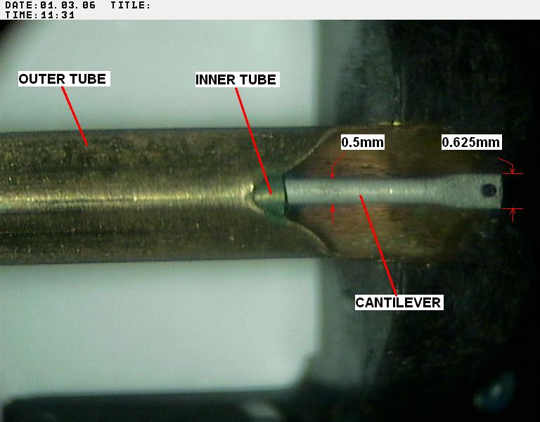

But the one that you call it mysterious may have a deterministic root. Let me lay down my hypothesis:
All the electrical energy that the motor of the cartridge provides to it's output pins, comes from the kinetic energy of the cantilever (better expressed: All the modulation of the moving magnet's magnetic energy, is provided by the kinetic energy supplied by the cantilever).
Where does cantilever draws this energy from? From the modulated grooves of the rotating disk.
This is the only energy source, the amount of which depends on the modulation velocity of the recording.
Now suppose that some parts of the cartridge are vibrating.
For vibration to occur, energy has to be supplied to originate vibration, as well as to sustain it.
The source of this energy according to my hypothesis is the kinetic energy provided by the cantilever.
Now the cantilever has to draw energy from the record "pool" in order to feed two power consumers.One the motor and the other the vibrating parts.
Since the energy provided by the record grooves is finite and defined, the result is that, the motor takes only part of the energy that it would, had there were no vibrating bodies.
This is the explanation that I believe makes for 80-90% of the recorded 2-3 db increase.

I don't believe there are any 'misdirected' energy losses in mm carts with push-in styli. I would rather propose that due to the 'lossy' fitting of the stylus assembly in mm carts, the absolute true potential of the record grooves driving the cantilever is negated or not fully exploited due to flexing between the cart body and the cantilever holder. I guess that should there be any miniscule creaking or rattling between the latter two components, any audible result will travel to the headshell and further along the arm to the amp. Whether one would be able to measure such aberrations, is another question.
I further suspect that George's mods will result in a marginally higher output and an improved frequency response profile due to the integrity he introduced into the cartridge mass with the glue*
*) Regarding superglue or cyanowhatsisname: I use or have in my wife's fridge (where the cheese or butter should go), at least 5 or 6 different brands and kinds of the stuff. I use it to glue things together of course and have two unnamed favourites - one liquid and the other a gel. I also have in my workshop a branded superglue solvent, in gel form, as well as a large bottle of pure acetone. Sometimes, if mistakes are made in glueing, I prefer NOT to use either of the solvents I have as they make a mess. I still prefer to separate the items by heat (usualy my soldering iron set to 350C) and then scratch the remains off with an NT cutter blade.
So, what I'm getting at here - set superglue is not as hard as you may think. I have plenty of experience in scratching at blobs of the stuff with a cutter blade.
This glue will help with what George is trying to achieve but I guess that a hard-curing cement of one kind of another would give more favourable results.
