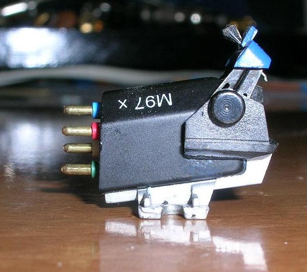

No, I did not remove this silvery (it is aluminum actually) cartridge mounting.
The most convincing reason for having no desire to try this out is, that my headshell is not detachable and not disposable.
Had I had removed the mounting, the only acceptable way of attaching the cartridge to headshell is by permanently gluing it with Cyanoacrylate (bulgin will become furious now) for to achieve a non compliant joint.

No problem honinbou !
I just would like to see in details what the Japanese “colleagues” have managed.
In fact, with such a mod (removing the aluminum mounting) you described in your #19 post, several factors come into play. These (neglecting the increased difficulty in setting the 90 degrees azymuth angle) that I can spot are:
1st: VTA change. The aluminum mounting places the black body of the cartridge to an angle of 7-8 degrees relative to headshell, as attached photo shows. Removing this, VTA becomes 7-8 degrees less.
2nd: Cartridge mass reduction. Alum. mounting is quite massive, may be it is the 1/7th of the cartridge total weight. Apart from the fact that this mass may place a certain dumping to the cartridge, it consequently affects the:
3rd: Arm/cartridge effective mass, and in conjuction with the cartridge’s (unaltered) compliance:
4th: Raises the arm/cartridge resonance frequency.
These are but the obvious. Each one alone has the potential to affect the perceived sound.
Unfortunatelly –excluding VTA- each of these factors affects the sound differently, depending on the rest of the analogue system.
I know that the Japanese take their mods to extreme. At the same time they treat the subject in an analytical way. That’s why it would be interesting to see a relative site. But, again it is O.K.🙂
But anyway enjoy your tweaked cart!

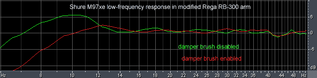

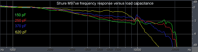

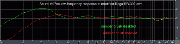

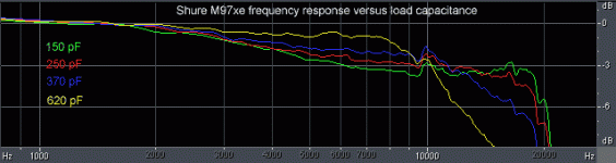

Werner's M97 response graph
What type of set up did you use for the response graph? Did you use a test record with a frequency sweep? Is this graph from the output of a digital converter?
I don't suspect that the M97 will have the hi-freq peak like the carts I was talking about, the tip mass is too low.
The ones I was referring to were in the M44 category with the more massive cantilevers and heavier stylus bushings.
What I am wondering about is why the roll-off at hi-freq. Is this caused by the cartridge or something else? The yellow line is curious.
My results last year were using the output of the RIAA eq. into an oscilloscope. I was connected through RG58 lo-cap coax coming out of the equalizer. Could you be rolling off your eq. output?
Mark
Pink noise track. Flat equalizer, then into ADC and to PC.
FIR filter to convert from pink noise to white noise (flat).
No hidden nasties. I have measurements of many cartridges.
Some are near-flat. Some are peaky. Shures have muted treble.
That's part of their design. The recent 'x' series are deliberately
warm in sound.
last word for now
I never use the brush. It has a "talk" to it that transfers groove noise to the signal.
