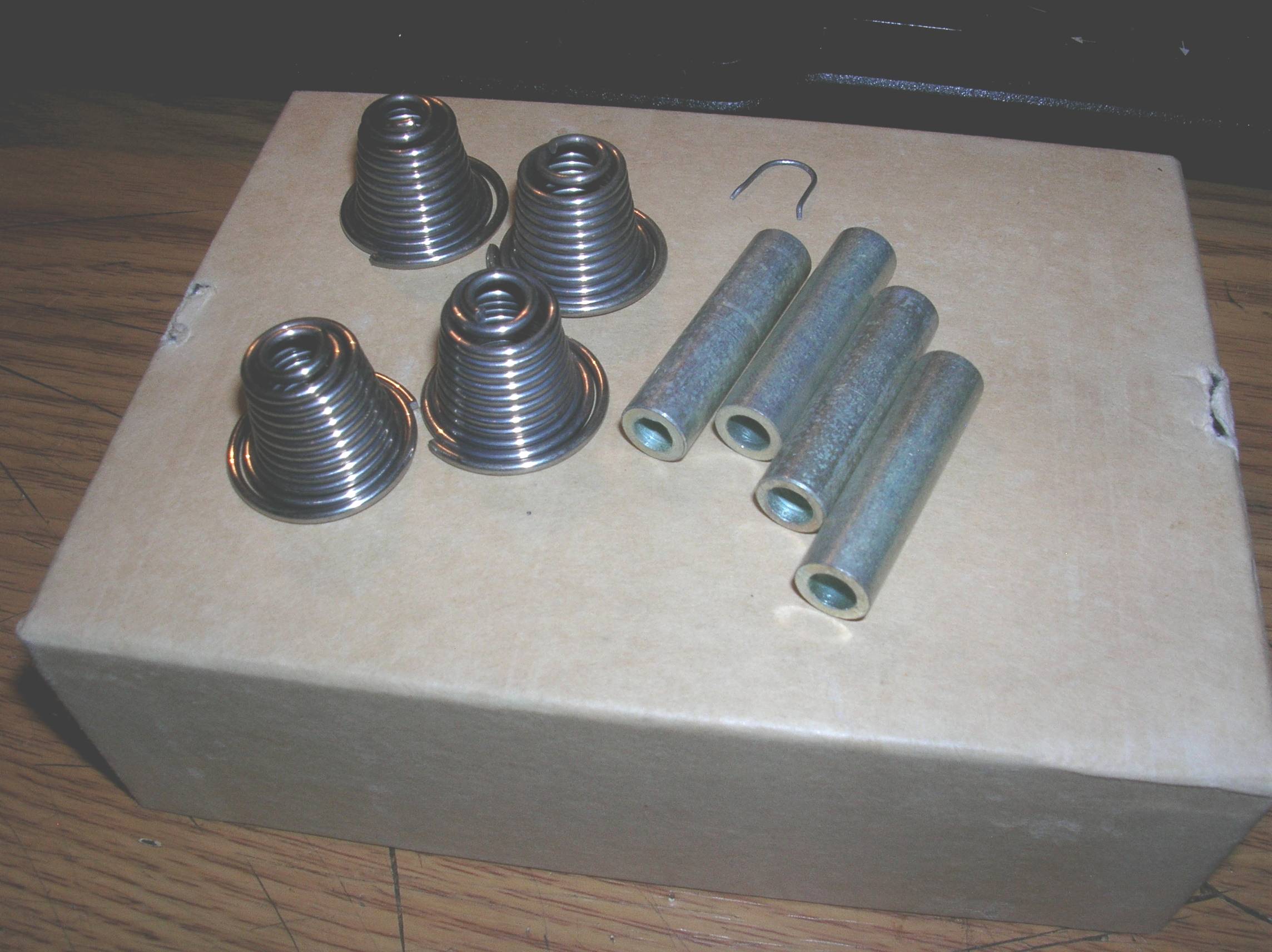

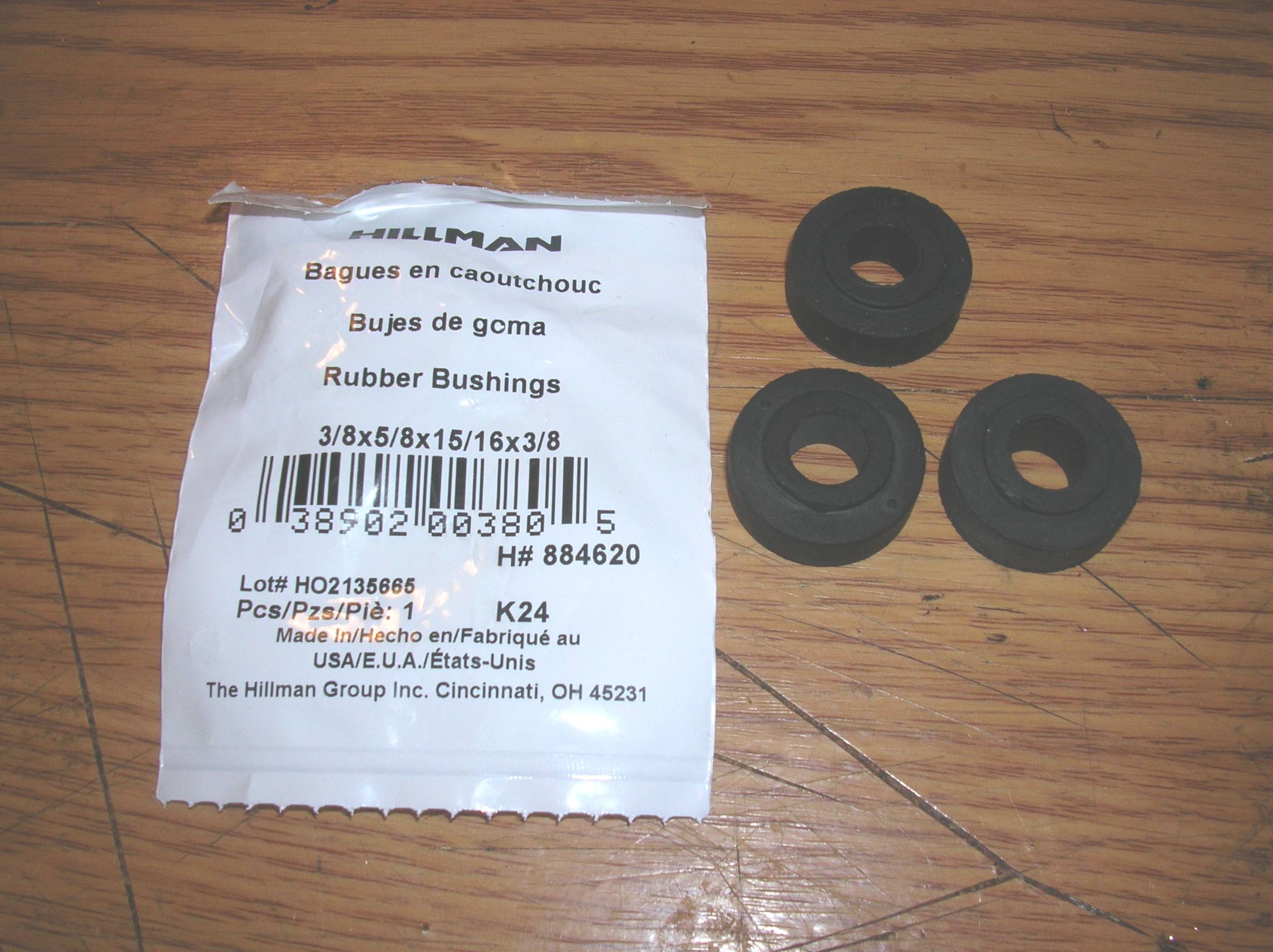

Not sure where those springs came from, but it looks like something someone improvised at some point. The rubber mushrooms as far as I know were the only option provided by the factory. (Edit: I would have to look it up in my book, but now for some reason upon looking at those springs again I think they might have been available on special order to address some particular issue.)
I own two of these tables, the mushrooms on mine had turned hard as rock. Both are mounted on slate plinths and I don't use the mushrooms to isolate the chassis from the plinth. On that vintage plinth I would use the mushrooms. There are several good sources on eBay.

The springs are mention in the manual on page 5. As yet I have not found anyone who uses them. The pointed end down with the sleeve inserted and the treaded shaft passed trough. As yet I have not tried them. I have done some basic maintenance on it. I've ordered the brass shaft bottom and o-ring idler from audiosilence, I should have got belts from him, too. So far I'm still getting some low level rumble. I plan to have the motor re-built next month as funds come available. Running the Ortofon arm with a Acutex 315 III STR. Sounds very nice, Good punch and not a lot of sibilance.
