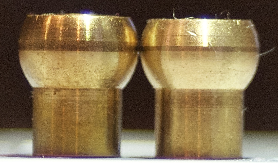

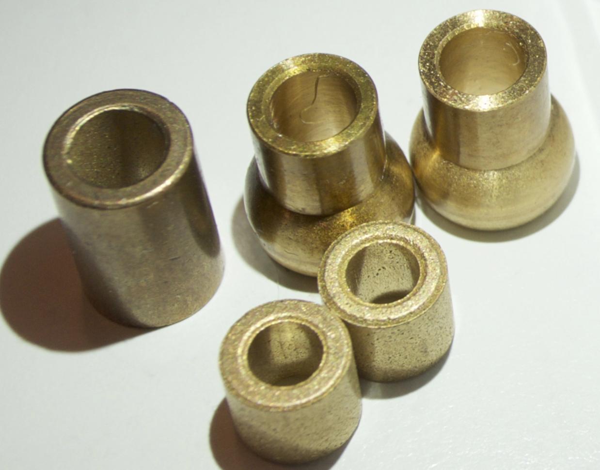

Attached are photos of all the various bushings I have purchased for rebuilding my Thorens TD 124/II. These bushings were purchased from three different vendors over the past few years. One of the main platter bushings is shorter than the other set. One of those sets was purchased as part of a larger Thorens parts purchase from someone on eBay who had no idea of the provenance of any of the parts. The E50 bushings were purchased from another vendor, while the remaining bushings, if memory serves me, were all purchased from Simone.
I took over 40 photos in an attempt to capture as much detail as I possibly could. Obviously none of the photos is in sharp focus on every surface of every part, which is why I am posting enough to try and represent the surfaces of all parts. Capturing enough detail on the I.D. to properly represent the surfaces was difficult, but I believe there is enough detail for one to get a fair understanding of the parts.
I noticed as I lay the bushings out, that the smaller ones for the idler wheel and stepped pulley transferred some oil to the surface they were placed on. None of the others transferred oil.

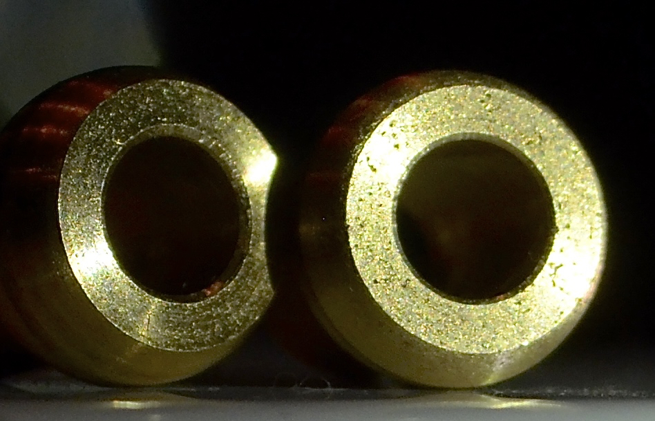

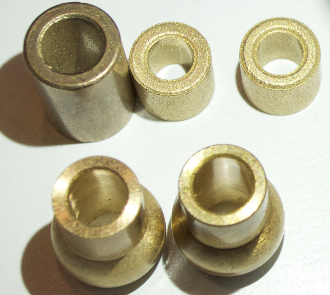

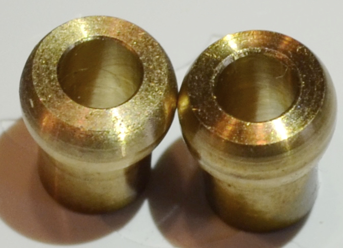

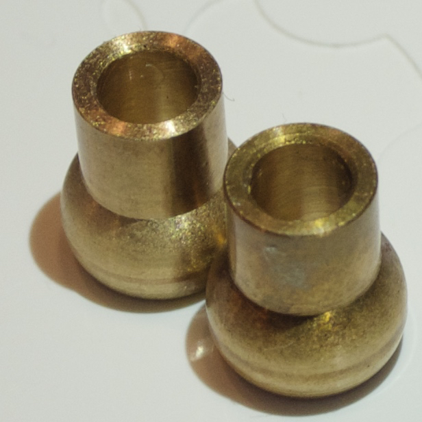

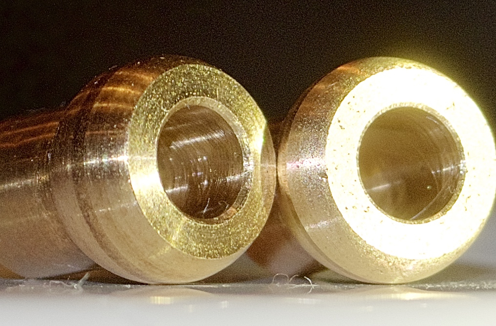

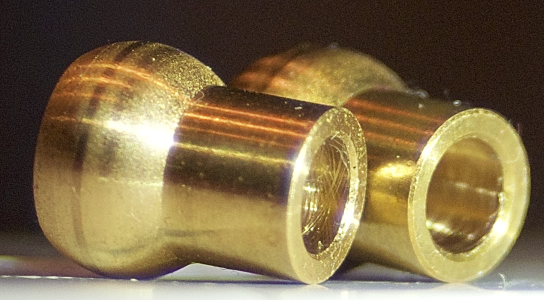

I wasn't satisfied with the level of detail I was able to get in my earlier E50 bushings photos, so I changed lenses and enhanced this second set. More detail can be seen because they've been heavily sharpened, but the result are photos that look much more grainy than the actual parts are. In many in this set, I tried best as I could to focus on the I.D.

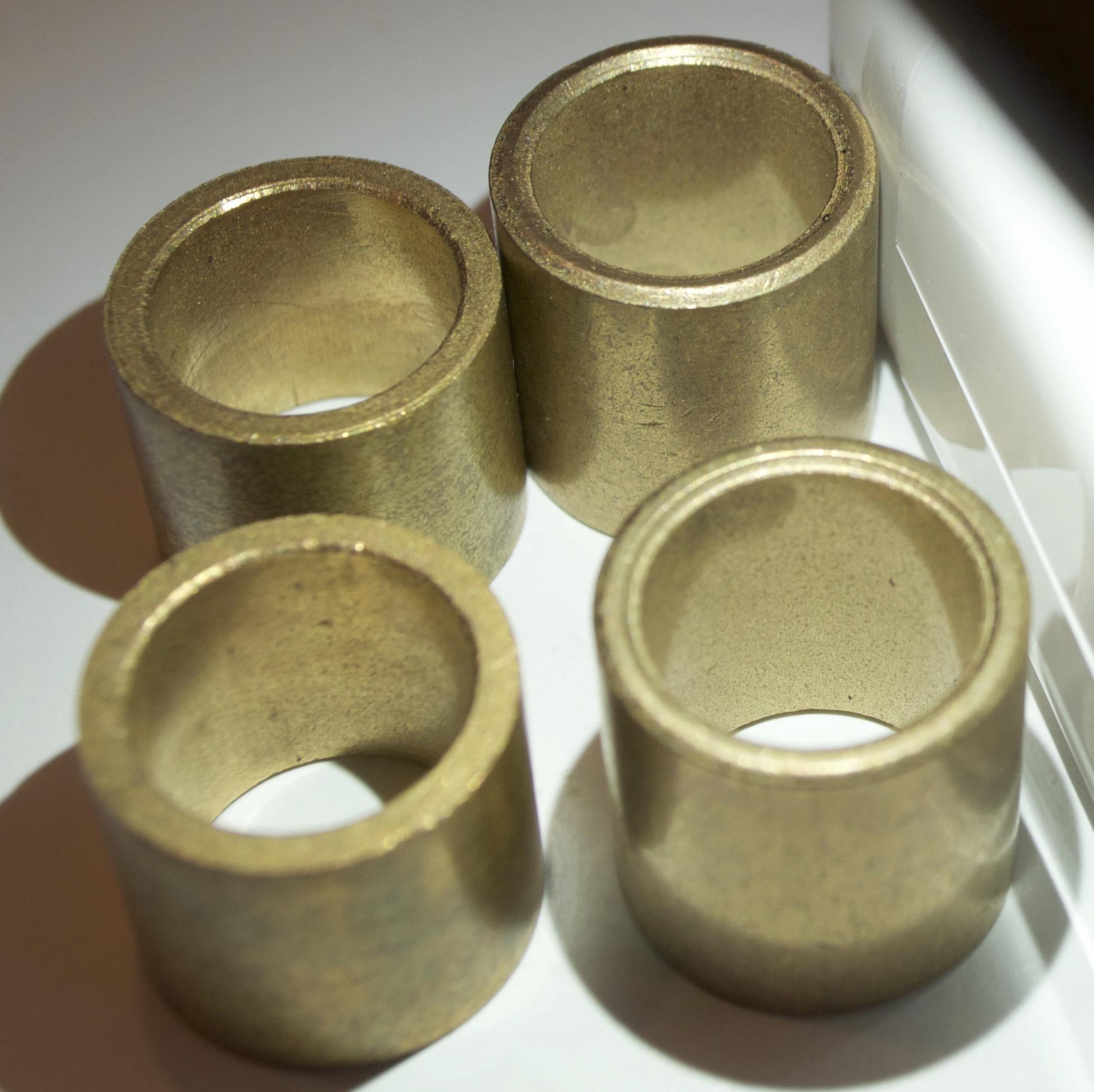

Interesting, I see a few where it appears that the ID is solid bronze, in general there seems to be a lot of tooling marks on the running surfaces of some of these parts.
The second pair actually look like oilite, the others not sure.

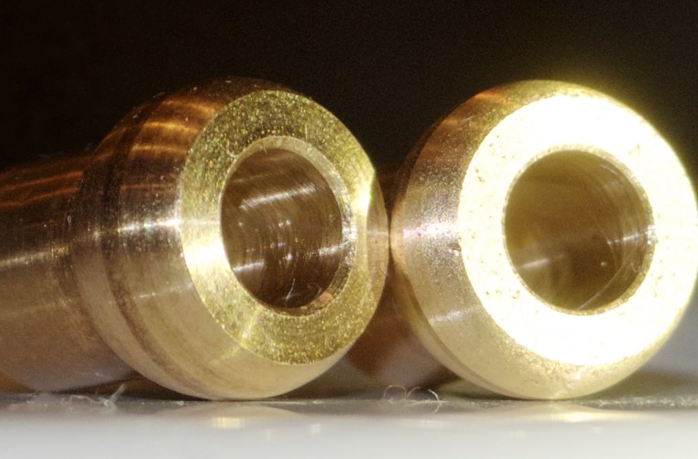

This is the first photo from that group of 4. It also appears to be porous bronze. This is more evident on the second bushing in the photo, where the lighting is overexposed. The porous surface of the material can be seen on the end face.
The inside diameters appear to have been smeared by improper cutting method. I'd guess that the machinist used abrasives to achieve final size in the Id. Smearing means that the porous surface has been sealed off. The smearing will prevent the bushing from self-lubing as it should.
Generally, the big no-no with this material is to use abrasives in order to achieve size. Sanding will smear/seal off the porosity of the bronze. The bushings have to be cut with sharp free cutting tools at speeds and feeds that will keep the porosity of the material open. And, at the same time, sizes need to be held this way.

I would be very interested if someone can find a good material for these bearings. Sintered phosphor bronze is the better one so far. If a porous plastic was available it would reduce vibration transmisson. Gortex comes to mind. It is a strange situation where a reamer and a material can not provide an answer. I was told wood is possible. Ebony for example. Ships bearings were made this way.

To be clear since I posted so many photos, I have photographed only one set of E50 bushings. The only other set I own are the originals still in the motor.
In evaluating the surfaces of these parts, it's important to take into account digital noise present. Look at the part surface, then at some area just outside the part. In particular on the second set, the combination of lower lighting and high sharpening gives a certain amount of grain to everything. I apologize for that, but I'm simply not set up right now to do a better job.
That aside, while it may not be apparent in the photos, all of the bushings, save the E50 set, have a uniform appearance on all surfaces, I.D. and O.D. and that uniform appearance includes little "dots".
The set for the stepped pulley do look quite different, in that the alloy is much brighter and the "coral" look much more predominant. Thinking back, I can't say I know the provenance of the stepped pulley bushings. They might well have been part of that parts lot I purchased. I'll have to check. If that's the case I may opt to buy replacements from Simone, assuming he offers them.

I did not realize that those pictures were all of the same E50 bushing set. The important point is that the interior has been machined in such a fashion that it appears to completely block the pores.
The pair I recently removed from my MKII do not look like sintered bronze inside or out, and were absolutely dry when received. I dropped them in hot oil, but had problems immediately upon installation - did not have enough experience at that point to know definitively I had not done something wrong.
