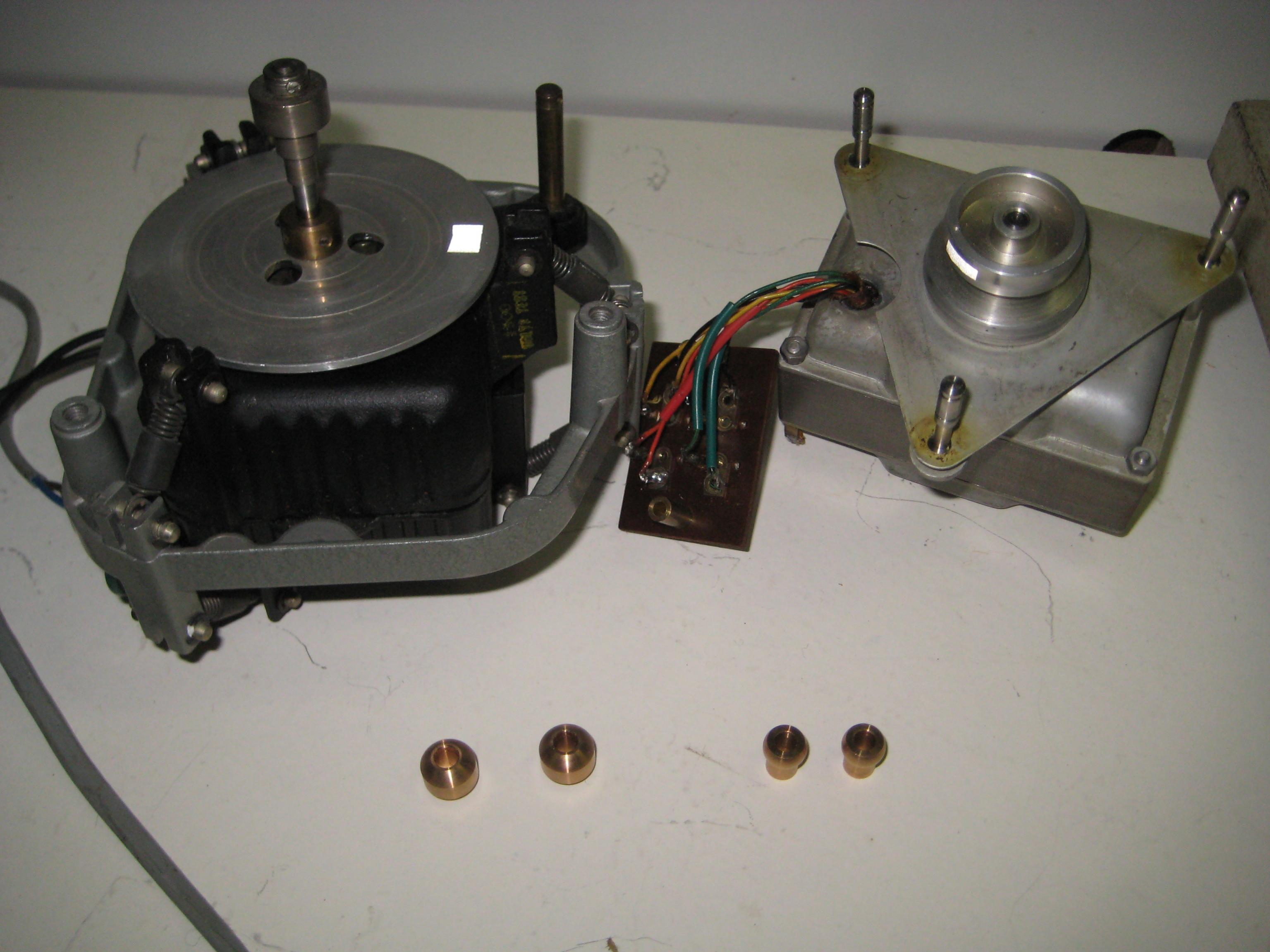

I just wanted to add a little to what I've said about my desire to add a vacuum system to the process of re-infusing E50 bearings (or any of the other sintered bronze bearings for that matter).
Everything I've been able to find related to the subject suggests a vacuum process is what was used commercially, and in fact is still what's used for stock Oilite. One could posit a number of reasons why it would be done that way, including the possibility that it simply speeds up the process.
But I can't help but wonder if it also assures all of the air is driven out of the part. We might think that it's all removed through the heated oil bath process alone, but simply observing that no more air is coming out is no guarantee of it. Perhaps there is air farther in, or in such small capillaries it simply refuses to budge. Perhaps on one part, the heated oil bath does all we think it does, but on another part it doesn't.
Does getting every little micro-bubble of air out matter? I suppose that's debatable. Personally though, critical as these parts are, I'd rather not have to worry about it. If one is simply adding lubrication to a bushing that's in service, perhaps it's not that important, but in those cases where one has gone to great pains to remove all old oil and contamination from a bushing (thereby filling it with air) it may matter quite a bit.
To that end, trying to duplicate the process that is used commercially, to the extent possible, doesn't strike me as making things unnecessarily complicated, more providing additional assurance that the job really gets done.
What I plan to do is to try and set up a system that allows me to first use the standard soak in hot oil bath to remove as much air as possible, then seal the jar and turn on the vacuum. If after having done that with several bushings the vacuum does not remove any additional air, then I'd say it's only worth the time if it actually ends up saving time.

Using a vacuum process to infuse the bushings in the first place makes some sense as the nooks and crannies in the bushing are full of air, (and some carbonized wood) such should not be the case with used bushings which would generally be full of congealed oil. In a commercial scenario speed is of the essence.
I don't believe vacuum on its own would do a good job of extracting old oil from a bushing, but in conjunction with heat it might improve the results slightly to significantly.
I have observed that hot oil is a pretty good solvent, and would expect that soaking the bushings in hot oil with some limited agitation would tend to displace most of the remaining residue. Vacuum could help here too.
I don't believe these bushings were made by Oilite, and have not been able to find any reference to how these bushings were actually manufactured. (I'm assuming these were made either by the motor manufacturer or one of its suppliers in Switzerland.)

Kevinkr - I agree the concept of using a vacuum makes more sense for re-infusion, and that the hot oil may actually be a safe way to help clean out old oil - go through the standard process, re-infuse, then gently heat the bushing again. A rinse and repeat process. It does require additional new oil, but at least nothing other than oil ever touches the bushing.
nigel pearson - That's the first mention I can recall that the original bushings were pressed. If anyone would know, I'd think it would be you. As you say, the use of a mold assures consistency in dimensions, but also gets you that "coral" surface that's indicative of a good porous part. It also speaks to critical differences between new and old bushings, consistency being only one. The pressed parts may have gone through some fairly gentle cleaning process before being infused with Thorens-specified oil, but that was it.
I also agree with you, Nigel that it's the oil doing the work. My focus on trying to properly clean the old bushings is to assure the oil "tadpoles" have multiple clear paths from the felt to the interior of the bushing (top to bottom).
In a perfect world, someone with the means and interest in these turntables would couple with a fabricator capable of making new molds and pressing new bushings, but I imagine the initial cost, coupled with inability to sell them in any volume to more than recoup that cost probably makes that a pipe dream. Thus my desire to safely "restore" bushings that are not worn.
Nigel, I would appreciate hearing your thoughts on the possibility of "re-forming" original E50 bushings, as I've heard of one person who states it can be done and that it was something recommended by one or more engineers who at some point worked for Thorens. I have only a rough understanding of the process, but it sounds similar to the original manufacturing process, in that in involves pressure and heat. Perhaps a mold of sorts that duplicates the original, coupled with a shaft of proper diameter?

I've done it a number of times with different motor bushings, most of which have no history known to me. Others have done it countless times without having the bushings catch on fire. I'm relatively confident that the combustion temperature for these sorts of oils is well beyond 200 degrees F. You could use a solvent to clean out the bushings, but my understanding is that you may remove the carbon in the bushing which is an integral part of how the oil is stored and wicks through the bushing. This I am told ruins the bushing, this might be hearsay..
I am almost 100% confident that vacuum will not remove the old oil from the bushing, there should be nothing for it to act against, and the original lubricant will have turned to goo or worse.
If you are concerned I would just purchase proper new bushings from a reliable source like Simone Luchetti here: Thorens TD 124 E50 Thorens 135 121 184 Complete Motor Rebuild Kit Made in Italy | eBay
These are real sintered bronze bushings, and should work quite well given his attention to detail.
To my knowledge these bearings are not sintered self-lubricating bearings !
There have been good oilite replacement bushings made for these motors in the past - I've installed them. The ones Simone Luchetti offers on eBay have the correct appearance in photographs and I suspect work just fine.
I have no way of knowing for certain but I suspect the problem with my bushings could be due to inappropriate machining practices during fabrication or incorrect material or both. The originals look a lot better under close inspection, and in several days of use seem to fully address my issues..
Volken has a very good point about the age and condition of the originals, but I fell that these old bushings even with the stated shortcomings may be substantially better performers than a badly made replacement. It would be great if someone made something with high tech materials as a replacement.
