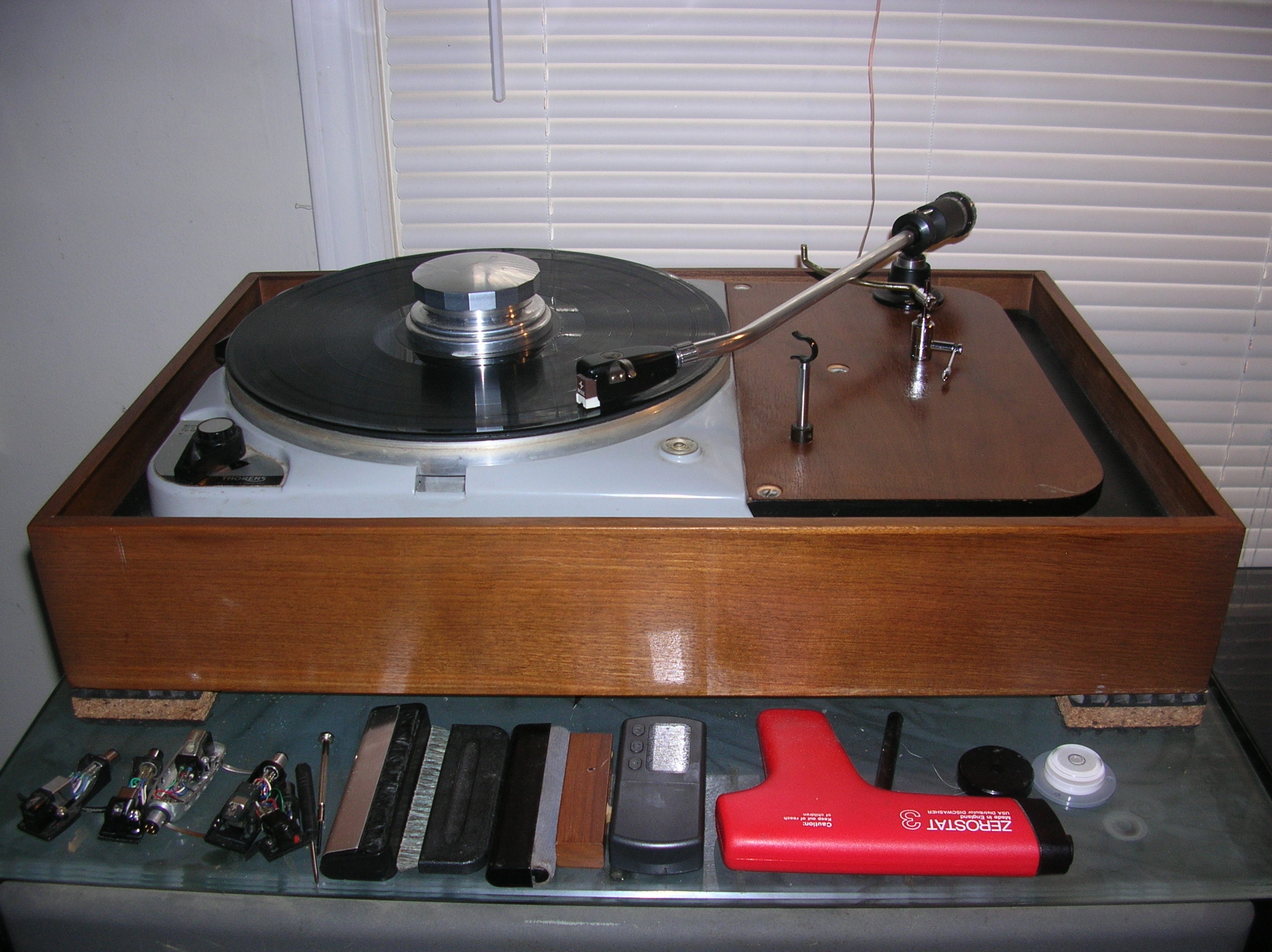

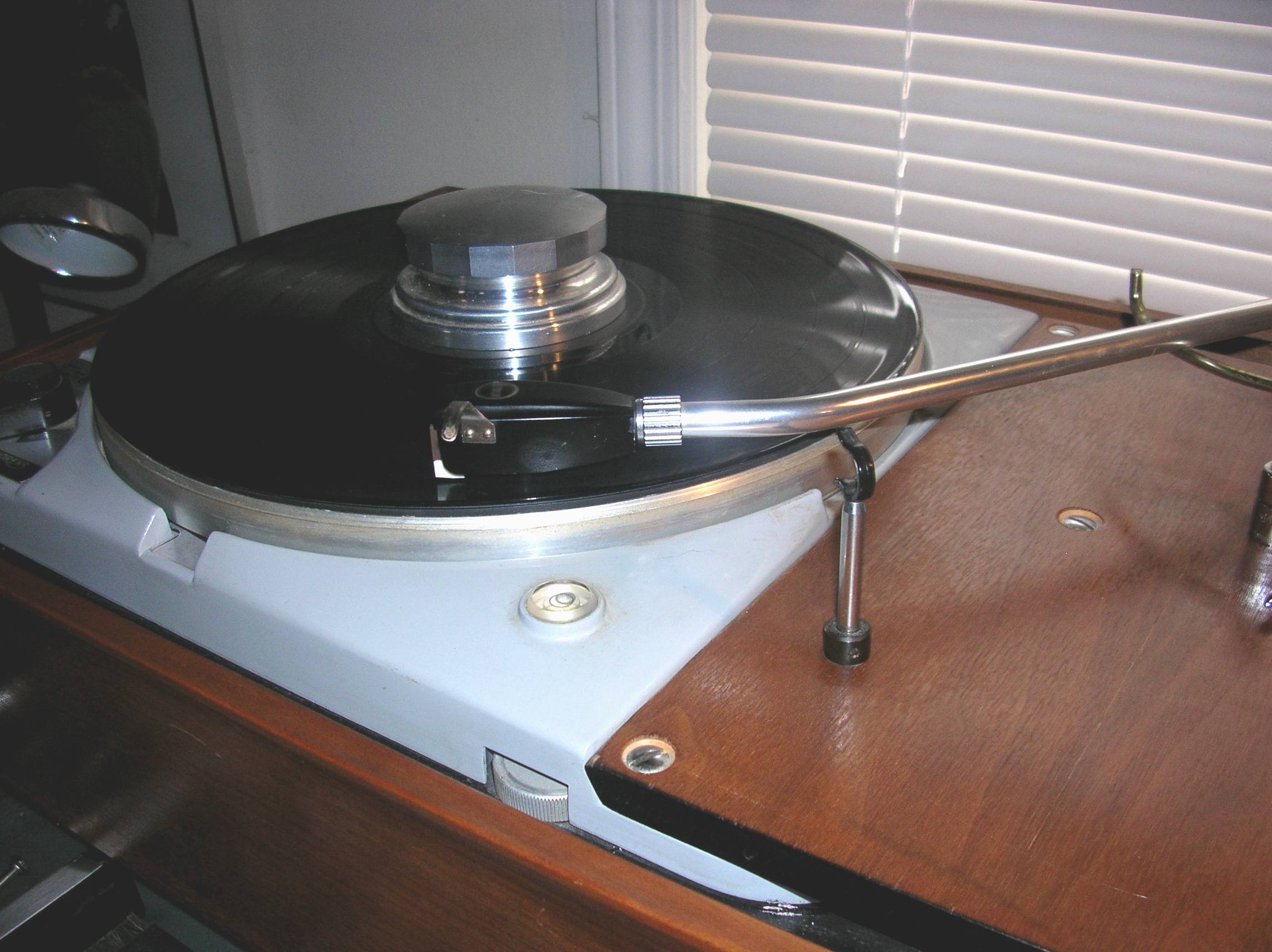

Gracias guys for helping me out. Readjusting the pulley via the grub screws was the ticket.
I took heed on proper fitting and only loosened, aligned, and tightened the screws the same amount. I am not sure if the height is correct, but I only raised it enough to clear the shield and not high enough to have the belt come off. I have been spinning records all day, and all is good. I will take the platter off tonight and inspect alignment. This is probably the quietest my deck has been since I have had it, thanks to great help here. Tomorrow I will check the eddy break's alignment. After that, the plinth! To think I was about to sell it out of loss of patience
