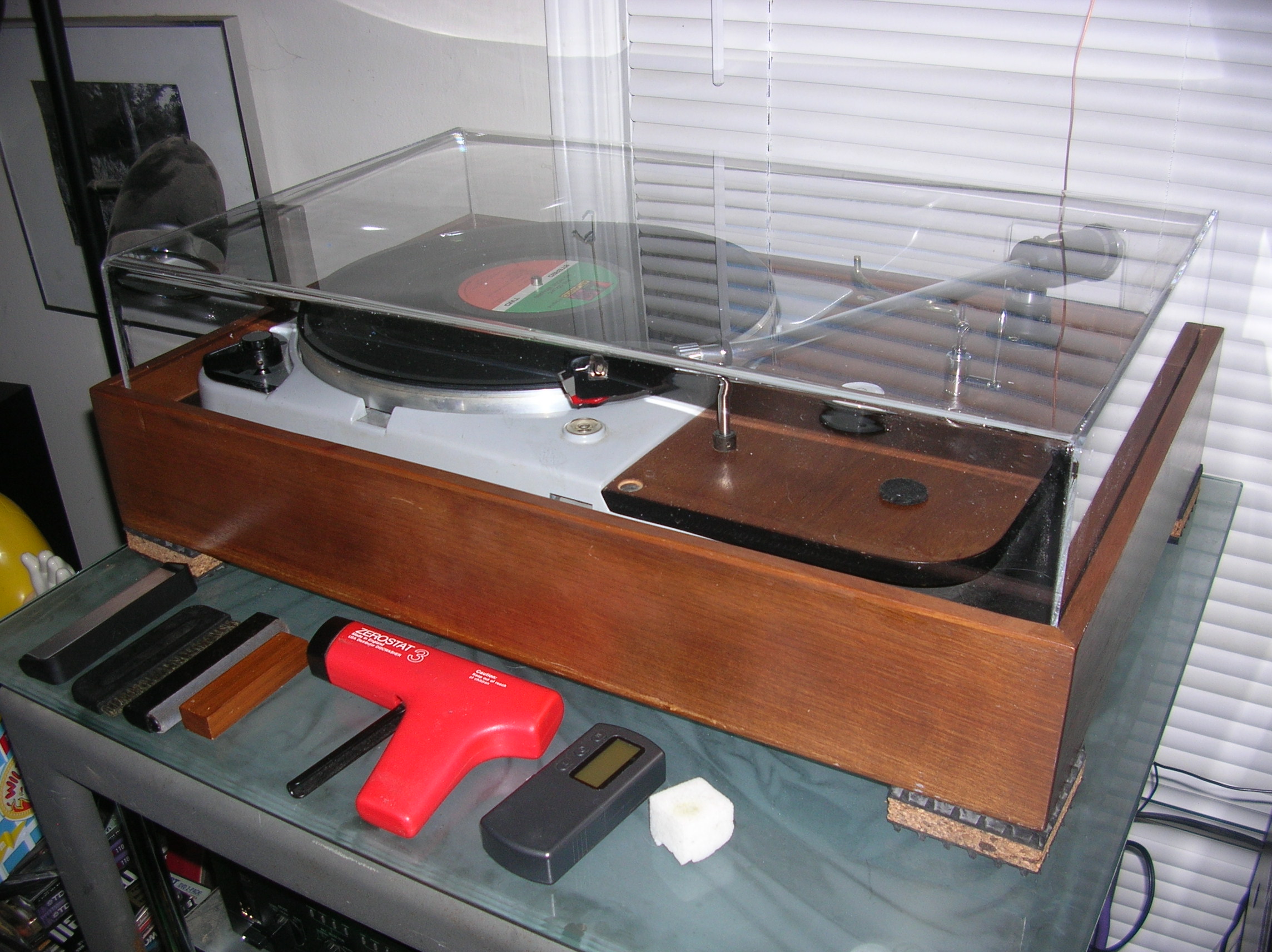

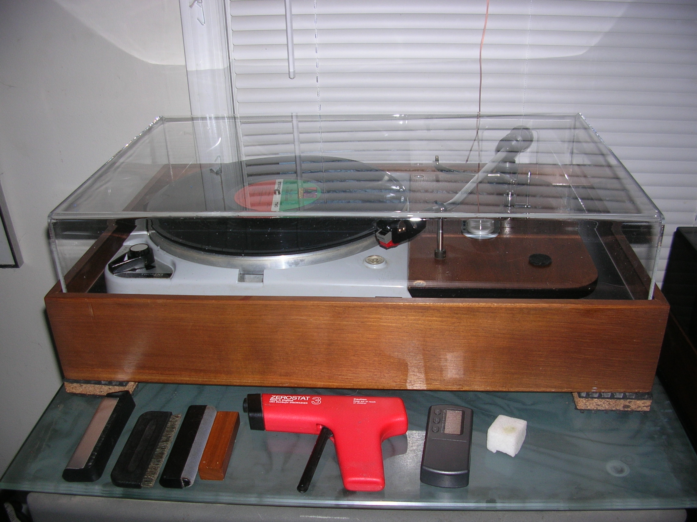

My TD-124 MK II with new dust cover.

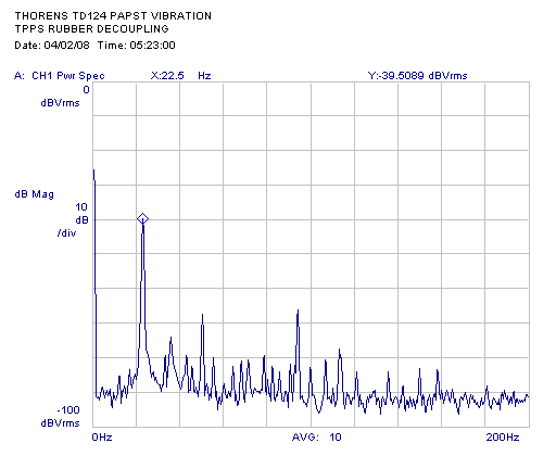

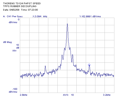

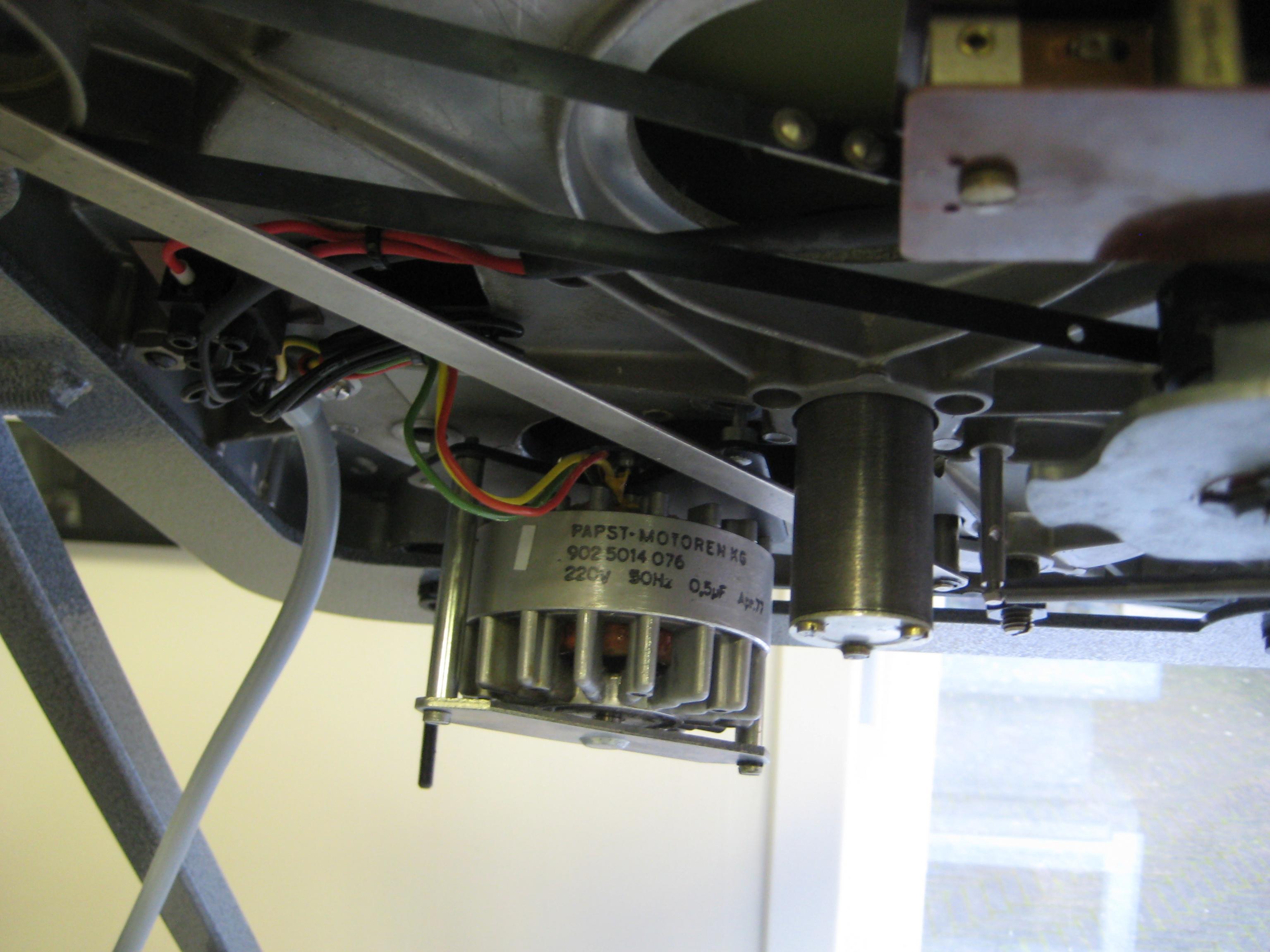

Papst motor with three phase powersupply in TD124

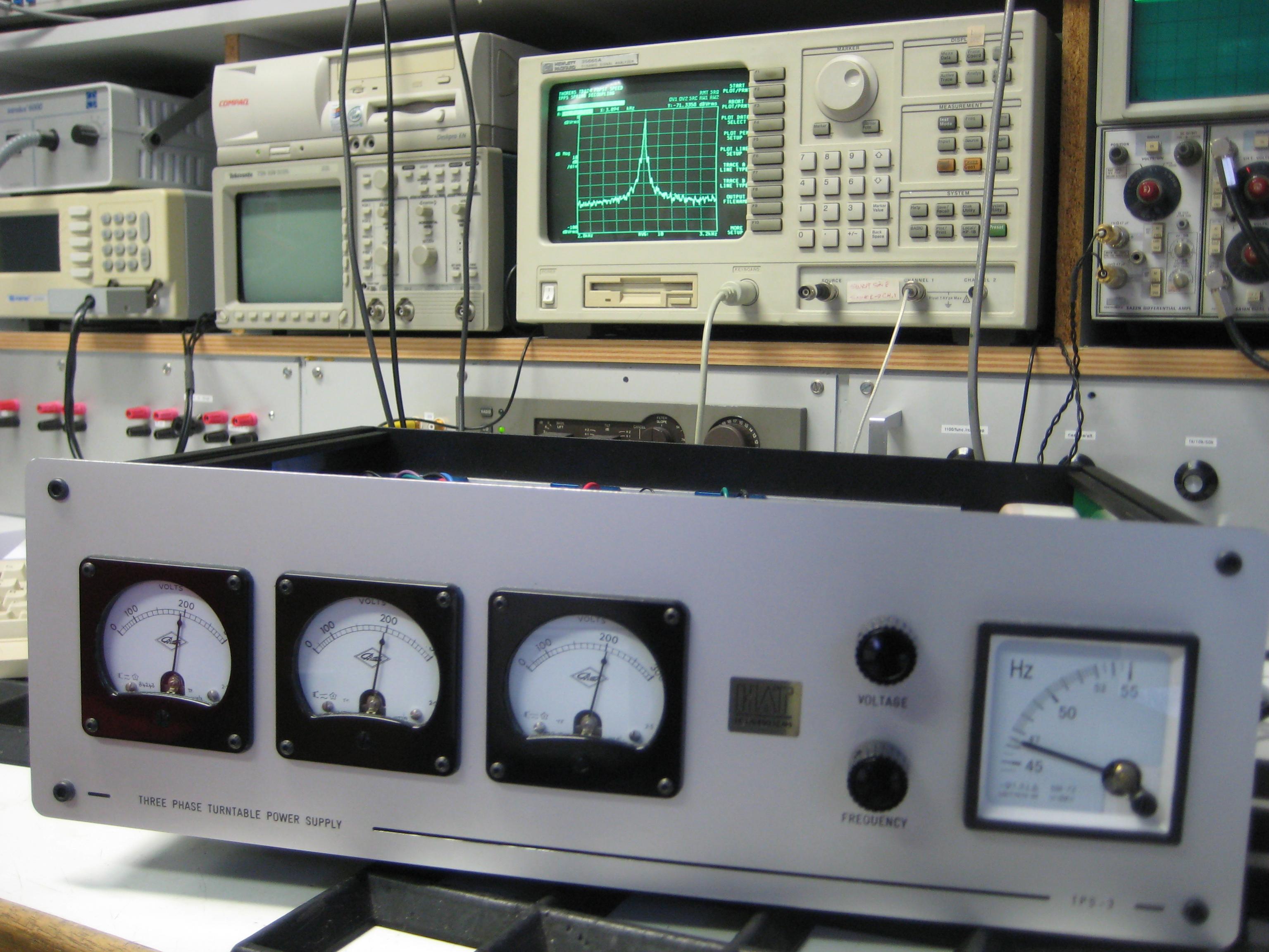

Finally the first results from my new three phase powersupply for the Papst and EMT930 motor.
The measurements are done without brake .
Freq.from powersupply is 46,94 hz voltage 220 volt.
The powersupply is connected by a 7 wire shielded cable for independent neonlamp power and swithing the three phase supply on with the speed switch on the turntable.
Measurements are quite spectacular the speed stabilty is the best I measured so far on idler turntables a very sharp peak .
Thorens supplied with the Papst modification also other softer rubbers I have used them in the first measurements seen the own motor freq.22,5 hz at -39 db and statorvibration 94 hz at -66db.
Thorens TD 124  Papst motor Three Phase Speed rubber decoupling.png Thorens TD 124  Papst motor Three Phase Rubber decoupling  .png

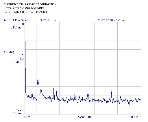

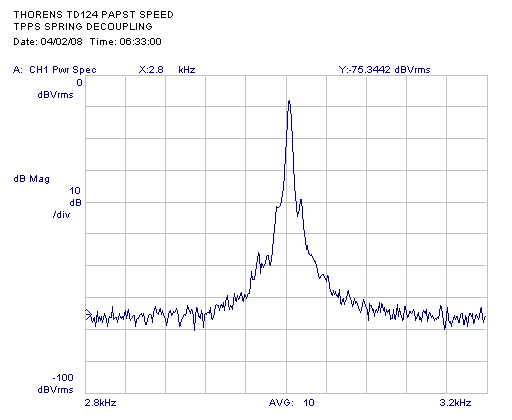

After replacing the rubbers by springs the own motor freq.vibration goes to -63 db and 94 hz stator vibration -78 db
