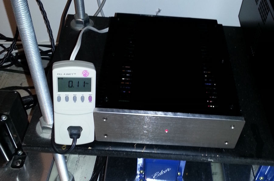

E50 Motor Power Consumption
This is with the tables in question fully warmed up, power consumption seems to be slightly higher when cold.
The following values are for a fairly late original series TD-124:
120mA @ 110Vrms, 60Hz
Real power: 9.1W
Apparent power: 14.1VA
Power Factor: 0.65
The following values are for a late TD-124 MKII (the one featured in this thread):
110mA @ 111Vrms, 60Hz
Real power: 8.2W
Apparent power: 13.0VA
Power Factor: 0.62
Edit: 120mA @ 117Vrms, 60Hz
Real power: 8.9W
Power factor: 0.62
In both cases I used my recently completed sine source to power the table in question.
The meter in question has relatively limited resolution, the output voltage probably differs by a couple of hundred mVrms at most between the two cases, but due to round off error the meter reports a full volt of difference. (There is significant DCR in the step up transformer windings of the source and they are not inside the feedback loop.)
More details here: http://www.diyaudio.com/forums/anal...ource-induction-motor-powered-turntables.html
