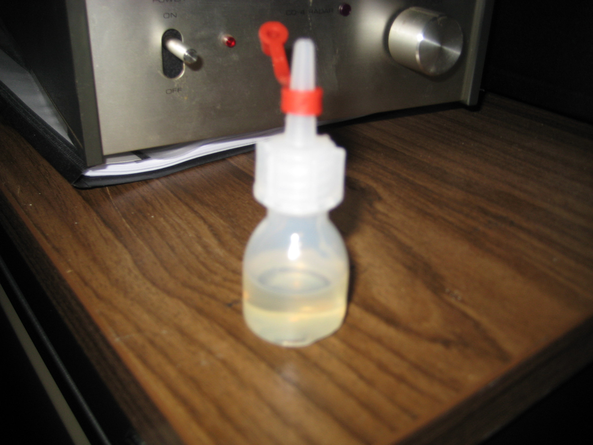

Volken, what weight of lube do you use in the.....
...motor bushings. Most of us have been following the service manual and use 20 wt turbine oil.
-Steve
-Steve
Volken, to echo Steve I'm using SAE 20wt electric motor (non-detergent) oil to lubricate the oilite bushings in my motors. It's about the closest thing we have around here to the original oil used.
I use Schopper oil for the new bushings they are no sinterbushings and need other oil. .
The viscosity is for me unknown but it is thinner then SAE20 but as you know the viscosity must match with the bushing tolerance !

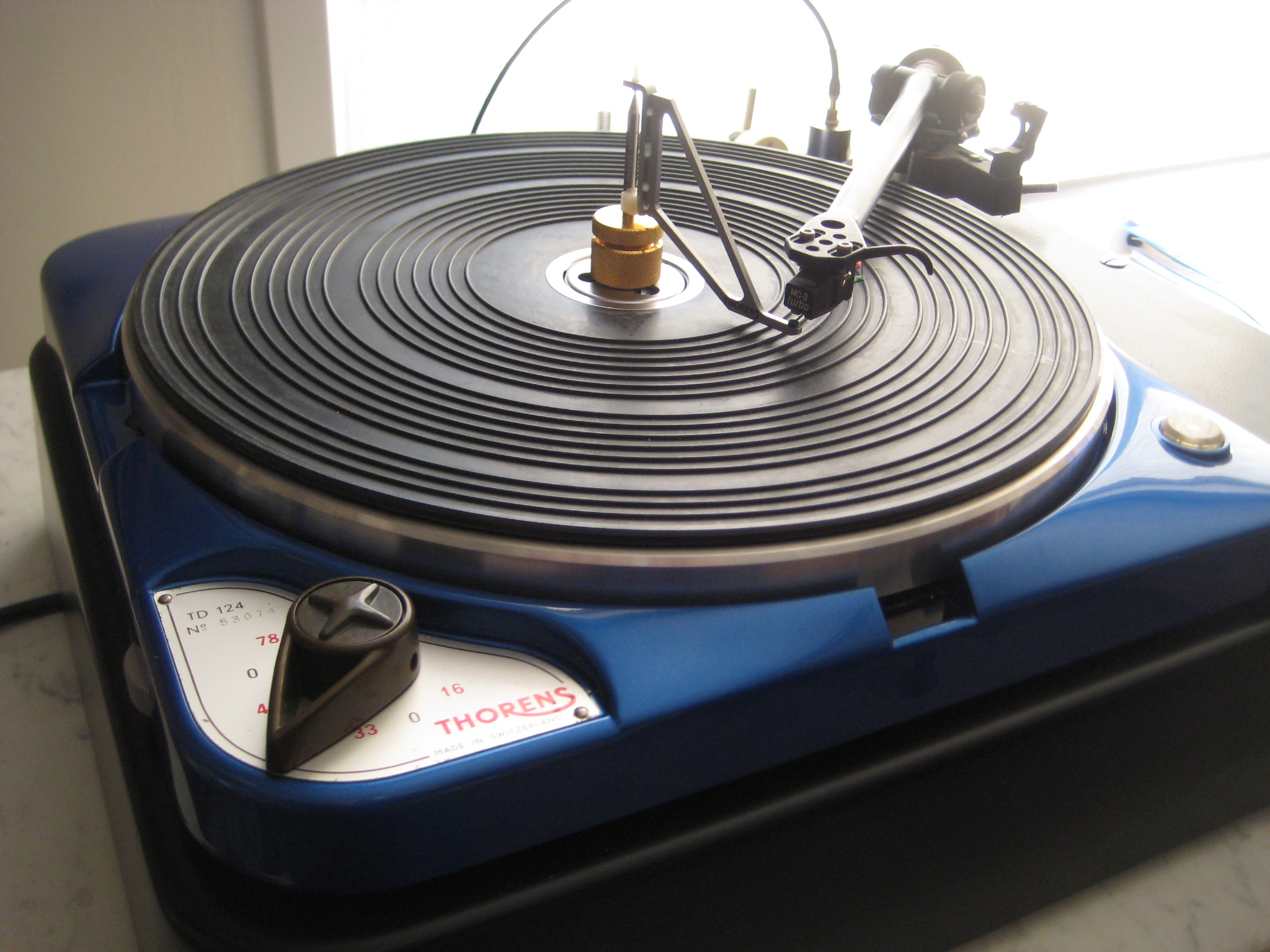

Thorens TD124 Ciel Bleu
Just finished the restauration on a TD124 because the chassis was in a very bad shape I deside to change the color in Ciel Bleu !

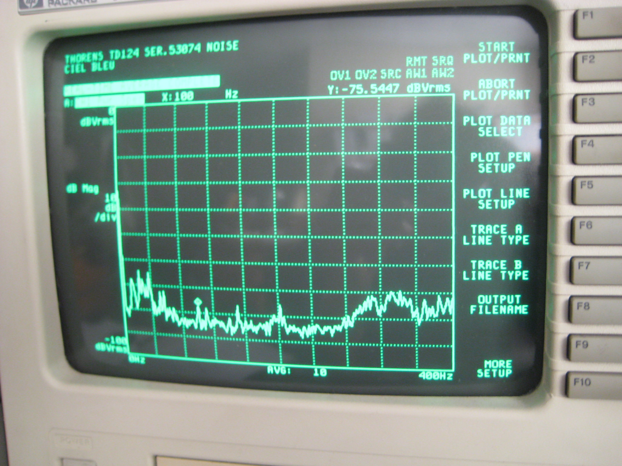

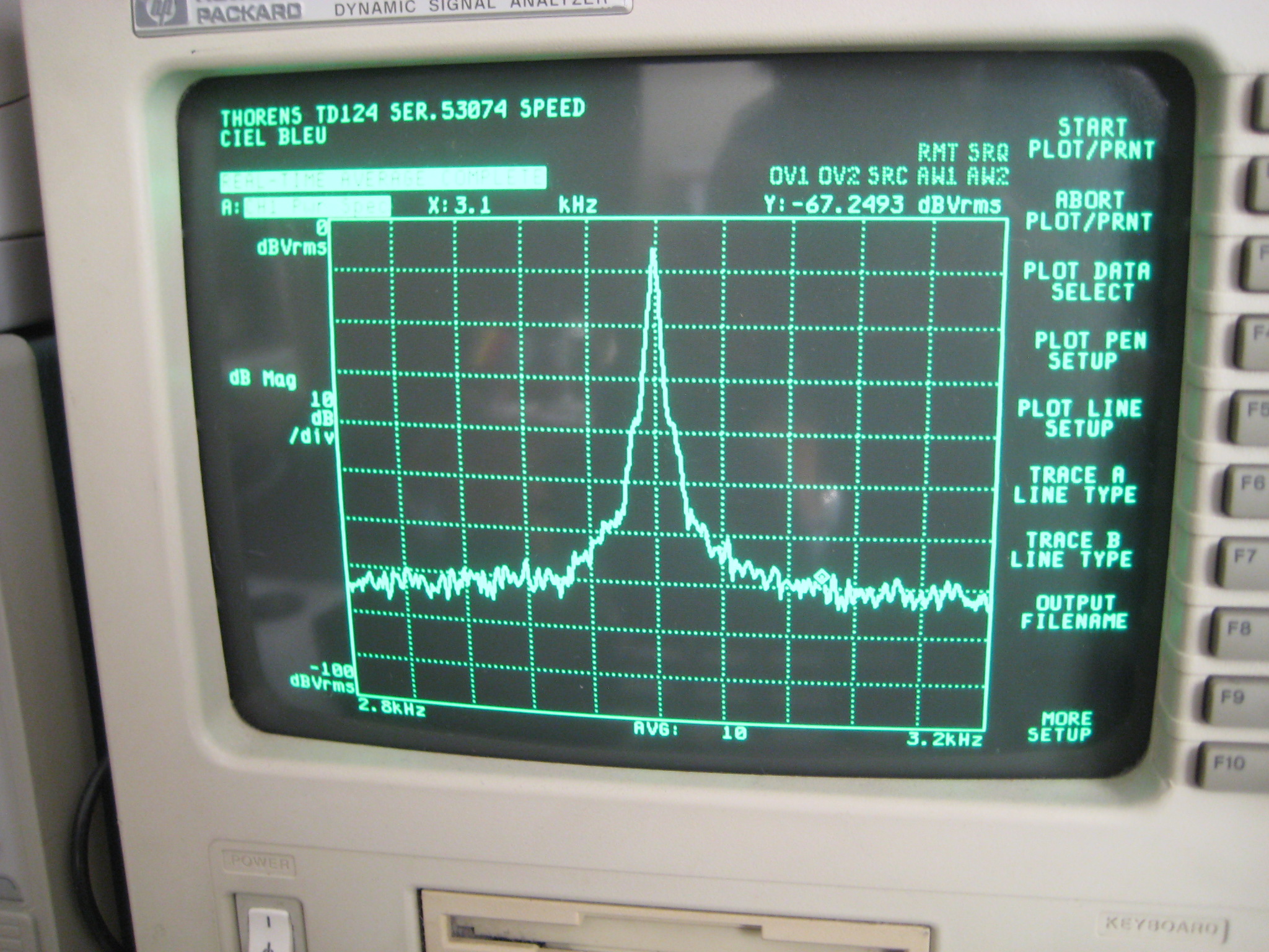

The speed and noise measurement are made after the restauration speed stability is excellent with a very sharp peak !
Motorvibration at 100hz is also very weak as result from the spring motor decoupling .
