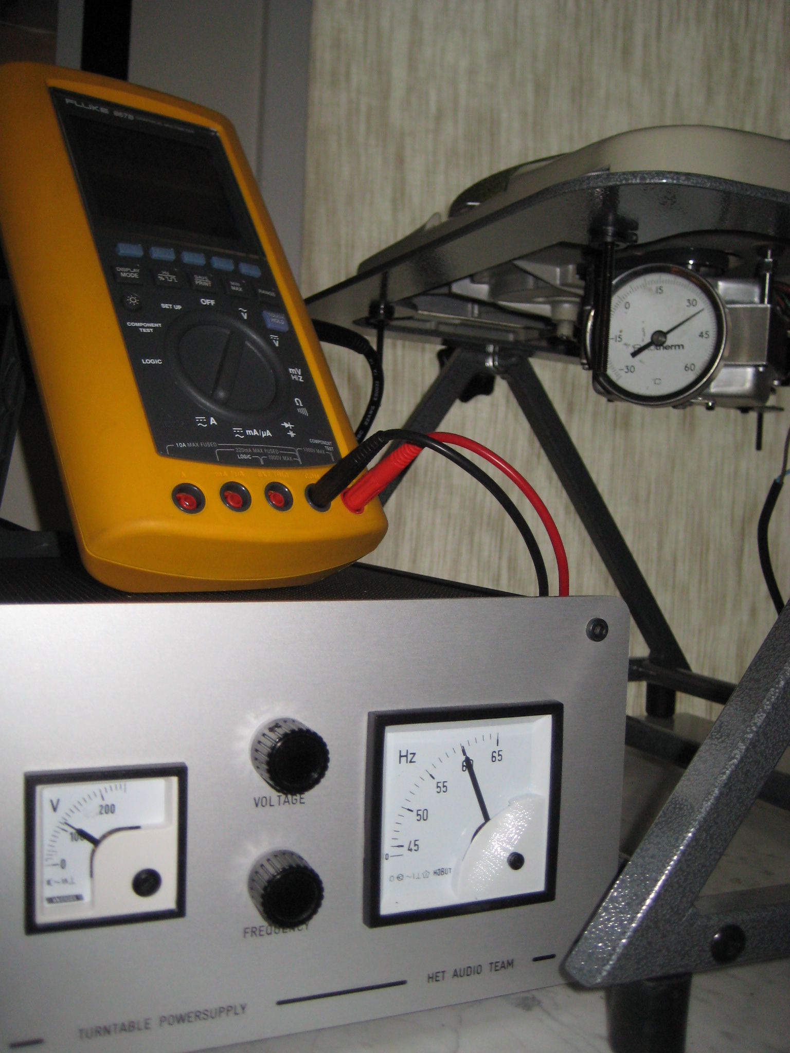

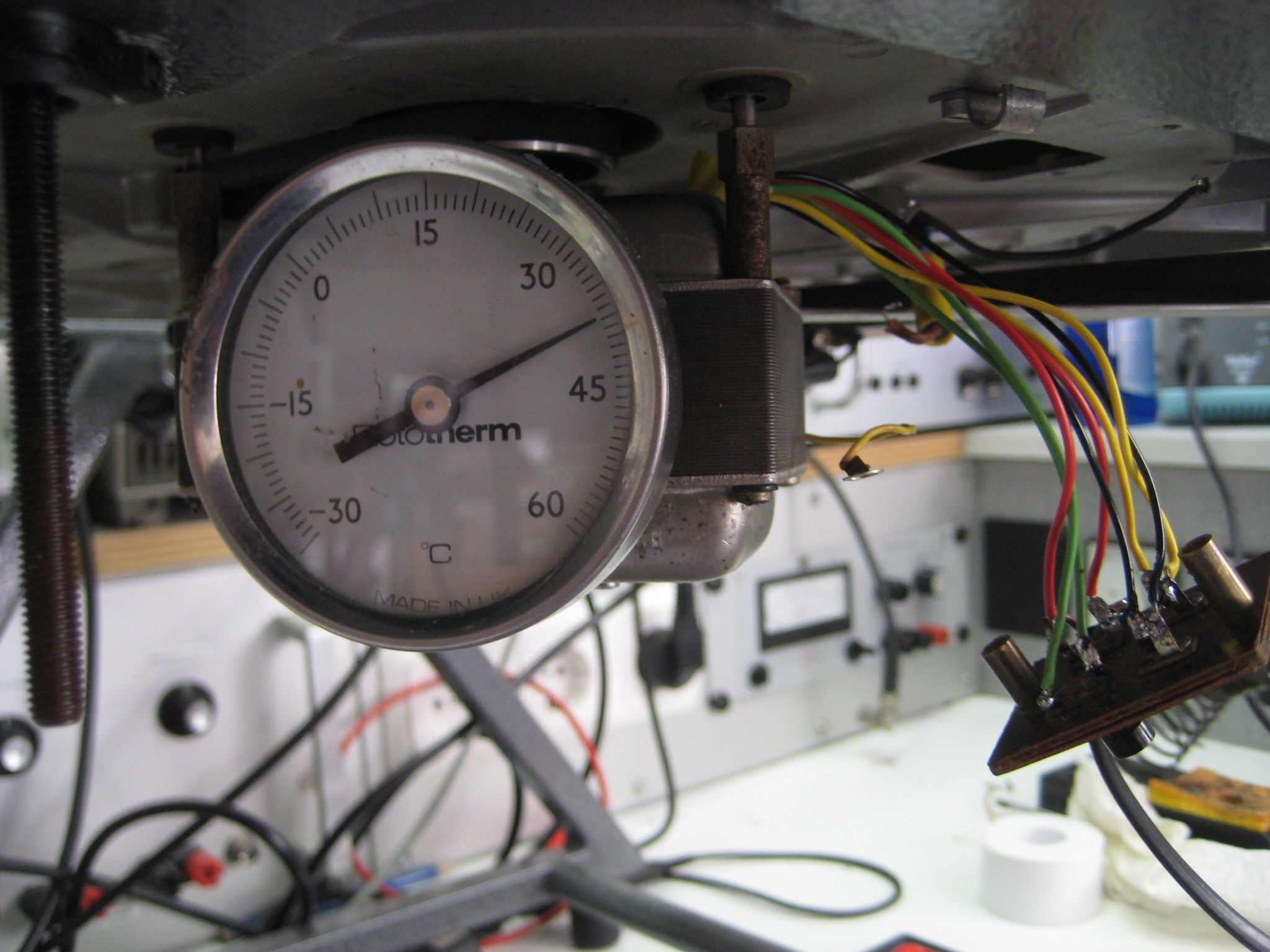

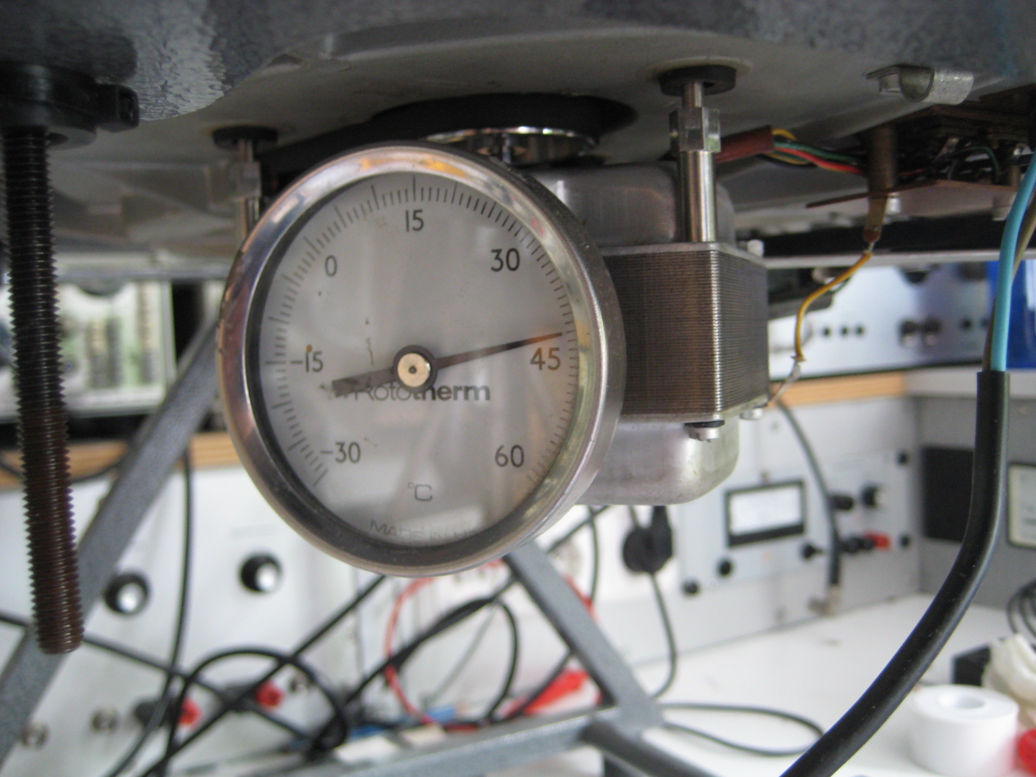

Thorens TD124 E50 motor temperature and speed
Following measurements under same conditions as first one hot measurement after two hours and speed measurement on the belt , the only way to measure the speed from the under side , hum shield removed.
Motor from ser.1487 speed 428,5 rpm cold at 42 degr. 427 rpm
Motor coil Simone 2 speed 436,6 cold at 38 degr. 435,6 rpm
Motor MK2 speed 429,6 cold at 37 degr. 426,0 rpm
Volken

Is the motor driving a completely assembled TD124. ie: belt driving stepped pulley driving the idler wheel driving the inside rim of the platter?
-Steve
-Steve
Yes Steve driving completely TD124 !
Volken

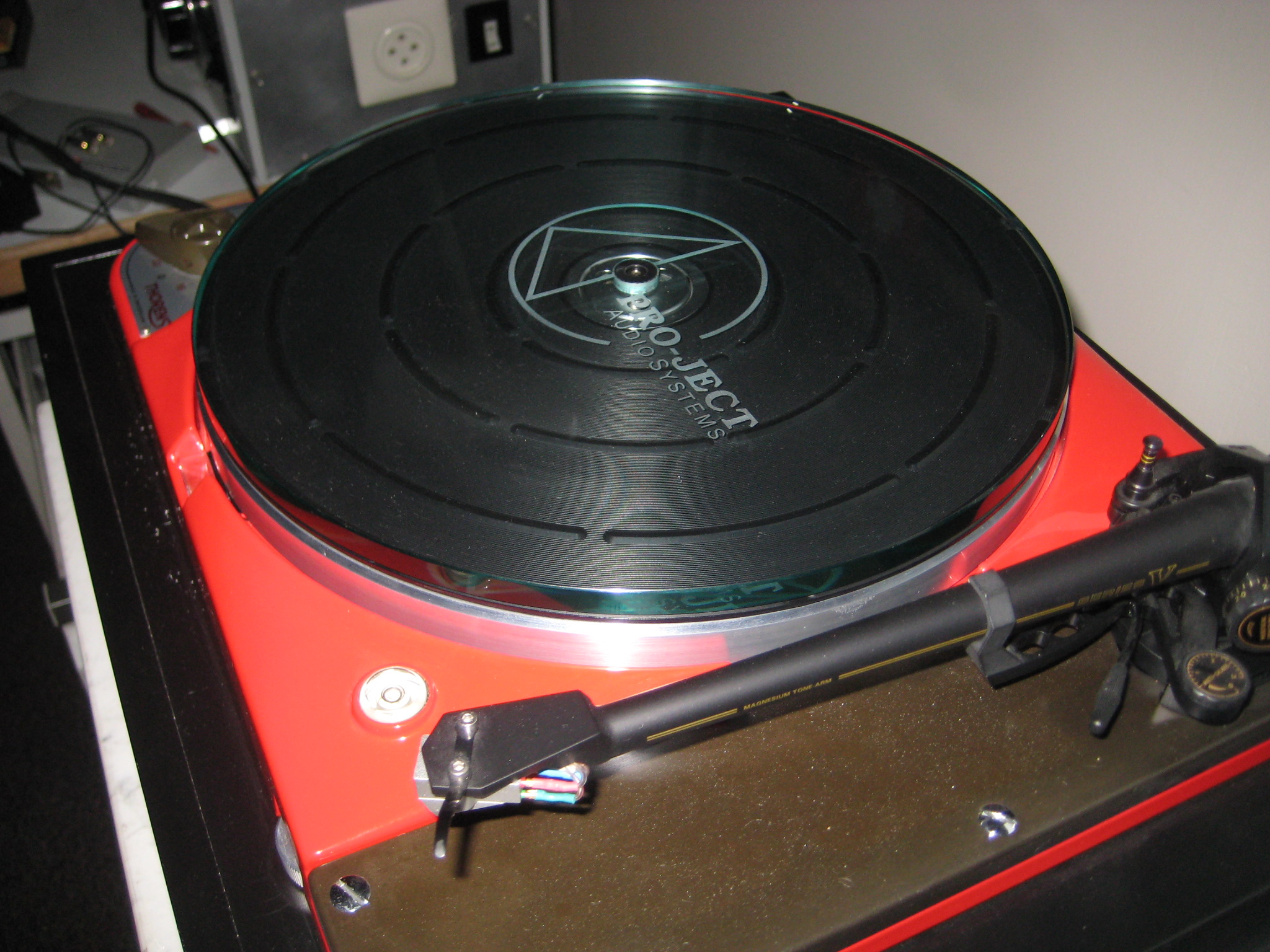

Newbie questions. If load an eddy's brake imposes is more than the variable load of stylus drag, will the slip remain constant ? How much influence would a heavy platter have on slip changes ? Wouldn't the inertia of rotating heavy platter over come various factors affecting speed accuracy ?
Thanks and regards.
If I place a Project Glass platter will not change the speed !
Volken

I suspect under load they run considerably warmer, I would swag perhaps in the 55 - 60 degree C range.
These temperature values indicate that there is something wrong with the motor.
Normal values are around 40 degree !
Volken

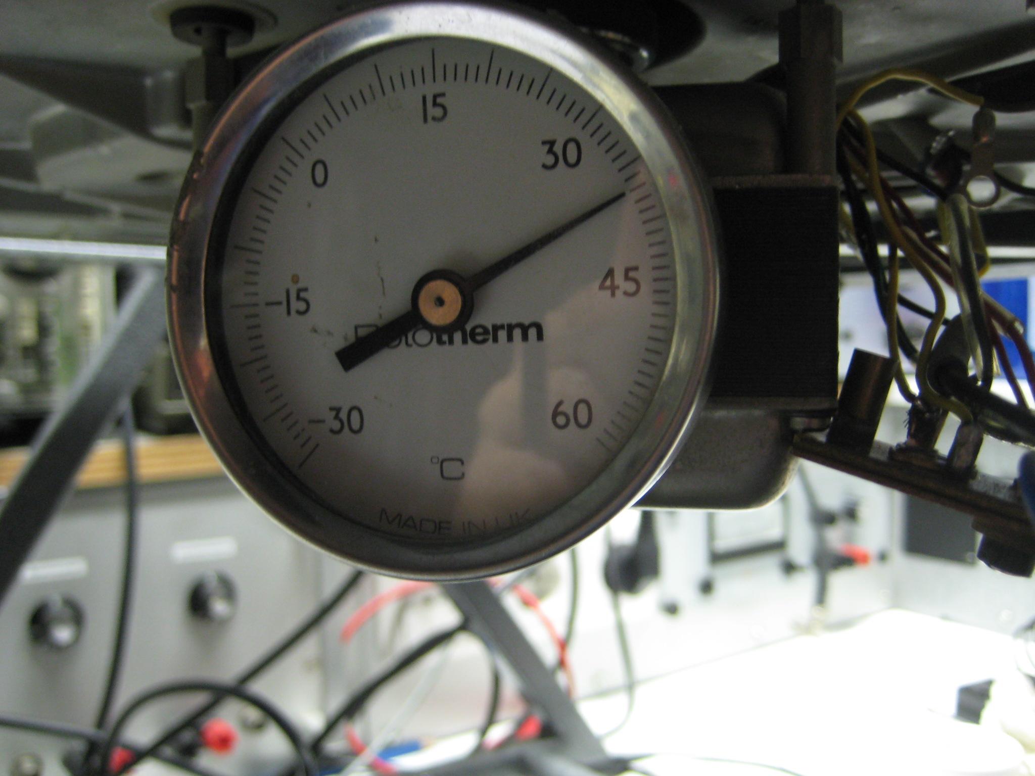

Thorens TD124 E50 motor temperature and speed 110 Volt 60hz
Following measurement done with HAT CPS turntable supply on 110 volt 60Hz
after two hour
Motor TD124 ser.1487 belt speed cold 490,4 rpm at 36 degr.488,1 rpm
Motor MK2 belt speed 506,1 rpm at 37 degr. 503.3 rpm
Speed results are about the same as on 228 volt .
Temp. from MK1 6 degr. lower ! MK2 the same as on 228 Volt.
Volken
