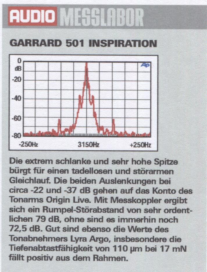

The Garrard 501 has a world record for idler drive rumble ( over most belts also ) at - 79 dB weighted. This shows it can be done.
This is indeed impressiv if I look at the speed spectrum from the 501 I see two sidebands at about 25 hz and 100hz .
I assume these are from the motor vibration ?

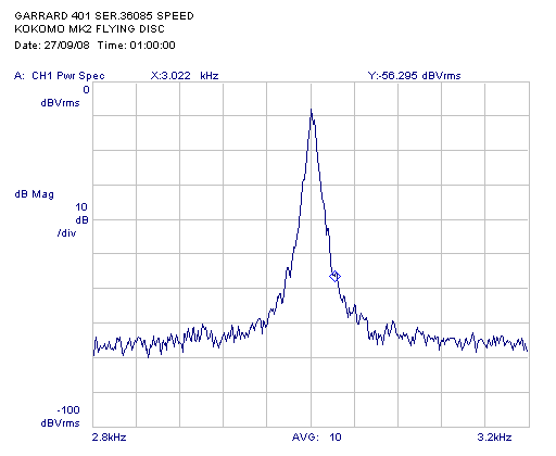

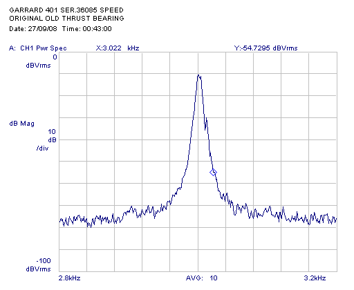

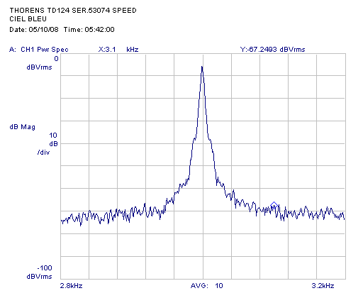

Here are a couple off measurements to concerning speed stability and other ,,rumbling,,components it is not a 1:1 compare because I don"t no the testrecord from the German test they used a 500 Hz span mine is 400 Hz measurements which is more critical .
The motor vibration at 24 Hz can be critical in combination with tonearm resonance freq. The noisefloor from the Garrard 401 is somewhat lower but don"t forget that the tonearm at the 124 is mounted on the chassis and the Garrard on the console !
Volken
The Garrard 501
Thorens TD124 after revision
Garrard 401 after revision with new bearing
Garrard 401 after revision with original bearing

Are these the 25/100Hz sidebands in the speed spectrum ?

See the measurement with the old trustbearing and new one !

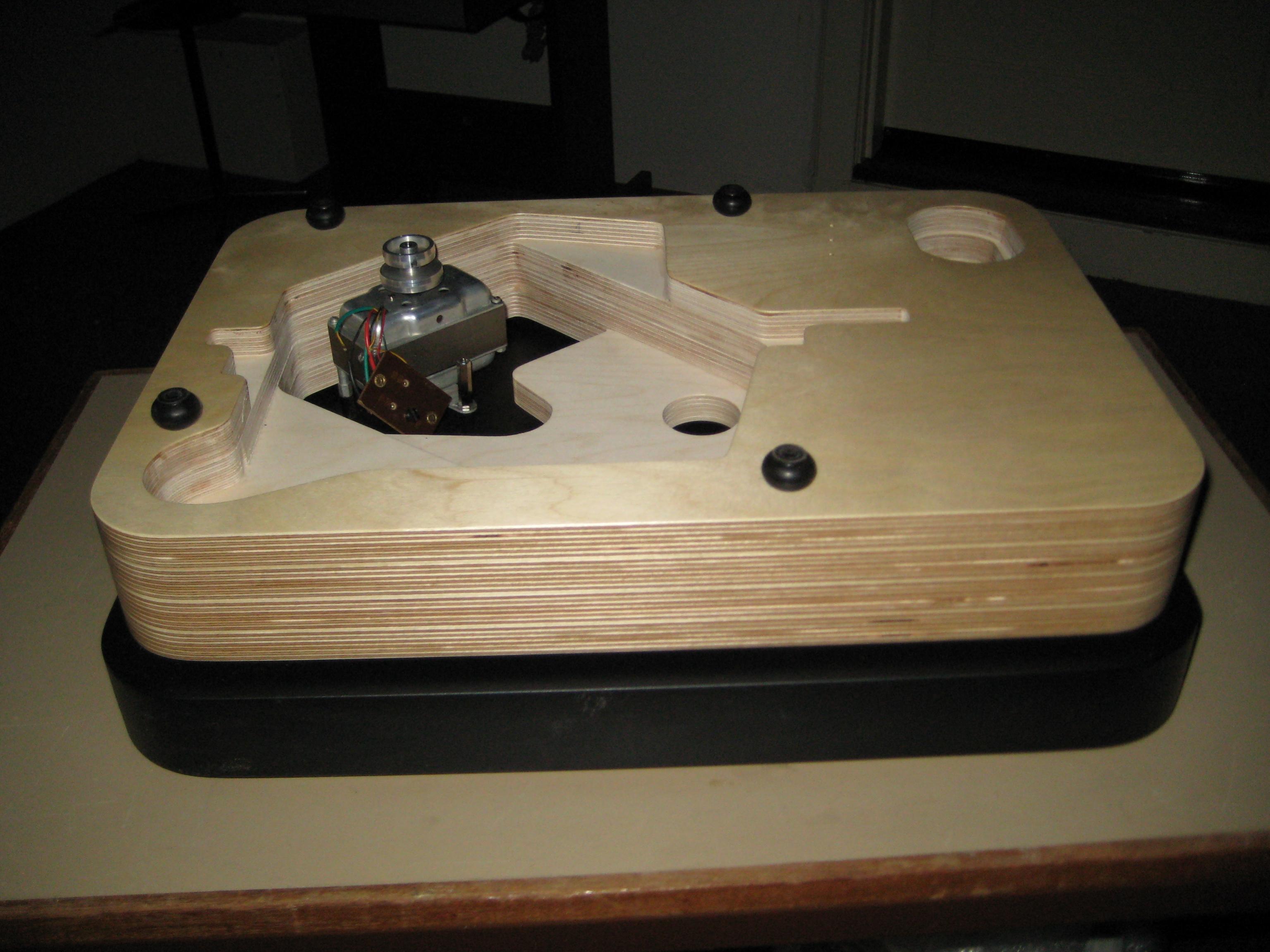

Instead of placing E-50 motor on rubber grommets, why not make a two tier plinth and rest it firmly on bottom plinth ? This would isolate it from main chassis.
Regards.
Regards.
... also would like to know. If we make a hollow cavity filled with sand or ball bearings which could be fitted on center bearing shaft on bottom, will the noise/vibrations dissipate in to it ?
Regards.
Mr.J-C Verdier did this in 1980 , I tried it to with mixed results the vibration couples with the console for best results the motor must also decoupled from the bottom console.
But it goes to far from the original design and complicated a set off springs is easier with almost the same results .
thanks.
I tried a graphite thrust, it was very different sounding. Thinking about it, it is perfection in some ways. The one I fitted to a 301 came out perfect months later, took me an hour to make. I fitted on the 301 shaft a Pyrometer window ( 10 mm ) made of Pyrex. The glass bonded to the shaft using a lathe to make it true. Use a dial gauge to check ( as best you can, I used the end stock to push it flat, worked well ). The TD124 might suit even better. Graphite can be worked with simple tools. I use electrical grade for motor brushes. It would both damp and offer minimal displacement due to imperfections on the graphite surface. TD124 might need the glass thrust also. If so a slight dome shaped thrust works well or flat. I think I would put the graphite on the TD124 shaft as a dome and have a recess for the ball bearing in the graphite. The glass on the bottom set in Blu Tack, just enough to get it flat. The big deal is all of it is reversible if not the answer. I think Thorens saw that the centred ball is never that. The plastic thrust helps it work properly. The last Garrard bearing for the experimental 501 had a massive flat thrust and flat bottomed shaft. About 2 cm. The turntable rode on oil. It had a grey pattern of a different metal looking something like a milling too on the flat part. My 501 is a 301 with slightly better bits, I choose not to follow the Garrard Swindon 501 ideas, it was a belt drive.
