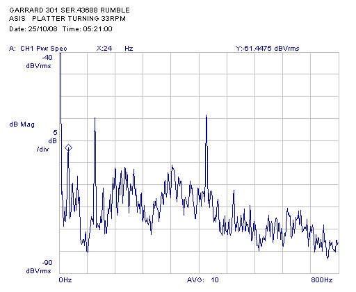

On the moment working on a old301 nice to see the vibration levels from the motor 24-100 hz and the harmonics only motor turning.
Second picture with platter turning and the extra rumble component from the idlerwheel .

Try to understand the effect on this concerning rumble levels and speedstabilty not only listening but also measurements
Can you tell how Garrard ground the shaft without using the center ?
-80 db how did they measured this ref.level ?
