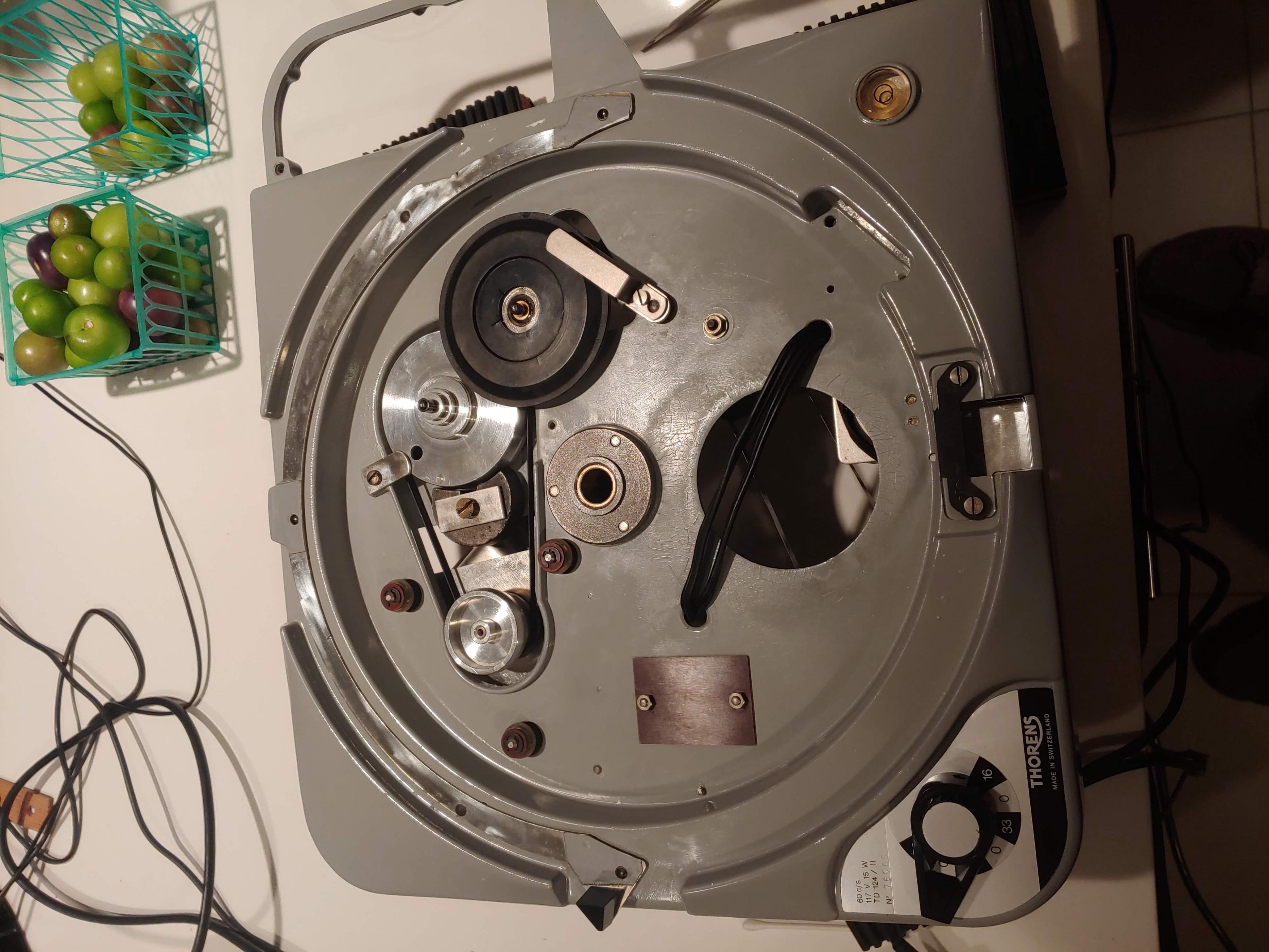

Here are some more pictures of a TD124 for the internet. 🙂

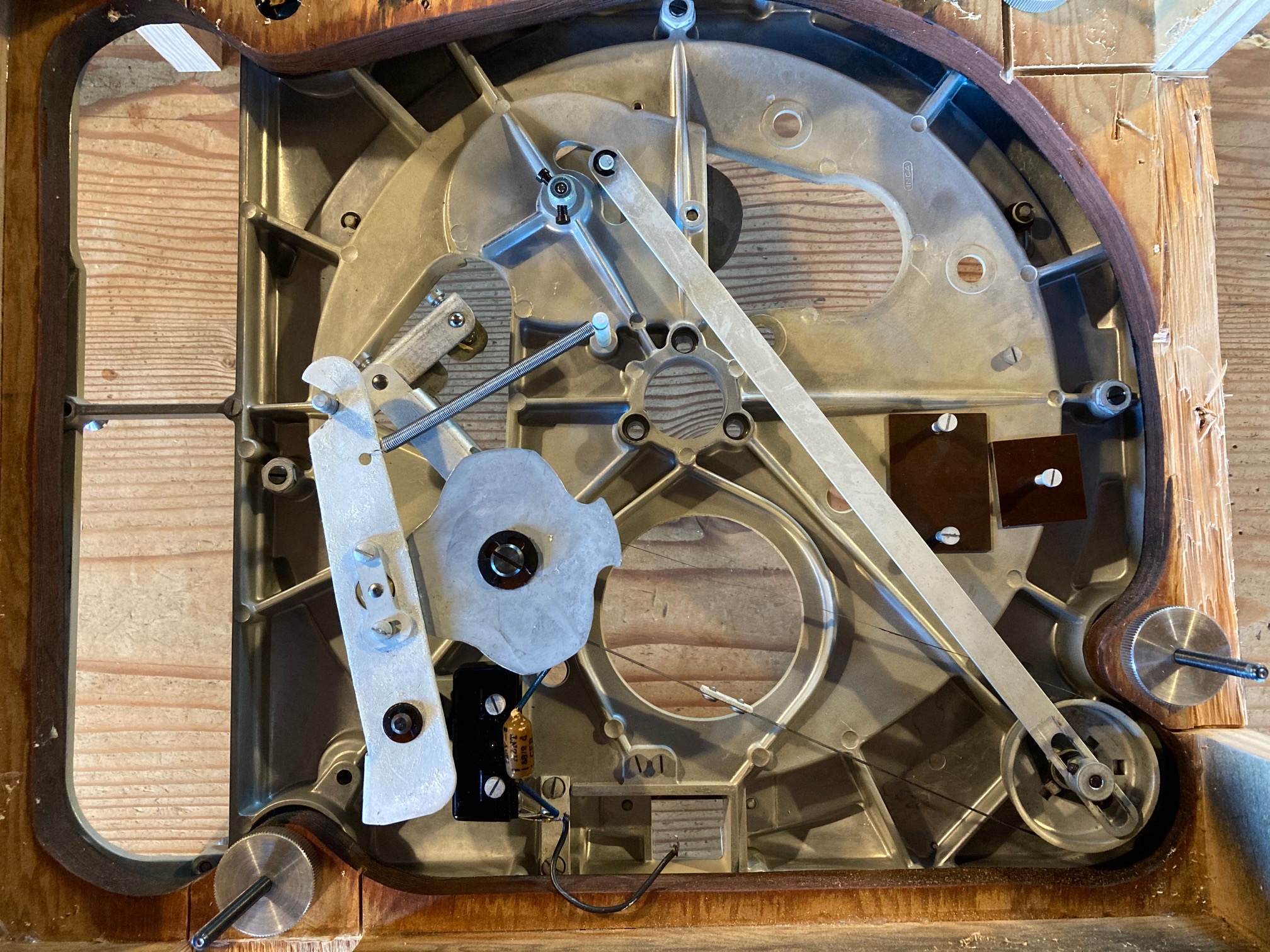

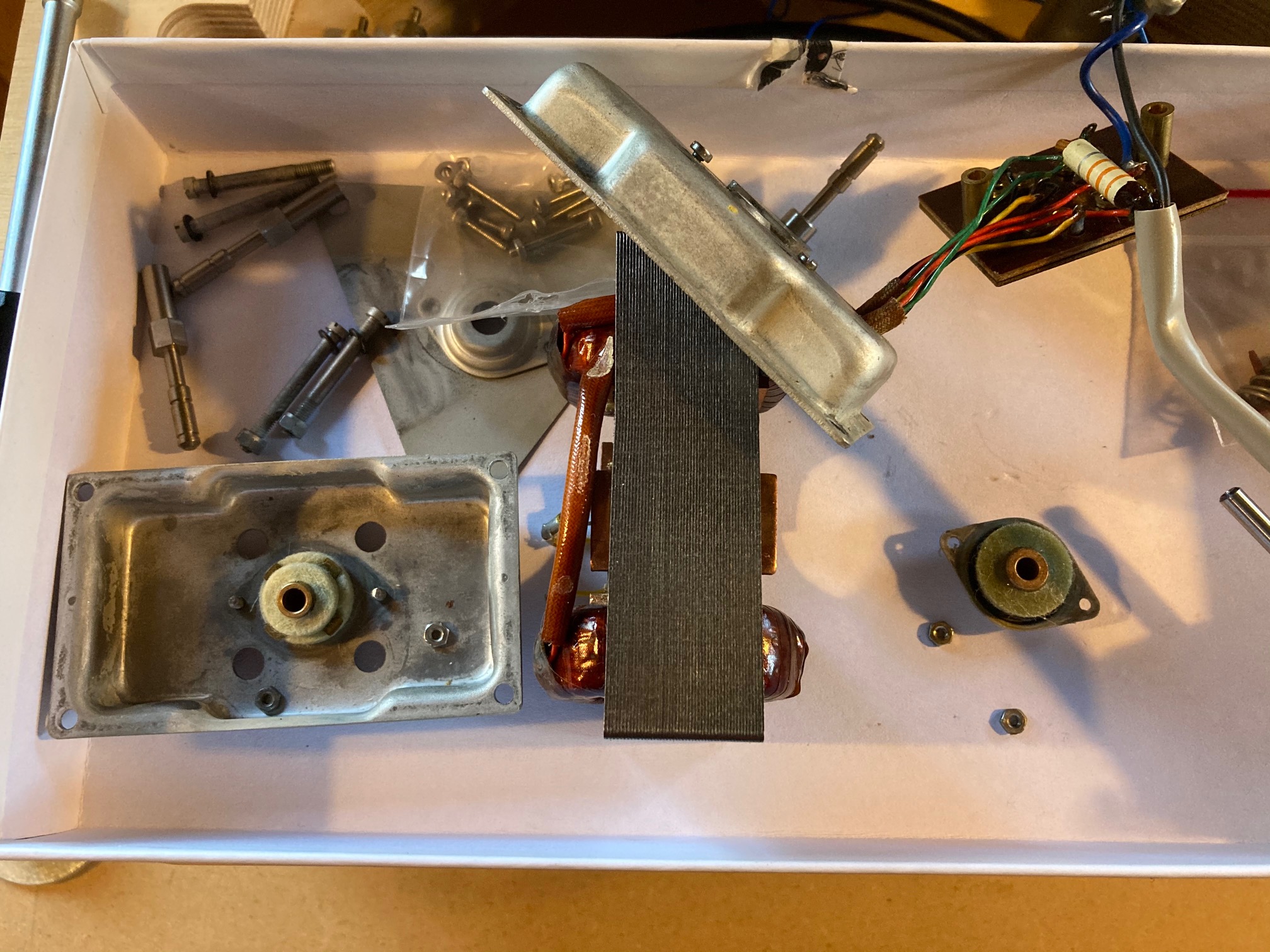

I made an ugly frame to bolt it too and that has made working on it much easier. I found that there was very little oil in the bottom bushing felts of the motor. There was probably very little in the top as well. But I had spent the last few days applying oil to the spindle at the top. I have no idea where the oil has gone. I rebuilt the motor just over a year ago and it still looked just as clean inside as the day I closed it up.
I have put the felts back in some sae20 3 in 1 electric motor oil.
Should I bake some oil into my bushings? They are from Audio-Silente and I thought they arrived loaded with oil already. I really want as much oil as possible in there.

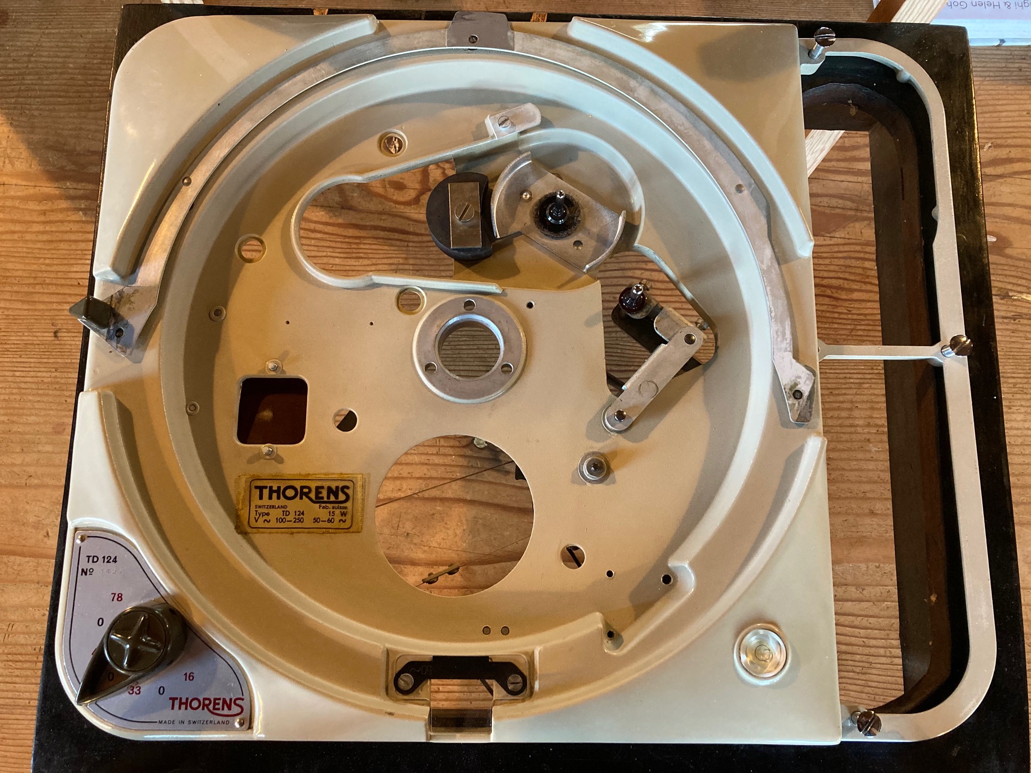

My table is back together now and is rotating the platter well. It takes just a turn or two to get up to speed though it struggles to get to 78 without a little help. I have just a few things left to do:
1. Create arm board and mount arm / cartridge
2. Create plinth
In terms of table upgrades, I would like to get a new idler wheel (or get it redone by Terry's rubber rollers). Any opinions on getting it redone vs getting a new wheel such as the one from Audiosilente?
I would like to get a new bearing end cap. Any opinions here? Was thinking about the Audiosilente one as well.
A new nylon washer for the thrust of the idler. Was thinking of just getting one from the local hardware store.

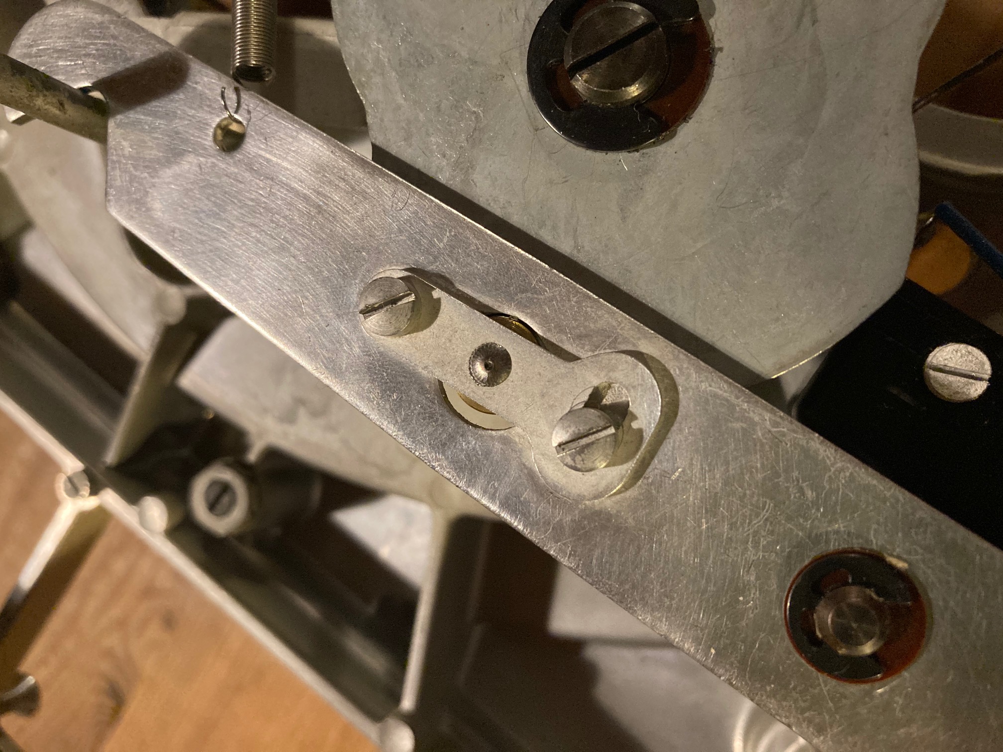

Finally, does anyone know what the pictured brass washer looking ring is for? It is 6mm and I had it bagged with the metal cam follower/switch actuator assembly.

Definitely get the Audio Silente idler wheel, it is much, much quieter than the stock idler or any of the several replacements I have tried including a very well preserved NOS one that was perhaps the closest but still a distant second to the AS idler.
Get an end cap that will fit through the chassis opening. Chris' end cap is excellent.

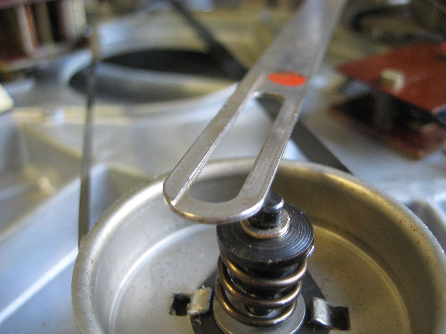

The brass washer is for the speed regulation don't loose it then you got a problem.

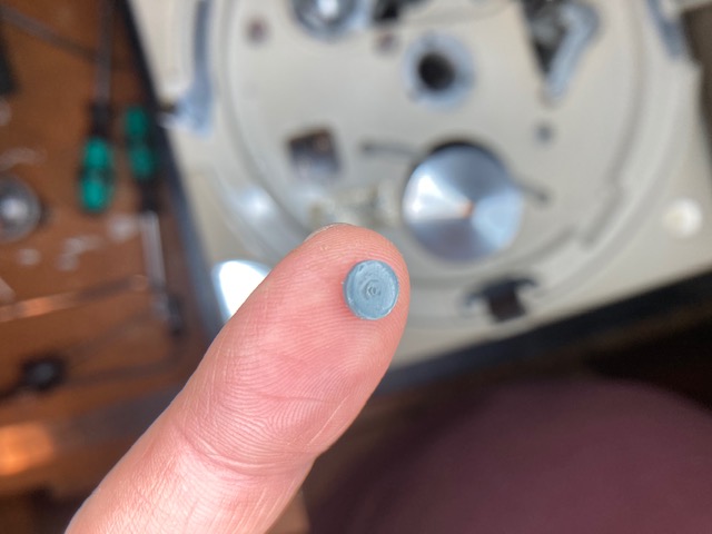

Do you mean the thrust washer? (That's what it looks like) The cap is the large metal part that bolts to the bottom of the housing in usual parlance.
My thrust washers are all the ID of the housing and can't move around for that reason.
Whatever that is looks more than a bit too small. To fix you probably need to get the right size thrust washer somewhere online and take the end cap off and install it.
Don't run it without one as the ball and cap might be damaged.
